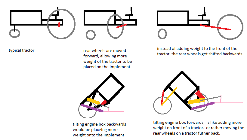

Ryan you got the pictures I was watching. when stuck in mud could raise out the wheel shake the mud off like a dog and continue moving.
Thought this would give you a few ideas of the concept.
enjoy reading really would like to see a prototype.

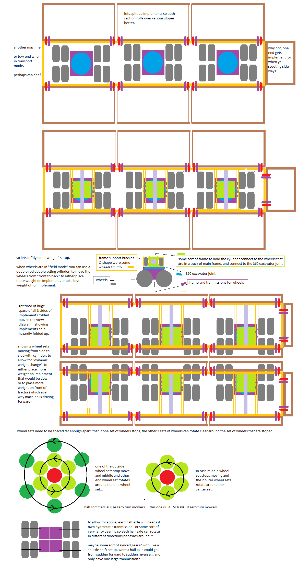

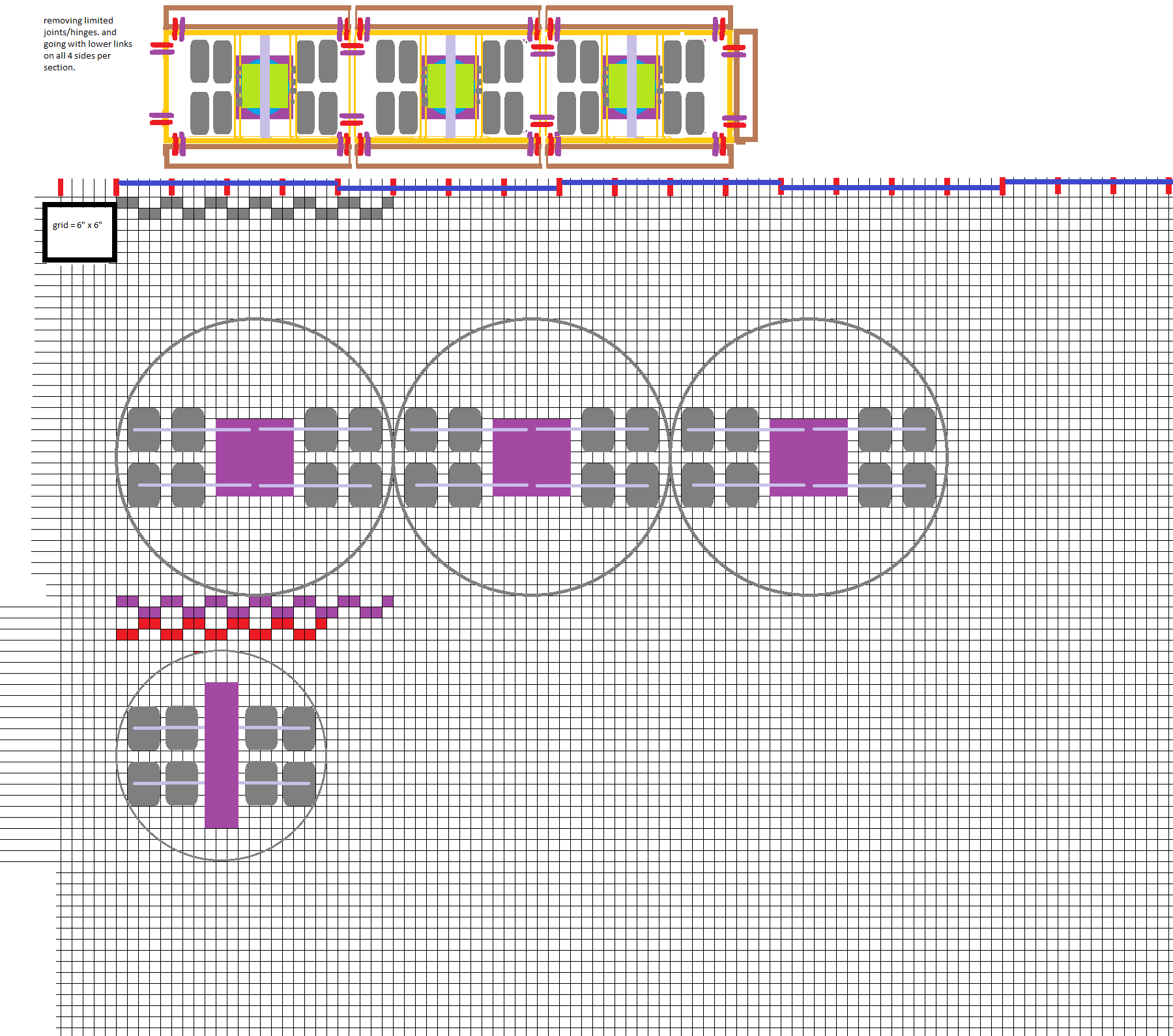

going through future trends for farming on internet... and having a hard time with what i been seeing and reading...
i always come across small size robots out in fields. and i have a hard time with this. more so when trying to get into wet muddy areas of a field. i did see some good comments of smaller size width and length tractors/implements. but normally attached to same comments, is someone setting at home in there chair. this really does not make much sense to me.
for the SSTT. i think i am more looking at a physical enclosed trailer / motor home type thing. that can be pulled behind a full size truck with 5th wheel connection. perhaps a trailer that folds out for a larger area inside the trailer. inside, having a 2 command centers.
command centers, acting like "remote cabs" with a bunch of computer monitors surrounding a chair. and live feeds from cameras and sensors on the SSTT get feed back and displayed on the computer monitors. and a drive is able switch and move camera feeds and sensor reading data readouts around. and control various SSTTs from a central point.
the trailer would include, fridge, toilet, a/c, heating, generator, telescopic antenna perhaps something like what new station vans have. for getting live feeds back to the news station command base. around the outside perhaps area for tool box location, areas to store some spare parts, and oils and fuel, along with various liquids to clean and deal with sensors on the SSTT. perhaps location to store some batteries and remote antenna repeater. to extend range of everything.
the truck pulling the trailer, so trailer can be dropped off, and truck take off across the field after a SSTT that is having problems, with another antenna on it, to extend range, and some generic laptop in the truck. to take control of a SSTT. that is having problems. perhaps some sort of long "pole" on front of truck. is if SSTT is going out of control. truck can drive up behind it. and crash pole into a "emergency stop button"
the goal of truck/trailer combo. is being able to command and control multi SSTT (side ways snake train tractors), make it tilling, and trying to get as much done as fast as possible. or say harvesting unit, and controlling chase grain wagons. and when it is time to move everything down the road to another field. it would be a ready set go. or perhaps a small crew of folks driving back and forth. as one field finishes. SSTT is driven off, letting another SSTT stay around to finish things up.
i am having a hard time with "plan ahead" thinking. i see all these dozers with laser tracking, and then scarpers and motor graders with laser guidance. and then even see all these tractors and implements with GPS navigation and computer plotted. paths to follow. but i am not seeing much, of controlled plowing / discing / etc... and combined with erosion problems, and shaping of the fields. and more to the point sensors at the plows and discs, and chisels and other ground engagement doings. all tied up with satellite maps, and air plane photos, and GPS, and etc.. for accurate elevation within the field.
i mean really, how hard would it be to do a "plan ahead" and let say a bottom plow drop a couple more inches down in a given area. and another plow right beside drop only inch more down. and reshape a field. perhaps make an extra pass or 2 every couple years. or better yet let the farmer choose, to see how much they want to reshape a field. and remove high spots and fill in low spots, and deal with drainage better. i mean really does a bottom plow, or a set of discs. need to be locked together as one large solid mass.
i am still stuck on wanting to lift dirt up off the ground. and feeding the dirt through various sensors and crumbles and what not to brake it up to a certain point and then controlled layering and compaction. as dirt falls back down. but i am having a hard time with current "technology"
speaking of current technology, farming is lagging behind in the times. i am not seeing more "3D gaming" built into things. at most i am seeing PDA's and cellphones. and a bunch of touch screen displays. this goes to "manuals" and part lists. to also repairing a tractor. i honestly would like to see a full 3D game like environment. i can open up on my laptop. act like 1st person or 3rd person view. and walk around a 3D model of a tractor and implement. and click or touch screen to zoom in on a problem. click bolts. and a button to remove say a shield or a tire. and zoom in the area and click again to take something apart. with perhaps a link to a youtube video. or a link to some webpage that gives more detail / specs
when it comes to driving more so remote controlled. or heck even in current age full decked out cabs. being able to get past 2D diagrams. and going with 3D diagrams and pictures. ok i gotta end on that note, i am not up to par on full current age cabs.
on different note, is there an actual third party per say collective body, that attempts to control standards of various technology for farming? i mean all this do-hickeys, for controlled driving, and planting and harvesting, and data sets for a given tractor or implement. that might be obtainable from a manufacture. and these data sets be given out, to let the run of the mil computer programmer, to use at there wants. and perhaps come up with there latest and greatest little program that does this or that...
i mean come on, all these sensors out there and different type of sensors. for various tractors and implements. and trying to database everything. so when it comes to the next thing in the field, tilling, planting, harvesting, and then the next tilling. is there a common database structure and software package that is common or could be possibly common across multi manufactures. as say a standard to go by.

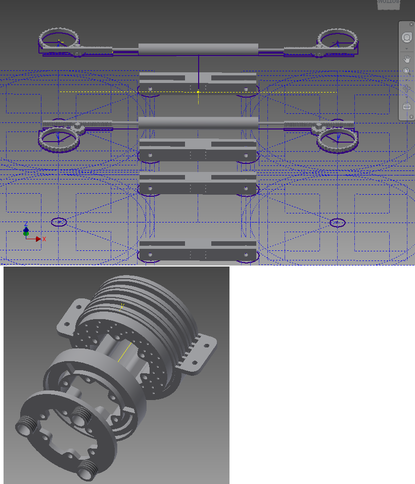

*frowns* the hard drive went, and took all the previous files i had for the SSTT with it. along with majority of all my other personal documents and notes.

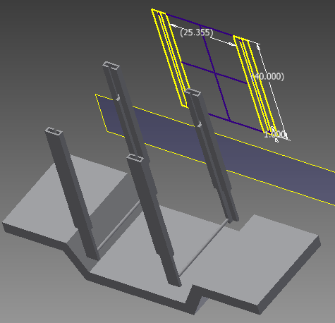

autodesk inventor pro 2013. license came up as being activated to many times (the key that is). and going through emails with autodesk to hopefully get it all straightened out. till then on a 30 day trail thing.
the day after, Hard drive went, got a call for a trail for a electric magnetic software. that works with autodesk. will need to get wheels rolling with that, once autodesk license gets worked out.
with old gone, might as well start from scratch. from ground up one more time. *nothing new there*.

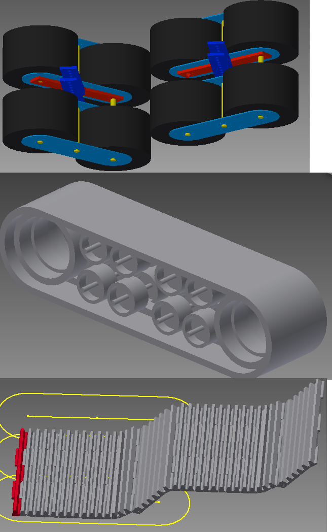

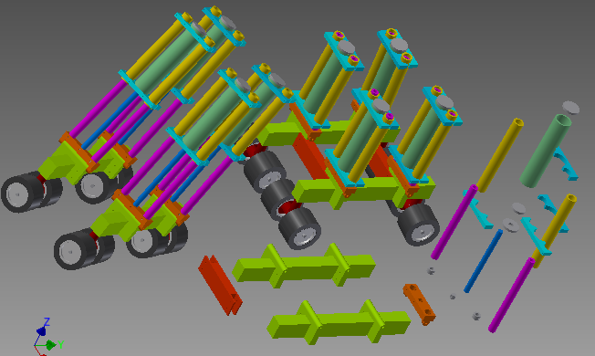

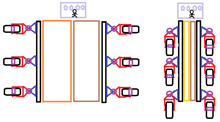

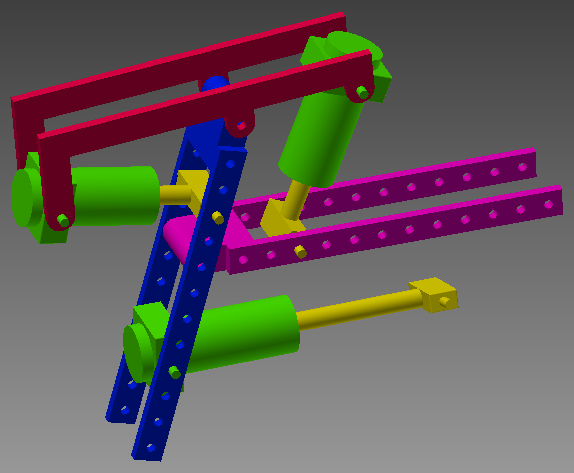

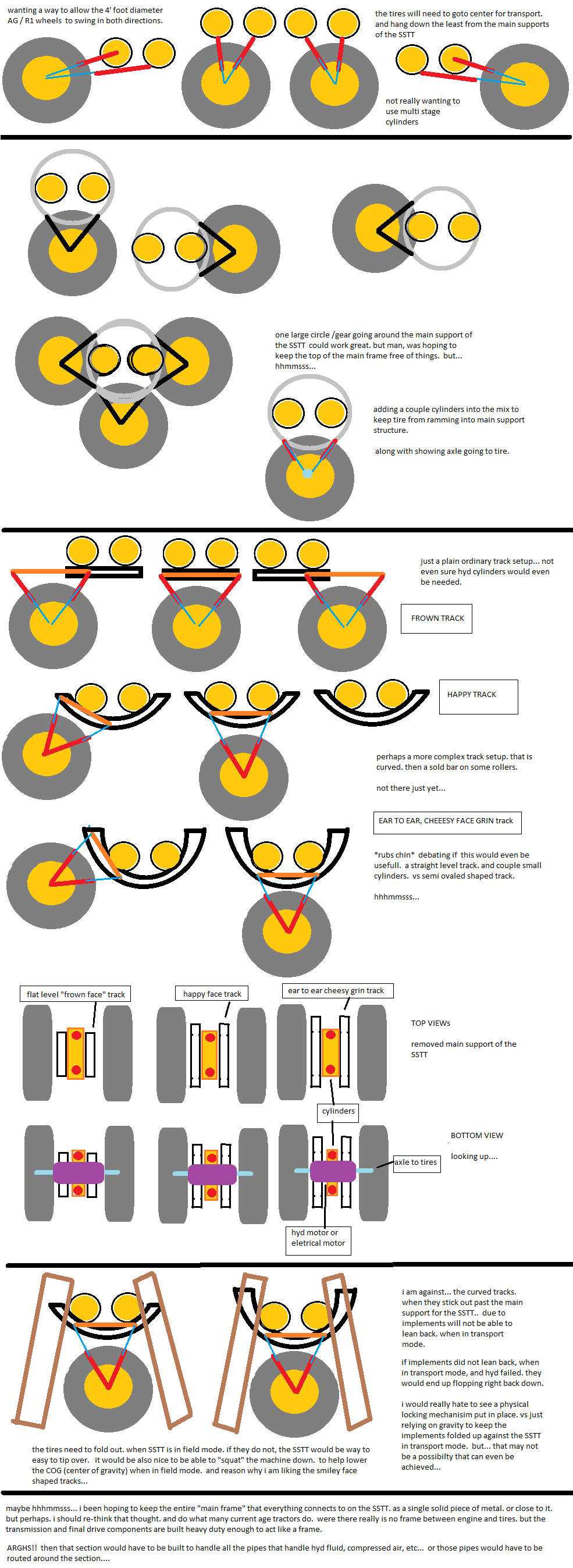

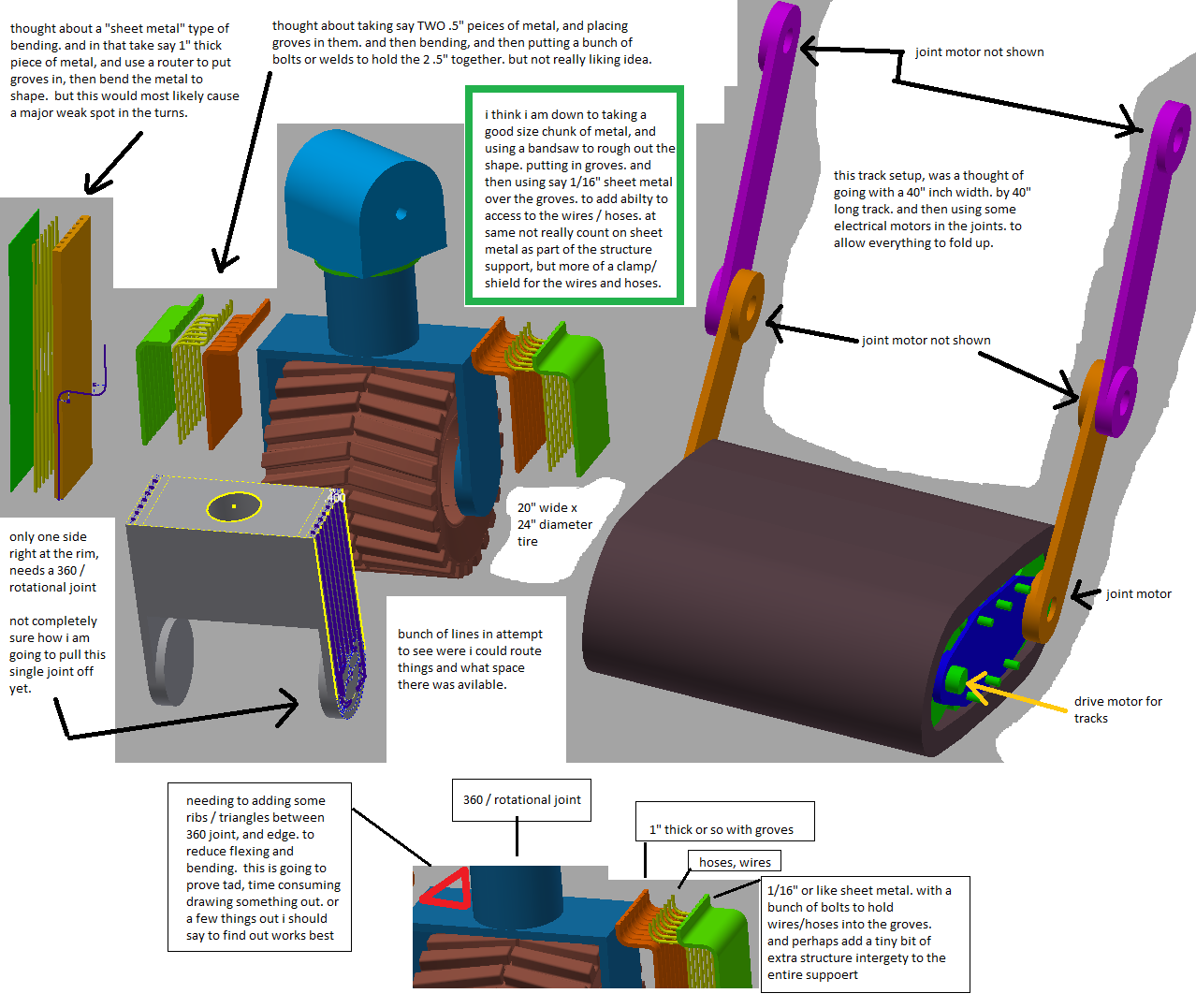

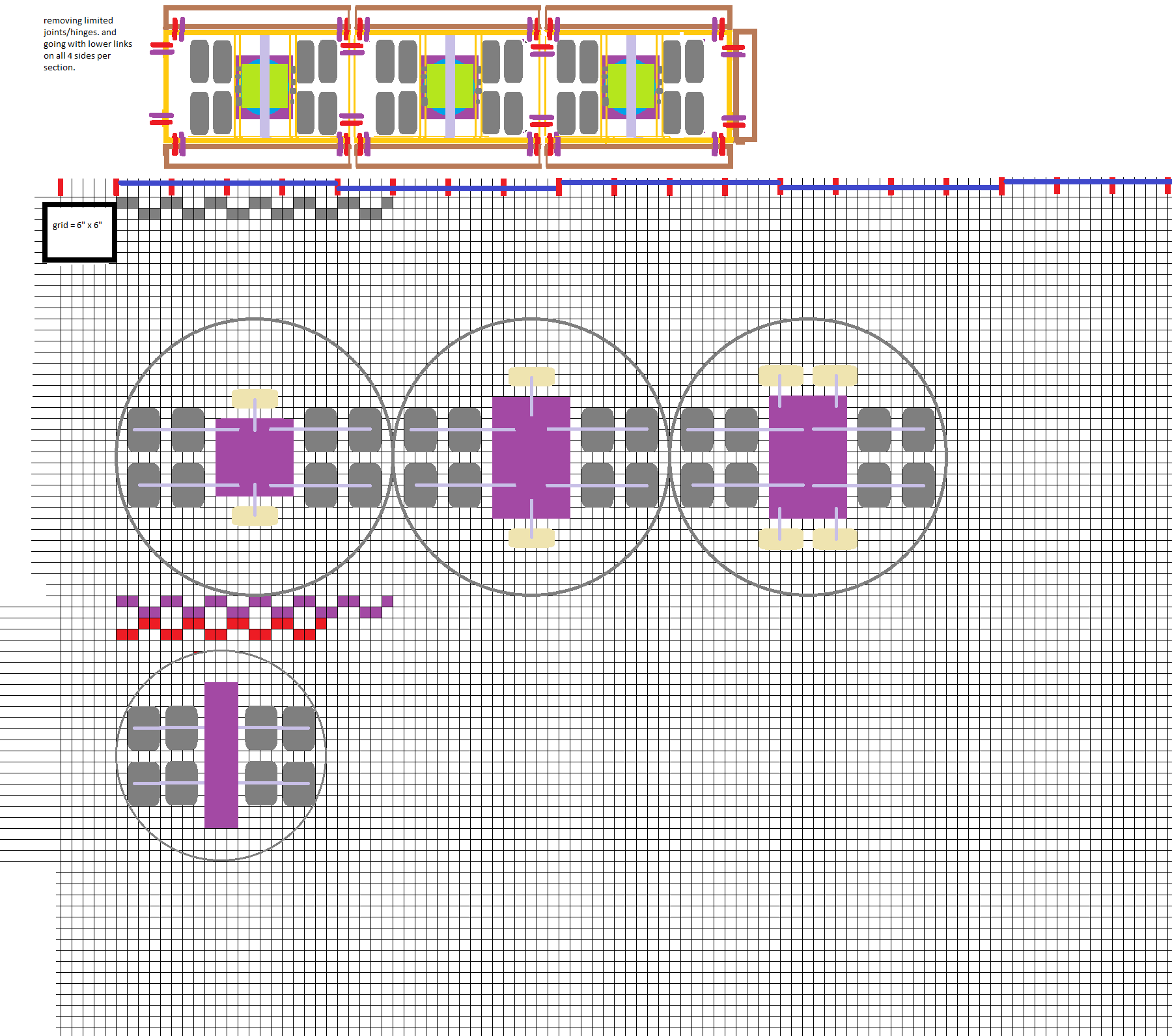

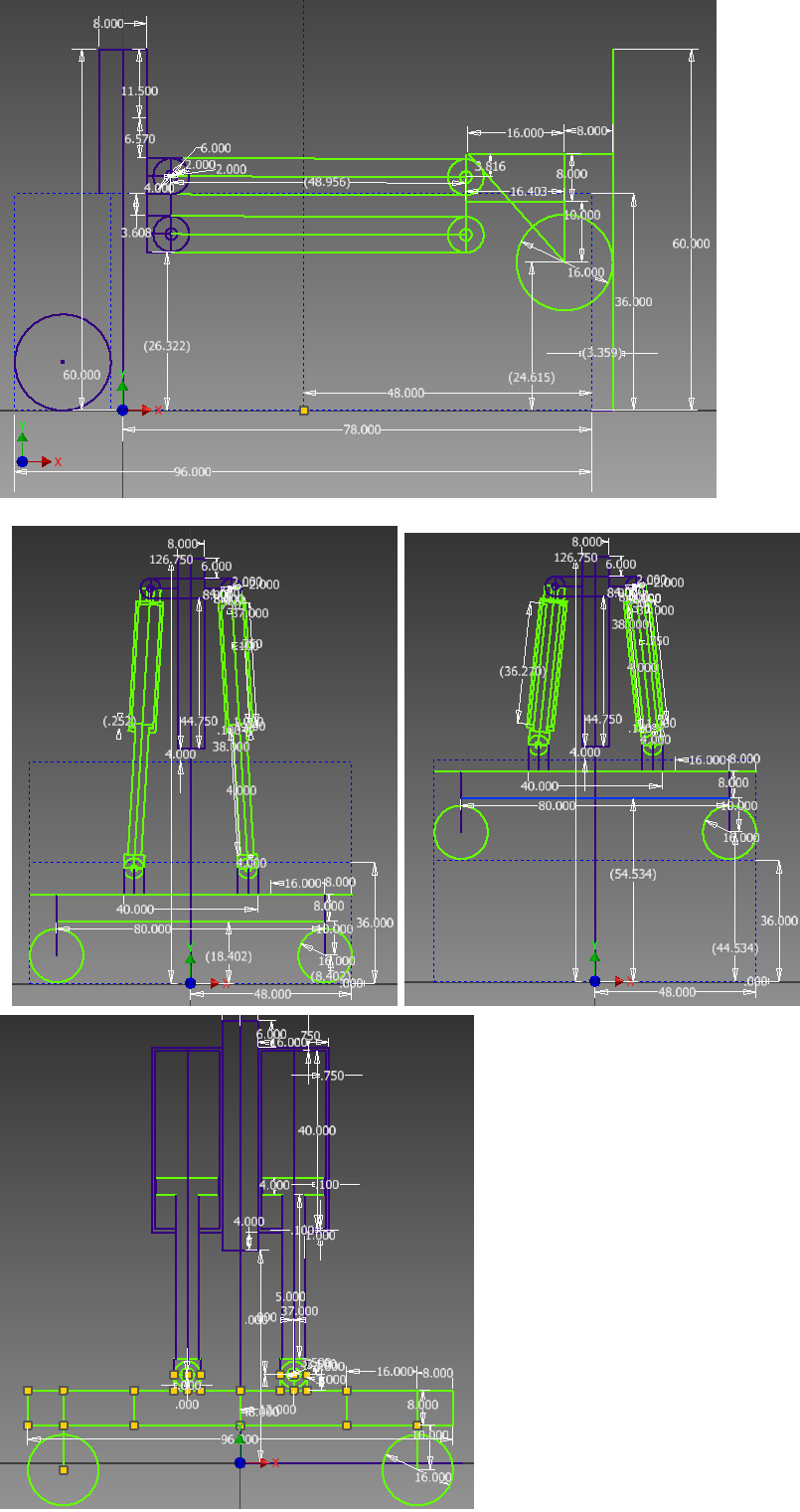

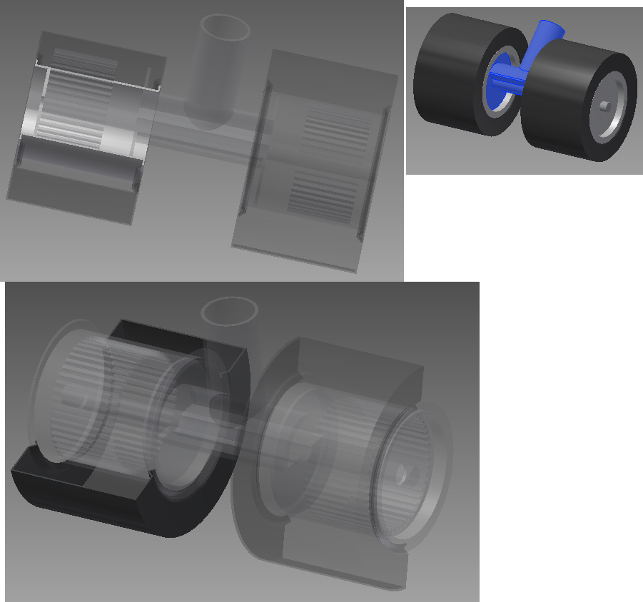

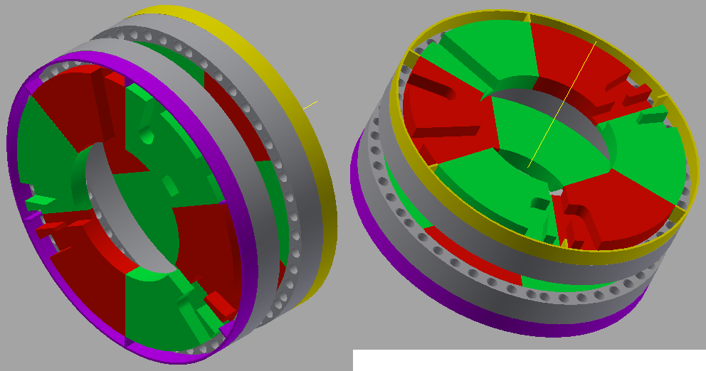

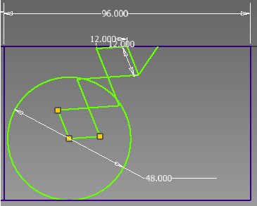

with "ken" recent posts to thread, and the nasa spider looking rovor. been quickly sketching things out. and trying to get my mind around it all once again. hopefully all will go well, and get some quick sketch models up and going over the next or 2.
well i take that back, ended up with a old secondary LCD display, and tossed in another video card. to run dual monitors for computer. and i do believe, i am running into some video card driver conflicts. :(

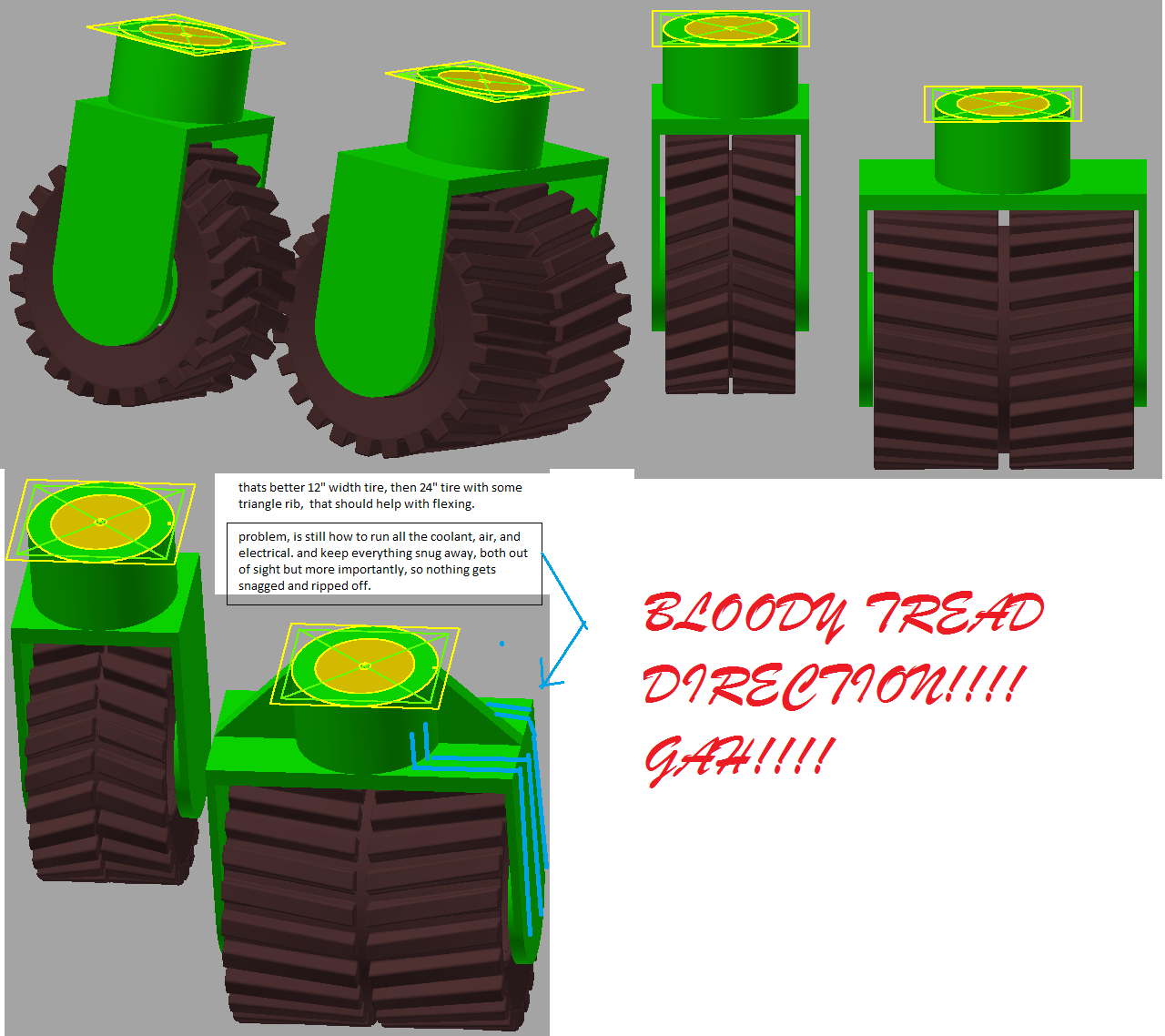

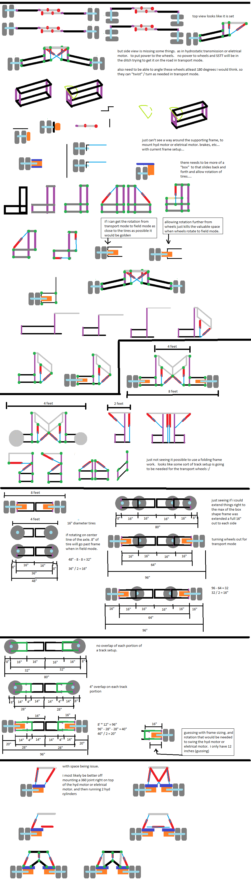

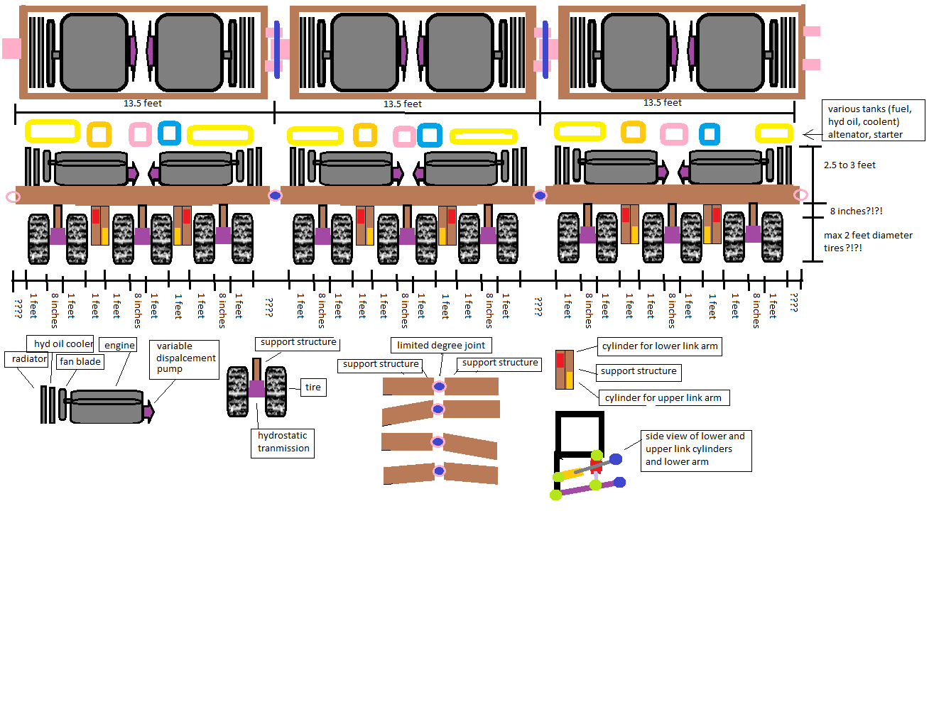

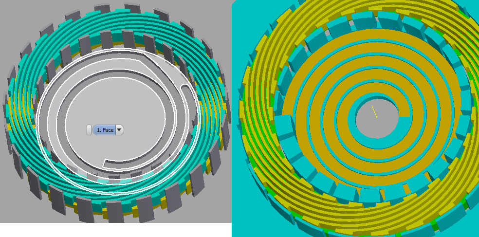

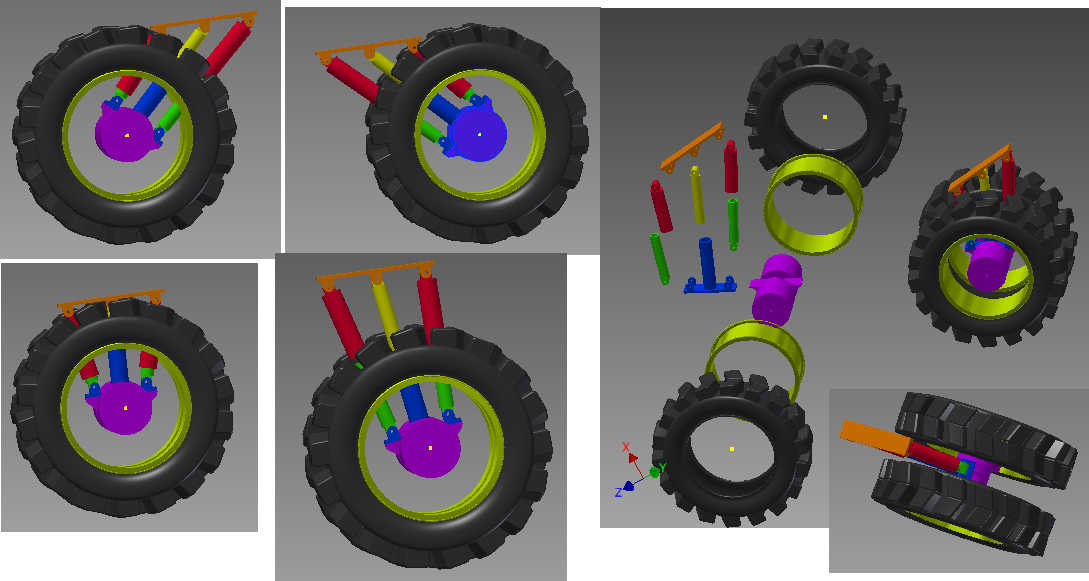

now one more redo, of them rovor wheels. will it be... electrical motor, with, water/anti freeze mix for cooling motor, and air for emergency brakes, and possibly adjust air pressure of tires???
and will i stay with pure electrical for rotation and linkages... do not know. kinda skiddish of electrical motor trying to hold a few thousand pounds. rotation is one thing. but holding everything, like hydrualic cylinders would....

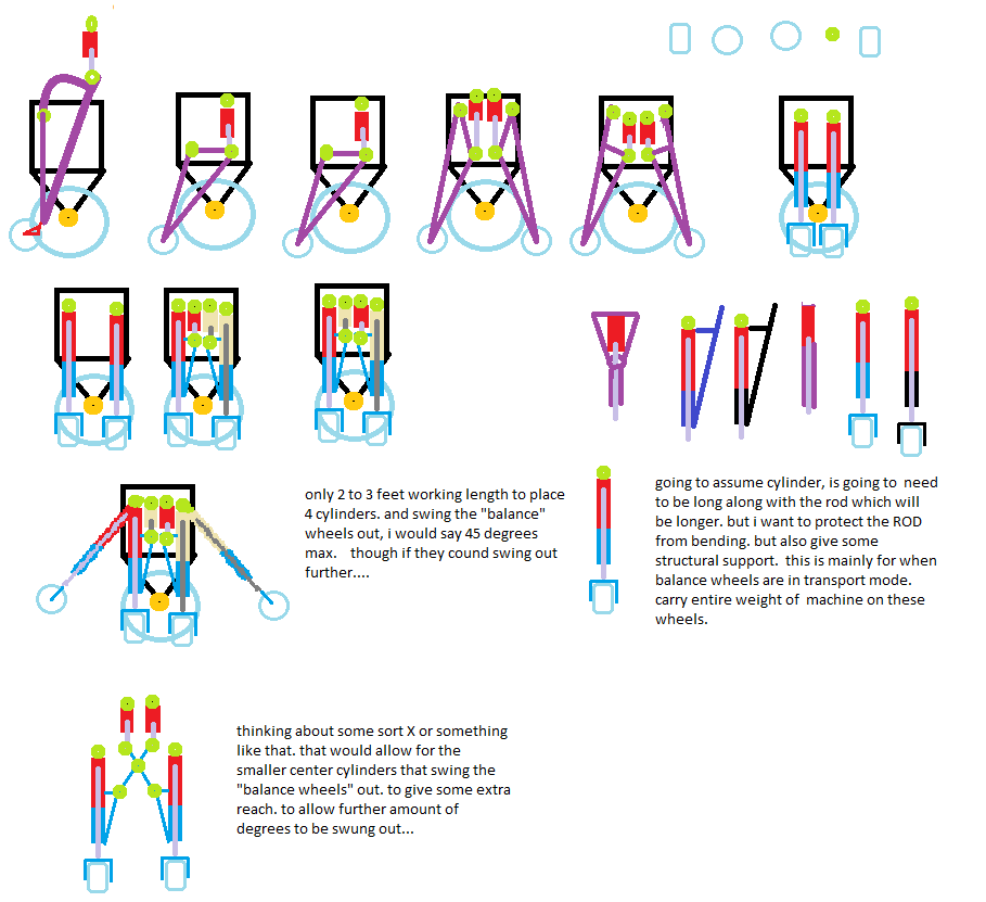

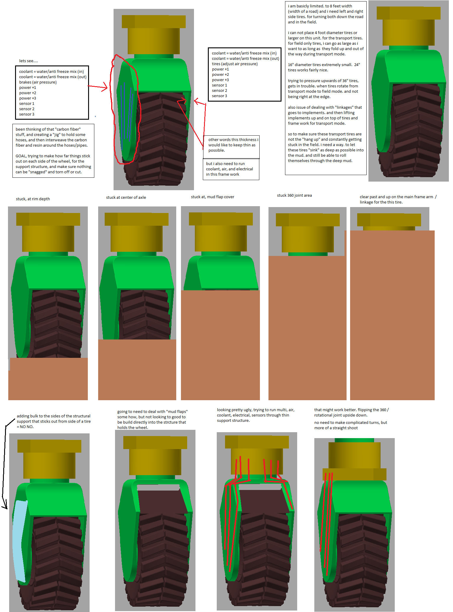

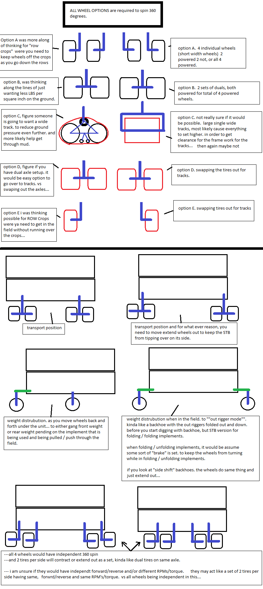

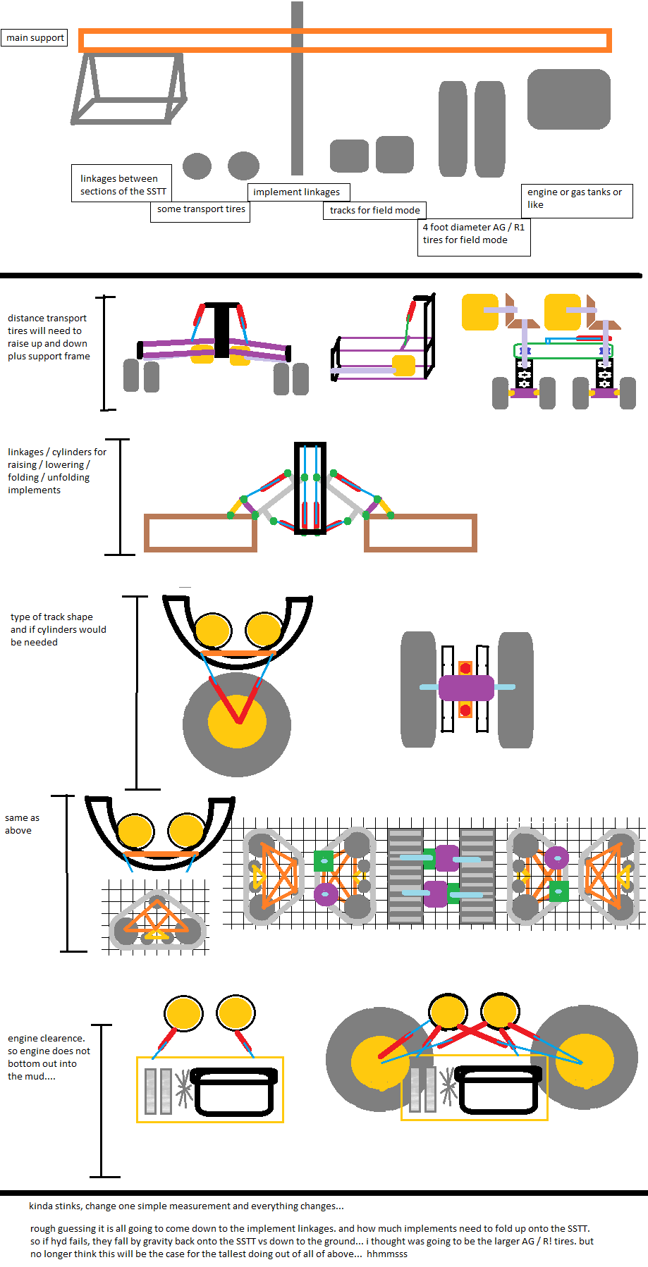

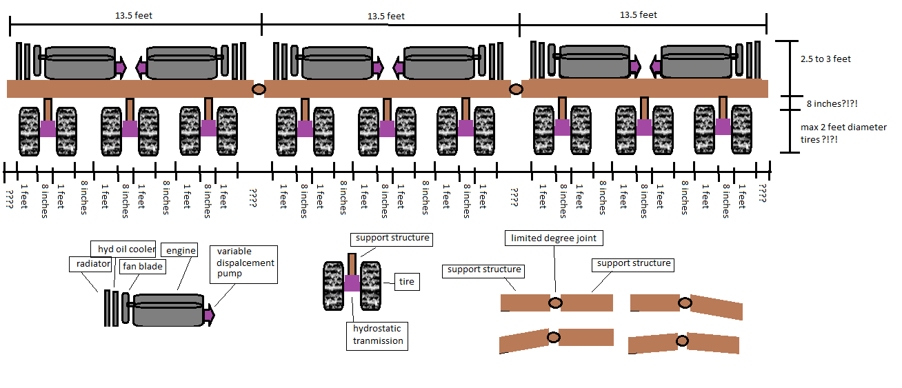

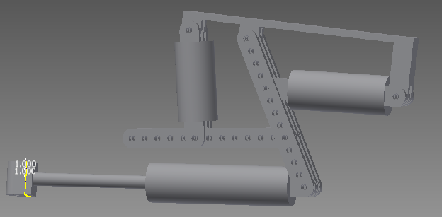

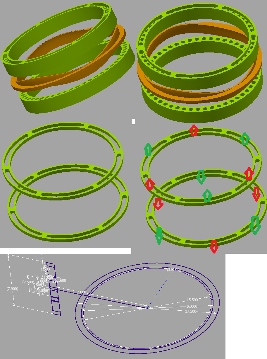

still trying to think "universal" tire direction. and be ok-dokey. but really. agriculture tire treads, are designed for a certain direction.
and i am still not to keen on the "nasa spider rover" vs a regular caster wheel design setup. that has the 360 / rotational joint off set from center axle. the only thing holding me back. is the extra "rotational" space that a caster wheel structure setup would take up.
*keeps looking back at the nasa rover" man those extra linkages in the legs would be really nice and solve a lot of problems.

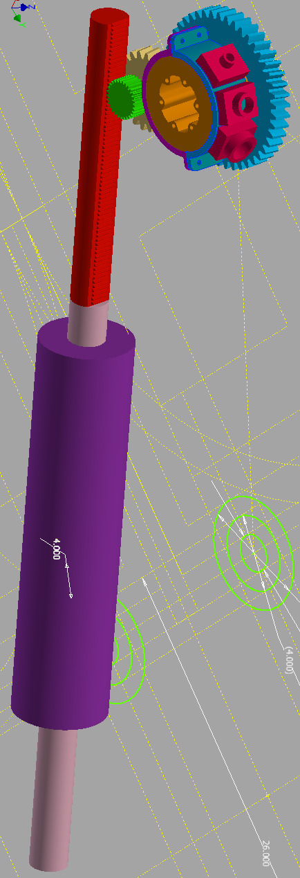

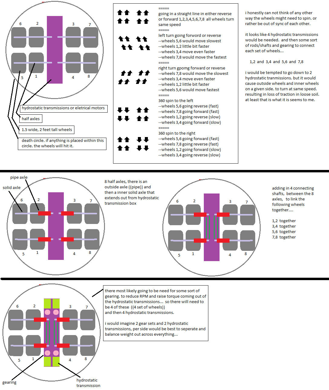

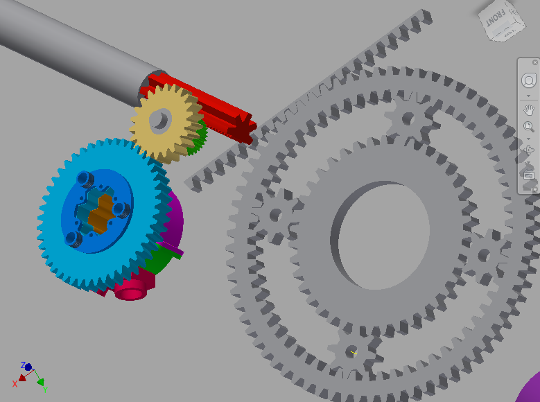

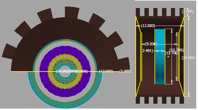

GAH, electrical motor instead of hydraulic cylinders. it is like, i can not even thinking electrical motors for joints.
BINGO!!!!. maybe, just maybe. ok, ya.... that might just work. some planetary gear sets most like a couple of them, to reduce say 3000RPM's with little torque, and convert it all to extremely low RPM's as in counting .1 to .00000001 of a degree of rotation. BAH. that might give me torque, but holding that torque and degree of rotation *grumbles* let alone the ratio conversion. ggggrrr. well DUH!! wet brake discs. errr acting like a clutch. that might work out nicely.
turn on motor, let it build up the torque, and then dis-engage the clutch errr brake, rotate to wanted degree, re-engage clutch errr brake, turn off motor. will already be running coolant lines and electrical lines right next or through the joint. errrr coolant lines through the joint will be needed. stinking explosion proof = fully enclosed motor. to reduce chance of any chance of a spark. = no way to cool motor. with exception of directly coolant. and a joint may be working itself non stop in a field.
seriously this might work. same brakes (take your pick of type of brakes) holds huge amount of force, with very little effort.
the problem, is the actual electrical motor in the joint. *ouch* enough, force, i guess torque, would need to be had. to fully lift, i guess at max, 1/2 to 3/4 the entire weight of the SSTT. ok maybe 1/4 the weight, if acting with another wheel and joint combo set.
besides above. i think trying to fold a wheel up into the support arms, like that nasa spider rover, is asking way to much, nasa needed tight small package, to get it up into space. agricultral tractor, still needs tight space, but more importantly needs good traction. meaning wider width tires. making things most likely unfeasible to fold tires up inside the linkages / arms. on other hand, if going with eletrical motors in the joints, having linkages folding up inside of each other, might be a high possibility.
regular electrical actuators, i just do not see them happening. just not enough thread contact. and then a chance of stripping all the threads....and all it would take is one thread, out of shape, take out the entire actuator.
to note it, eletrical actuator, looking like like a hydraulic cylinder, that has a threaded rod inside of it. and a motor spines a nut that causes threaded rod to extend/contract.

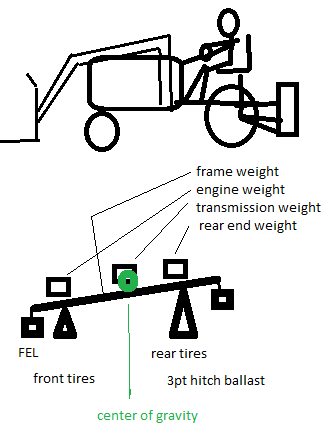

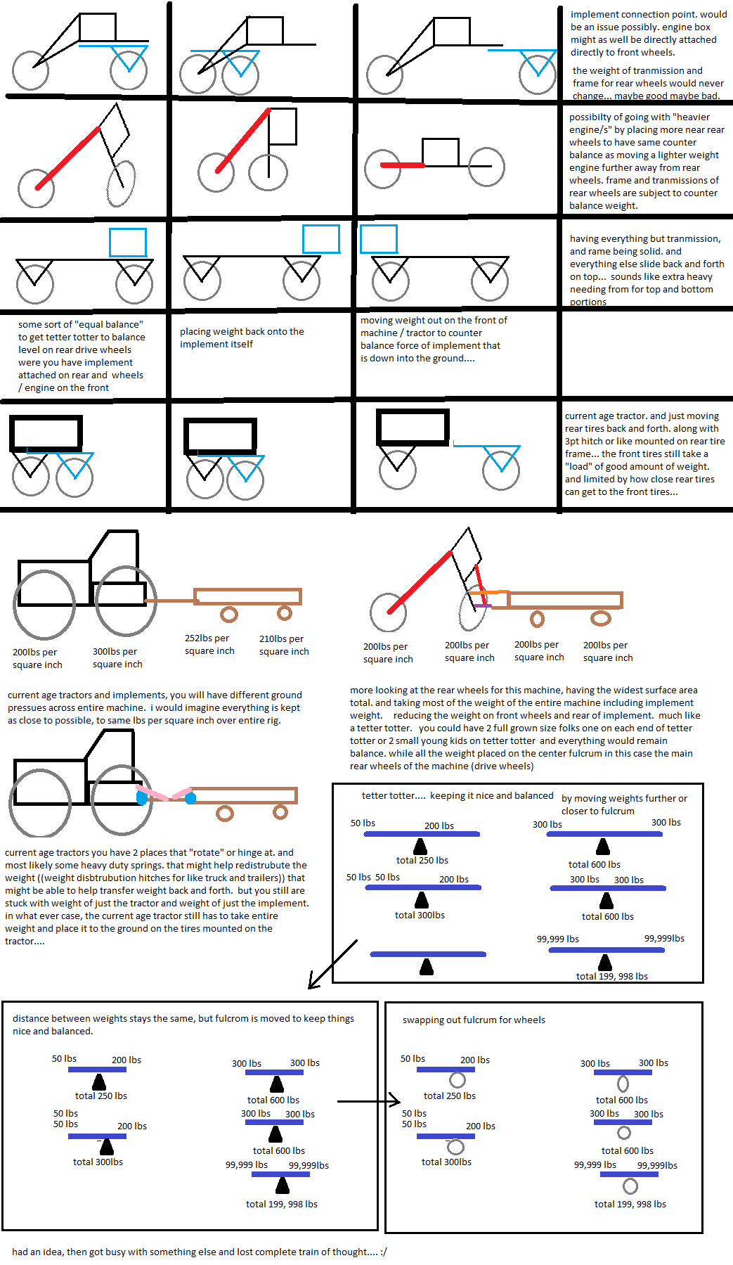

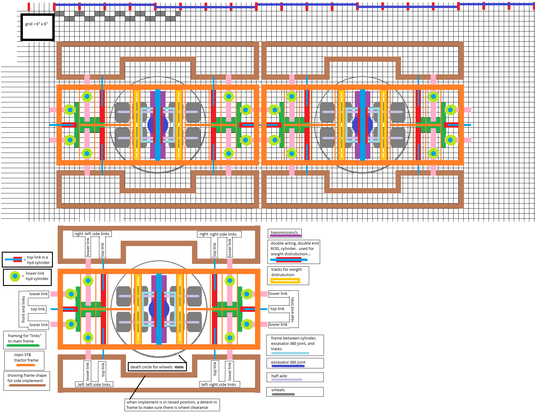

ok weight about the "weight" in a regular SCUT / CUT / Utilty class size tractor. that has a FEL and/or backhoe. hydrualic cylinders places weight in certain spot on the tractor. if going with something like the nasa spider rover, that weight would be moved a huge amount of weight either in front (for fel) or in rear (for backhoe) destroying center of gravity, and needing a bunch more ballast.
for the SSTT on other hand. how much effect would it have on weight distribution?

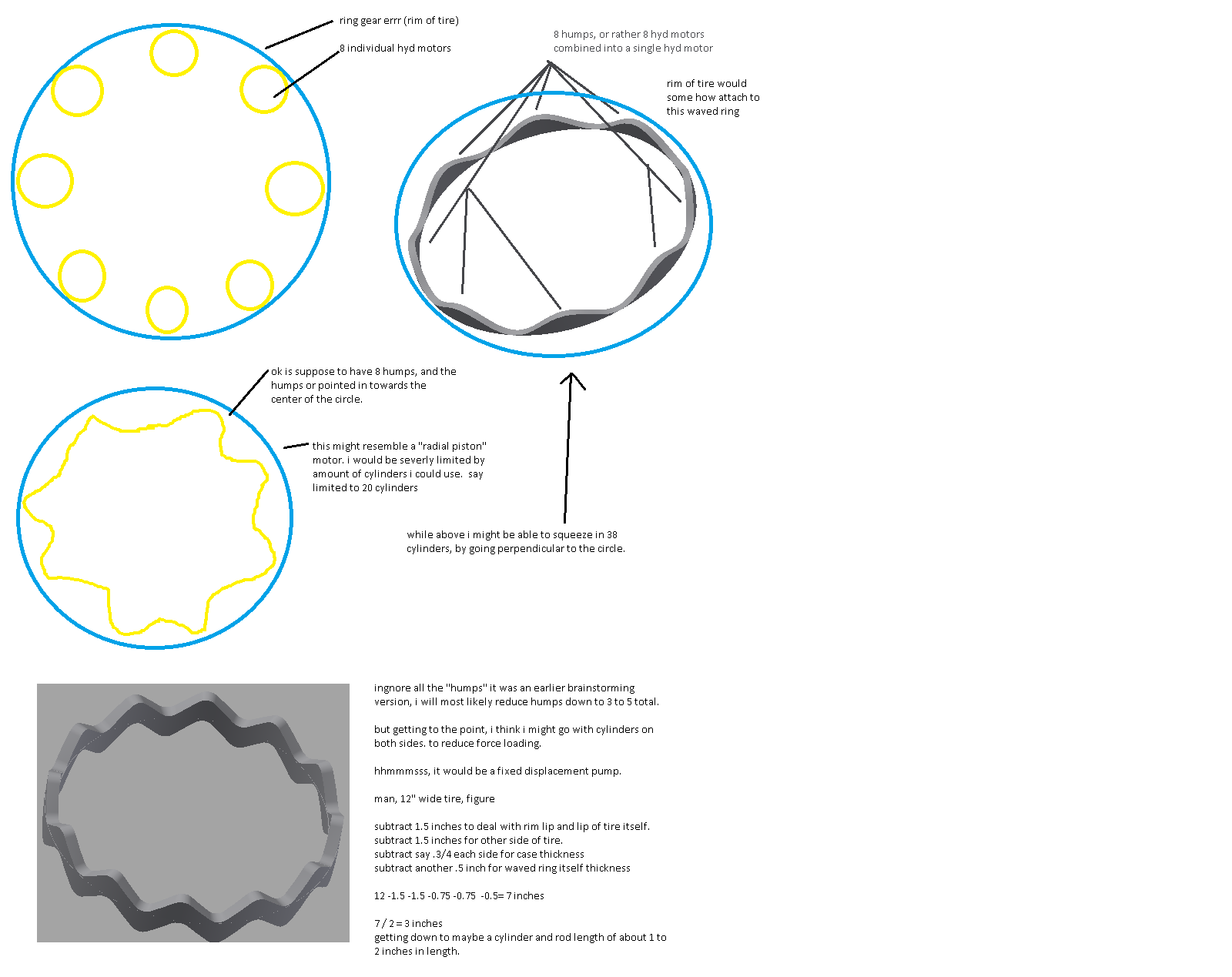

placing electrical motors directly in the rims of all the tires. would be like filling the tires with a fluid. but now i am not using a hyd cylinder, that extends the entire length of a linkage almost. and in that spreads the weight out across the linkage. but weight is directly in the "pin" for lack or better term were the joint pivots.
with hydraulic cylinder, the cylinder and rod itself provides structure, to physically withstand forces being placed on things. but now...
drawing a complete blank, not even a chance for a clue or an idea to brain storm on.

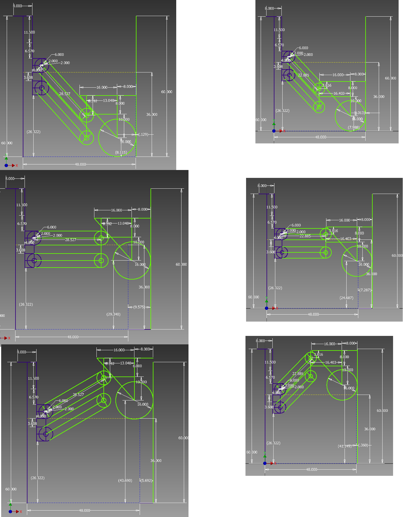

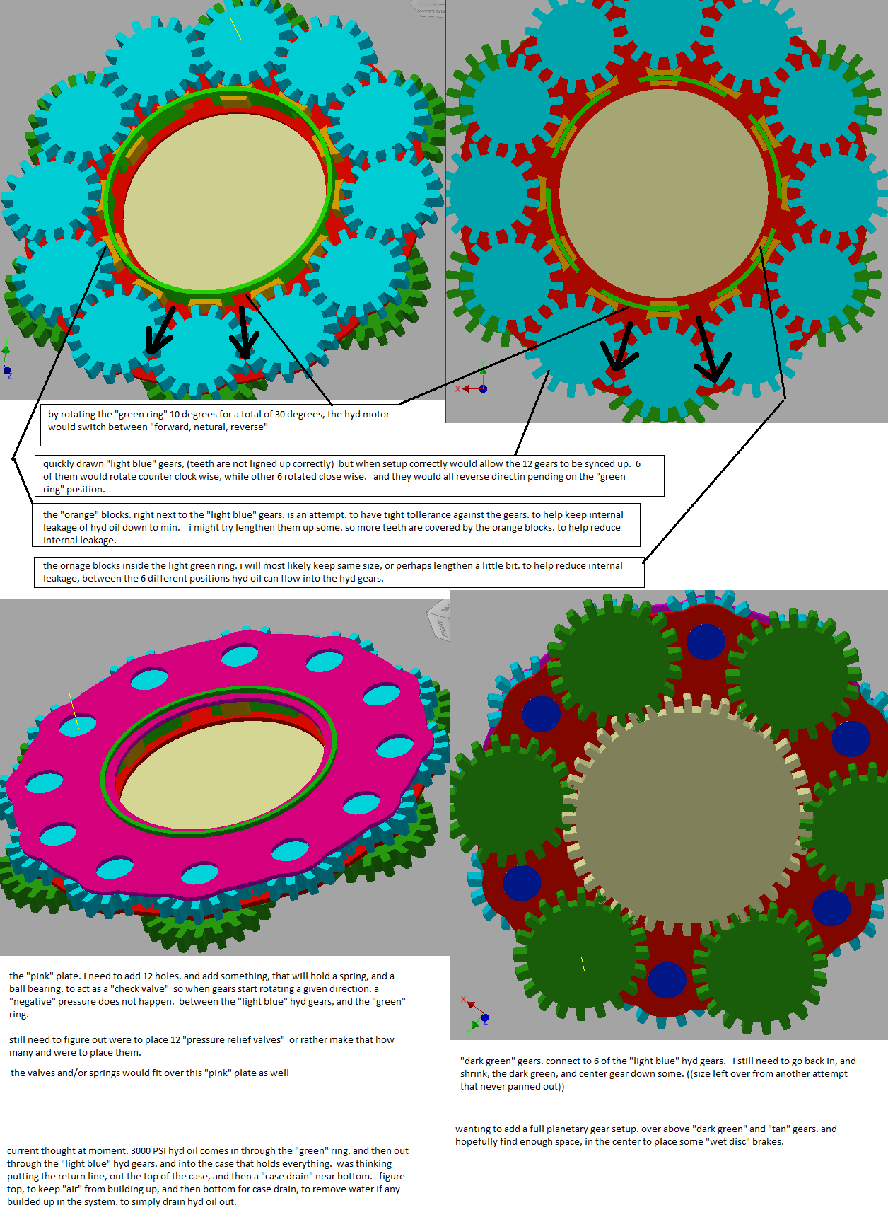

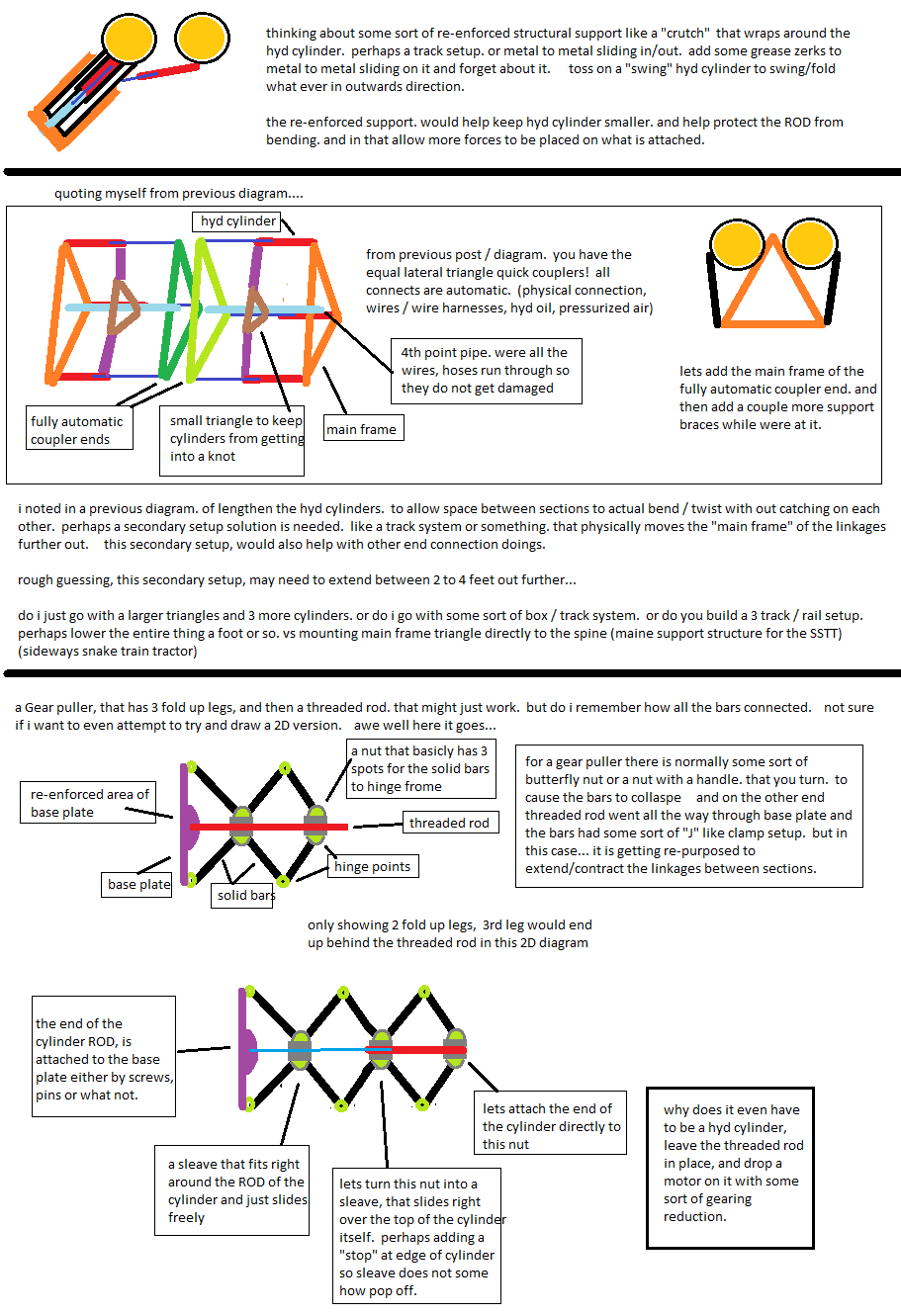

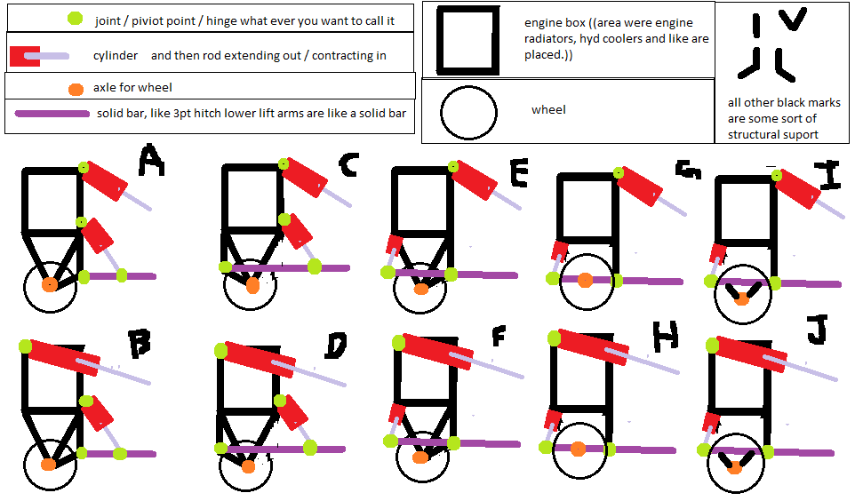

ok getting back to the joint motors. vs hydraulic cylinders for linkages.

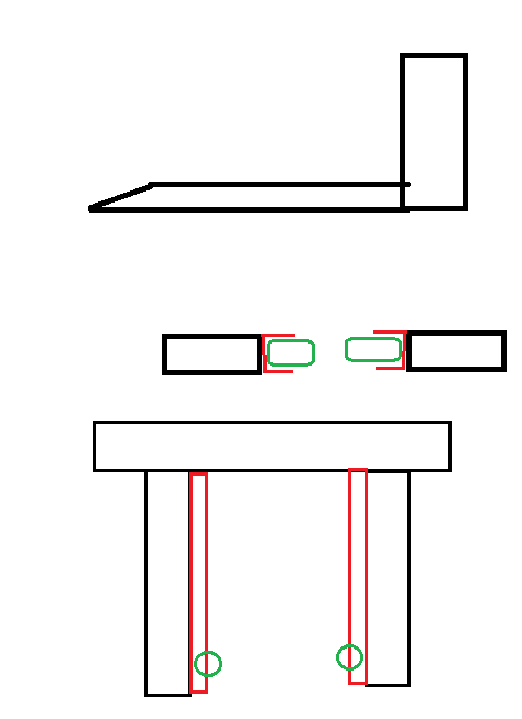

say a joint motor fails, and welds itself completely up. going to need to be away to easily remove motor for replacement, but also possibly get the linkages out to the wheel folded back up and locked into a position.
everyone is use to the common, bolt, flat washer, lock washers, and like and then a nut. but thinking of a gear shape washer. or perhaps eewwww.. forgot, i am looking.
ah ok, that might work. instead of a typical pin / bolt you might find on a FEL (front end loader) on a tractor. the pin would turn into an axle and a gear. the gear would lock into onside of the linkages. ya. remove pin, removes the gear. and frees everything up. use some chain binders to get things were needed and wiggle the gear pin back into place. might not be perfect but, enough to limp home and to get repaired perhaps.

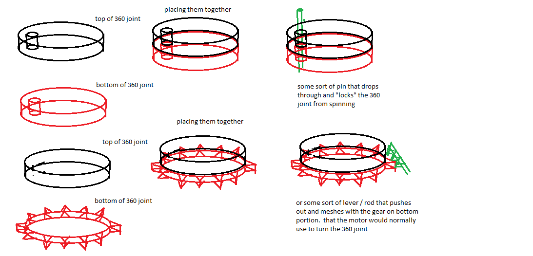

electrical motor, transmission, brakes, water/anti freeze cooled, with a geared washer/bolt/axle. instead of a hydraulic cylinder and generic set of pins. why not nothing to loose at this point.

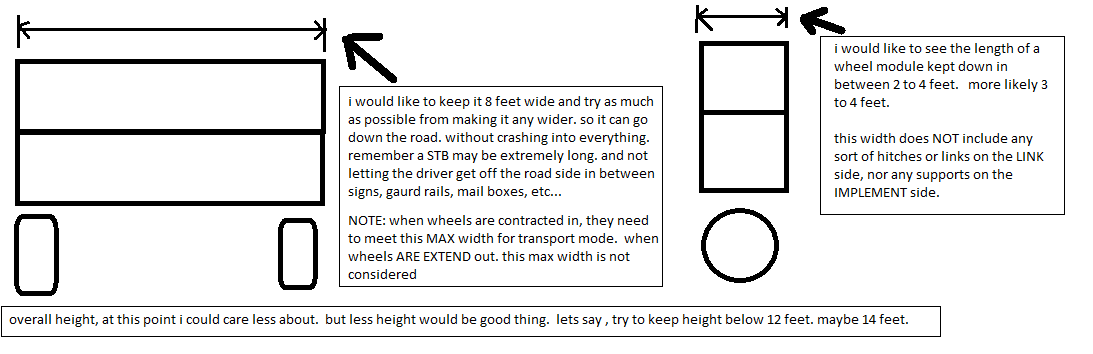

ok before i was going with 24" diameter tire, with 12" width, and now more looking at 24" diameter tire with a 24" width. if i stay with ability to change tire pressure, thinking about installing 2 or more tubes per tire. to reduce flexing of the tire across the width of the tire as it rolls across the ground.

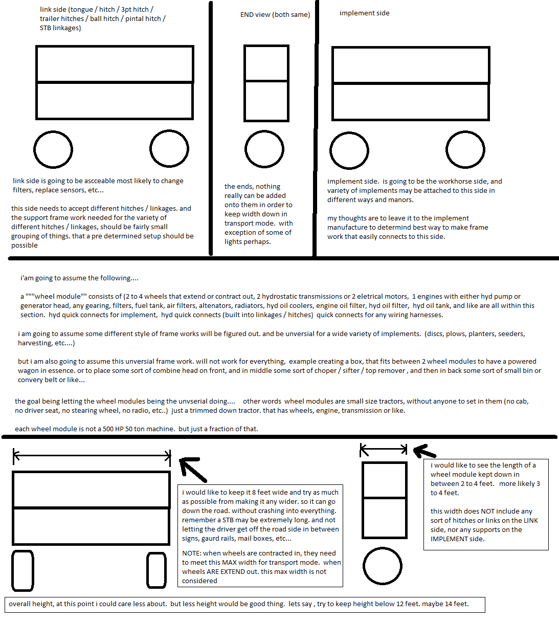

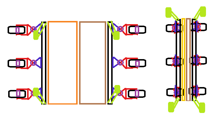

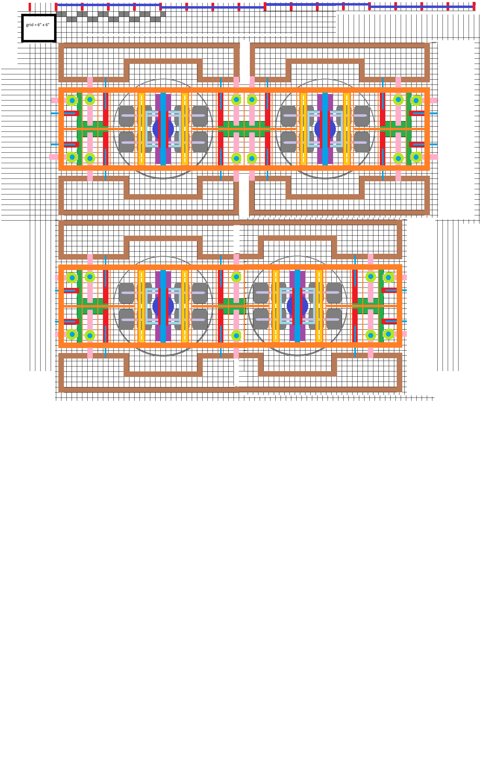

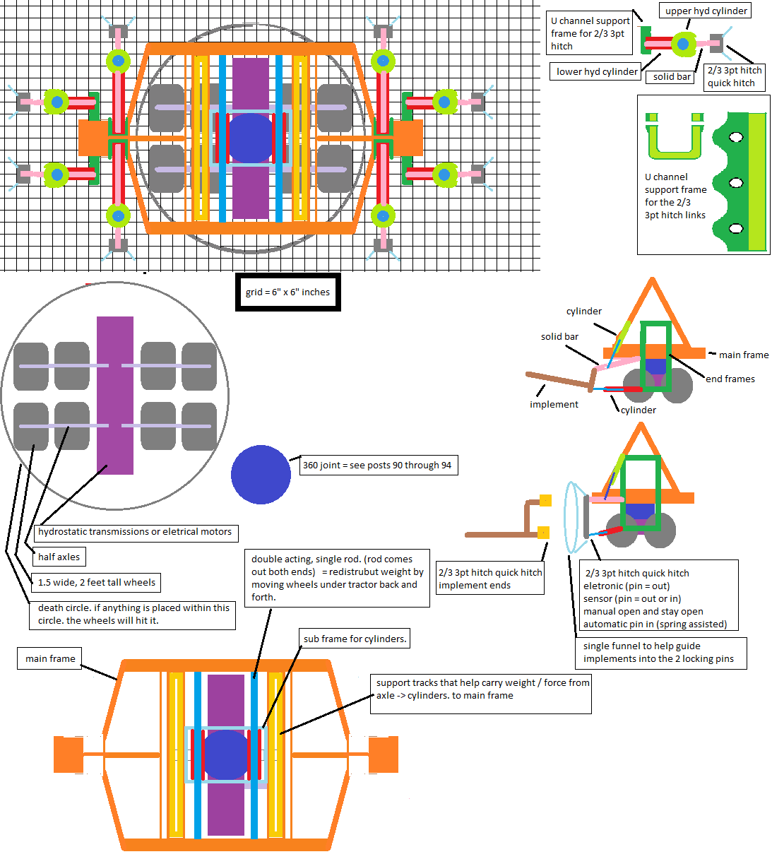

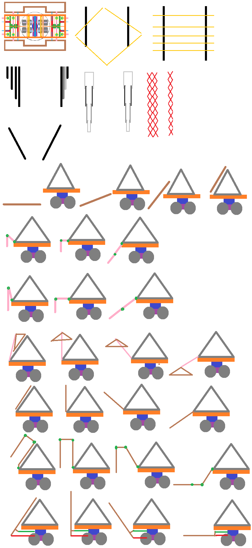

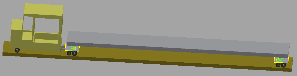

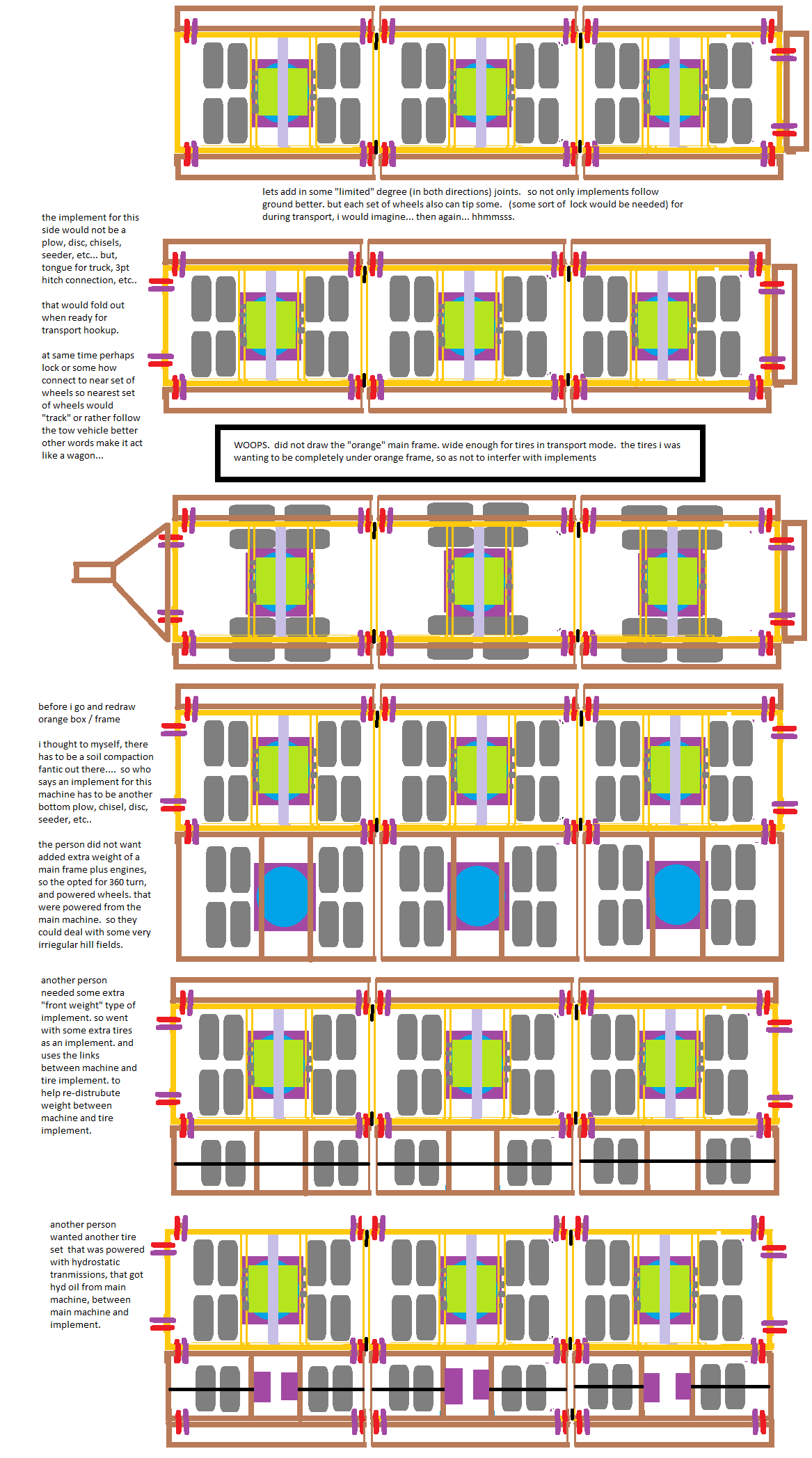

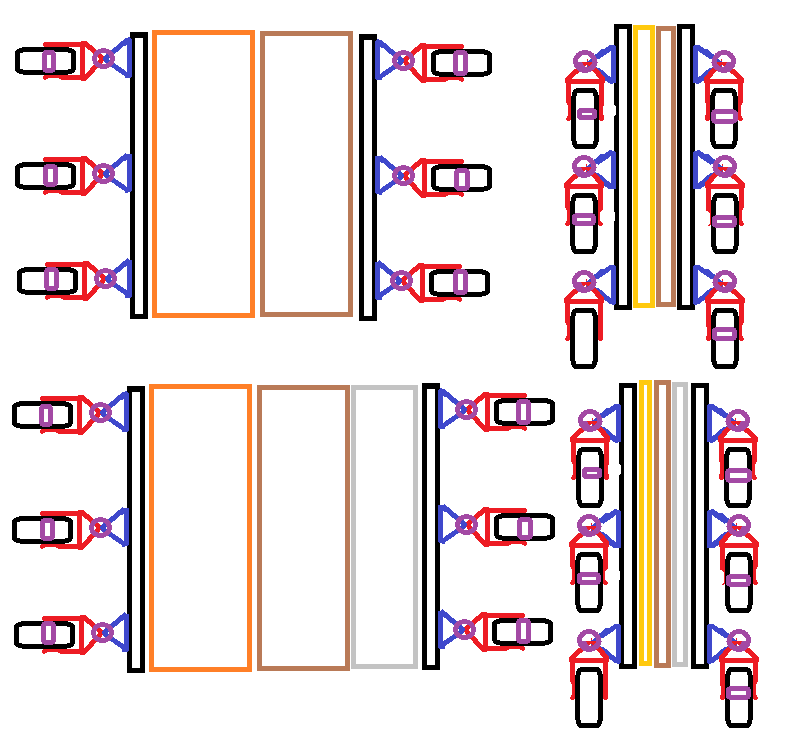

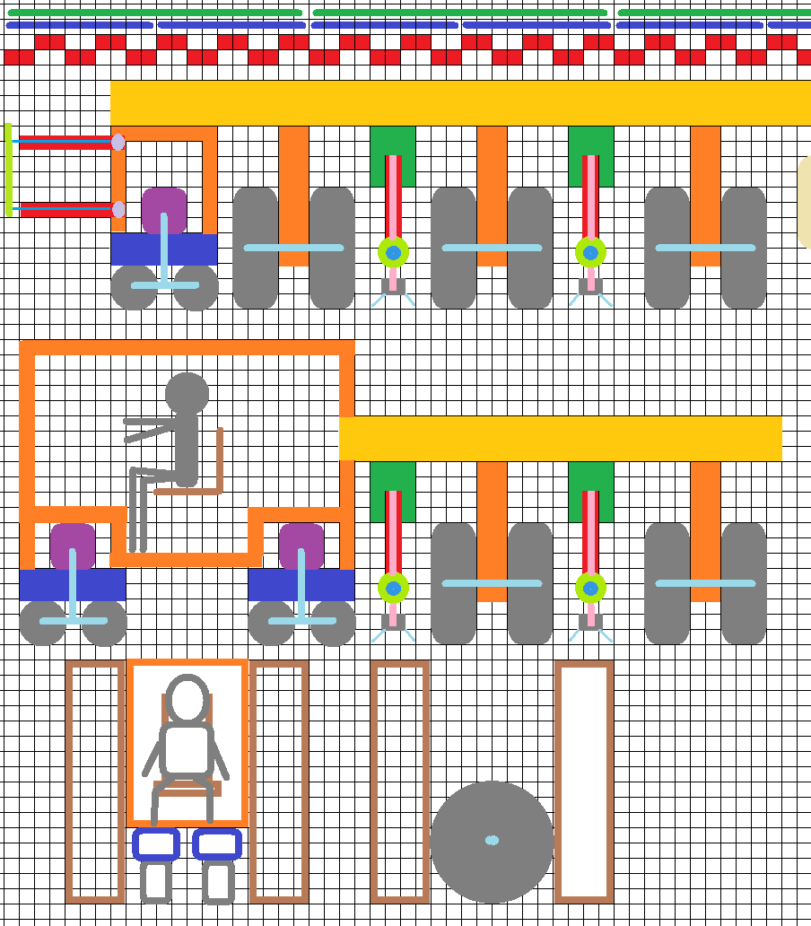

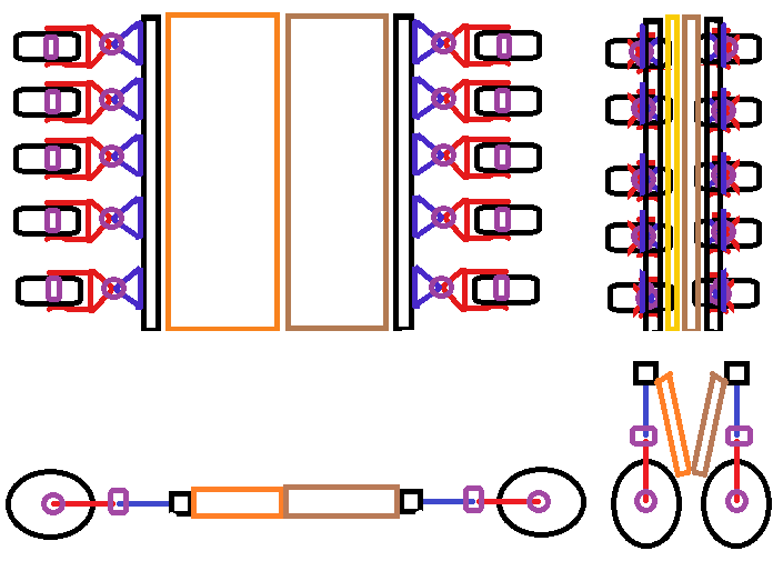

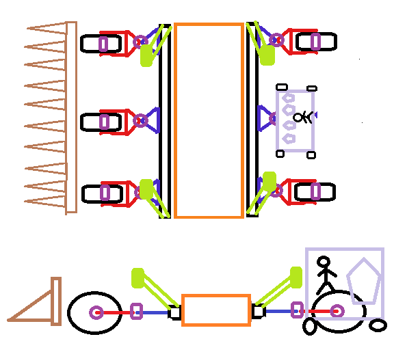

semi truck, with sleeper area, turned into command center.
what would normally be 8 wheels on rear of a semi truck trailer. is turned into a glorified RC (remote control) car on steroids. that attaches / detaches. to one end of the SSTT for transportation.
(not sure of actual name) semi trucks and trailers use for them to connect together. but same idea. but in this case, there is a converter, between the normal pin a semi trailer would have. and the connection to the SSTT.
if i stay with dolly for rear wheels type of thing. i am going to need a 3 point connection both at rear of semi truck (the converter) and then on the dolly itself. 3 point connection in shape of a triangle. so i can ensure, everything holes nice and tight, in a roll over, or hills, or say hitting a guard rail, mail box, etc... and not rip the dolly wheels out. think 3 point connection much like a 3pt hitch on rear of a tractor, but turn flat. i think.
SSTT rolls up, and then sets down, and 3 large bolts or pins come down on each end of the SSTT and makes physical lock on rear of semi truck, and then on dolly wheels.
i have been debating over a generic, frame between rear of semi truck and dolly wheels. and turn everything into an actual trailer. if i did this, i could send power through the frame to the rear dolly wheels. and reduce a bunch of extra complicated connections. for air for rear brake tires, electrical, along with sensors. the frame might also serve as a backup. in case something on the SSTT came loose and started to dangle down. on to the road. the frame might stop that.
but perhaps a hybrid setup.
a very cheap flimsy, frame between rear of truck to dolly wheels. and still go with 3 point connection. or something. so SSTT can quickly and securly fasten itself down. and act like part of the support structure when SSTT is on the trailer. that might work out better.
perhaps. all rear wheels to expand/contract with say a hydraulic cylinder or like. so distance between rear of semi truck, and dolly wheels can be any were from 0feet to 2 feet extra. to aid in getting SSTT all lined up.
other major issue. how to get SSTT to roll off a trailer. there was no main frame between semi truck connection and dolly wheels. the SSTT could just put its wheels down, and then lift right off of semi truck and dolly wheels. and SSTT could take off out into the field.
but with a frame. connecting semi truck connection to the dolly wheels. the SSTT would have to some how roll up on to some sort of ramps. or some how lift up one set of wheels a couple feet. roll part way on. then lift another set of wheels up on the trailer. kinda of a pain in the rear.
if dolly wheels were just that a remote control set of wheels. there would need to be batteries or a small generator and a battery, to make sure the dolly wheels could move when needed.
ok what about a frame that was hydrualic cylinder driven. that raised up and down. i mean there really would not be a whole lot of weight or stress being placed on this trailer frame. about all the frame would do. is when there is NO sstt on. is make sure the rear dolly wheels do not roll some place there not suppose to roll.
but then whole thing of trying to get wheels of SSTT from slipping and sliding, as they roll over a frame of trailer. it would be like taking any vehicle or tractor for that matter and trying to drive over a log or pipe.
then issue, of the trailer frame, getting bent up and twisted and everything else, not to mention the weight of SSTT being placed on the frame as it rolls over it. more so if frame is placed down on uneven ground, and ends up laying down on some large rock. i could see this frame bending all to heck. *frowns*
road side parking errr parking on and into the ditch along side of the road. dolly more likely tip over. if not frame between it and rear end of semi truck.
what if i just skipped the whole dolly idea. and just used the wheels on the SSTT furthest from semi truck rear end. to act as transport wheels. that would be the most ideal setup i suppose. and just accept the wear and tear of the wheels on the SSTT that are down during transport mode. while all other wheels are lifted up off the ground on the SSTT. that would give better ability for logistics and perhaps using a full sized pickup truck that is beefed up on shocks and rear axle. to transport the SSTT around, and just have the semi truck use as a command center. and ability to pull a SSTT around.
ya i like that idea, instead of turning SSTT into like a grain wagon. just turn the SSTT into a trailer for transport mode.

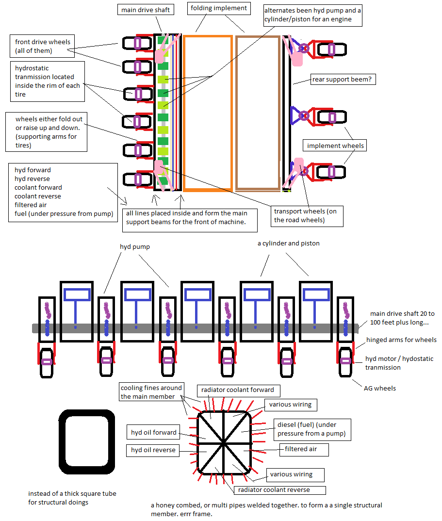

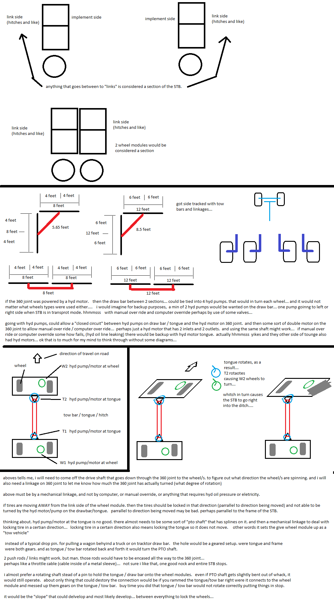

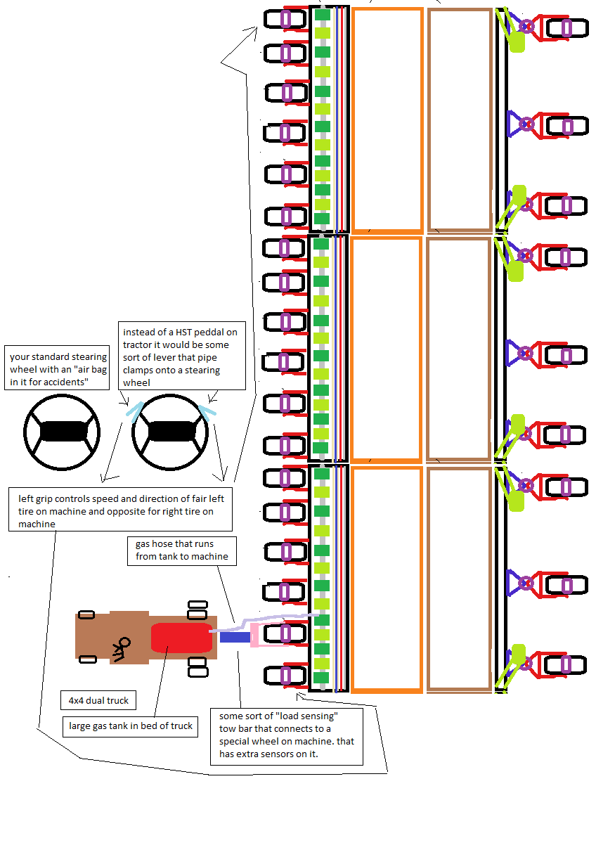

Ryan I was thinking you were planning on equipment large enough to pay the not using a tractor. But hauling on pick up ?
Go to a logging yard where the transport trucks are unloading trees/logs look at how when empty the truck locks the trailer brakes then back up jack-knifing the trailer frame until all is loaded on the truck. Saves wear on daul axles. less rubber on the road.
Elec. motors with dc voltage that is pulsed will rotate at full current and rpm is by frequency of pulse.
Also for breaks the pulse is reversed. when need to lock the brakes use a magnetic clutch no voltage full brakes.

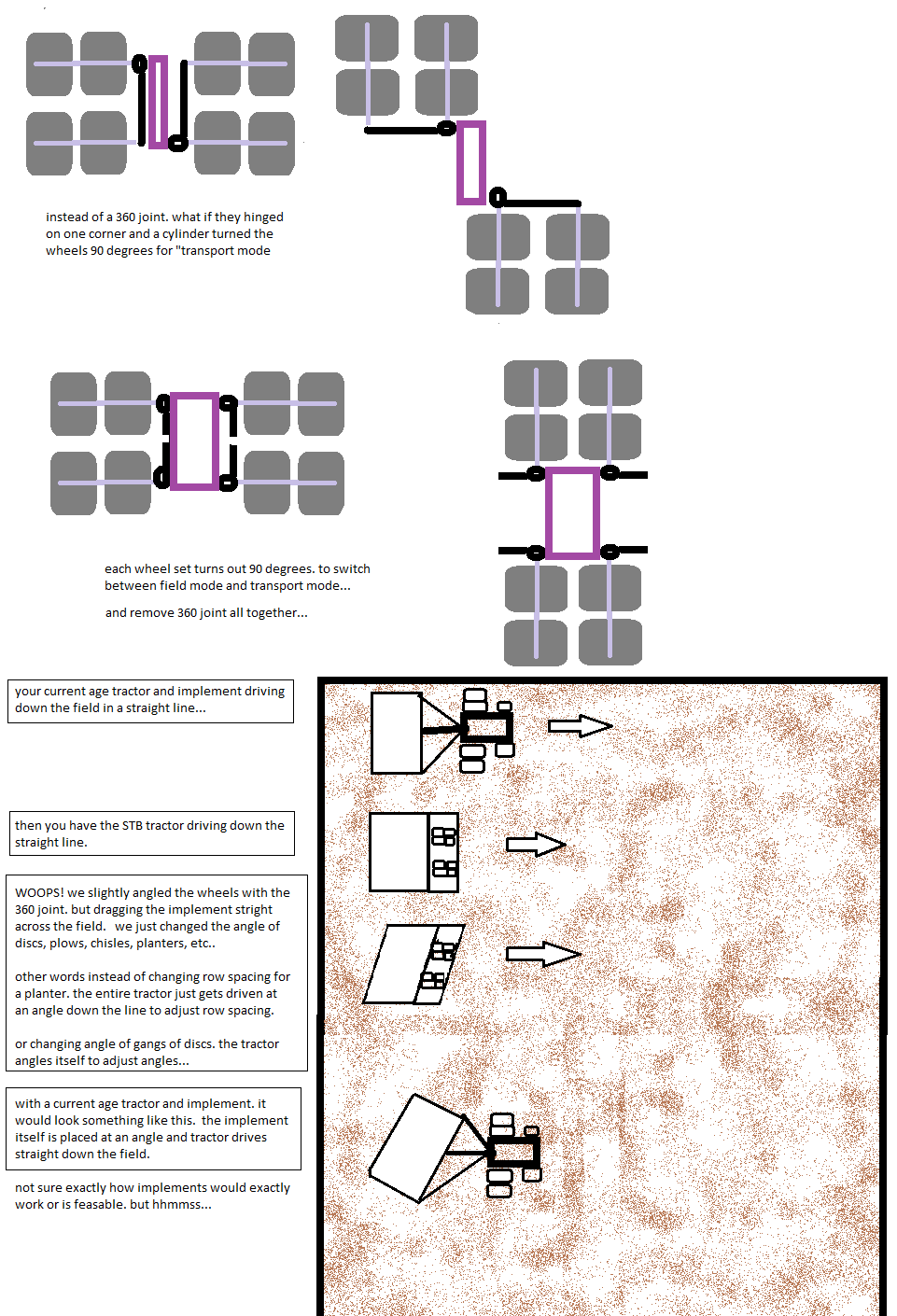

ya, i know ya confused and i am sure a good amount of other folks, due to i am confusing my own self. i really need to do a "RECAP" and bring everything together. vs all this random almost jumping around, and working the little things out here and there. the problem is, i am not fully sure what i am wanting. there is not some "huge major goal" of how i would like the SSTT to work or look or operate. ya i do have an idea. but i am not married / sold on the idea.
post 279 this should make, so it is about time for a good recap i noted in a previous post.
until then.....

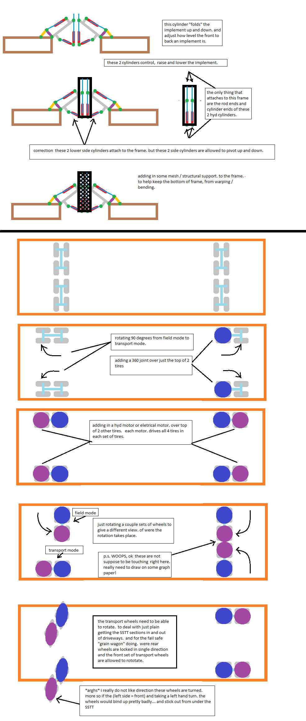

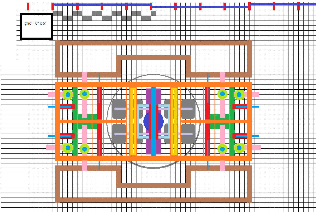

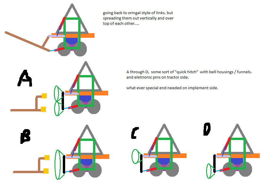

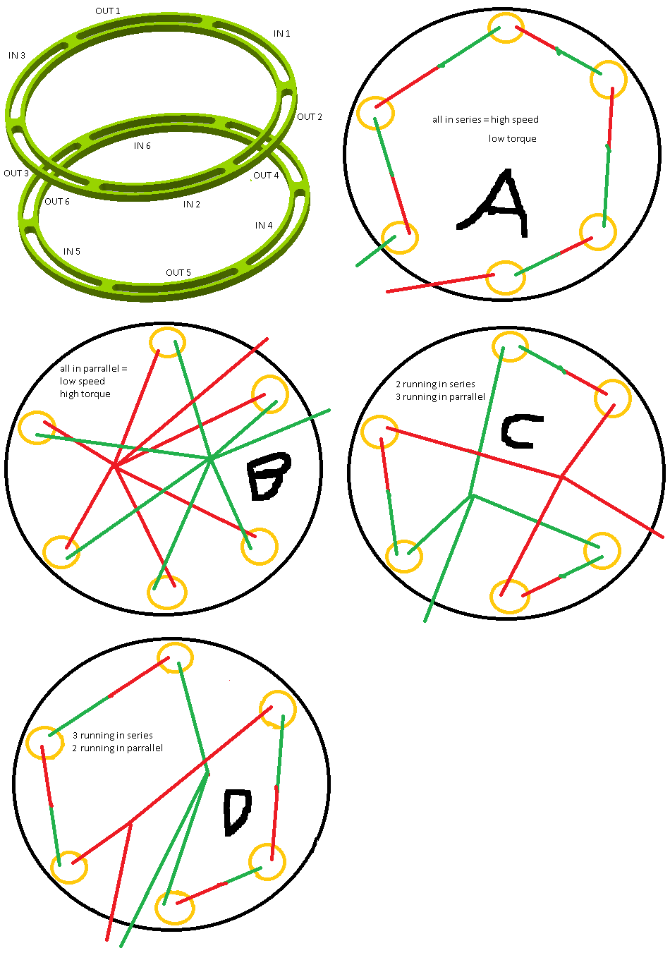

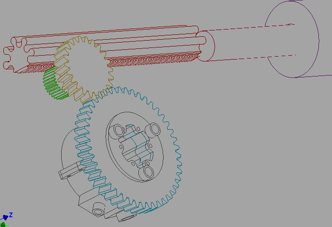

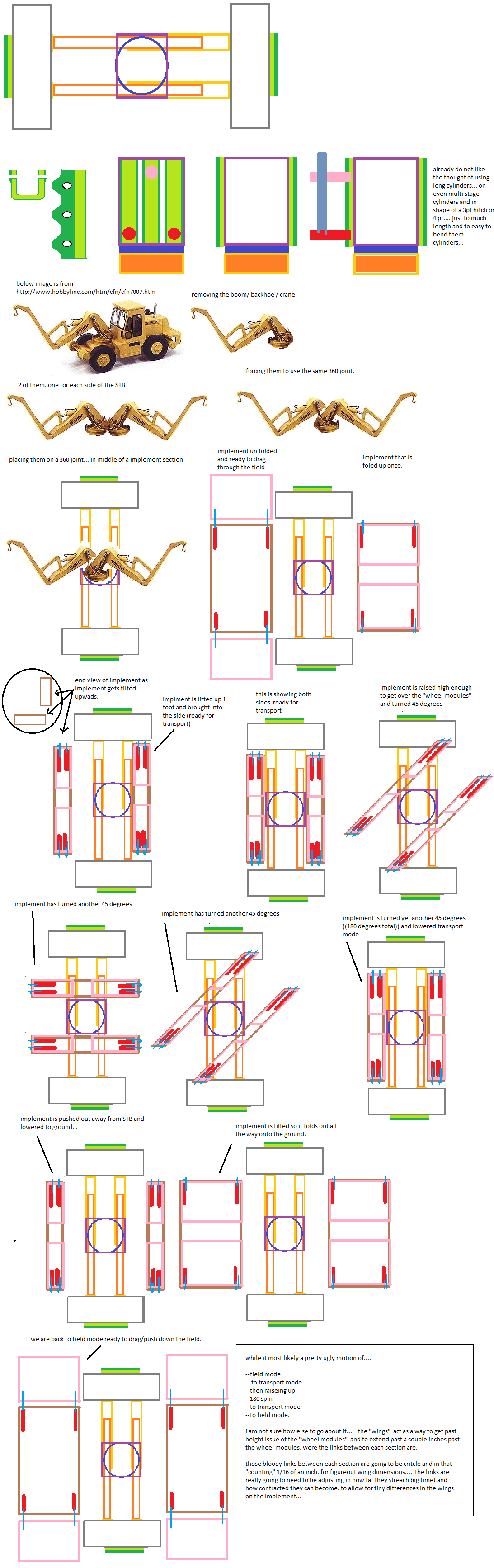

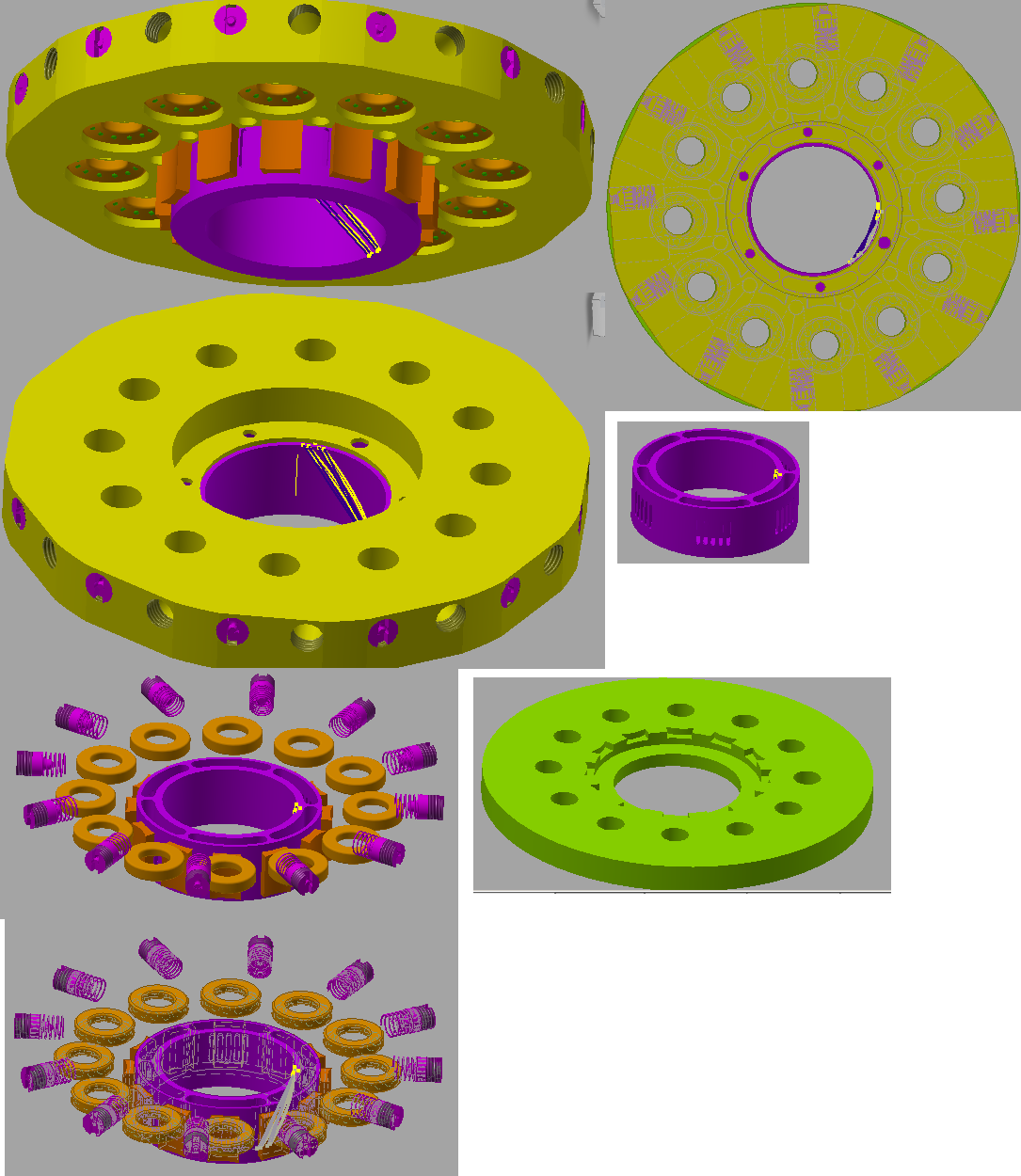

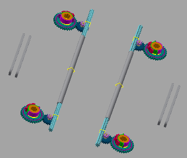

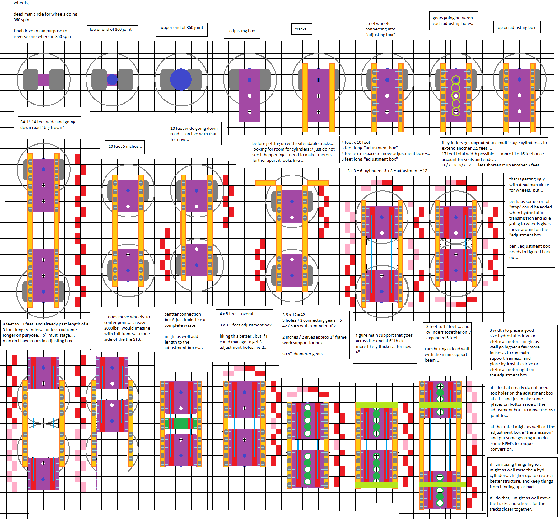

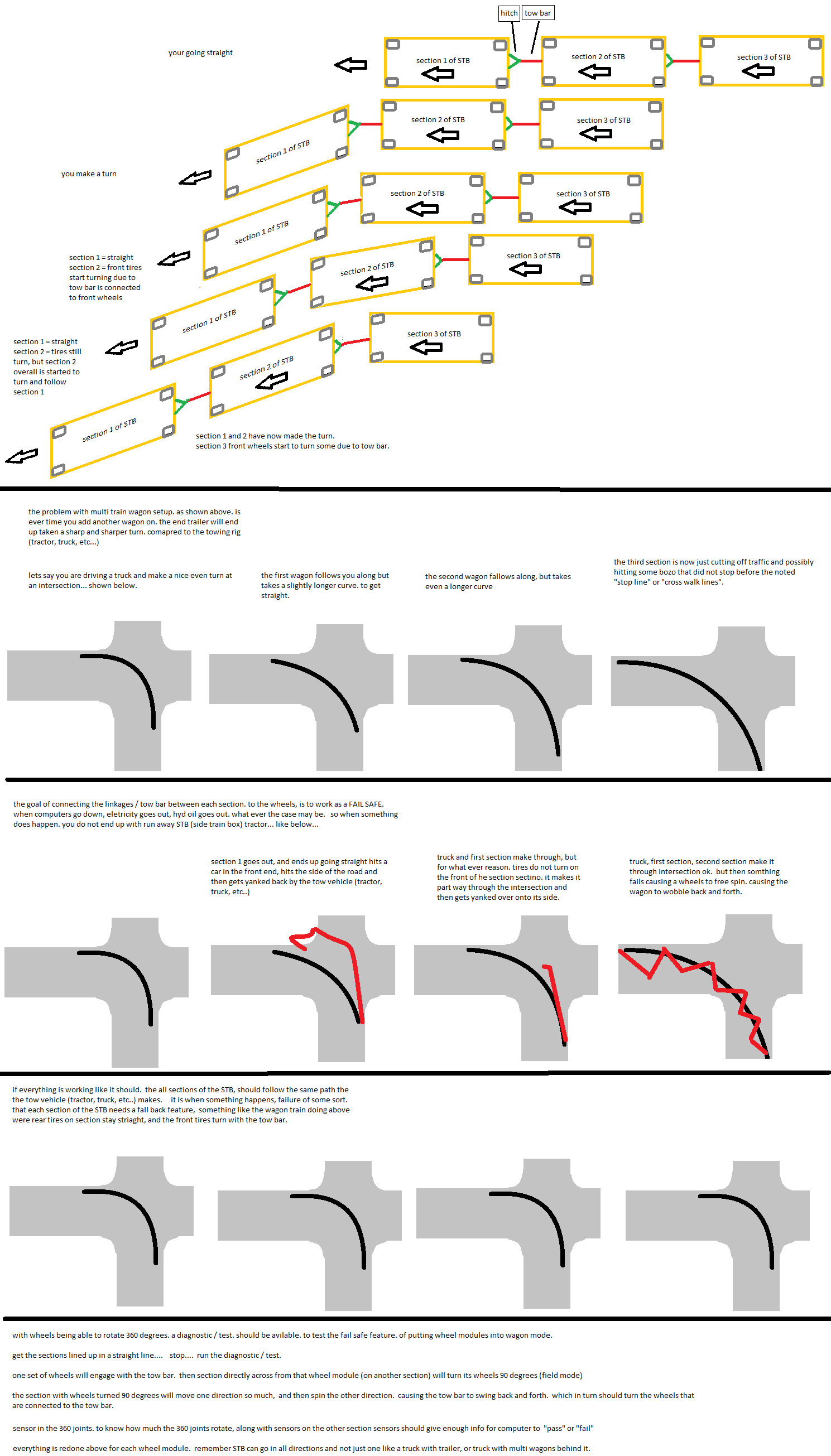

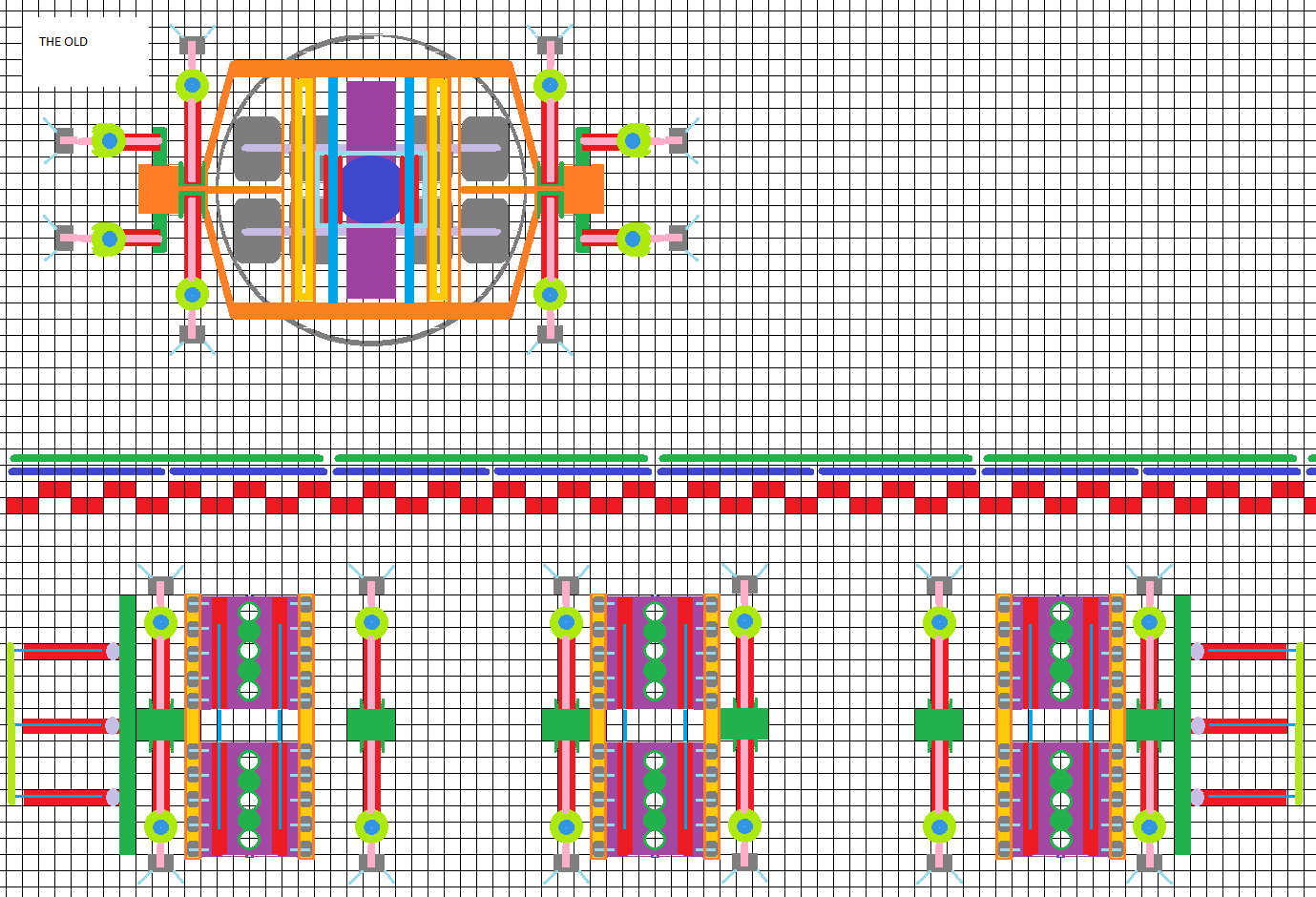

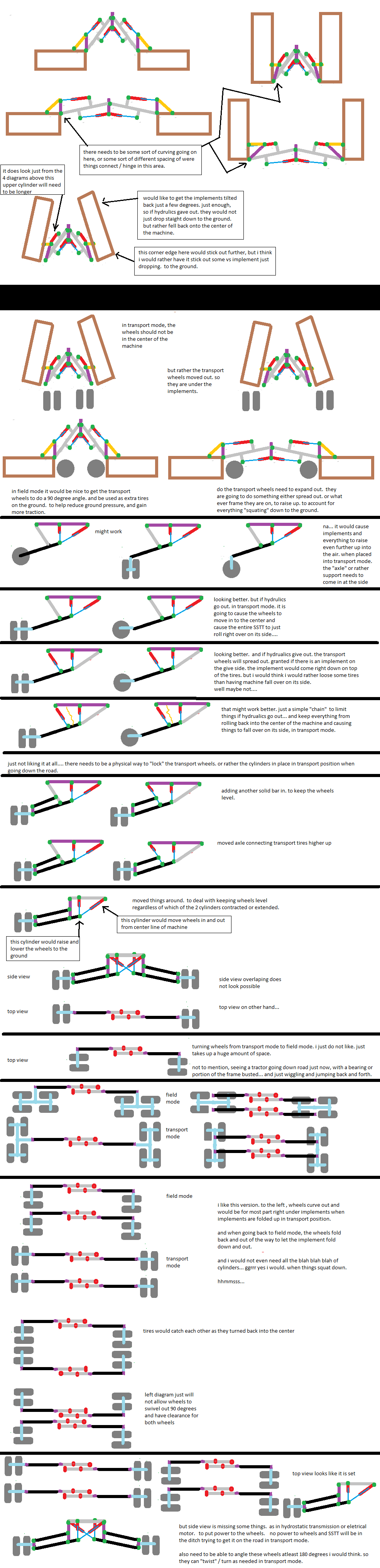

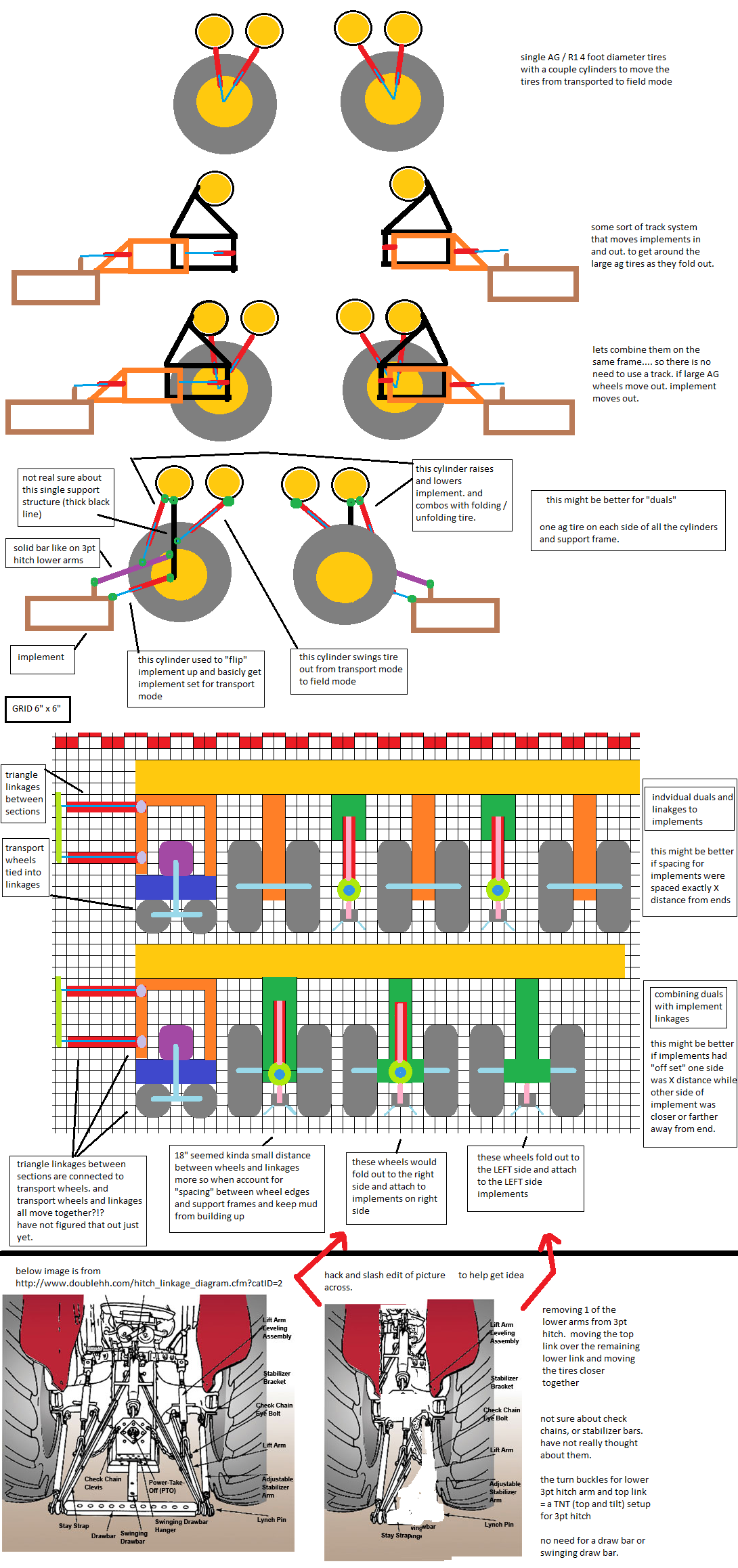

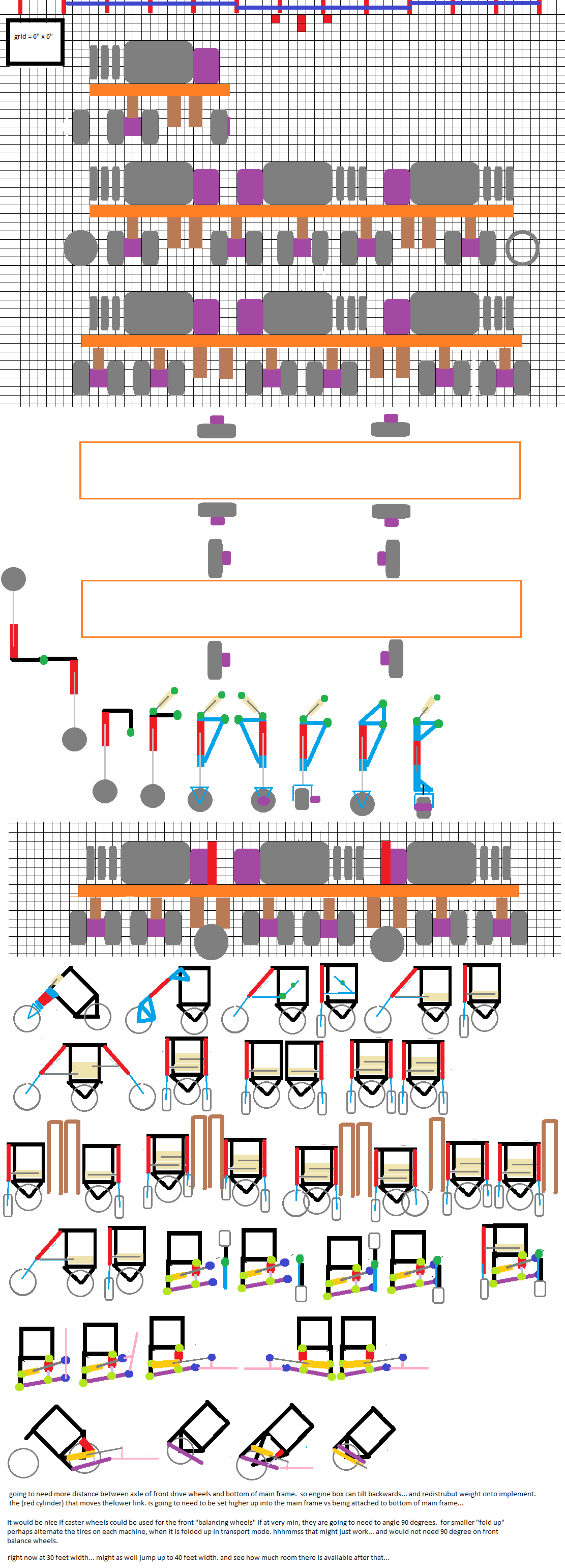

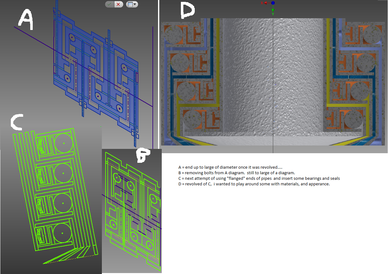

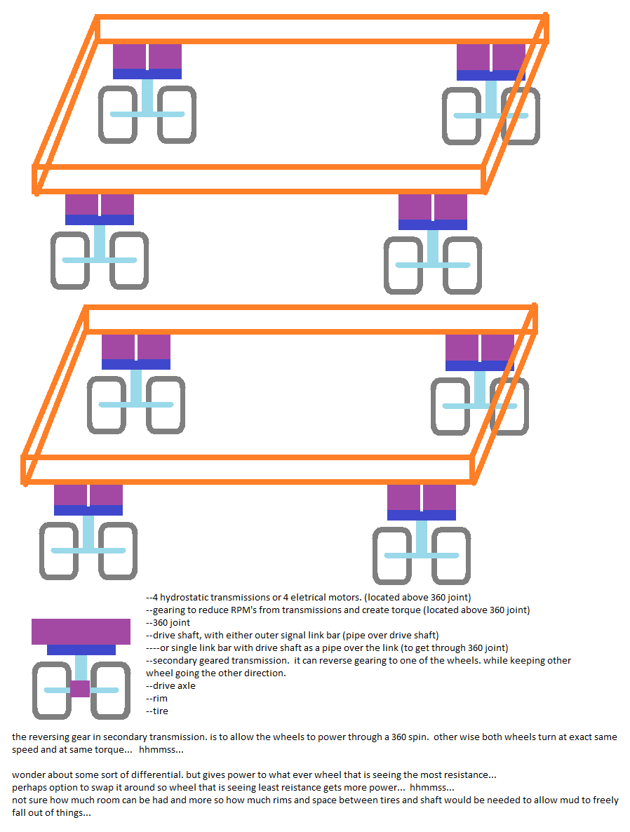

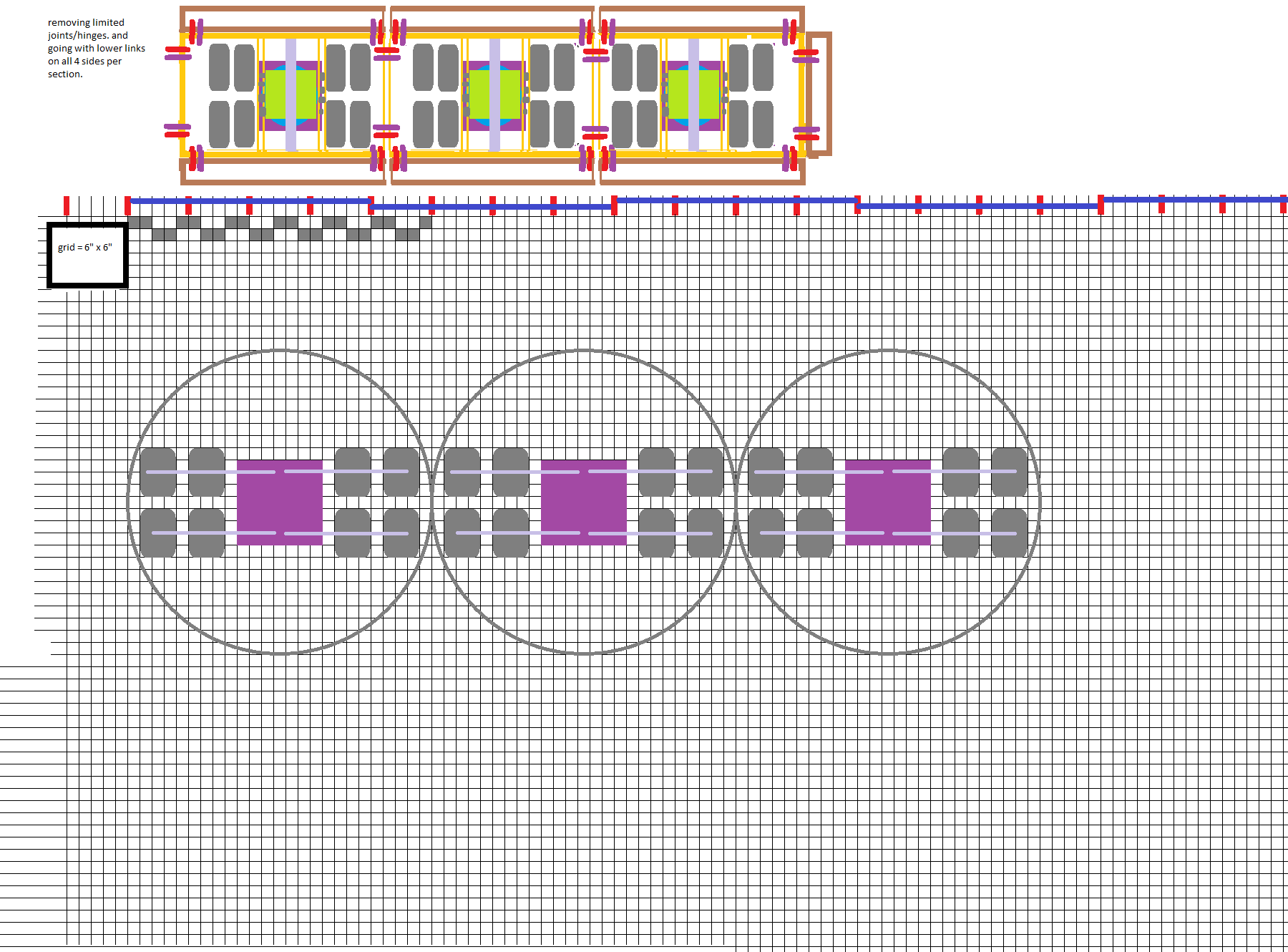

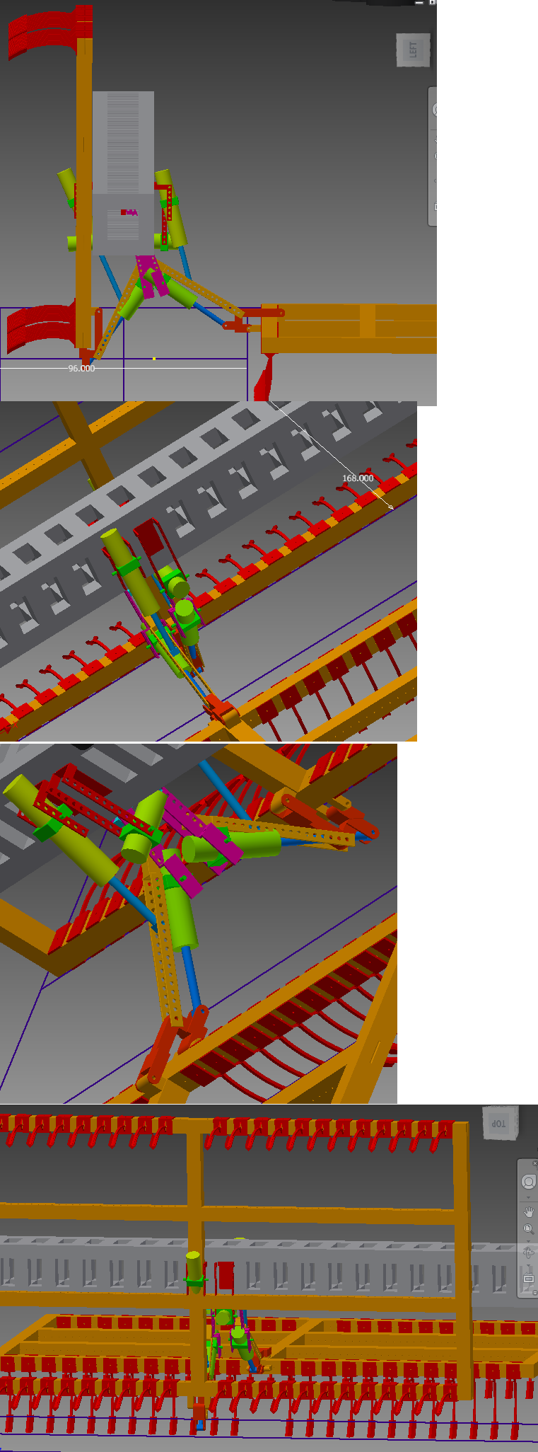

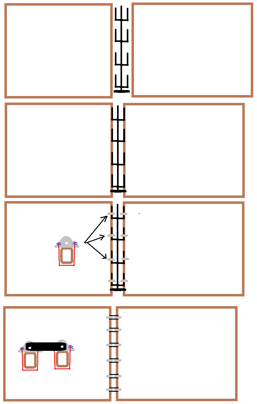

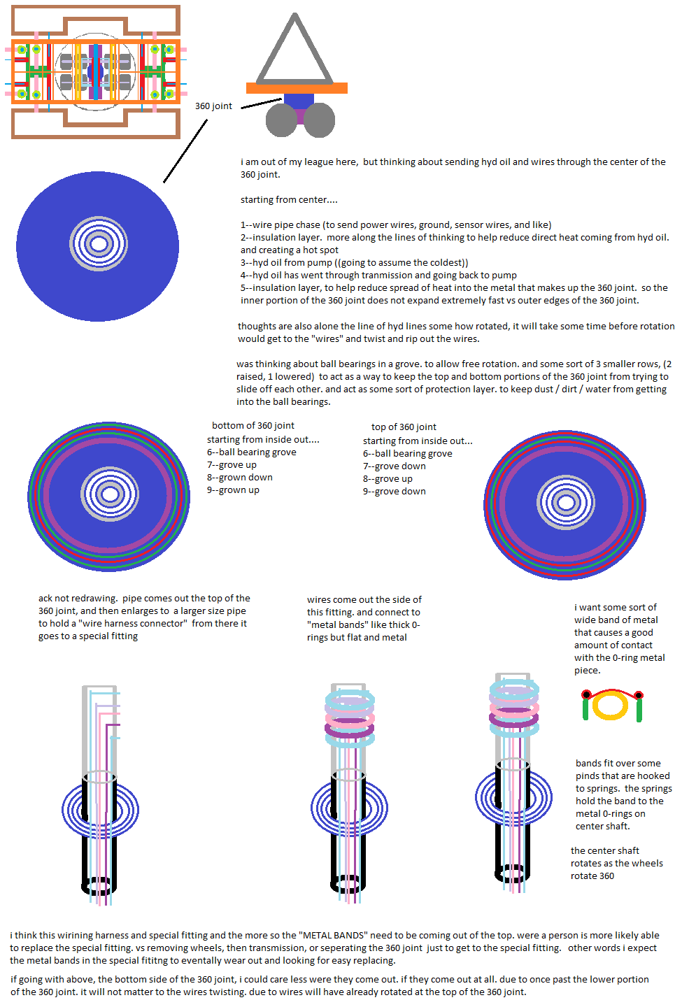

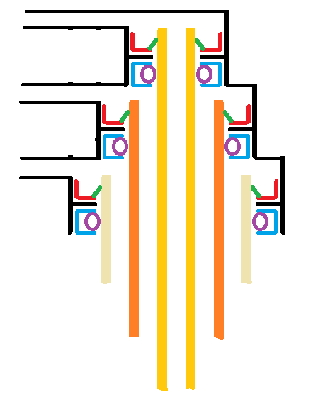

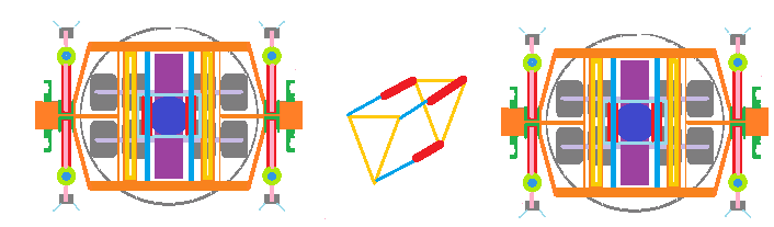

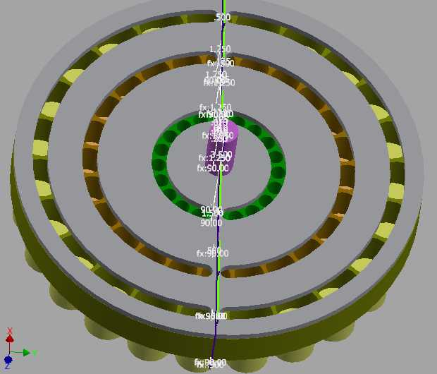

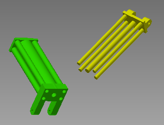

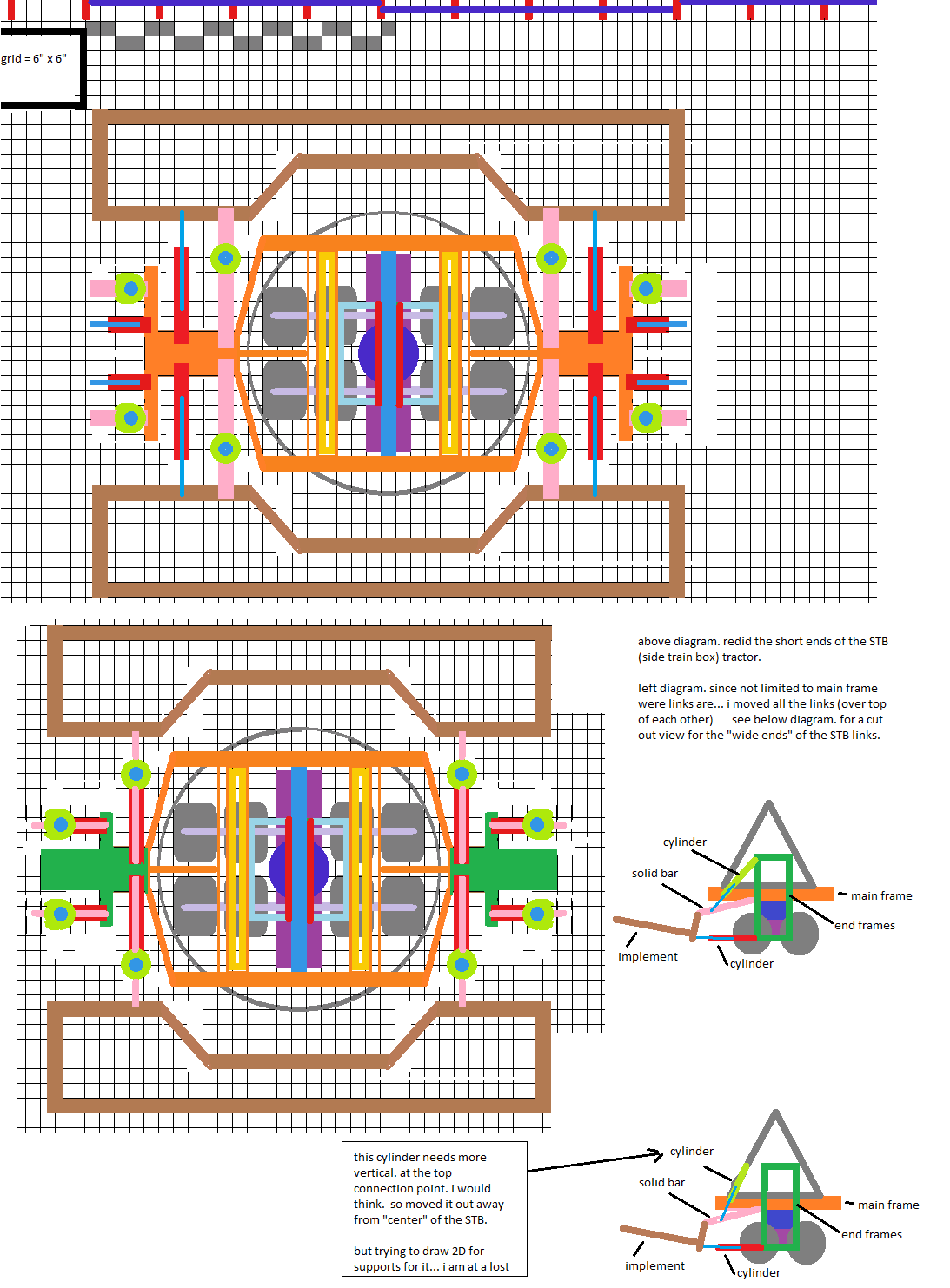

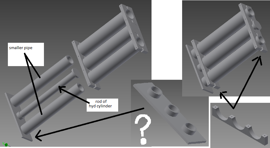

drawings in trying to figure out how to route and run wires/hoses around the caster wheel like design for electrical wheel hub motors. and connection up to a 360/rotational joint setting on top of the caster wheel structure.
