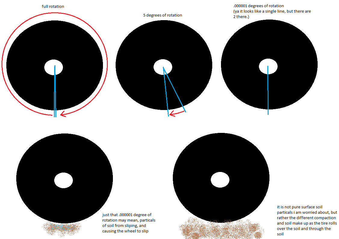

==finite wheel control. as in down to .00001 or more .0000000001 in adjustments of RPM and torque. other words how many trucks/cars have some sort of traction control. this is more traction control for in the field. vs keeping car/truck on the road and not skidding out, or trying to stop as fast as possible. finite adjustments are for compaction, and easier ride, kinda of part of the suspension. with so many wheels / tracks on the ground. and most likely less weight. the need to adjust for wheel slippage, and tiny humps and dips. more finite control the more happier i will be. see attached images.

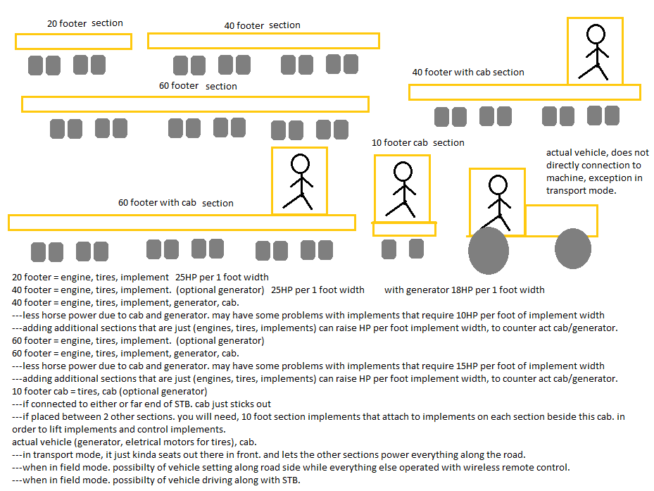

to meet above....
cab
==through out this entire thread, i have not really figured out a way to include a "cab" for a person to actual stand or seat to drive the unit. by the time you fold up all the implements, and placement for main engine, batteries, gas tanks, etc... you end up taking up a huge section. that would require extra linkages and things to move. in order to work around a cab.
==with above, i am more looking for a cab ((i am now calling it the ""command center"")), kinda like a tower command center at a big airport, or nasa space ship launch command center. but geared for 1 or 2 people. and have abilty to control multi tractor/implement combo units. other words a kids video game placed in a vehicle. and wireless internet connection to 1 to multi tractor/implement units.
==to add to above, it would be like playing with a RC (remote control) kids toy car. but being able to control multi RC cars from a single place.
==problem is internet more so wireless internet, make it satellite, to cell phone, to wisp, to other wireless internet, does not cover a good amount of areas, (dead zones) and the bandwidth, to handle multi video feeds/singles and sensor readings.
==with above, this is going to put the unit up into a upper tier, that will most likely require paying FCC a yearly fee, to use a certain frequency, that can handle say 5 miles radius from the "command center".
==i have not completely ruled out the idea, of tossing a "box" on end of a SSTT. to hold a person, for "safety". or having a chase or lead vehicle make it a truck, car, or 4 wheeler. that has either a pull cord safety rope when following, or some sort of rod that extends to 4 wheeler, for stopping unit completely.

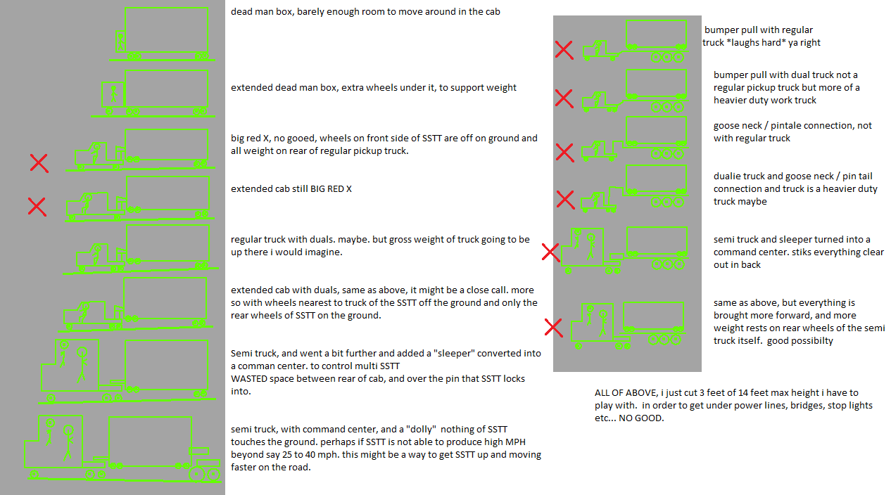

not covered in above, is low boy trailer. and not real keen on a low boy trailer. way to many hills and ditches, and simply not enough clearance.
other thing not covered, is treating SSTT as a wagon, much like a grain wagon. this still might be a good possibility.
Ryan I was thinking you were planning on equipment large enough to pay the not using a tractor. But hauling on pick up ?
see above diagram.

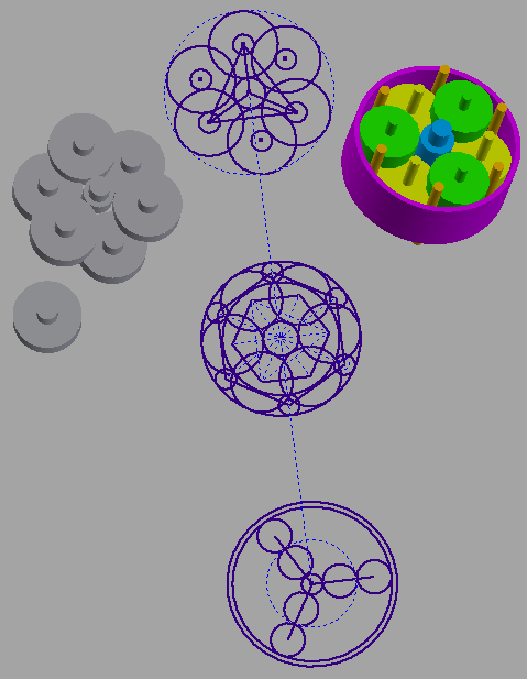

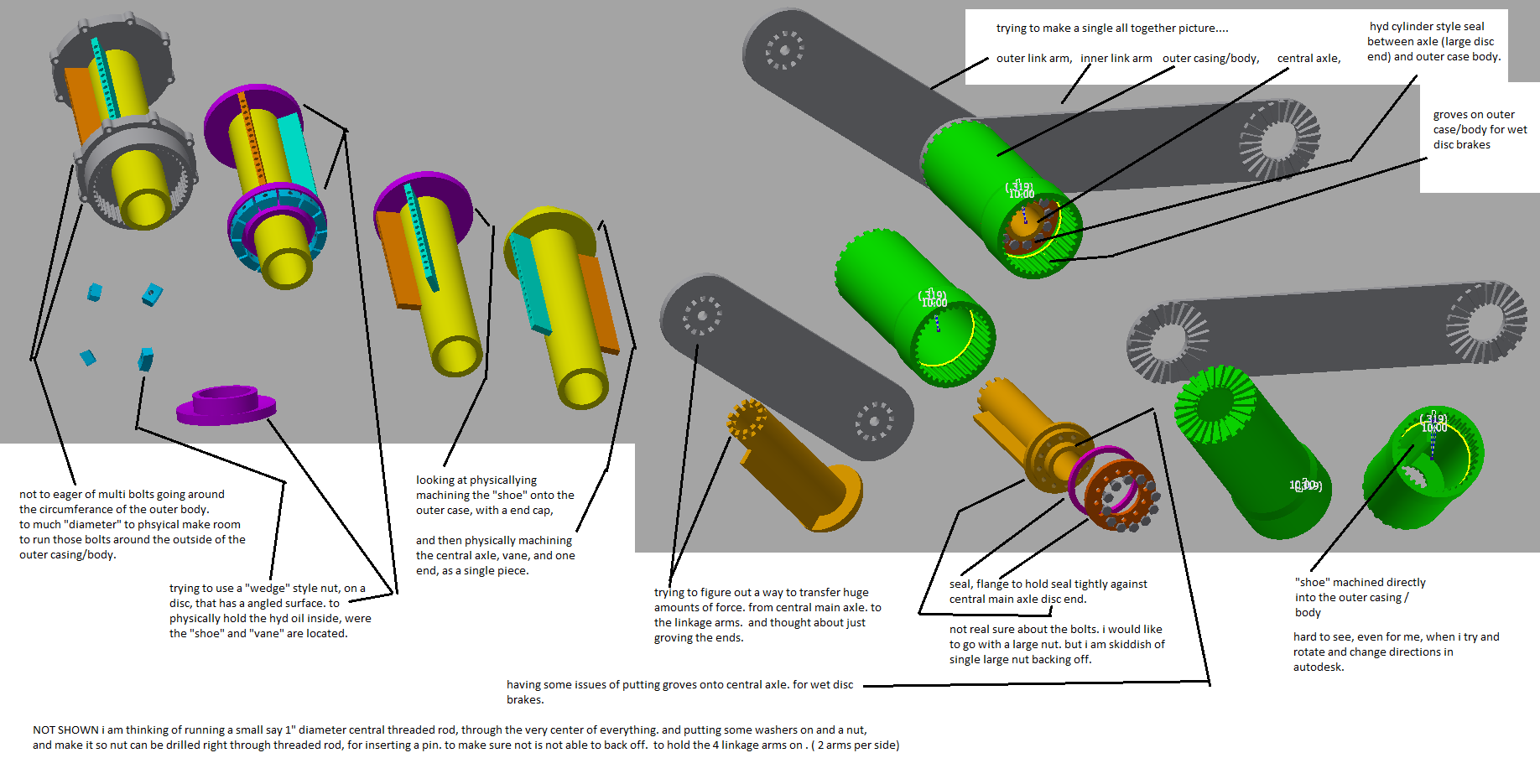

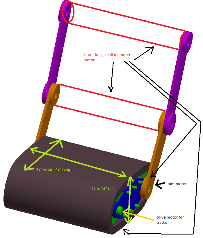

how do i make a 4 foot long motor, and smallest diameter possible. and have initial start load, at absolutely max torque being able to produce. and not done yet... have that "finite" control of adjustments. of .0001 degree or more of rotation.
combine the motor with a set of disc brakes, that also needs to fit in the 4 foot length.
--willing to compromise using a coil of tubing basically wrapped around the outside, as a way to create a cooling jacket. but not really sure about internal coolant, say through the axle itself.
4 foot long shaft is fairly long, and i am worried about vibration, and things banging into this motor, and simple twisting of things. that could cause motor to short out some place in the center of the 4 foot length. meaning most likely going to need to split the 4 foot length up in half, and have 2 motors. one on each side, but not real thrilled about running extra wires for 2 motors.
i thought about multi pancake motors, stacked one next to each other. but worried, about reducing the center shaft, and resulting more chance of something bending, and taking the motor out of commission.
i really do not like idea, of a "squirrel cage" style motor. i do not think i could ever get the "finite" control i would want.
i am thinking of a modified squirrel cage motor. and the coils of wire, instead of being parrallel to the shaft. wrapping the coils at 22.5 or 45 degrees. both in rotor and stator. part of thinking is, i will be able to wind the wires tightly without need of some sort of wedge or something to hold the wires / coils in place. and at same time allow for finite control. problem i do not know were finite control. vs needed/wanted initial starting torque is, and being able to hold that torque without much spin.
i am not to keen on wrapping the coils all in the exact same direction, i am more thinking of wrapping one half of motor in one direction, then doing a 90 degree in center, and wrapping coils in other direction. to help balance out the force, of instead of pushing rotor/stator apart at the axis. but rather almost keep them aligned with each other. reducing pressure on any side force bearings.
thinking about it, i might run a slightly bigger axle, to cool the internals. the 360 / rotoational joint, would not be spinning like a wheel hub motor.
ok for water jacket, perhaps extremely large thread shaped hit sink fine, and then a long nut that went over the fines for a better tight fit. that might work, out nicely, good solid heat sink material, and water/antifreeze running through the fines. i would imagine it would not be that bad for friction loss either... errrr strike that. that tightly wound of coil. would only be good for internal pressure pushing on a pipe. i am more worried at moment, in beending over 4 feet length. sounds more likely i am going to have to rely on U shape passage ways at the ends. so i can run the heat sink fins parallel to the shaft length. though thinking i might put a slight twist / rotation on the fines.
as ken poinited out going with a magnetic clutch / brake. but how do i time it, how do i sense things. so that current torque being placed on this joint and being held by the brakes, to the point that the motor is able to build up enough torque, and more the point, a torque that comes as close as possible to current torque being held by the brakes. before the brakes are released and the joint moves.
also can create a "spring" or rather shocks, and leaf spring style effect. out of these joint motors.
thinking about it, these tracks, are going to range widly on this SSTT. from say 8 inches wide, to perhaps up to 4" inches wide. and may be any were from 2 feet long, to 8 feet long.
man, that totally changes dynamics of things.
before i got to hang man games for track widths and lengths, and linkages lengths....
for the multi pancake motor idea, for the 4 foot long motor idea.... was think of setting them up like wet disc brakes. see below video. and instead of friction disc, discs would be stacked in a tube, and over a geared shape shaft. and then runnng wires down in the groves of the teeth. and then a spring /brush type of connection. for each disc. and using the teeth. to slightly off set all the discs. to obtain a better finite control.
for current thought for wrapping coils in and around rotor and stator.... would be something like a combine header auger...

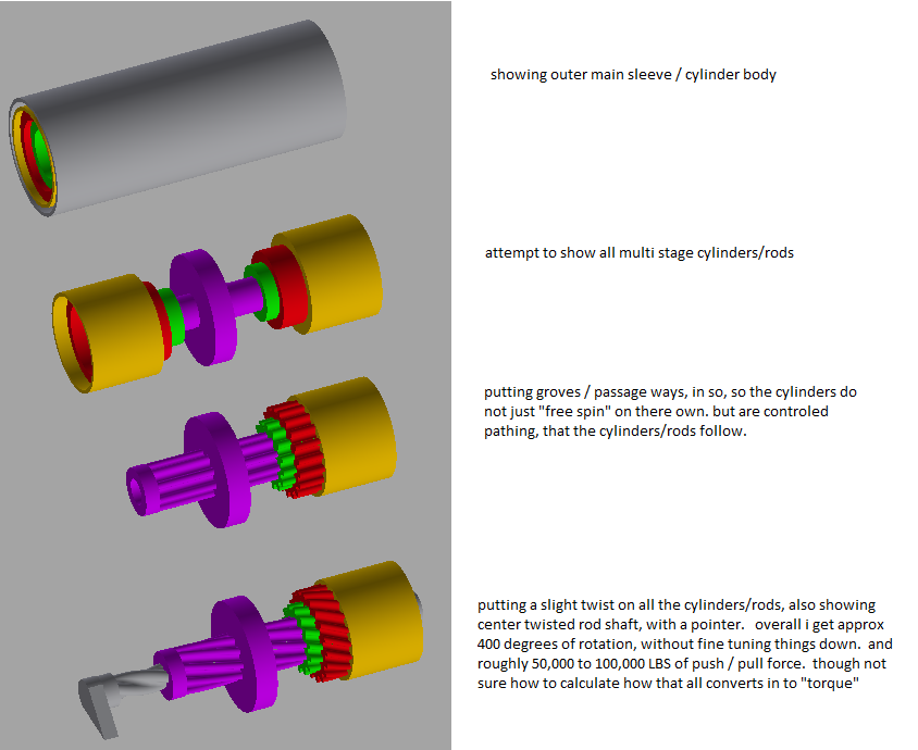

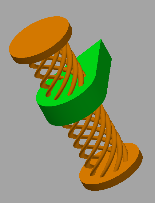

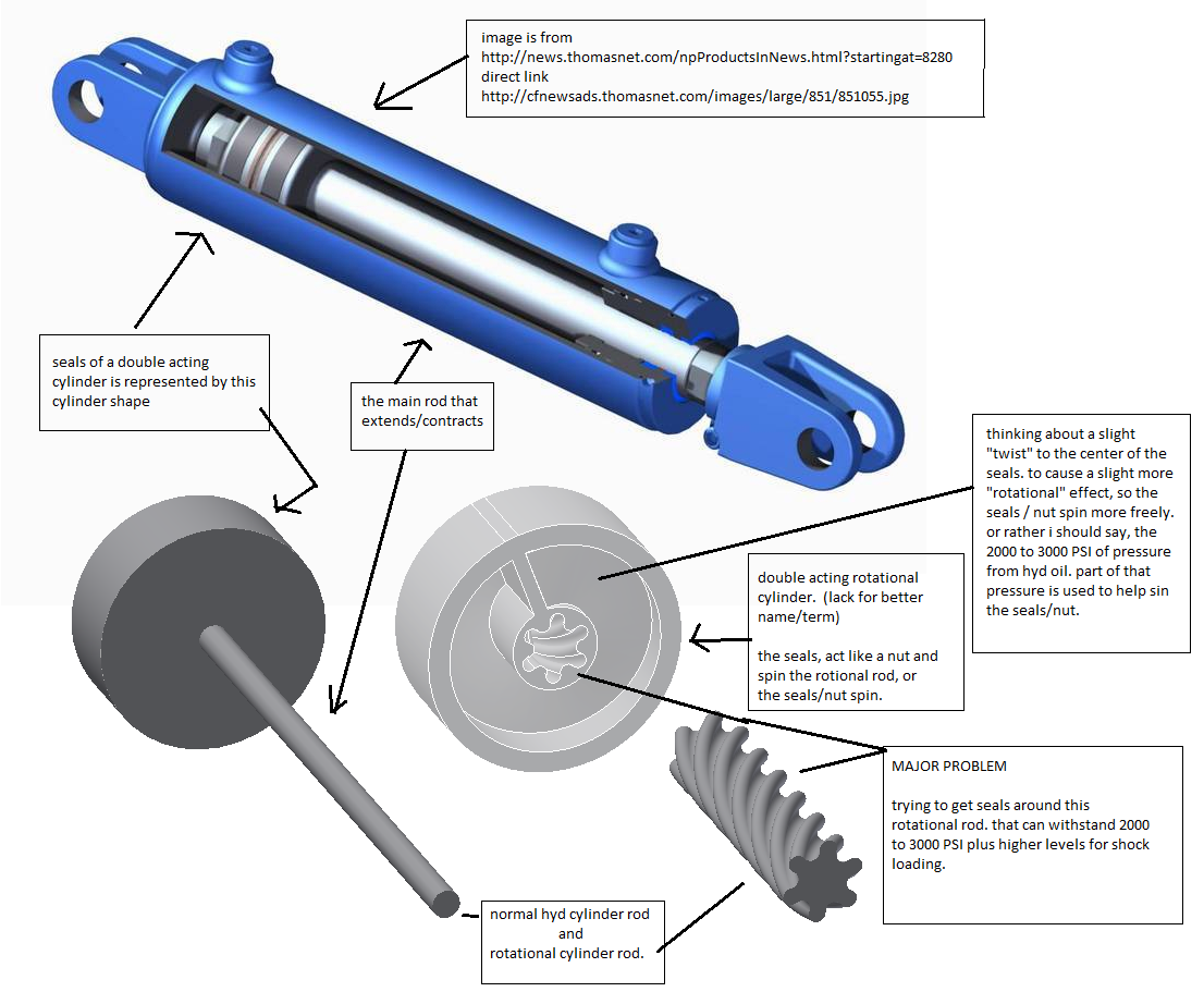

i wanted to see if i could use a simple hydraulic cylinder, that allowed "rotation" of say 350 to 300 degrees, for the track / wheel linkages. the idea seemed simple enough, and then frustation sat in, trying to figure out how to "place seals" that could handle 2000 to 3000 PSI of hydraulic oil pressure. and then getting rotation.
decided to step back, and look at coil/spiral shapes. to get a better idea of what might work. ending in below diagrams, and understandings.
to sum up above. if i am going to make idea of "push rotation" reality.
==rod that has twists / teeth will need to be small diameter (smaller the better), and long (longer the better)
==PROBLEMS, is getting seals in place, trying to hold back 2000 to 3000 PSI, and then shock load pressures that would be even higher, around a shaft that is twisted / has teeth and is small. a perfect circle is one thing, just like a regular hydraulic cylinder rod shape. but to twist the rod and put a grooved path / teeth on it.... is another thing entirely.
EDIT: additional diagrams to help get things across better perhaps
EDIT: complex'ing the problem....

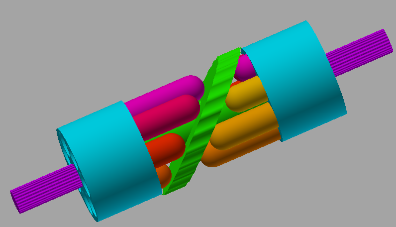

#287

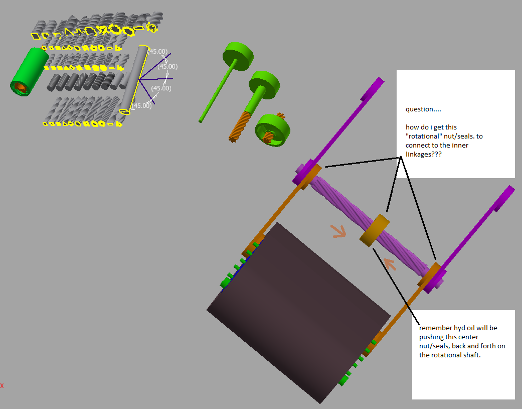

just been trying to draw things up, to visualize if they may or may not work.
2 hydraulic motors, end for end. just trying to make the most of space. with the swash plate (green) center piece, tilted at 45 degrees.
this has some promise, granted this is rough draft, and need to change what connects to what for rotation.
Above diagram, vs below diagram....
above diagram, has smaller sized overall cylinder/rod capacity (bore size/rod size), vs below diagram. though, with above if i could find a gear ratio set. above might prove more promising.
below diagrams been tad of a challenge, couple dozen 2D sketch redraws over a 2 to 3 days, in attempt to find something that might work. this one i am actually wanting to run through a stress test. just to see if it could be possible.

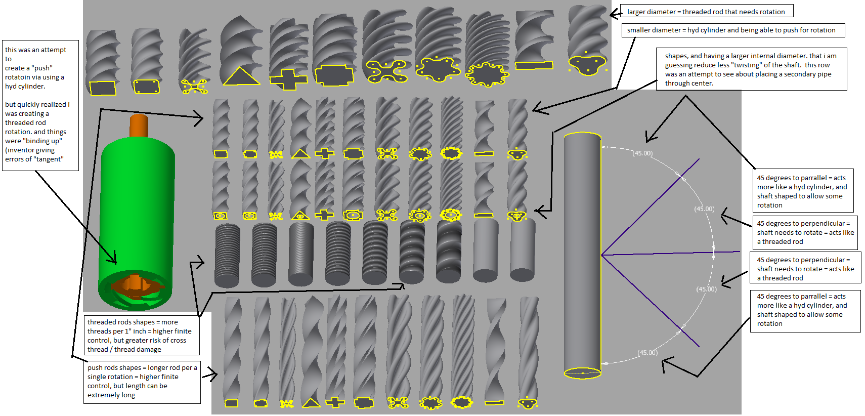

run into problems with autodesk, with drag and move, and "drive constraint" option. i either got "insert, or tangent" constraint errors. after so many multi stage cylinders had to move. tempted to create a short animated video but no go.
the multi stage cylinders are an attempt to fit more into a small space.
the spiraled paths/teeth, are required in order to transfer torque from the center, what do i call it,,, (large push/pull) disc. that rides on the main centered twisted rod.
this idea never will pan out, without some sort of multi stage like setup, connected to the main center disc that slides back and forth and rotates. the entire trying to place seals, to deal with the 2000 to 3000 PSI hyd oil pressure, and then higher pressure loads from shock forces. and then work out some sort of connect rod or grooved paths or something. to get things to rotate the 300 to 330 degrees.
an attempt to figure out what gear ratios might be achievable. within 7.5" diameter by 20 inches long. (motor, and brakes/clutch also need to fit in the area)
i did come across some regular bicycles (the ones you actually peddle). the rear wheel gear hub. that had multi planetary gear sets. that might be something. with shifting all put into it all. granted i really do not need shifting, just a way to reduce gear ratio of a electric or hyd motor. and obtain a nice super finite control that is extremely smooth in rotation.
i also came across some helicopter transmissions that gave some thought of how to "gear" things. to obtain a higher ratio.
i thought about "worm gear" type of drive train, but gave up on the idea, not sure how i could achieve compactness and keep stresses from tearing things apart.
hhmmsss ovalish?

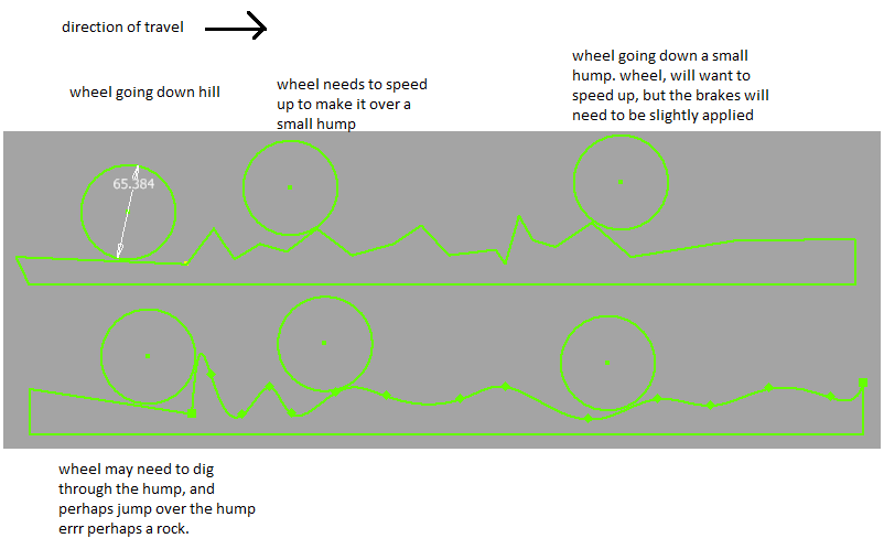

i figure i am going to need enough power. in the following scenario....
going down a very steep hill in transport mode. and need to raise the lower front up, perhaps to get over a creek or wash out. a single wheel/track is for most part going to need to support entire weight of the SSTT, and forces going at unknown amount of MPH. this cylinder shaped rotation device for linkages needs to be able handle

#288
*well duh*
--no need for a full 360 degree rotation. but say 300 to 330 degree rotation.
--works like a vane pump / motor.
--easily size-able to different diameters and lengths. to produce different torque values.
--only a few parts needed. KISS (keep it simply stupid)
--electrical over hydraulic valving. perhaps double up the valves. one larger valve, for quicker change in degrees, and another valve for finite control. second valve more of a needle valve with a variable direction solenoid could control. without use of electrical, over hydraulic, over hydraulic. to control the needle valve.
--cylinder shape force bearings on ends of the center shaft
--some regular hydraulic cylinder seals perhaps between central shaft and outer body.
--toss on some brakes at one end of it, for fail safe to and to lock the linkages in place.
--other end toss on a disc shape, that has multipule sensors (back up and better finite control of readings).
--down the long length of the cylinder and across breaks and digital sensor disc. run valves for the rotary actuator, and hyd hoses. it would not be a perfect circle i was looking for. but more egg shape, but that might be a pretty good compromise i could live with. just would take some extra planning to double check clearances.
weeks worth of fussing... and only to find above...
do i need to go with more vanes and inlet/outlet ports. to how do i say it, multiple the torque. and to even out forces being applied to the center shaft and outer casing/body. other words do i go for more of a vane motor/pump type setup. but without the off set in rotation that a vane pump/motor has.
--if i start going with more vanes. and rigid shoes (per video notation) that act like stop blocks. i would have to go with a planetary gear setup or like on ends. to obtain my 300 to 330 degrees of rotation.
--if i remove the shoes / stop blocks completely....there would be no way to accurately predict direction of rotation. so that is no good. i suppose i could do "one way clutch" one direction free spins, other direction locks. and use 2 of them. and engage one or the other. to determined rotational direction wanted.
--getting to complex for way to many linkages. would rather enlarge things, and place more focus on sensors and valves and complexion the computer logic up.
seals...the "shoe" / stop block in video.
--i do not want to physically cut the outer body/casing into a C. but perhaps a "grove" on the inside, that the "shoe" / stop block goes into, into the outer casing/body. then every so many inches. drill holes through outer casing. that align with the shoe piece.
--the strip of metal of the shoe, grove it out for seal that touches the shaft, and then, hundreds of springs, all with same tension. pressing down onto seal. and onto the shaft for a even seal face?
--hhhmmsss perhaps a simple "check valve", well no better yet. hooking the "pressure line" 2000 to 3000 PSI hyd line. to the shoe from the outside of the outer case/body. and using that force, to push the seal down tight against the shaft. along with into the internal sides of the grove the seal sets in.
--gggaahh... i need more of a "wear seal" and a tight tolerance.
what about the tip of the vane. and sides of the vane.
actually the side of the vane, more likely be problematic.
--well no maybe not. just toss a cylinder shape disc on end. ok but how the heck does that help me.
ok instead of a nice perfect 90 degree corners, what about more of a rounded out ends.
--that would let me curve the vane seal right around from the long face, and down the sides of the vane.
what about the actual shaft, and dealing with leakage, a bearing would most likely have to set outside. and a seal setting closer inside.
--hhmmss suction cup but turned into a seal, and center drilled out.
multi groves that are circle in shape. to act like a labyrinth, that hyd oil would have to flow through.
--i can visualize the groves, being done on a lath. but actual rubber like seal

been trying to think of a way to circulate hyd oil through the "rotatory vane actuator. besides fully going to 0 degree, and then to max degree. along with hydraulic accumulators, finite control, routing of hoses. dealing with air accumulation, and water within the unit. the "shoe" looks like prime real-estate to install valves into possibly, vs having things wrapped around the outside of the unit, or mounted to the linkage arms.
i think disc brakes will be easy enough to cut some groves into outer casing, and put a bushing that is keyed to shaft. with some groves in pushing. for the other set of brake discs to slide in on. but unsure if i want to cool brakes with a anti freeze / water mixture, or send hyd oil through the brake discs. or just use a generic gear oil errr brake oil. and state it needs to be changed some many X hours. i think i rather have cooling happen on the brakes, i can not rely on air and in that fan. hhhmmsss perhaps plumb the low pressure side of the hyd lines coming from the unit and go into the brake discs. so any particles and crud from brakes wearing down ends up going to return lines and through filters before going into any other system were damage could occurs or cause more wear and tear.

say 2 linkage arms. errr 2 pivot points using RVA (rotatory vane actuator)
mainframe to linkage arm (A)
linkage arm (A) to linkage arm (B)
wheels are attached to linkage arm (B)
say wheels will extend out from center 6 feet. or rather i should say, center point of axle of wheels. to center point of RVA that is between (main frame and linkage arm (A)).
effort/force applied in RVA say 3" off center point...
6*12 = 72 inches
class 3 lever....
72 * 3250 / 3 = 78,000 ft lbs of torque required from RVA that connects between main frame and first linkage. per wheel

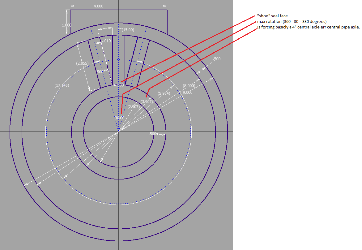

below is my own attempt over last few days of an RVA.
the seal between shoe/stop and the axle, this seal and degrees wanted 330 degrees of rotation, is predicting outer diameter of the central axle.
my own pathetic attempts in trying to figure out how to machine everything, bolt it all together, and to include brakes/clutch, along with attaching linkage arms to both sides of the RVA. granted it is all "rough draft" chicken scratches at this point, but i am getting a tad frustrated.
the whole trying to reduce need to make multi sections of the outer casing/body and bolt everything up, along with the central shaft and vane and also making into one piece is what is getting me. along with trying to keep linkage arms as thin as possible in attachment points to the RVA. getting hung up at the shoe/stop seal, the vane seal, and then seal/s for ends of them, to keep the hyd oil pressure were it needs to stay. and then making sure i can place groves in outer casing and central axle, so i can slide on some wet disc brakes.
may call Emerson Process Management to see about 3D file/s and then tweak there design, for connections for linkage arms and brakes.
