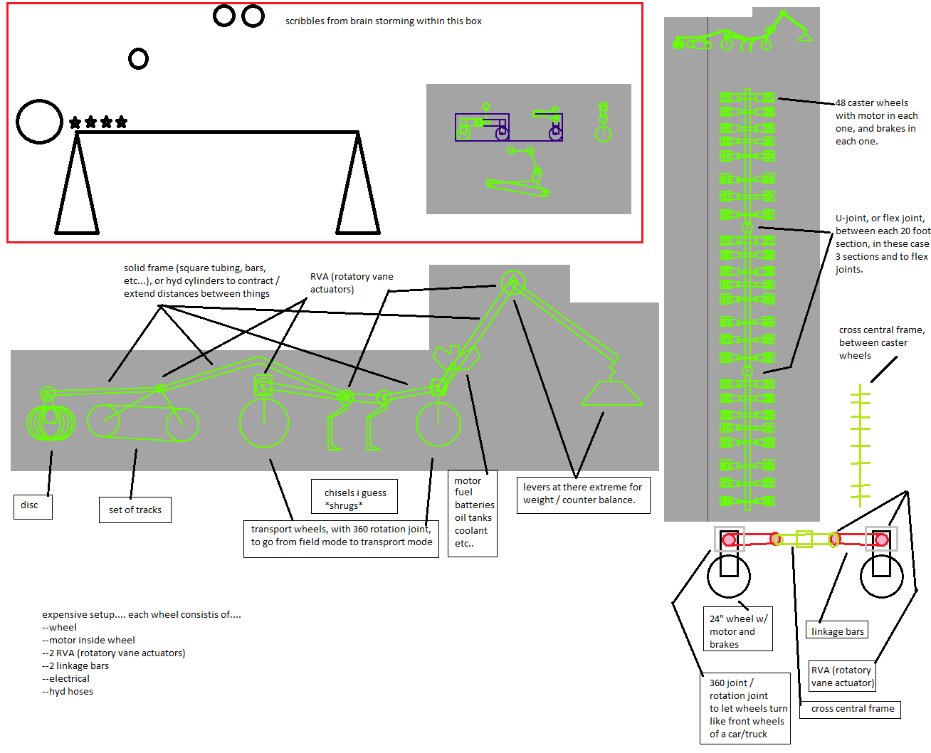

not sure i came across RVA (rotatory vane actuator) clear back during initial first few posts of this thread. and only looked at regular hydraulic cylinders as a form of movement.
going back to a old diagram i posted clear back on this thread. of using multi small tractors, and combining them into a single larger tractor.
brain storming lead to....
game plan change WSSTT (wheeled spider snake train tractor)
the more i re-look at old diagrams, i maybe going back to the original first handful of diagrams on this thread! just taken me 5 months to get that far *doh*

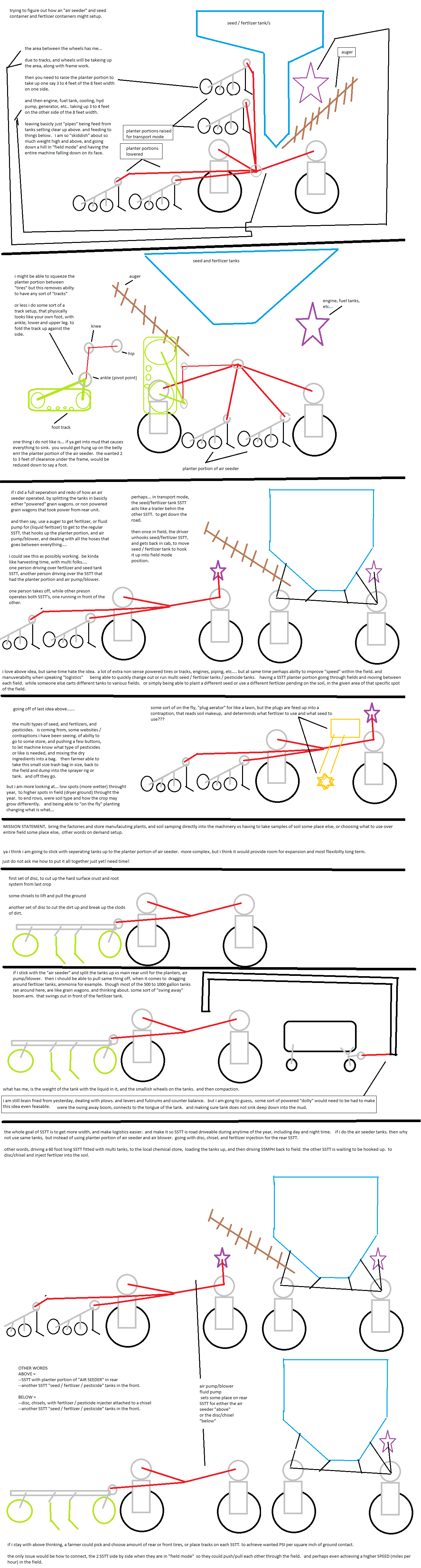

side tracking once again, need to look into conveyer belts with small sized buckets bolted to the rubber. to dig into the soil, and raise it up. without trying to get the dirt to go through an auger, or through a simple belt with tread perpendicular to the belt/track. hhmmmsss that might just work, but how to get a full scoop, that does not involve pealing the dirt off, and having it forced into the bucket. vs some how driving a blade in horizontally and then lifting 12" of dirt at a time or more, straight up vertically.
Wallace Truck & Equipment
google search for "wallace rooster picker" i can only find one that is for sale and not mfg.
EDIT:
thinking along the lines of a roller cooster, or rather i should say, a "track" that causes a motion of a bucket to act either like a backhoe bucket, or a FEL bucket. were, the bucket moves in and out.
the bucket punches horizontally into the dirt, and then rotates up and out of the way, taking a bucket full of dirt, without "smashing" the dirt into the bucket causing the dirt to fold and roll inside the bucket as the bucket goes into the dirt. instead, it is a nice smooth, punch into the dirt, and lift out, and very min of cutting/shaving the dirt wall.
instead of operator moving the boom, dipstick, bucket cylinders of a backhoe, the motion would be controlled by the tracks
getting back on track using RVA (rotatory vane actuators) for movement of linkages on the SSTT.
bottom plows.... ((single long picture / diagram))

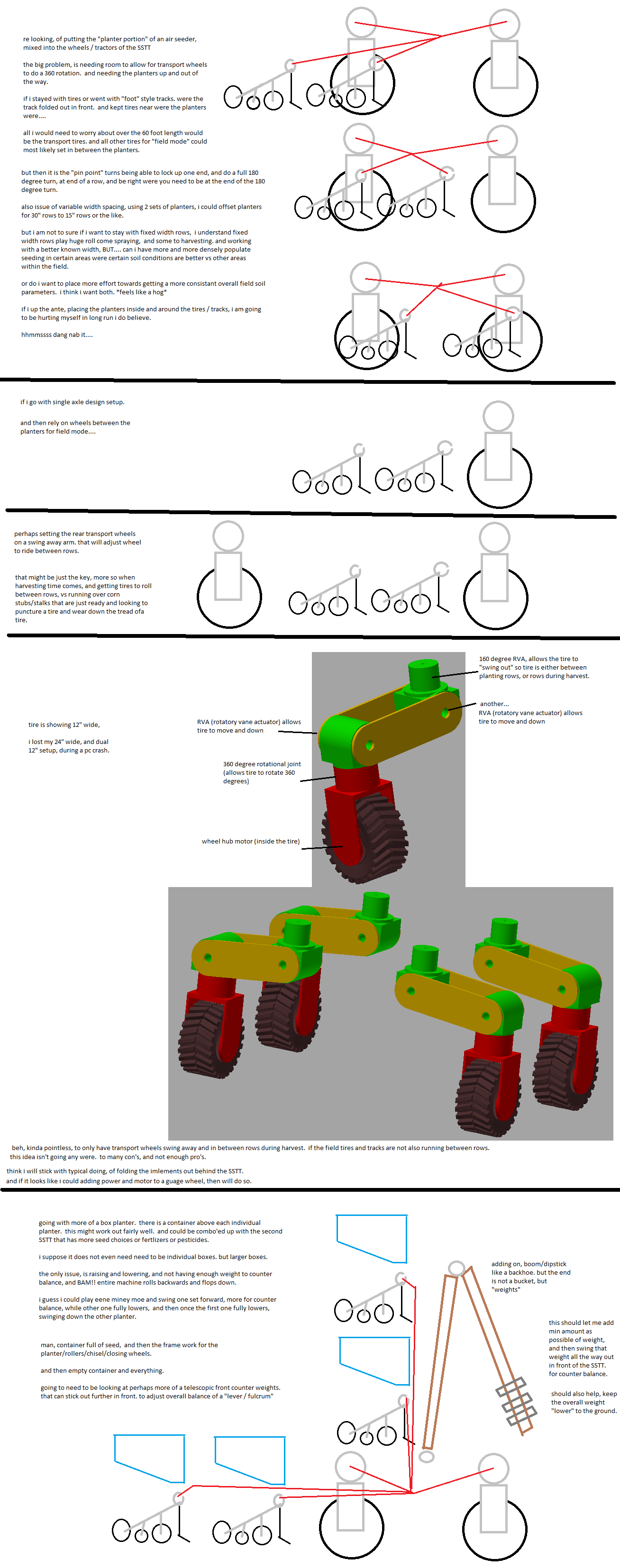

air seeder along with disc/chisel/fertilizer injection setup.
single long picture
back at it, to look, to see how other implements might be setup. so hopefully i can come up with a common "frame" and connection points that are universal for all attachments / setups. without making to huge of compromises.

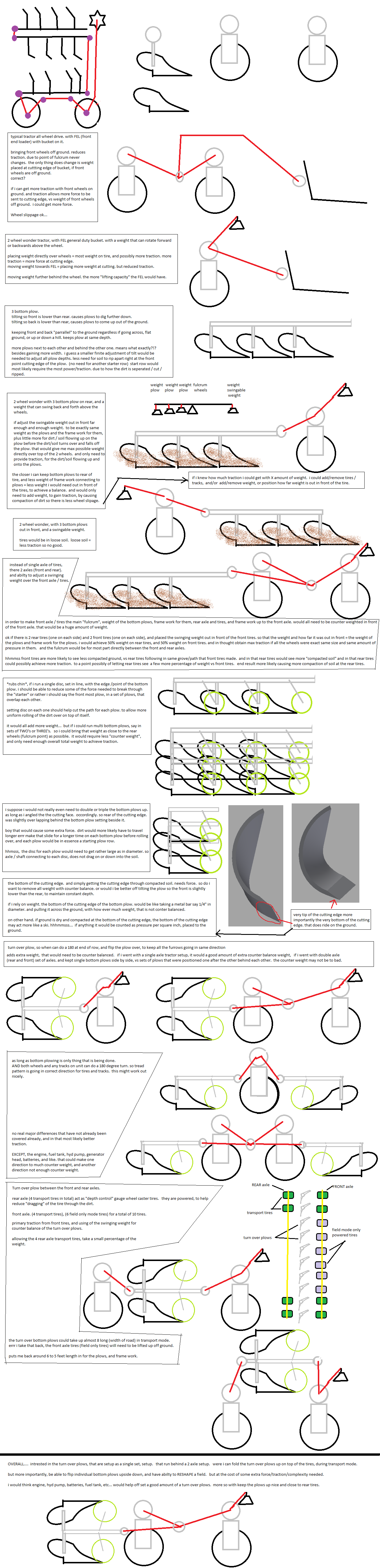

air seeder doings continued / box planter

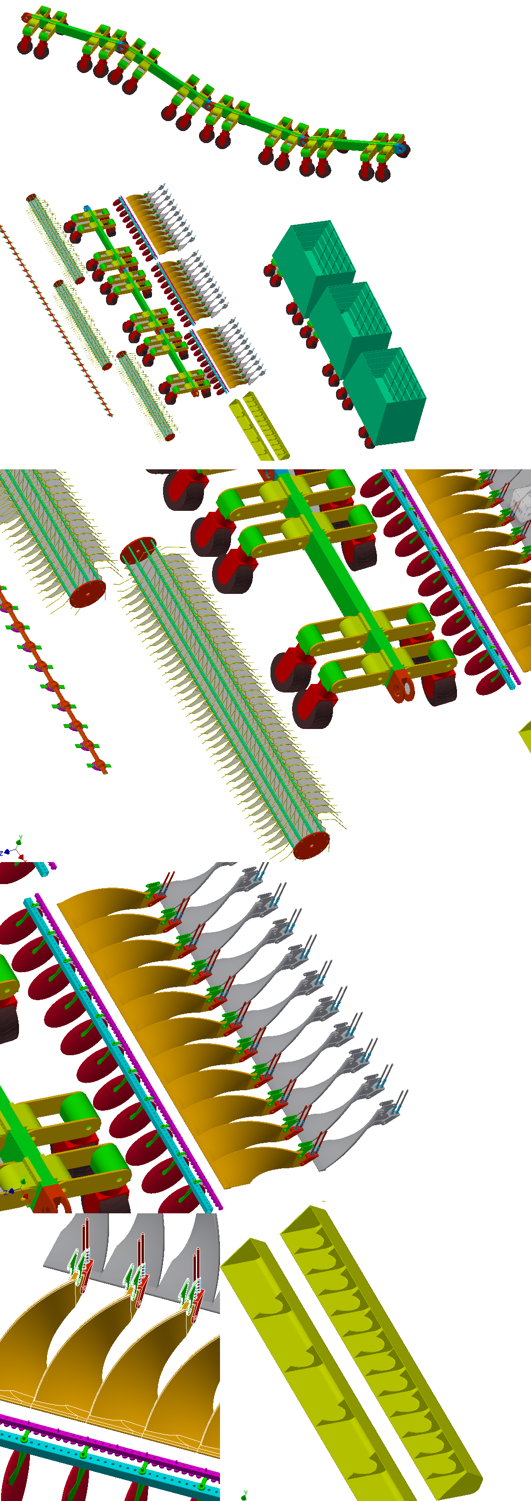

attached picture....
the main frame of the SSTT this is FOUR 15 foot section version, that i have been considering over THREE 20 foot section setup.
disc, that can adjusted to any "angle" wanted. i kinda butchered the disc pretty good, so i could approximately space the discs, to line up with edges of individual bottom plow beside it. i tried other ways to "angle" the discs. but every time i did, i ended up not finding enough room to fold things up.
bottom plow, from the first post i noted, i simply was not real eager to follow current age bottom plows, to turn over plows. i need something to fold up better. i needed to make 2 sets of bottom plows, so you could do a 180 at end of field, and switch over to the other set / row to keep all the furrows going in same direction. not my best work for "trip plow" so if a bottom plow snagged a rock or root or something else, the plow would flip back, but at this point was more focused to see if a bottom plow like this setup could possibly work.
i tried to make a FEL (front end loader) heavy duty bucket. to try and describe the bottom plows, and how they work, but how i was going to explain things has done left the building.
i tried making some sort of "hay rake" along with some sort of multi blade bush hog, to deal with hay, to try and see how things might line up. and overlap one another to perhaps save on cost and keep things more simpler.
decided to toss a few boxes on SSTT, just to see what it might look like. and figure out how much space i had.
hopefully as more things get figured out, better detail will be done to move things more closer to a finalized rough draft of things.

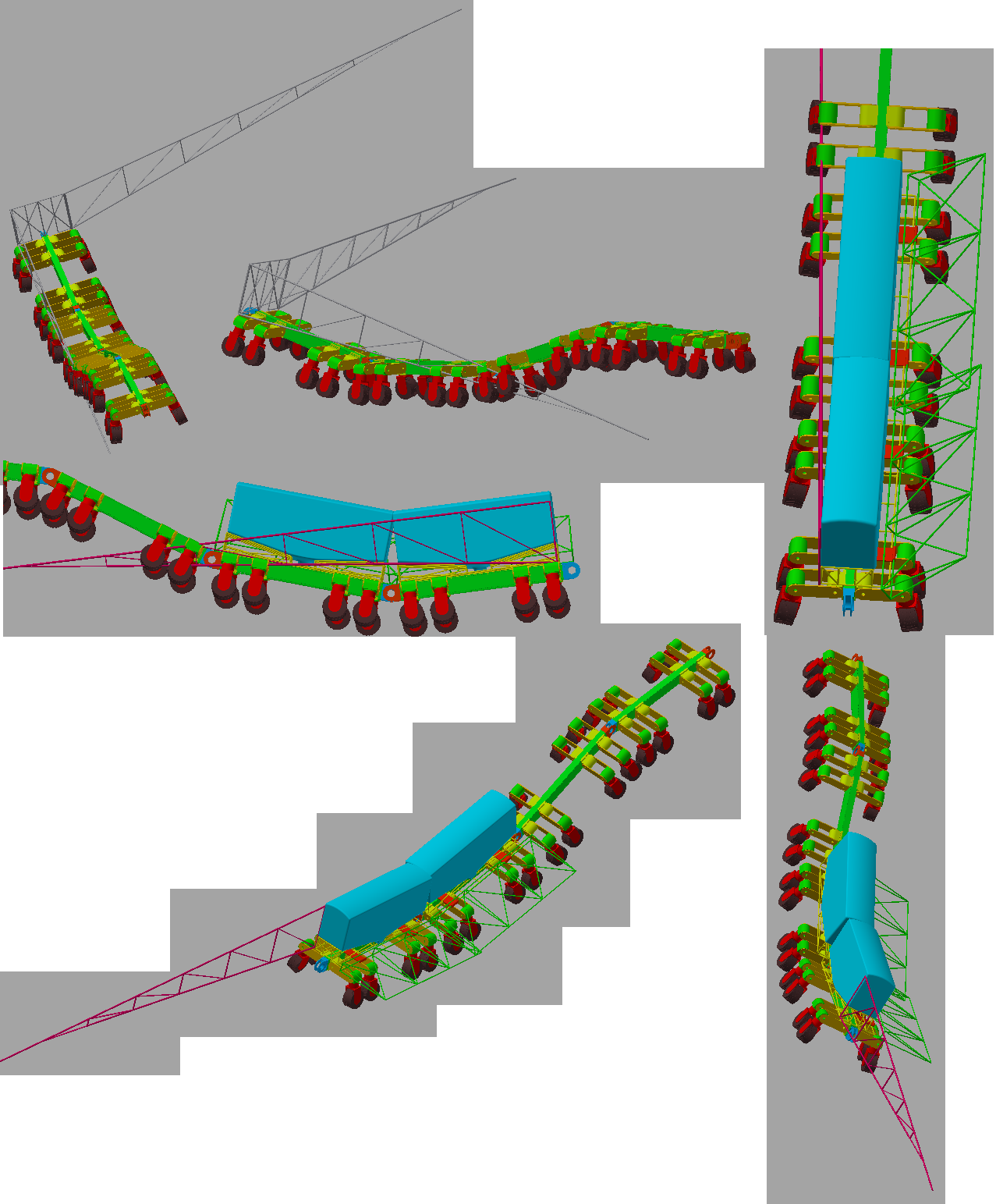

have not done a lot.
decided to try turning SSTT into a spray rig.
15 foot lengths per section 4 total sections for 60 foot lengths, and then another 60 foot each side booms, for 180 feet wide spray.
and then i got myself in trouble...
the 60 footer swing outs, when folded up, would tear themselves apart as they went into linkages for the wheels.
tried, mounting a couple tanks, and fold out 15 footer booms, and there all catching up were the sections rotate to allow for hills within the field.
overall, i think it could very well be possible. little tilt there, little longer there for over lap for the 15 footer booms.
ideas of how to make more of a universial connections. for sprayers, to wagons (box wagon), to trailer flat bed tops. is finally starting to hit me.
