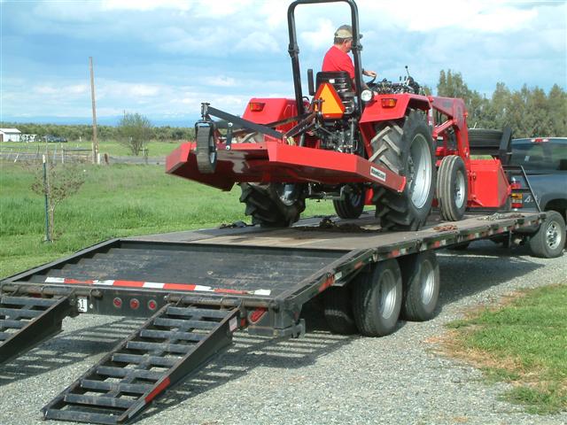

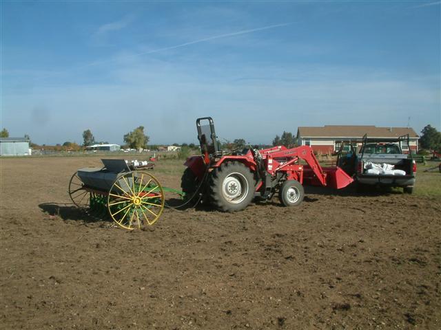

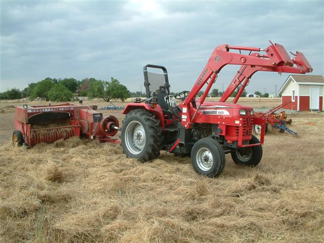

I have a 2008 Mahindra 5525 (3 cyl diesel, 54 hp engine, 45 hp pto) that I use on my 10-acre spread (flat pasture, 6 acres in oat hay right now).
The 5525 pulling my restored Minneapolis Moline P3-6 grain drill
The 5525 pulling my Massey Ferguson 124 baler
I mow the weeds on my place with the 5525 and a 6-ft Hawkline rotary mower (aka brush hog, bush hog, shredder, slasher).
The 5525 price was $12.7K with rebate. The front end loader (FEL) added another $4.4K and the brush hog was $1150.

Yep, the FEL is indispensible in my case since I move a lot of dirt, sand, gravel, mulch, etc around my place. It's handy for toting 50 lb sacks of seed 6 or 7 at a time when I'm using the grain drill in the hayfield.
You can add the FEL later, but dealers usually give a price break if you get the FEL when you buy the tractor.
