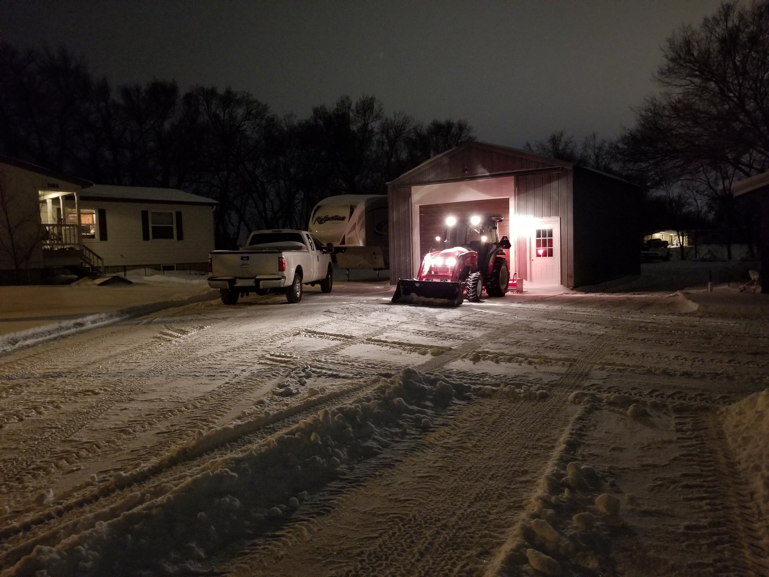

I just bought this plow replacing my bucket this year, but I also have an inverted snowblower MK Martin Meteor 68'' on the 3 point since I do not have drifting snow, but we can get 1-2 feet at times in one helping.
