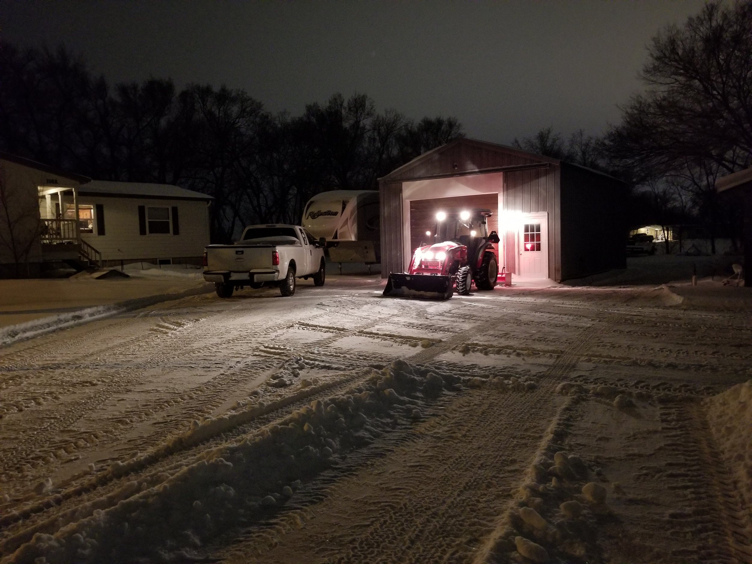

What's your average snow storm depth and type of snow? I just use a rear blade as we don't get enough to bother with a blower and our driveway doesn't drift in so big banks are fine. If you have a lot of wind you might want a blower.
Snow is a mix. I’d say more of a wetter, heavier snow than dry and powdery. We can get a 20 +in dump but it’s usually 6-8 in once or twice a week. Live near the ocean so yea it’s windy. Ty for the reply!

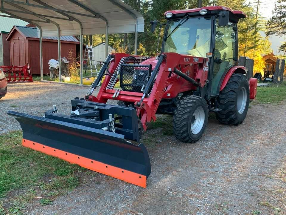

I just bought this plow replacing my bucket this year, but I also have an inverted snowblower MK Martin Meteor 68'' on the 3 point since I do not have drifting snow, but we can get 1-2 feet at times in one helping.
They are pushing a plow that looks similar to that. A land pride?
   / New tractor suggestions for snow removal #14
The plow is an MTG Industries DT86, yes on tractors 25Hp or less there is no regen. They are a lot simpler, when one buy tractor weight is more important that power in more cases than not. You can still do a lot with a large frame 25Hp tractor.
