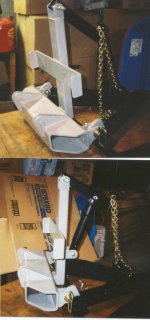

Do you by chance have any other pictures of this setup? I kind of like the direction you went in. I'm concerned about shock and vibration on the loader arms with a FEL plow.

The OEM Deere plow is black (this is a 7' Western Plow) and is 6' I believe.
The one shown is one I put together.
I will dig around in the archives for the quick attach pics I fabricated and posted some time ago. If I don't find them, I will post again, but don't want to load duplicates if not necessary. A couple of TBN members have made something similar, and one I remember was an improvement over mine.
Here is a thread showing a Meyer plow attachment.
Meyer Plow
   / New Tractor #14
In addition to the Meyer plow posted in previous reply, the attached pics show the quick attach with primer paint and some detail of the parts.
I built a wood model to get the configuration right and then took that model to a welder/fabricator to build it.
