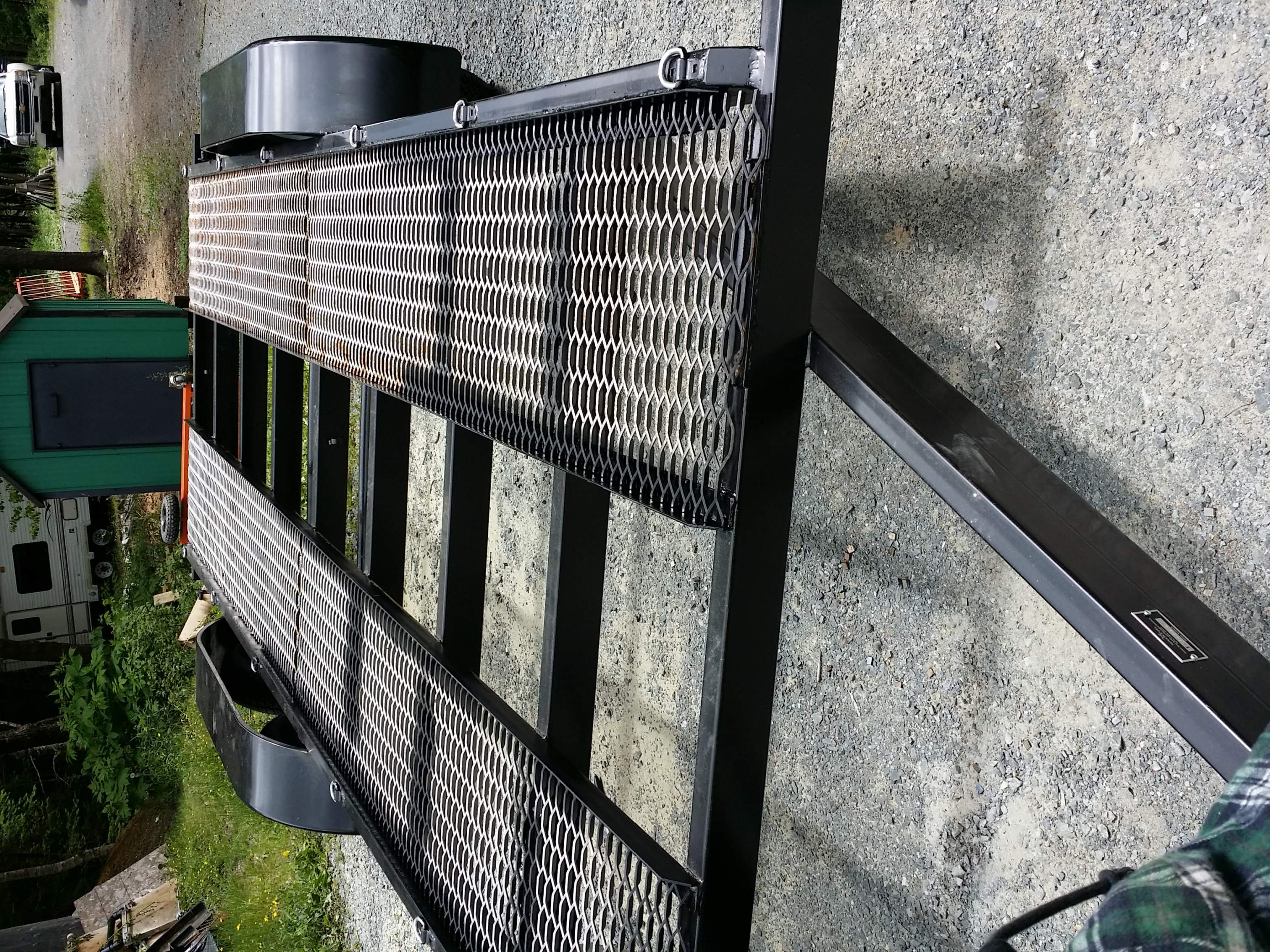

Finished putting deck on this morning. That 3# expanded is definitely a pain to cut. Two 4 x 8 sheets completed the deck with almost zero waste.
Now the painting has to be finished. Looks like spraying will waste lots of paint. Lots of air to paint.
Is the expanded metal going to be strong enough to support a 3500 lb vehicle if parked between the cross braces?
Are you going to make cover plates for the inside of the fenders to prevent dirt, stones, mud etc form coming off the tires and hitting the towed vehicle?
What is the tag you have on the tongue in post 49?
Very nice build.

My local metal supplier suggested the 3# as they supply quite a bit of it for car carriers. The clear span in the strong direction is only 20 inches and it's welded down every 8 to 10 inches. I'll know better when I load my 3500# tractor in a few weeks.
Haven't decided on the cover plates yet although I think I am leaning that way.
The tag is the serial number supplied by Department of motor vehicles which has to be verified in place on the trailer by the police before the trailer can be liscenced.
I figured that was what the tag was. Down here you have to completely build the trailer first then make an appointment to take it in for DMV inspectors to look at. They won't issue a tag until they inspect it and if they see something wrong they make you take it back home to fix then make another appt.
