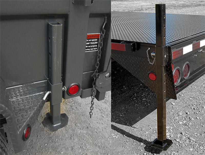

Those supports look like a good idea but how well do they work if on unlevel ground... say the ground is higher at the back end of the trailer being higher than at the wheels? Just wondering.
I did not say I liked the way some trailer ramps are made. The trailer I attached belongs to another member, Not me. I just posted to show pjb09 what I was talking about. When I had a trailer like that I always hunted for a level spot to load or unload.
Mark, that's why I mentioned the ramp feet to pjb. I have been on a few of those wild rides in the past. Personally I own a 20' tilt bed trailer and a 24' enclosed trailer for vehicles and a 16' dump trailer. No ramps on the tilt bed, back drops completely to ground for easy loading. If I were to have a non tilt bed for vehicles I would install the swing down adjustable jacks on the back sides of the trailer like pjb is going to do.

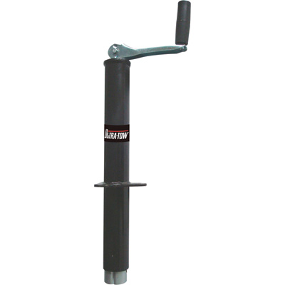

If you really want to get clever, put a tongue jack on each rear corner. Each side is now infinitely adjustable for slope both fore-and-aft and side-to-side.
Sixteen bucks each at Northern Tool
/ New trailer build #88
That's good stuff and add a foot pad for us folk that live in soggy weather! :laughing:

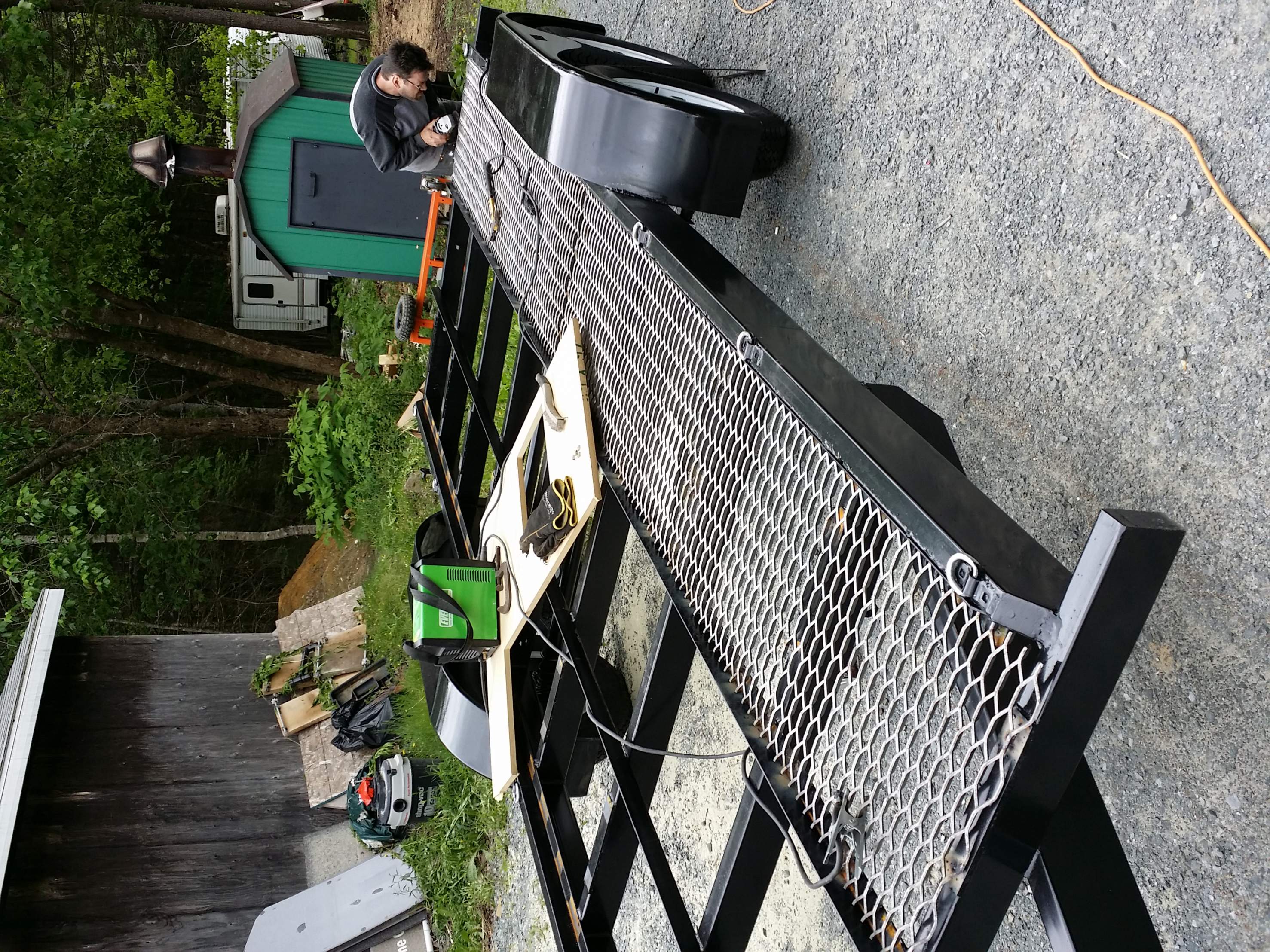

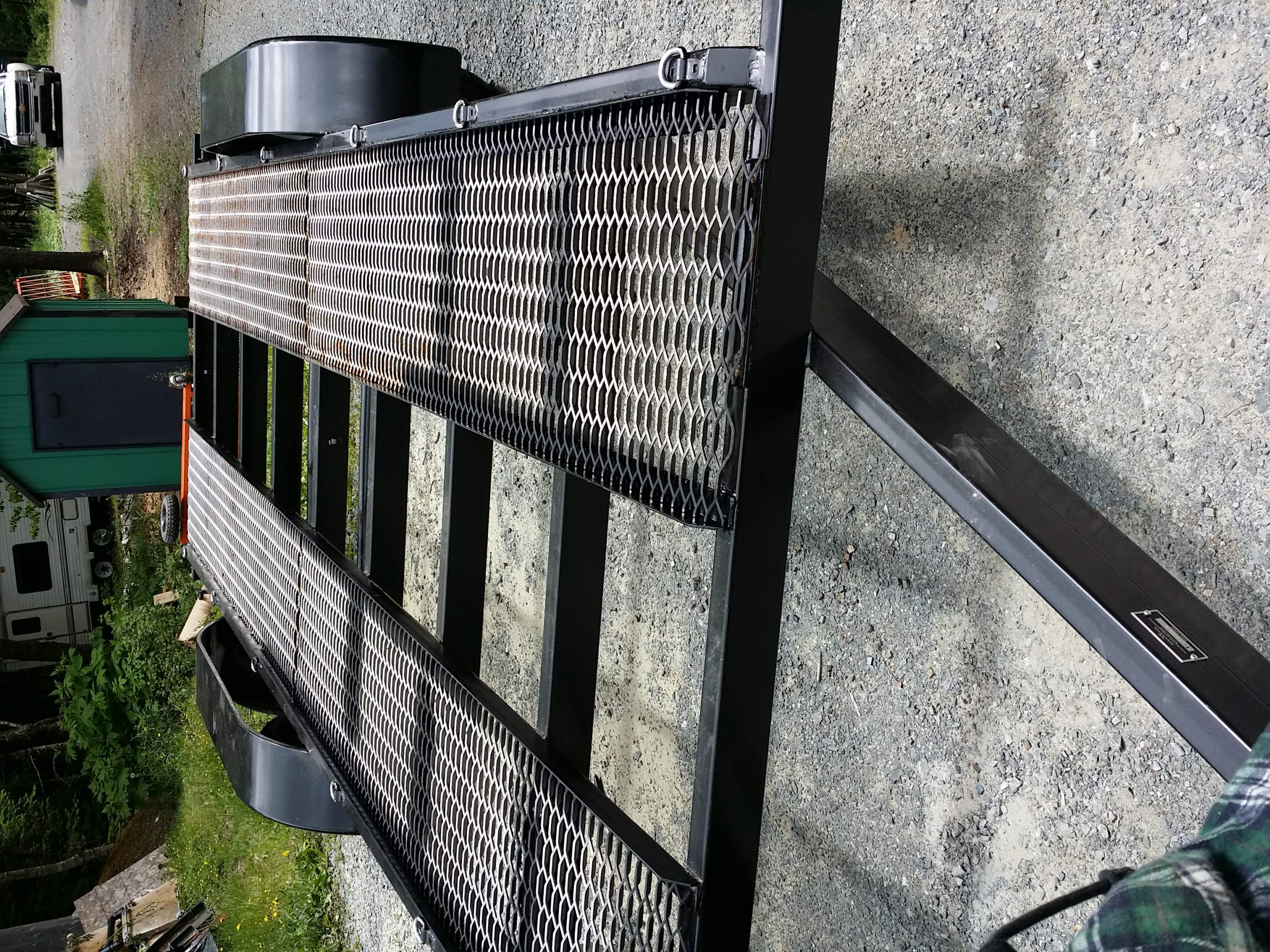

Just a few wire connections to make and it's ready for safety20140812_083747.jpg20140812_083902.jpg

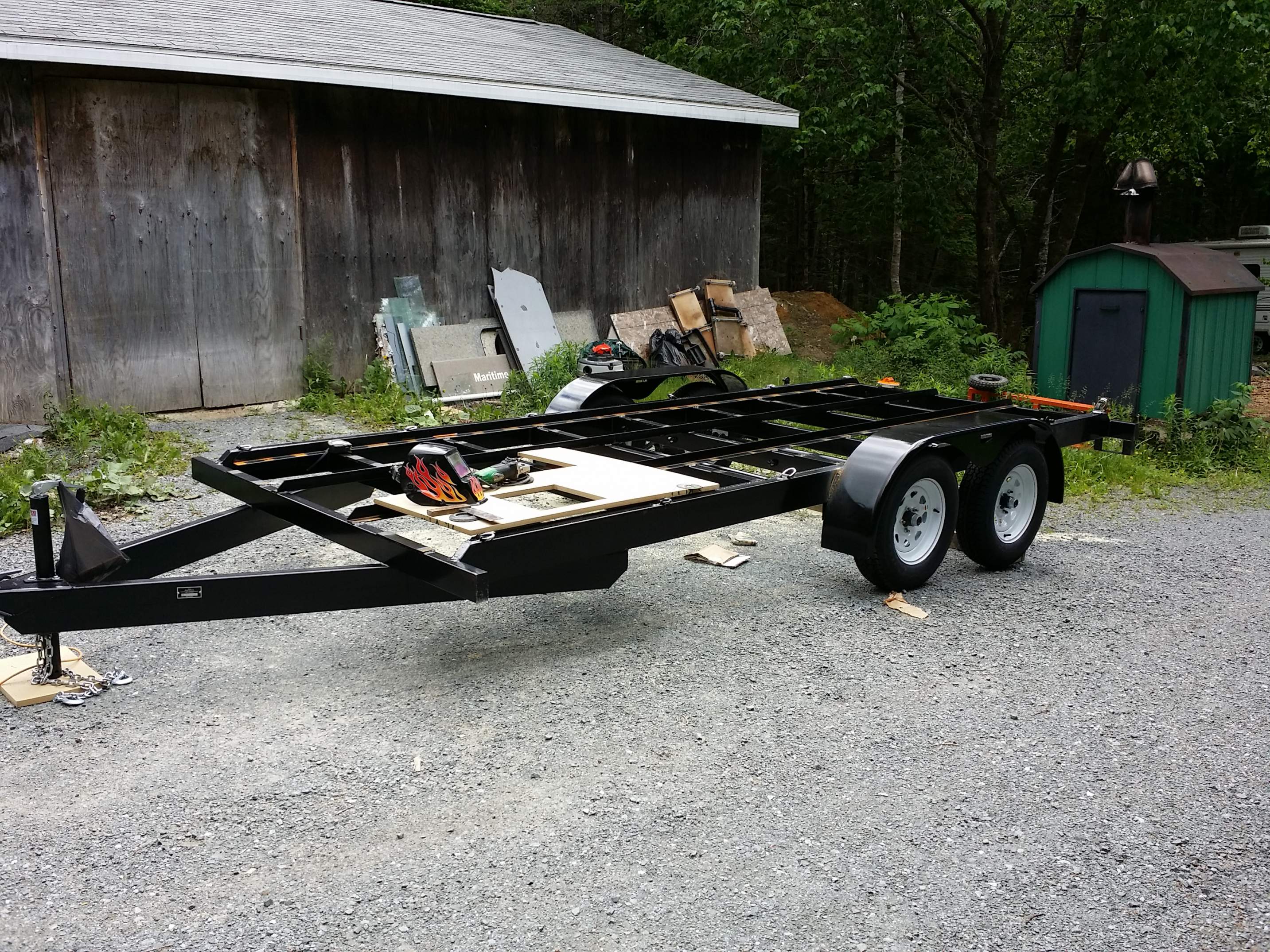

Finally got paperwork done. Trailer pulls great. Put tractor on to see how it fit.

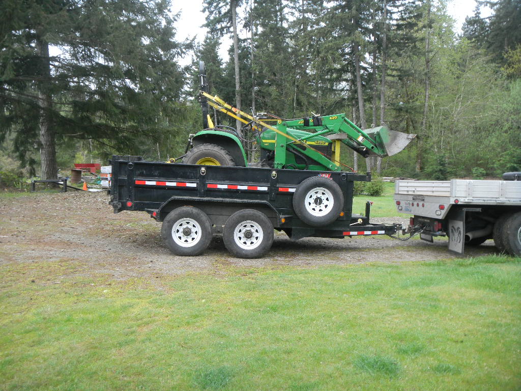

Looks great! Have you thought about putting some "legs" on the ramps to keep the trailer from picking up the back end of your truck when loading? I have had this happen to me, that's why I'm asking.
Legs on the ramps work good on flat ground, but I would suggest an adjustable rear support.
