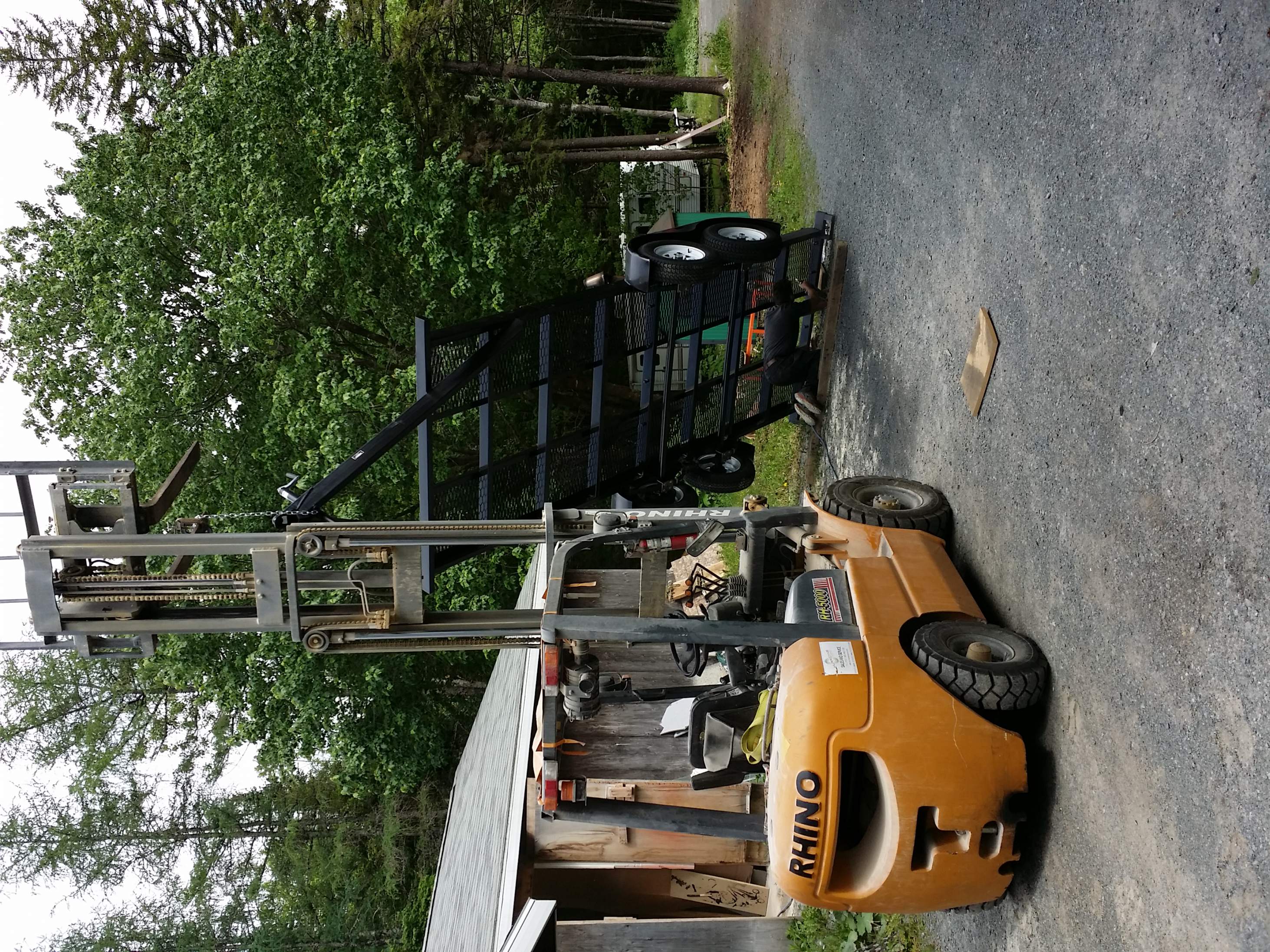

Painting the top of the deck was easy, but crawling around underneath with a spay gun wouldn't be much fun, so we made it easier.
/ New trailer build #67
Hey that's cheating! Nice job... I need a high bay and a lift. Don't think the wife is going to understand the benefits of a forklift. All my life I have been crawling, twisting, etc. Getting too old. :laughing:

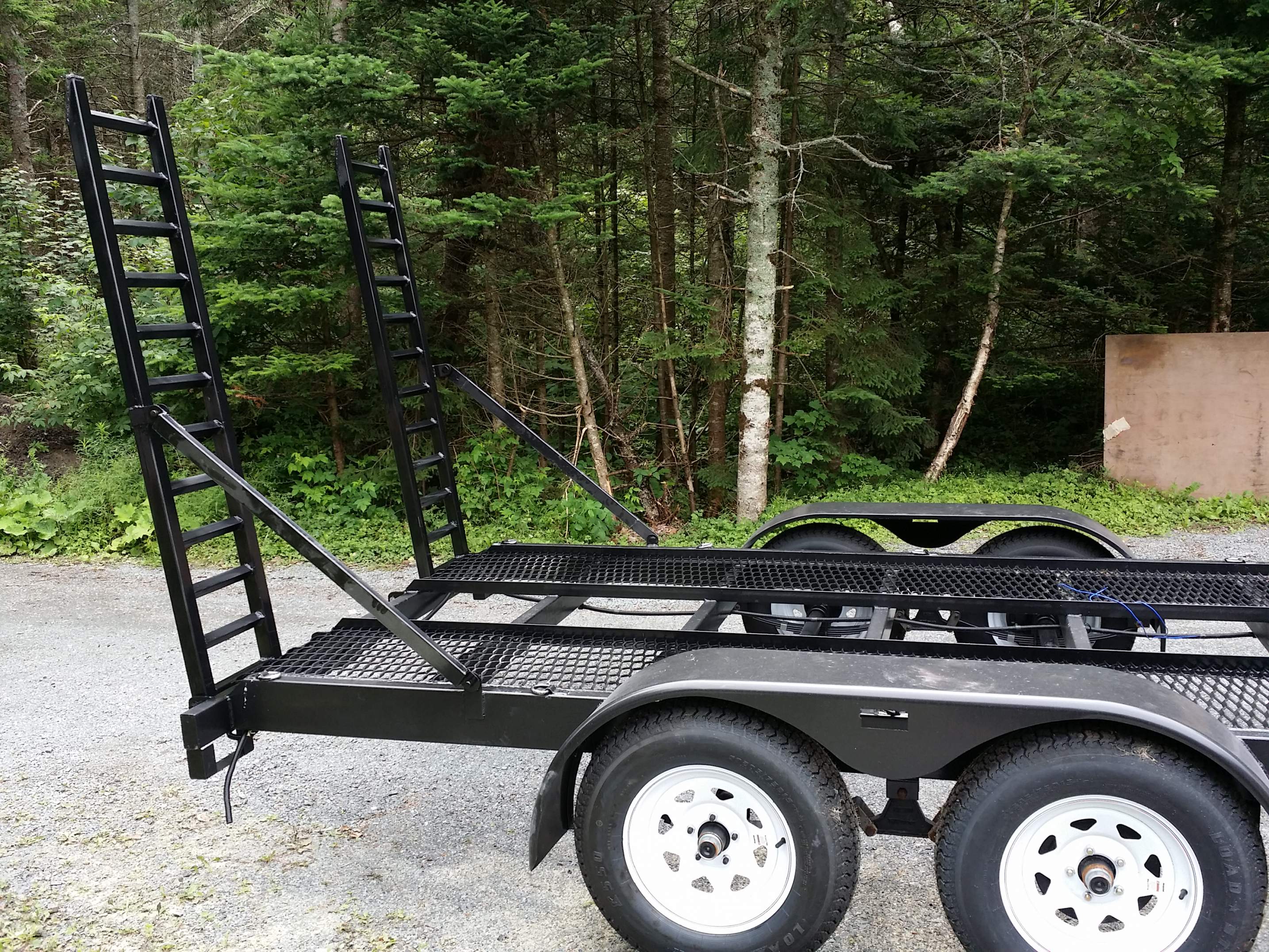

Finally got around to finishing the ramps and installing them.View attachment 384720
Looking good.
Since the ramps are already painted I guess your not going to add support feet (like attached) or you can add swing down rear trailer support stands to the trailer frame. They will prevent whatever you are driving up the ramps from pushing the back of the trailer down resulting in the front of the trailer lifting the tow vehicle.
/ New trailer build
#75
Looking good.
Since the ramps are already painted I guess your not going to add support feet (like attached) or you can add swing down rear trailer support stands to the trailer frame. They will prevent whatever you are driving up the ramps from pushing the back of the trailer down resulting in the front of the trailer lifting the tow vehicle.[/QUOTE
planning to add swing down stands similar to those on travel trailers.
/ New trailer build #76
[/QUOTE
planning to add swing down stands similar to those on travel trailers.[/QUOTE]
Carry on then and keep us posted on your progress.

Looking good. Since the ramps are already painted I guess your not going to add support feet (like attached) or you can add swing down rear trailer support stands to the trailer frame. They will prevent whatever you are driving up the ramps from pushing the back of the trailer down resulting in the front of the trailer lifting the tow vehicle.
Those supports look like a good idea but how well do they work if on unlevel ground... say the ground is higher at the back end of the trailer being higher than at the wheels? Just wondering.
/ New trailer build #79
Looking good.
Growing up in the heavy equipment business, I can't tell you how important it is to have all four vehicle wheels on the ground when loading. lol. If you've ever gone for a free ride down a hill with only the front wheels of the truck on the ground, it isn't that easy to steer if someone is on the backof the trailer holding on for dear life too....and front brakes on a 65 Ford flat bed one ton aren't that great to start with and when the engine isn't running....
/ New trailer build #80
Making the hinge points "double jointed" would help a bit for unlevel sites. Chocking trailer wheels is always a good idea also. Terry
