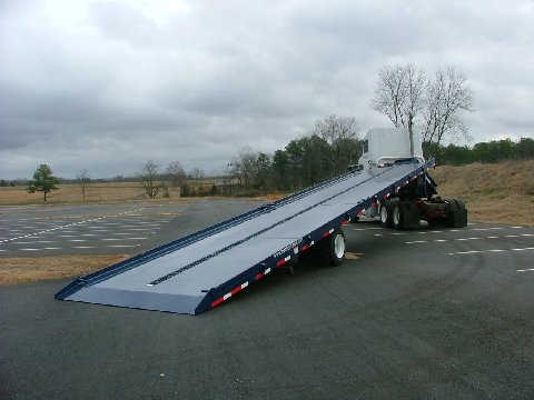

I have personally seen one of these used. It was pretty neat.
Rollback Trailers, Tilt Trailers & Heavy Car Haulers in Texas | Kwik Load Trailers
It has a hand brake that you lock down to hold the trailer wheels in place, pull some pins out in various places, and then back the tow vehicle up.

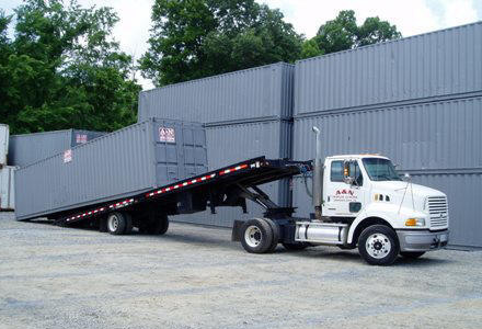

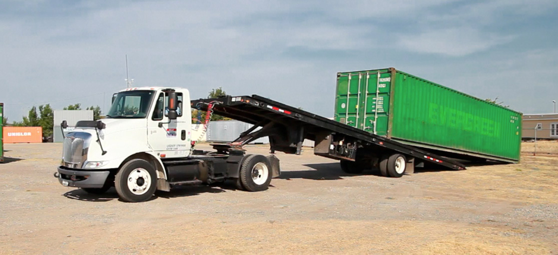

I have been searching on the internet but can't find it. Maybe you guys know who made it;
At work they hired a guy to move these metal ship containers we use for storage. He comes in with a full size tractor trailer tractor, and a single axle flatbed trailer(5th wheel of course to hook to the tractor).
It was amazing to see what this thing could do. The 5th wheel pin on the trailer was not mounted to the trailer fixed. The pin was mounted to a hydraulic mechanism which let him raise and lower the whole front of the trailer in relation to the tractor.
Along with this, the single axle dually wheel set was not mounted stationary to the trailer either. It was mounted on some sort of track system and a very long cylinder. He could move the axle forward and back several feet. I am not sure what all else it would do, but he was controlling the whole thing by remote control, walking around the whole thing while he was working it.
