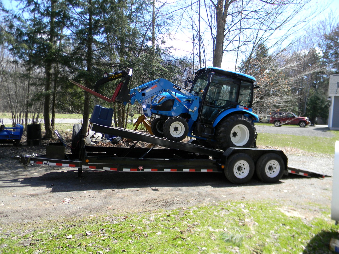

I recently finished my trailer research and what I settled on was a 20', 14k#, low-profile, tilt-deck from Load-Trail. The TL14:
*NEW* Low-Profile Tandem Axle Tilt Deck 14,000 Lb 6" Channel Frame Load Trail Trailer Manufacturing
I chose it because the tilt deck design means easy loading and unloading and no messing around with ramps. The 4' stationary section gives you a place to strap down an implement or a pallet and still be able to tilt the deck. It's more pleasant to load and tow since it's so close to the ground.
I considered power tilts and a lot of other stuff. In the end, this was my favorite option. If your M6800 fits between the wheel wells, I think it would be a good option for you.

I have a PJ 14K full deck tilt trailer. They also make full tilt deck over trailers that would work for you.

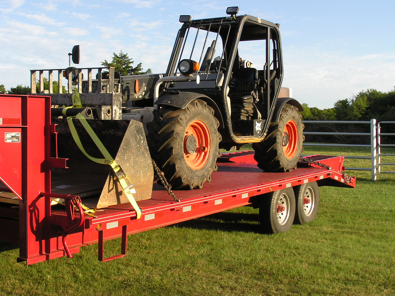

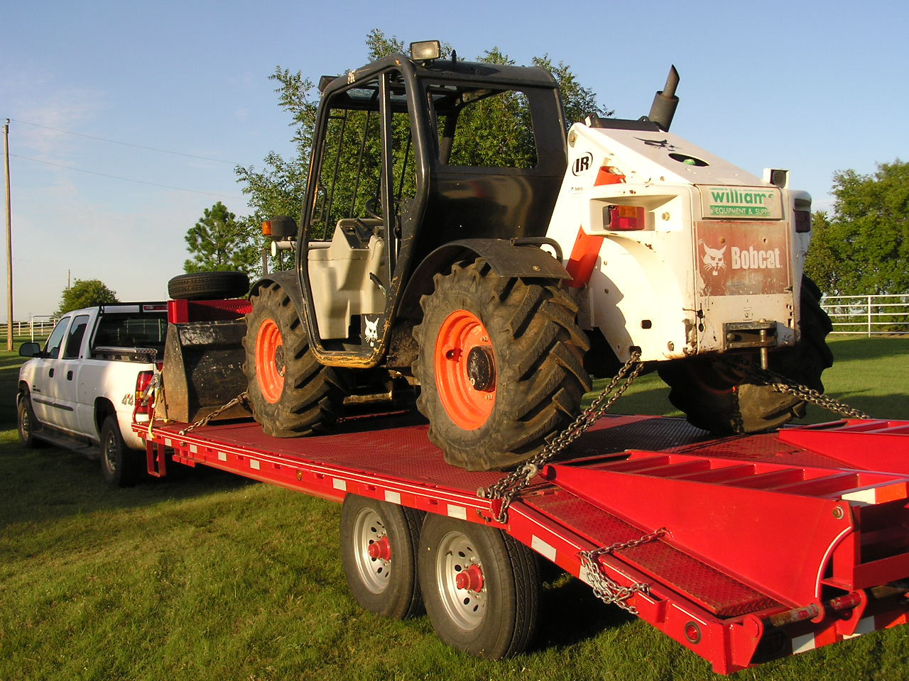

Here is my 2006 GMC 3/4 ton with the heaviest load that I ever puled. Hauled from Rogers, AR, to west of Oklahoma City in September of 2009.
12,640 on the deck, 3440 on the ball, 14,200 on the axles. Was very stable.

I agree. No need for a 1 ton for the right size trailer. I pulled a 7 ton 25' deck over gooseneck daily with an '04 GMC 2500HD. Truck was rated for 15,400. Never had any issues even once when I overloaded it with a 15,000# ish scissor lift that I hauled 80 miles. Plenty of options of deck over that are well suited to 3/4T SRW trucks

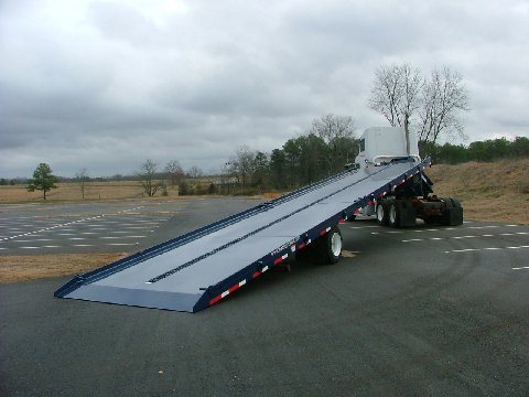

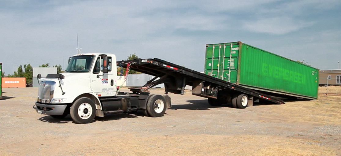

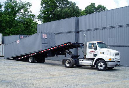

I have been searching on the internet but can't find it. Maybe you guys know who made it;
At work they hired a guy to move these metal ship containers we use for storage. He comes in with a full size tractor trailer tractor, and a single axle flatbed trailer(5th wheel of course to hook to the tractor).
It was amazing to see what this thing could do. The 5th wheel pin on the trailer was not mounted to the trailer fixed. The pin was mounted to a hydraulic mechanism which let him raise and lower the whole front of the trailer in relation to the tractor.
Along with this, the single axle dually wheel set was not mounted stationary to the trailer either. It was mounted on some sort of track system and a very long cylinder. He could move the axle forward and back several feet. I am not sure what all else it would do, but he was controlling the whole thing by remote control, walking around the whole thing while he was working it.
