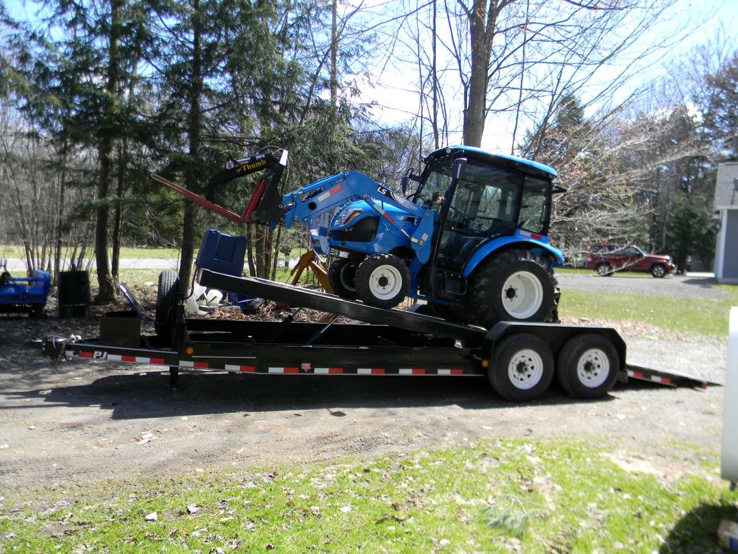

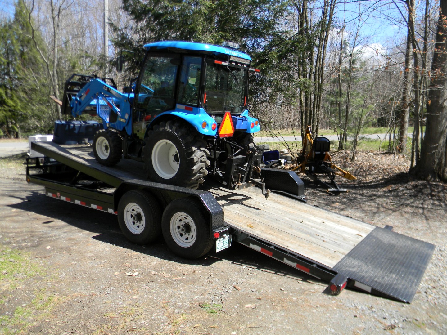

I recently finished my trailer research and what I settled on was a 20', 14k#, low-profile, tilt-deck from Load-Trail. The TL14:
*NEW* Low-Profile Tandem Axle Tilt Deck 14,000 Lb 6" Channel Frame Load Trail Trailer Manufacturing
I chose it because the tilt deck design means easy loading and unloading and no messing around with ramps. The 4' stationary section gives you a place to strap down an implement or a pallet and still be able to tilt the deck. It's more pleasant to load and tow since it's so close to the ground.
I considered power tilts and a lot of other stuff. In the end, this was my favorite option. If your M6800 fits between the wheel wells, I think it would be a good option for you.

I have a PJ 14K full deck tilt trailer. They also make full tilt deck over trailers that would work for you.
PJ Trailers - Deckover Tilt (T8)
First off thanks to everyone for helping, I must not be as good at searching as I thought I was.
George that is the trailer I had settled on except it was a deckover and if the dealer had one when I got there I would have gotten it. but now with all these options I have, I will have to wait and see.

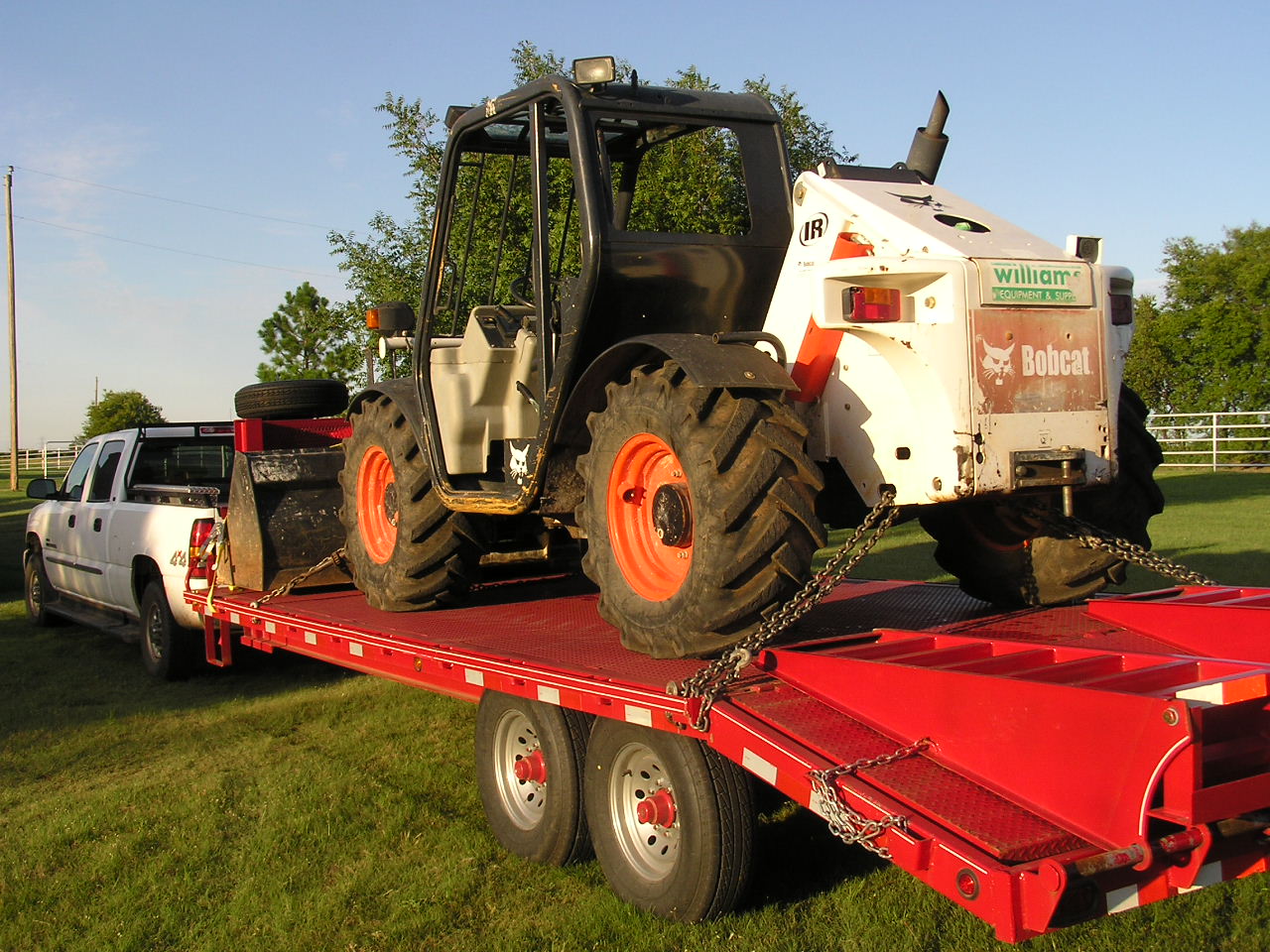

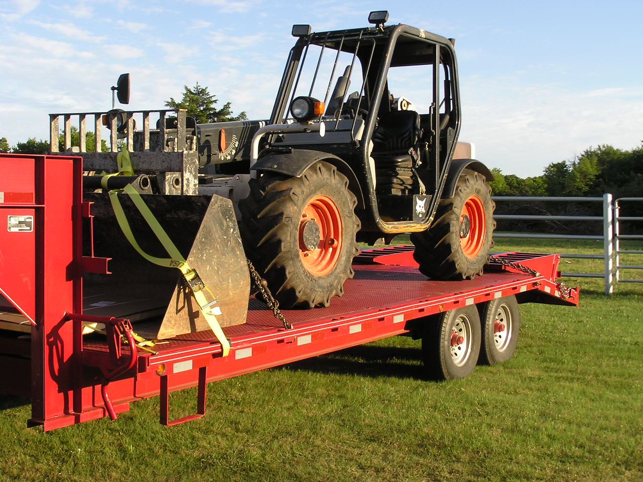

If it is a gooseneck the 3/4 ton will handle it just fine.
Here is my 2006 GMC 3/4 ton with the heaviest load that I ever puled. Hauled from Rogers, AR, to west of Oklahoma City in September of 2009.
12,640 on the deck, 3440 on the ball, 14,200 on the axles. Was very stable.
