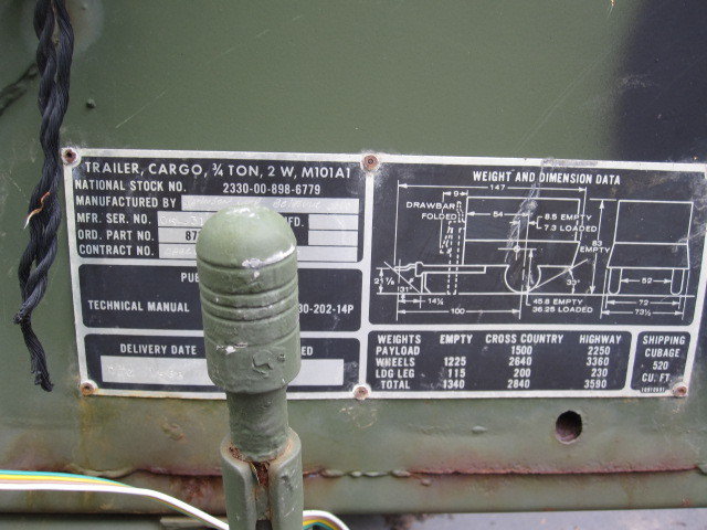

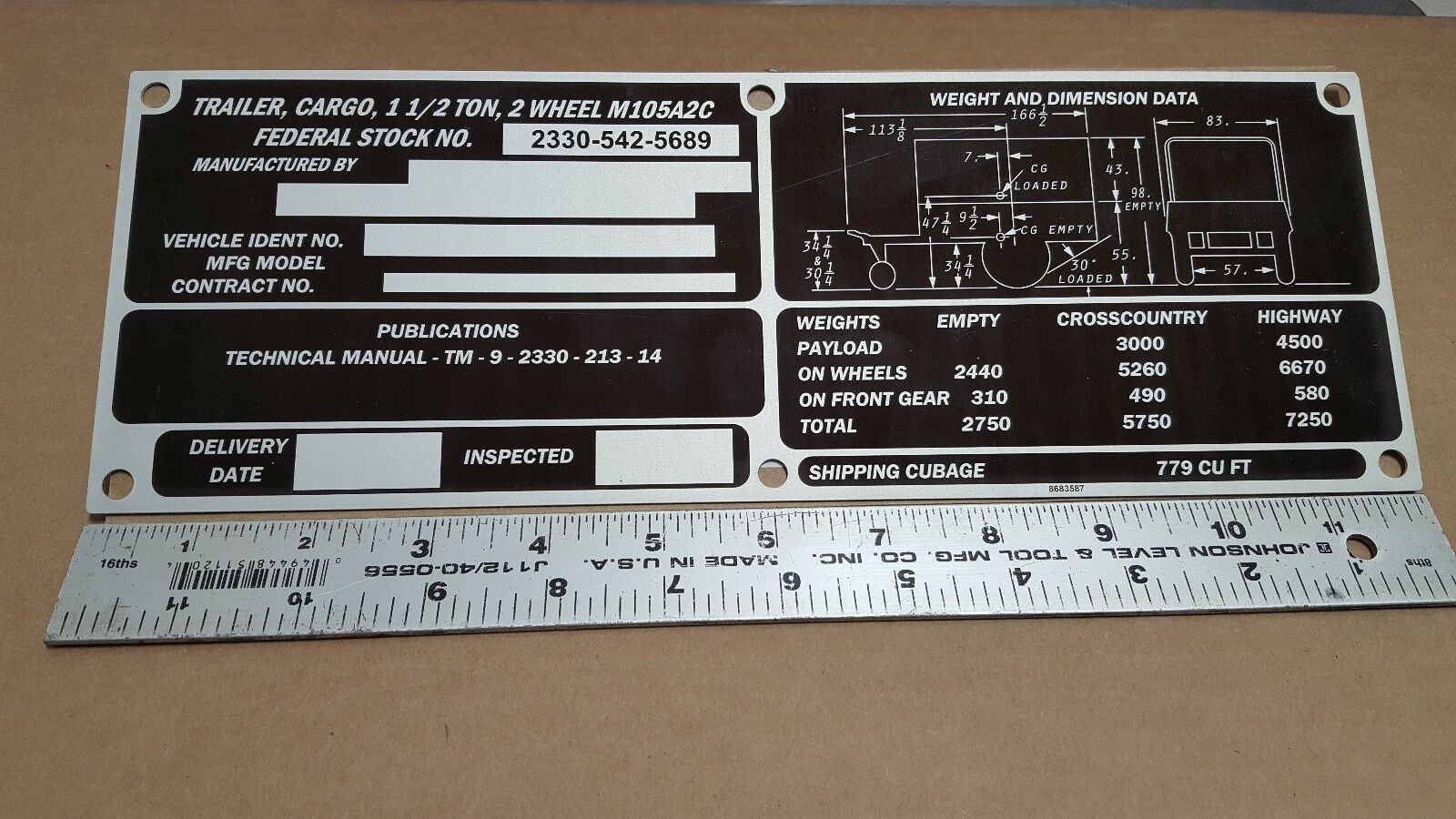

What do you guys think about the 5200# axle on a single axle trailer? They seem to be like unicorns, definitely something that would need ordered. But then I started wondering if it's really worth it. In the situations where I'd be pushing the weight capacity limits, I'd be pulling it with a tractor at low speeds. I'm wondering if that affords me a little more capacity. I figure they're designing a 3500# axle to handle the stated loads and deal with a pothole or rough hit at highway speeds. But in this situation, while it would be on uneven terrain, it would be very slow and easy when used with a heavy load.
