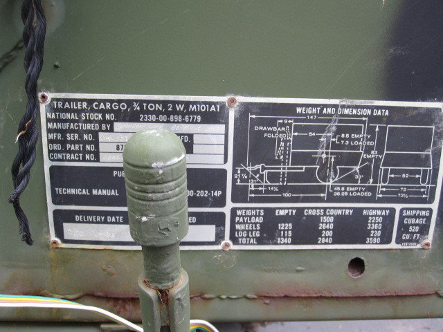

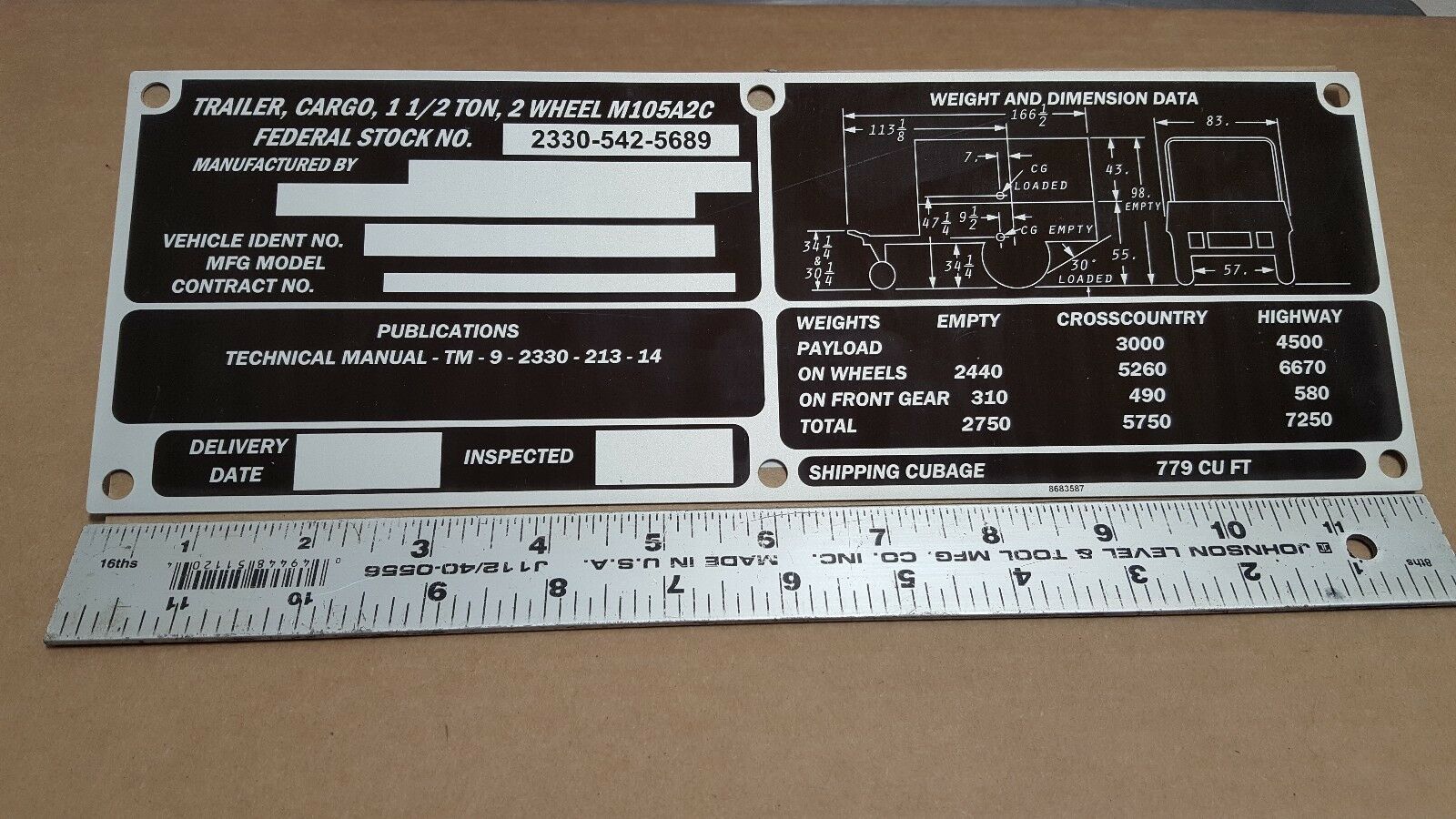

The military rates trailers for a lighter load when used off-road.
View attachment 664303 View attachment 664302
Bruce
Interesting, thanks for posting that. Still, I have to figure when they came up with the cross-county payload rating, they were figuring it potentially moving at traveling speeds. I'd be moving at a slow creep pulling with a tractor. Not saying I'd be good to go, but I'm not sure if it's entirely comparable.
That pic leads me to question something though. For the trailer I linked above, the GWVR is listed at 2990#. That's the weight of the trailer plus the payload. But are you supposed to subtract the weight being applied to the tongue supported by the tow vehicle hitch?
