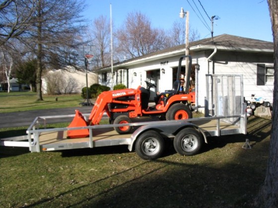

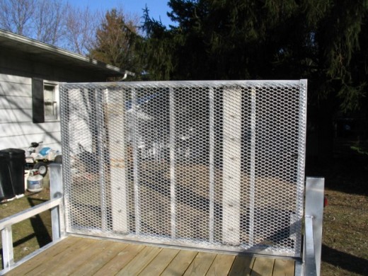

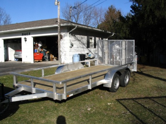

Well I picked up my new trailer last weekend and am in the process of getting it setup for towing my BX. It is an aluminum trailer and I decided the gate would need some reinforcement to handle the BX as the supports were not on line with the tires. SO I went to my local Fab shop and had them weld in some 5" aluminum C channel to handle the unit. Works perfect now!
Next I need to get the tiedowns mounted. I had the fab shop make some 1/4 steel backing plates about 3x3 1/2" to put under the deck boards so I can mount the tie downs. I am also planning on making sure that the steel plates will overlap the lip of the C-channel supports that run across the trailer.
Anyhow, here are some pictures....first is my old trailer setup for perspective. It is a 6x10' that is in the local Shopper for sale.

Now for the new one with the Kubota on it /forums/images/graemlins/grin.gif I ended up going with a 16' even though I almost bought the 14' but last minute decided I probably would never regret the extra 2'. Glad I did.

   / New Trailer For My BX
Heres another
Heres one without the tractor
Heres the gate with the new supports
Last one with the other side of the new gate supports.
