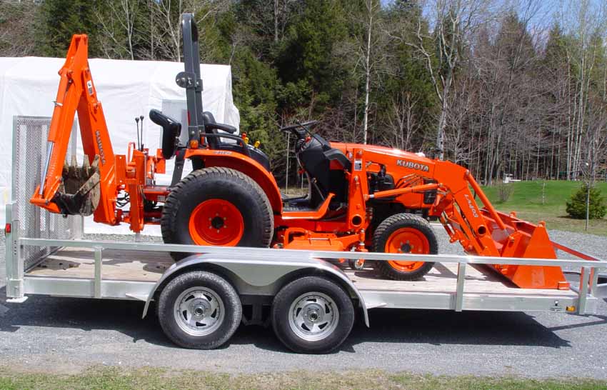

Here's the pic I was supposed to get with my BX23. It's gone now. So I took it with a B3030. Nice trailer.

Very nice, she's lookin a little tight though /forums/images/graemlins/blush.gif I see you also have the jack stands on the rear. That looks like a nice feature. Did you reinforce your gate as well to support the tractor?
   / New Trailer For My BX #53
In fact, yes I reinforced it but usually I use 8' steel ramps. They are tucked beneath the bed. Why 8'? Because a BX23 has a very small angle of departure (the backhoe is low and greatly reduces the angle). No problem with a BH75 though.
To anyone who plan to buy that model, a BX23 can't be loaded by the tailgate. The backhoe will hit the ground long before the rear wheels touch the tailgate (I learned the hard way). You need ramps to lower the angle. I like my trailer but sometimes you have to face some problems like that one.

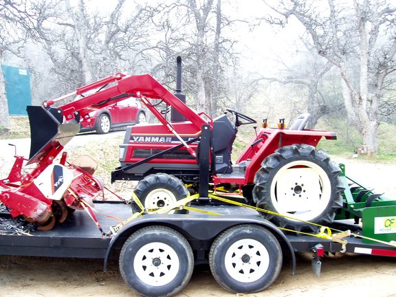

70boss1: Fill out your profile, then use the search feature to see why nylon ratchet straps are NOT safe for hauling a tractor. Finally welcome to TBN. Allot of great info here. /forums/images/graemlins/wink.gif )</font>
I got this tie-down system off a website that sells towing equipment. They are big nylon tiedowns that go through a keeper strap. The idea is to tie the tires down, not the car/tractor. It lets the suspension (on a car anyway) work and not loosen or tug on the tie downs. You can kind of see them in the picture. Because of the largeer rear wheels, I just ran one set of straps over the cross bar for the FEL. I really love the system, it's very secure. At the towing trade show, they have a roll back with a car tied down with these things, turned UPSIDE DOWN! Very impressive. 1888TOWPART is their number. These guys have a nice one too: wreckerstuff
