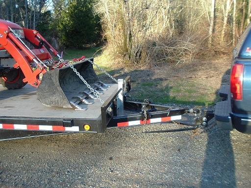

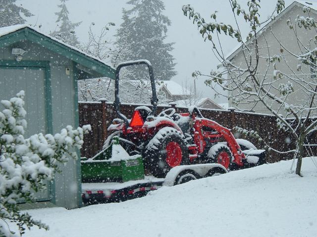

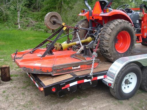

My removable ramps, on a PJ trailer, slide on a rail very similar to the pictured BigTex. Rather than stake pockets, PJ used little chunks of steel to hold the "rod" in place and away from the trailer to allow the ramp lip to catch. Cut a little noth in the ramp in just the right place. It will help you locate the ramp each time as well since you will not always have the tractor right there to measure it with.
I use no safety blah blah to hold the ramps down, they stay put just fine while loading.
I also regularly unhook the loaded trailer from my truck. Right now my trailer is loaded with a tractor and mower for a quick evening mow job after work. The PJ trailer has a very stout tongue jack with a foot under it. I've left the loaded trailer for months on end.
Do NOT consider loading, unloading, moving, or other jacking around of the tractor while on a trailer detached from the truck.
