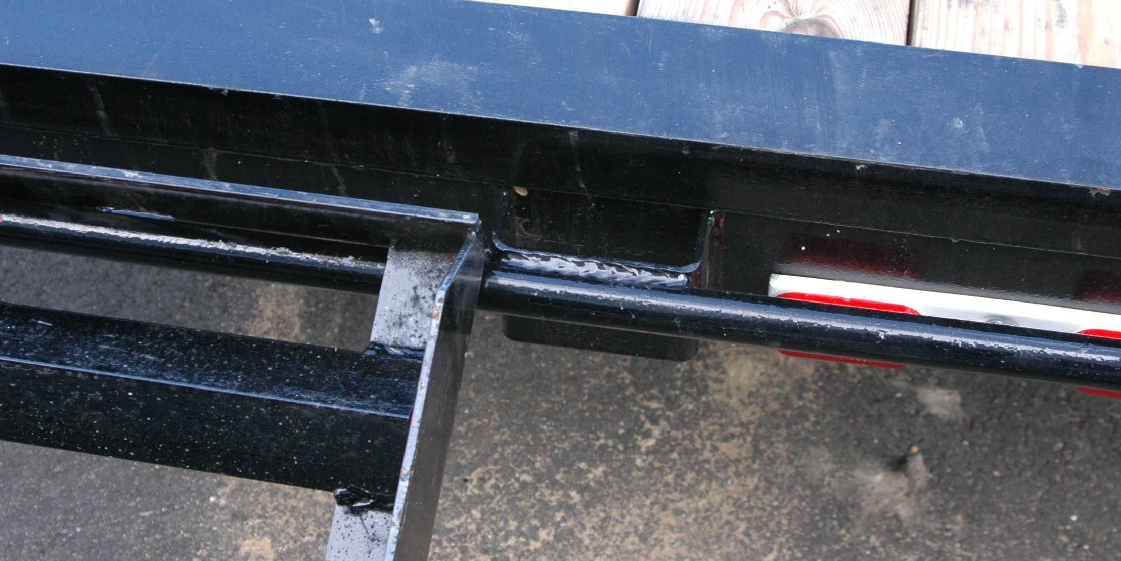

Hi All!
I have been following all of the posts and did infact cut a slit in the ramp to go over the stake pocket. That appears to will work ok when I get a chance to try it. I do like the idea of some safety latch and am pondering my options. I'd like to place this in the middle. to balance any uplift as there is a slot already there for the ramp locks. The 2305 has a fixed rear wheel. I believe it could be set wider, however the ramps , now put both tires ( by measure up the middle. Once I get it up, and more importantly off the trailer, I'll feel i've accomplished something JIM

   / New trailer HELP!****Bummer! #24
I have been using a 60CH big tex trailer for almost 20 years and have these type of ramps. I load tractors , cars , trucks , miles , etc. and I have to say I have NEVER had any trouble with the ramps coming off the rear bar. I suppose It could happen, But I just have not experienced it.I also have a number of heavy equipment trailers, like belshe, and bruton, that have exactly the same type of attachment. These are for d-6 caterpillers. I haven't seen any way for the ramp to come UP when it has 35,000 lbs pressing down on it, which in turn presses down on the trailer rear ledge. I cut a notch in mine in order to load the riding mower from time to time. I think many on this thread don't realize just how low to the ground the rear of this trailer is. Upon loading I often only have 6 to 8 inches in height at the front of the ramp to the ground. If it could fall it really might not be that big of a deal . Again- I may have been fortunate but I have never had any trouble with big tex ramps.

If you notice in my signature, I have a 70ch. I have loaded all sorts of equipment on it and have regularly OVERLOADED it. I have loaded tractors that pushed the tail of the trailer all the way to the ground.
I have never had a ramp come off.
The trailer was not designed for tires as narrow as yours.
Get a bigger tractor.:D
Just kidding.
It should be a simple matter for a welder to put stake pockets closer together and remove the existing pockets so you can get your ramps close enough.
I'm not sure I completely understood some of the other suggestions but personally, I would measure, mark, and slit the part of the ramp that hangs over the bar, letting the ramp drop[ down into the stake pocket.
You aren't going to weaken them enough to hurt anything.
Just my opinion.

Thanks Allen:
Did that and some of the other suggestions. Cut the slit for my Deere And then loaded a friends Kubota which was narrower, and it stayed on.
JIM
