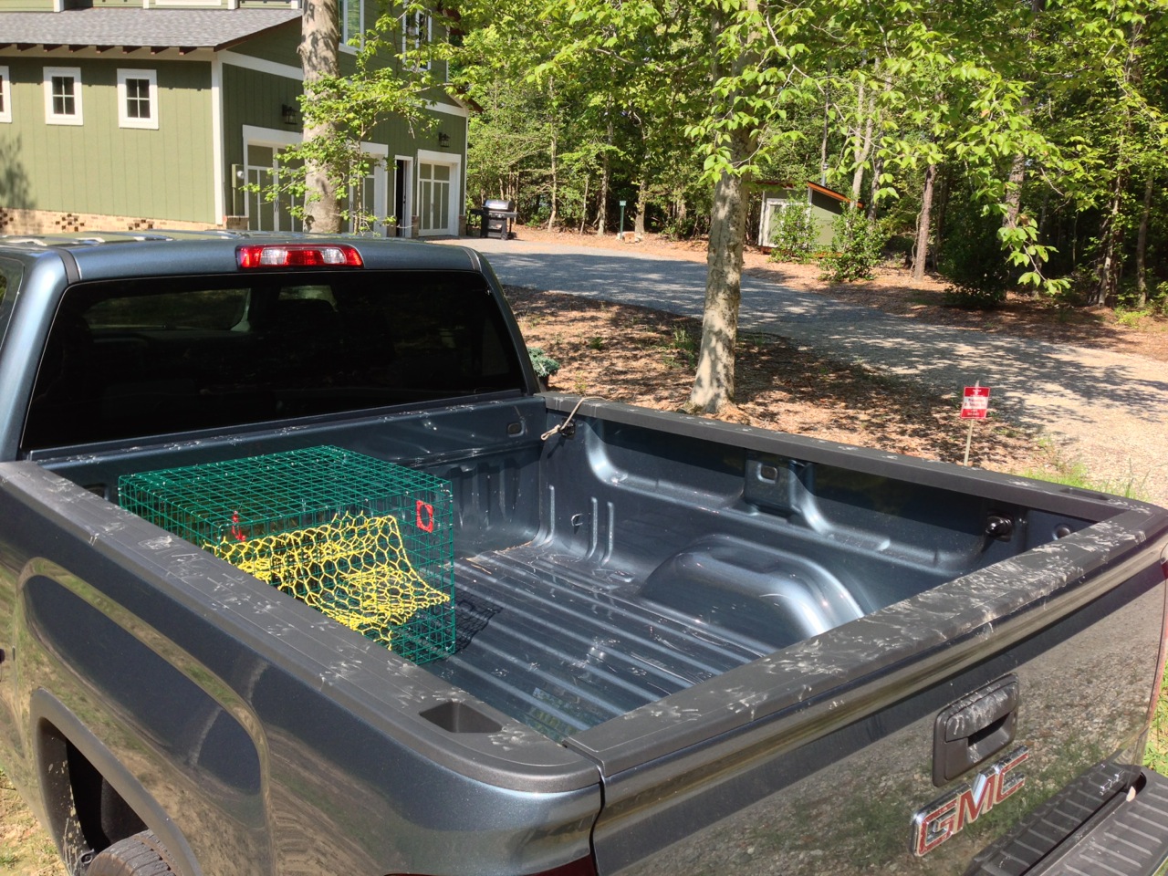

I still haven't got a bed liner. The bed is developing a nice patina of scratches, which I like. This isn't going to be a Barbie truck! Though I did have a real mess a couple weeks ago -- I brought home some new crab pots, and left one in the bed overnight as my hands were full. Came out the next morning and it looked like a herd of raccoons crawled all over the truck. Not sure what was so interesting about an empty crab pot (and it was new so it didn't smell yet), but they got muddy clay footprints all over the truck in the process of climbing into the bed. When a downpour the next day had no effect on the clay, I grudgingly pulled out the bucket and hose.
