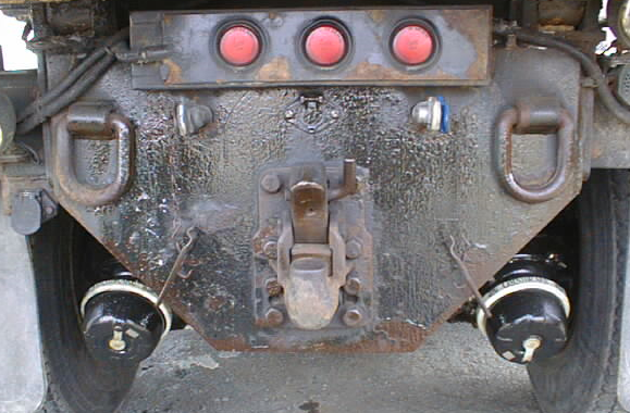

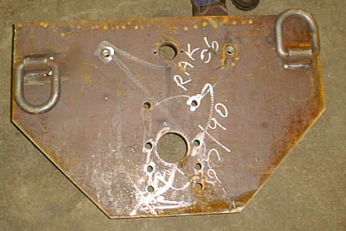

I found a couple of old pics I had taken of a tailplate, two 1/2" NPT couplings either side for trailer air, center hole for electrical, bottom holes for a 50T air cushion pintle hitch and of course the D rings. If it's in your budget, the air cushion pintle saves a lot of banging, not cheap tho.

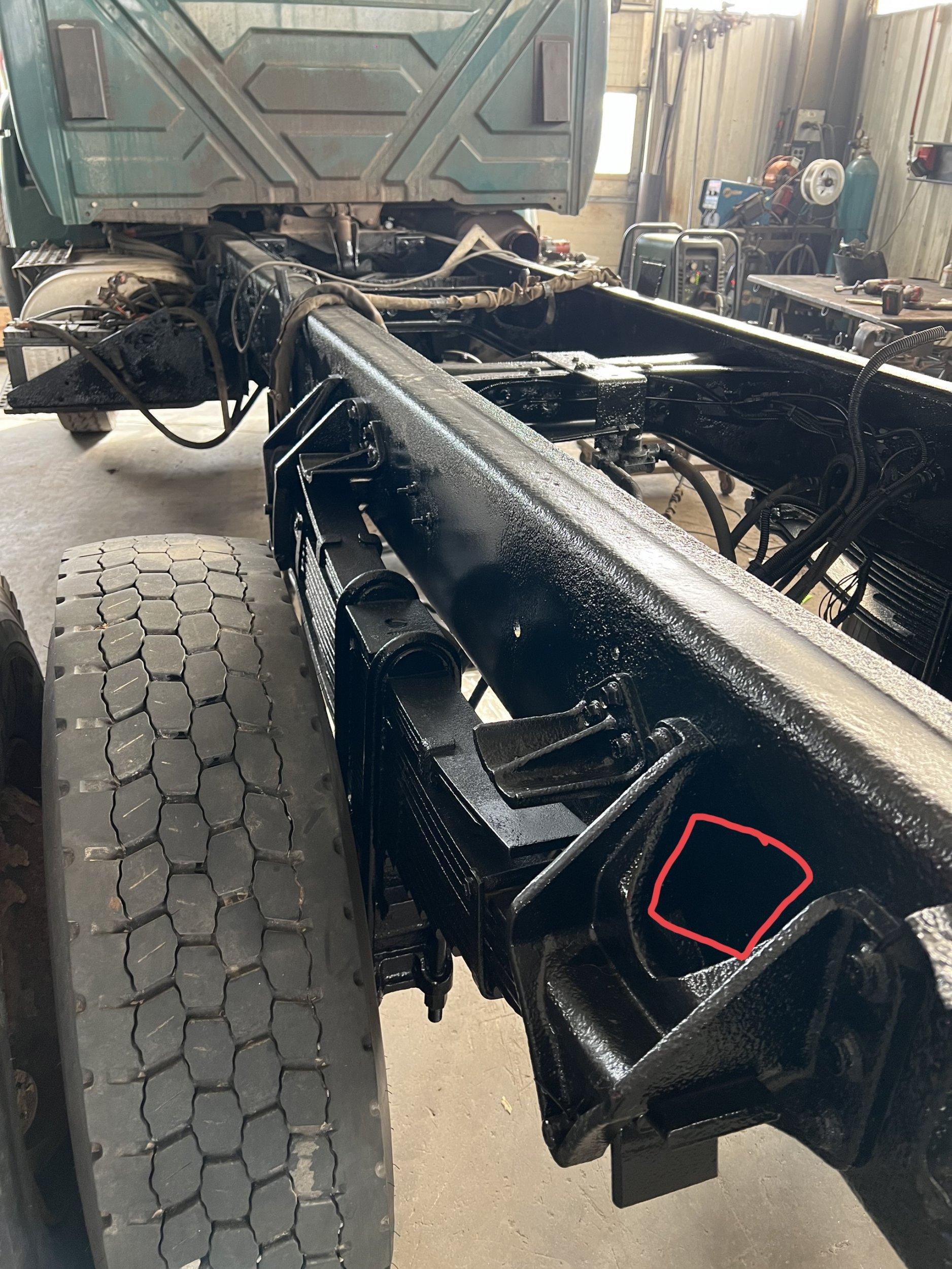

The best way I could describe the rusted are is it is inside the 6 bolt area where the rear spring hanger is. It looks like the outer piece of frame is about 50% rusted away. The inner piece of frame is fine. What concerns me is that area is under a lot of stress from the suspension hanger and it being the fulcrum of the the dump hinge/pins.
Maybe I am over-thinking this, but I feel like doing this now would be a lot cheaper than a big “UH-OH” later once the body is mounted.
The truck is at a welding & fab shop. They can build or do just about anything. I do what I can do, and they do the rest. Very nice people to work with.
Here is where the outer frame is thin (red box). A pile of asphalt sat in here for probably years, held in moisture and deeply rusted an area of the frame about the side of a fist.
Ultimately it's your decision, I understand the , "pay me now or pay me later" decision you have to make.
I don't think there's a bad choice other than doing nothing. Looking back at the options we've talked about.....I'm leaning toward the shorten the crossmembers and put a doubler inside the frame.

More info incoming. IH parts diagram does show a pin. :( not surprised.
I may have to reinforce from the inside as you suggest. I would lose the feature of covering the rougher frame with a smoother piece.
It would actually be a “tripler” :)

So I did some more pausing and gathering information on the truck. Spoke with a company in Ohio that installs beds and we got to talking. The guy was very knowledgeable. He spent 20 years in the shop doing frame work and mounting dump bodies on trucks.
What he told me surprised me a bit.
He said he would not bother reinforcing the frame.
He said to cut the last section off of the outer frame that has the rust issue (it’s about 18” long), and simply butt weld a replacement piece in place of it, then put a set of 5/8” bolts on either side of the weld and call it a day.
