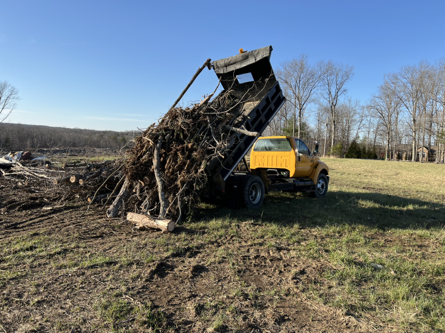

I never liked dog house built in the front of the bed of my last truck. It made loading logs hard and it’s also where dirt would start sticking the worst.
I can see dirt sticking and the log problem but you don't need a doghouse just because it has a telescopic hoist. That load looks like a pia no matter what you have
A telescoping cylinder provides zero sideways stability to the bed and the whole job falls on the bed pins where a scissor hoist helps with stability.

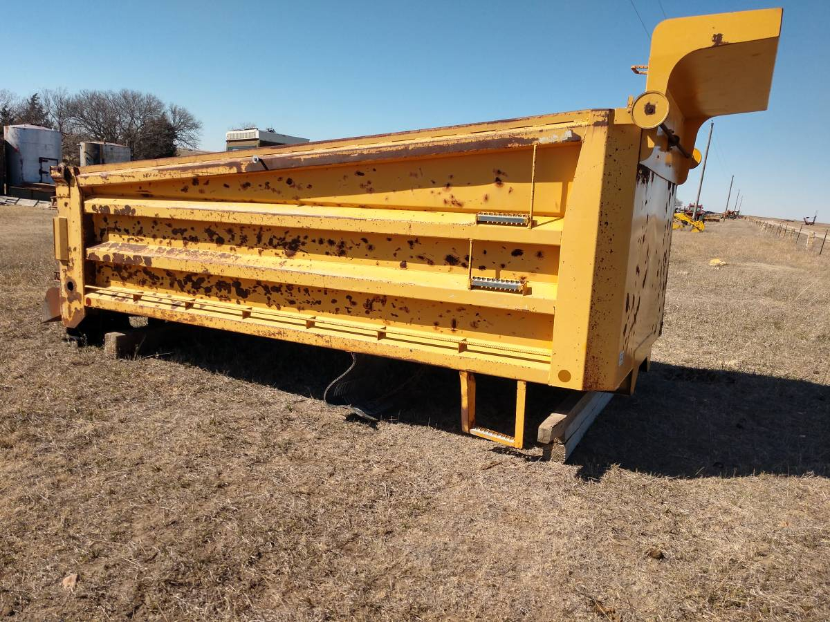

Something poped up on my local craigslist that reminded me of this thread.
This isn't what you're looking for, but at $2750 you could afford to modify it if you like it as a starting point.
15x8 henderson dump bed, no hoist

Thanks for that!
I am now in the process of getting the truck mechanically repaired, which buys me a little more time for finding a dump body.
I wish this truck took a 10’ body.
I’d be done and using it by now.

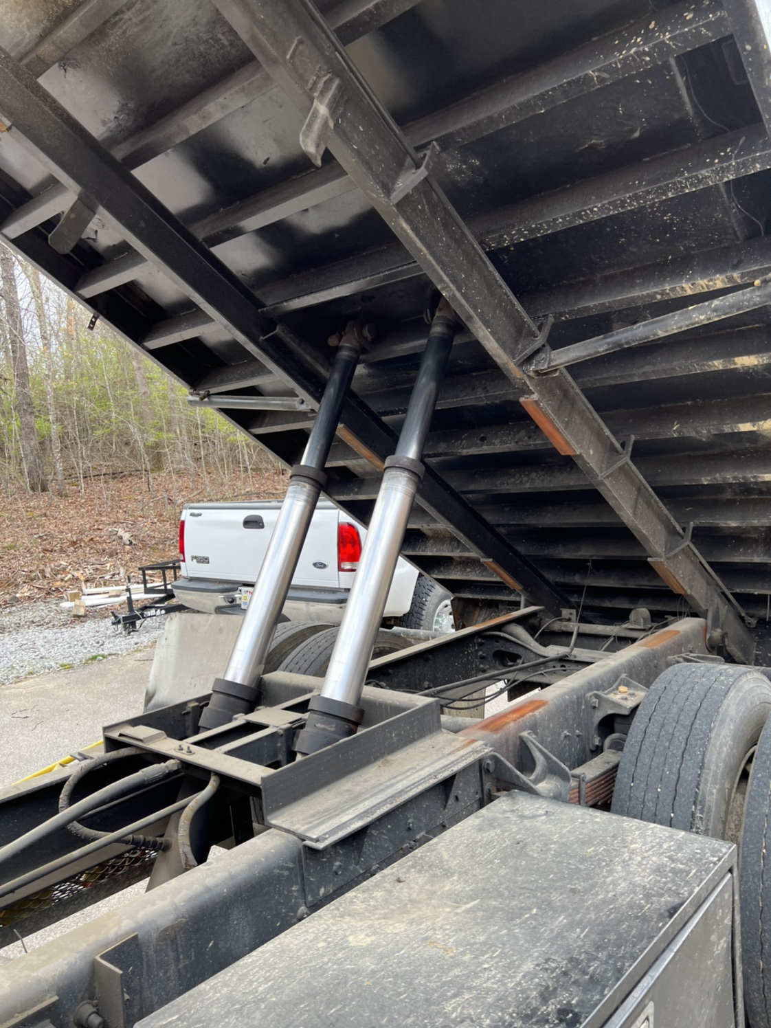

I never liked dog house built in the front of the bed of my last truck. It made loading logs hard and it’s also where dirt would start sticking the worst. A telescoping cylinder provides zero sideways stability to the bed and the whole job falls on the bed pins where a scissor hoist helps with stability. My current truck has duel telescoping cylinders mounted half way down the bed without a buildout in the top side of the bed. It works but it can’t dump the bed as steep as other options could. View attachment 790102
Thats a con tractors body. A scissor hoist on that truck is adequate. Great for sticks, twigs, etc.
I’m build a HD dump for mud, rocks, concrete.
   / New (used) IH 7500 Dump Truck purchase, modification & fix up #186
My F-750 has duel telescope cylinders. It will dump any load you can fit on it and so would my last 6500 truck. The 750 bed cylinders are flush under the bed and don’t have a doghouse in the front.
