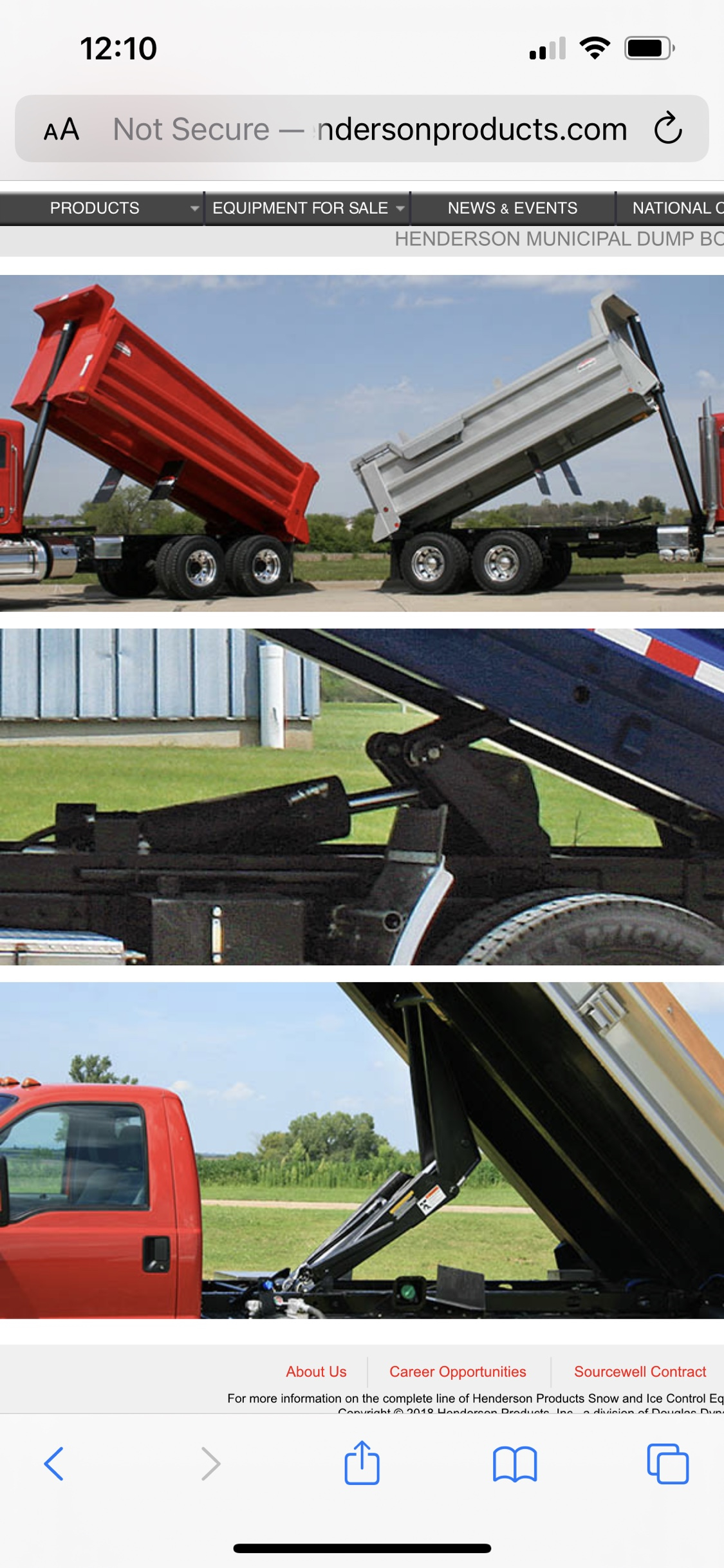

I’m not following everything you say, but do you mean buying a dumptruck bed with a subframe?
Wouldn’t that mean a scissor hoist instead of a tele hoist?
Don‘t have a problem with that type of hoist, but always thought they were inferior.
I don’t understand fully the rest of what you speak of with the cheek plate….
Will adding a typical pintle plate help strengthen? I think so, but wanted to mention I plan on doing that too
Scissor hoist only get a bad rap because they’re typically too light duty. Powering them with battery pumps doesn’t help. The beefy ones like the one in the middle of this picture are the best ones available for a single axel truck.
   / New (used) IH 7500 Dump Truck purchase, modification & fix up #179
I've never liked them because of the massive amount of force pushing almost parallel to the length of the body until it's partially up. Look at the size of that cylinder in the second from bottom pic, 10"± or so diameter. For the sake of a couple of degrees, when that loaded body is down, its almost totally horizontal, the mechanical force pushing back when the body is down must be unreal.
I'll take a telescopic cylinder any day over that kind of a setup, that's just my opinion and the experience I've had with them LOL. As the expression goes, opinions are like a$$holes, some stink some don't :).
   / New (used) IH 7500 Dump Truck purchase, modification & fix up #180
I never liked dog house built in the front of the bed of my last truck. It made loading logs hard and it’s also where dirt would start sticking the worst. A telescoping cylinder provides zero sideways stability to the bed and the whole job falls on the bed pins where a scissor hoist helps with stability. My current truck has duel telescoping cylinders mounted half way down the bed without a buildout in the top side of the bed. It works but it can’t dump the bed as steep as other options could.
