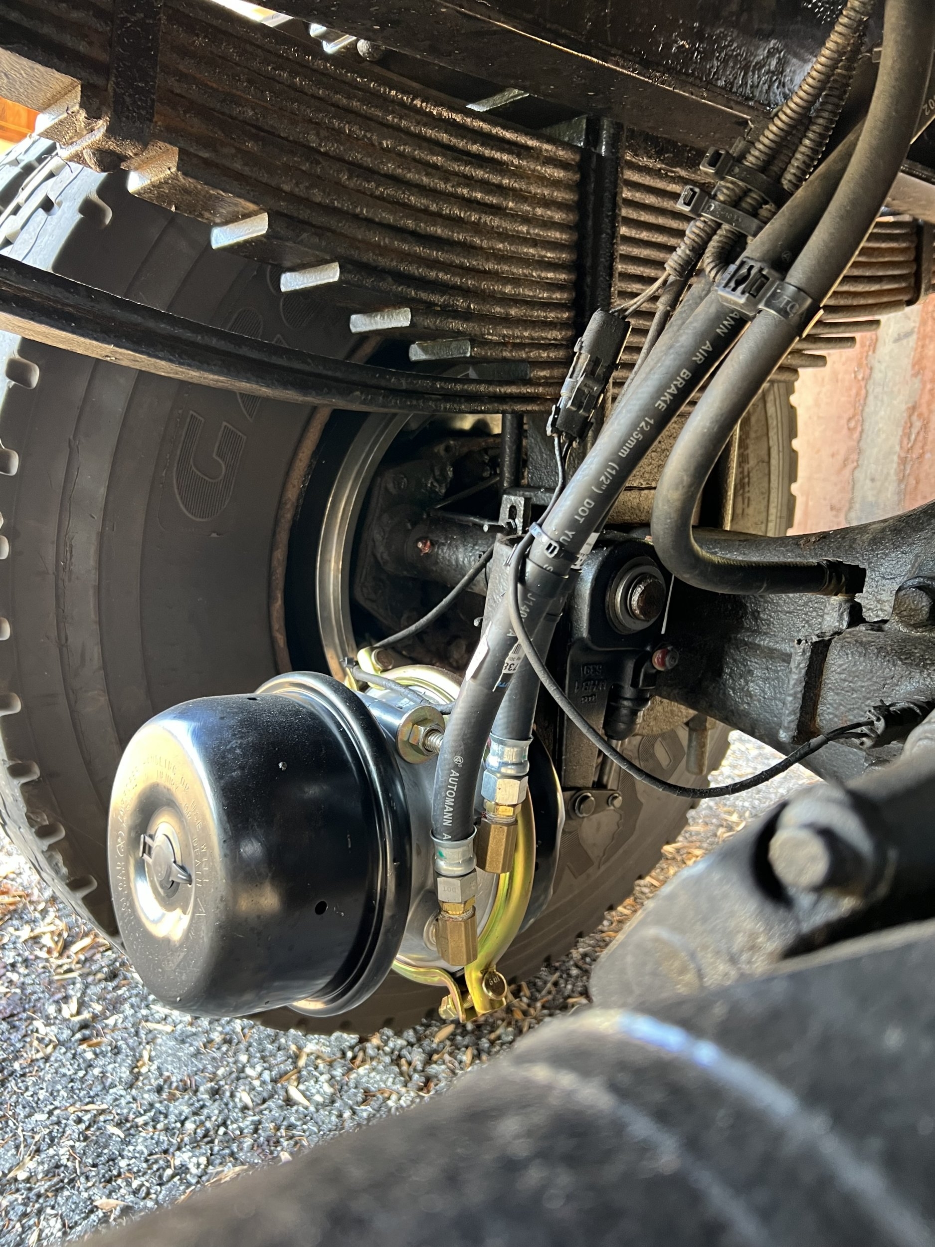

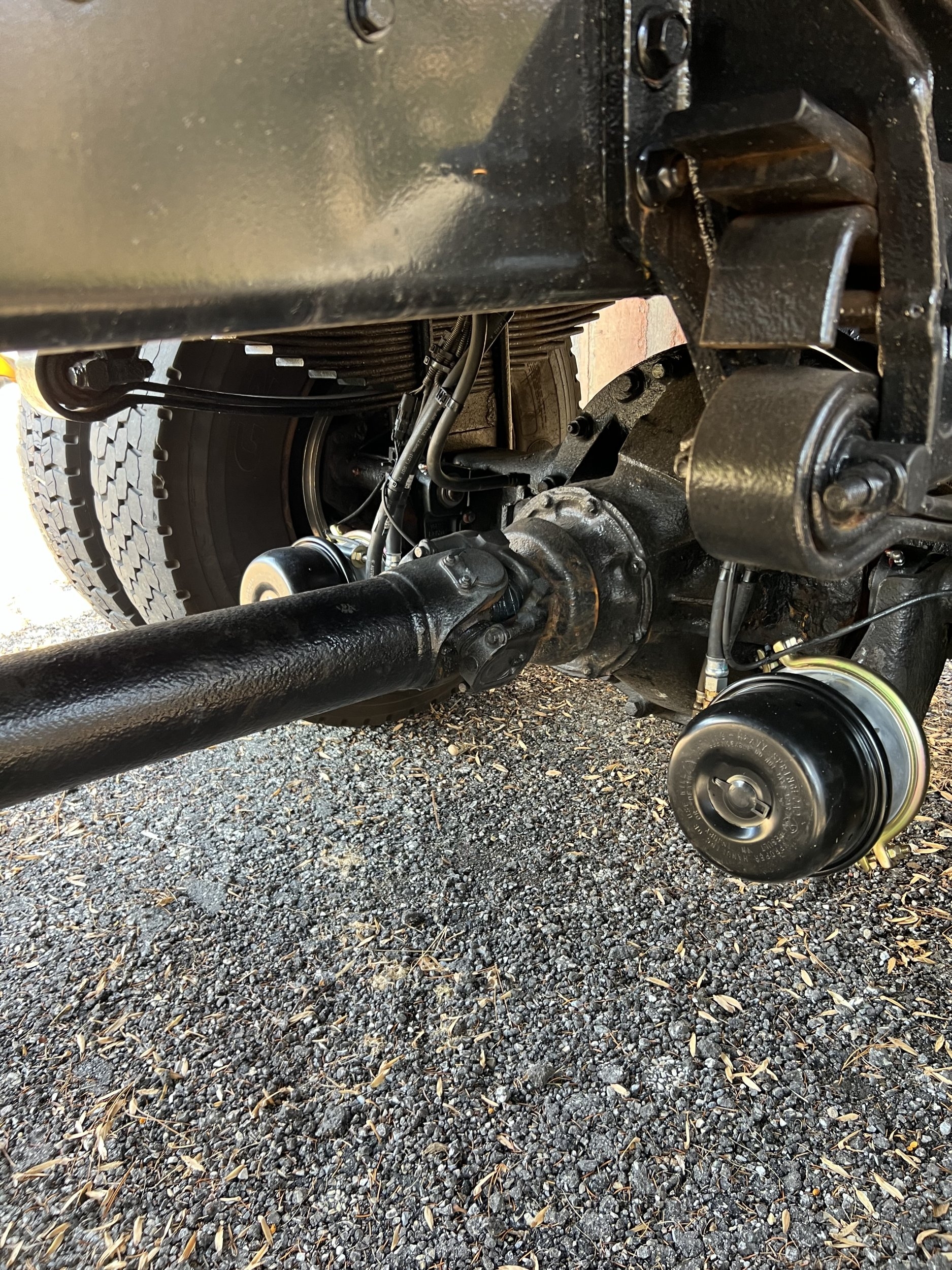

Finished up new chambers, slacks, hoses and drums.

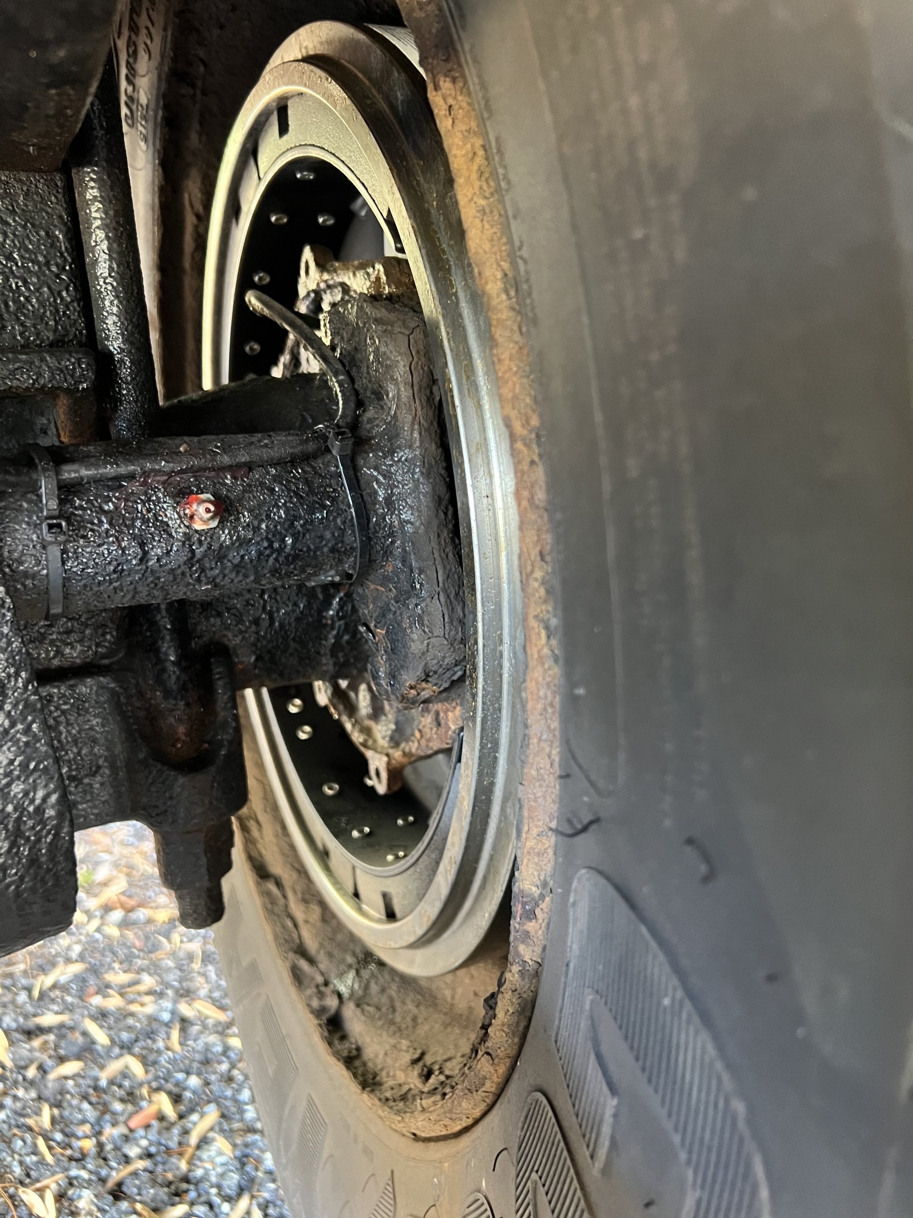

Frame rails don’t look nearly as rough as I expected them to look

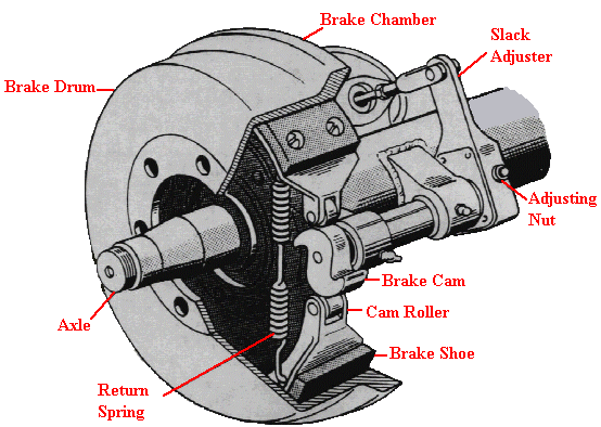

Im going to show my ignorance on air brakes and ask for some education. I know what drums are but can only guess on the other terms and what they do.
  • Hoses = Airlines that connect that air brake system to the Chambers
  • Chambers = Air brake chamber that converts air pressure to linear motion to actuate the brakes
  • Slacks = Slack adjusters, connect the chambers to the arm that actuates the brake shoes in the drums
Illustration courtesy of the Government of the Province of British Columbia via: S-CAM Brake Adjustment and Fuel Economy
