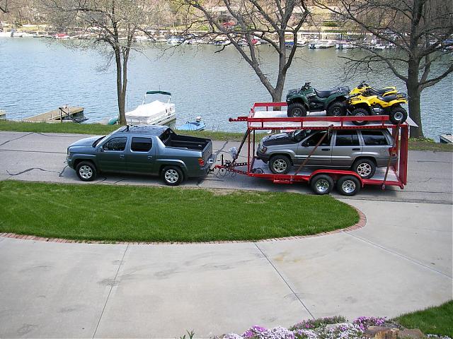

Your comments don't add up either. How are you deciding that Honda's 5000 lb. trailer capacity only means it's good for a 5 x10 trailer?
2017 Honda Ridgeline Highway Towing MPG Review: How Fuel Efficient? - YouTube
   / New Utility Trailer + Wimpy Truck #60
You're being pedantic. The 5x10 was obviously an example; I am not going to sit and write out every single trailer configuration that could possibly be hooked up to his car.
As the trailer gets larger and heavier, the OP is going to be able to put less and less on the trailer. If the trailer weights 2,000lbs, he can put 3,000lbs on it accounting for tongue weight and payload. That should go without saying but don't want you getting your britches in a bunch again. If he had a 5,000lb trailer, he'd be able to put 0lbs on it, once again accounting for tongue weight and payload. See how ridiculous this can get when you knew that I wasn't saying that he could only ever pull a 5x10 trailer and nothing else?
I don't know what point you're trying to make with the photo of an illegally overloaded car. A quick Google search puts a Cherokee ~4500lbs so unless the combined weight of the trailer and quads is <500lbs, which it obviously isn't, I need to drop that photo over in the 'Share Pics of People Hauling or Towing Something Wrong' thread.
