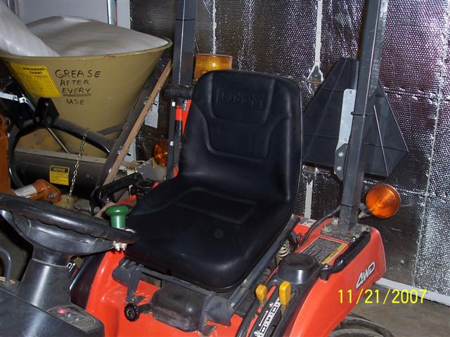

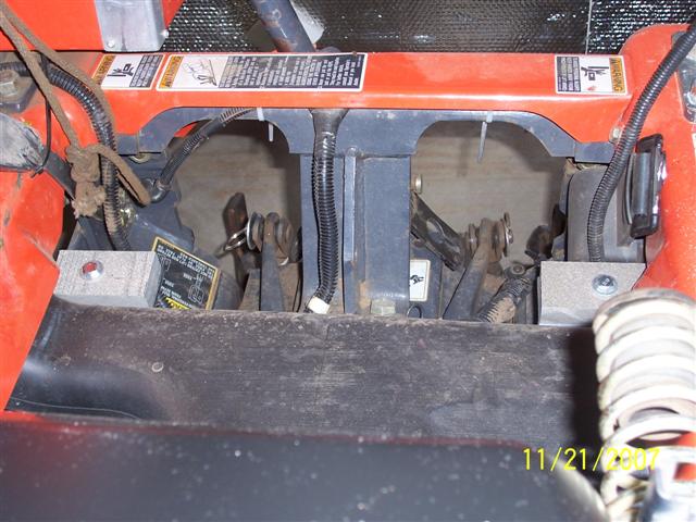

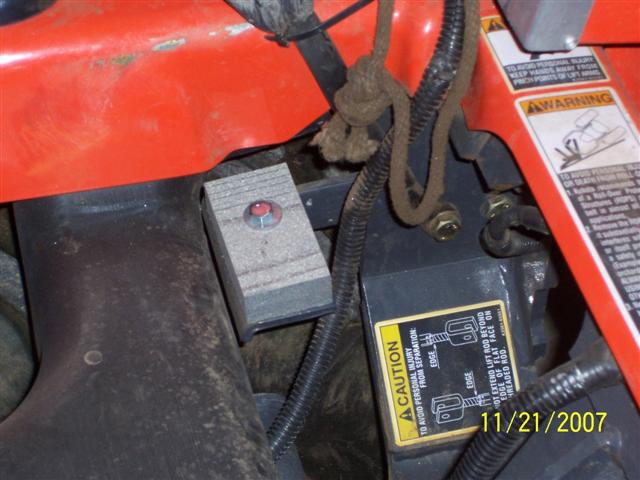

I just picked up a seat for my BX2200 at the dealer for $20.00 & the old seat. I had called last week after reading this thread, and the dealer had them in stock. He said that the program was not designed for the older BX's. I reasoned that after spending $50,000+ on their products, Kubota could afford to sell me a seat under "Customer Satisfaction".
The dealer said that Kubota allowed them to re-sell the old seat, to recover any costs associated with the seat swap. I figured that it would just end up in my garage, gathering dust, then I read the post about using it as a rolling shop seat, go figure.
I installed it, and adjusted it higher by adding 1" blocks to the lower seat stops. The seat now fits the contours of my back, giving added support at a higher level to my back.
If the seats are still available to you, it is a worthwhile upgrade.
WALT
