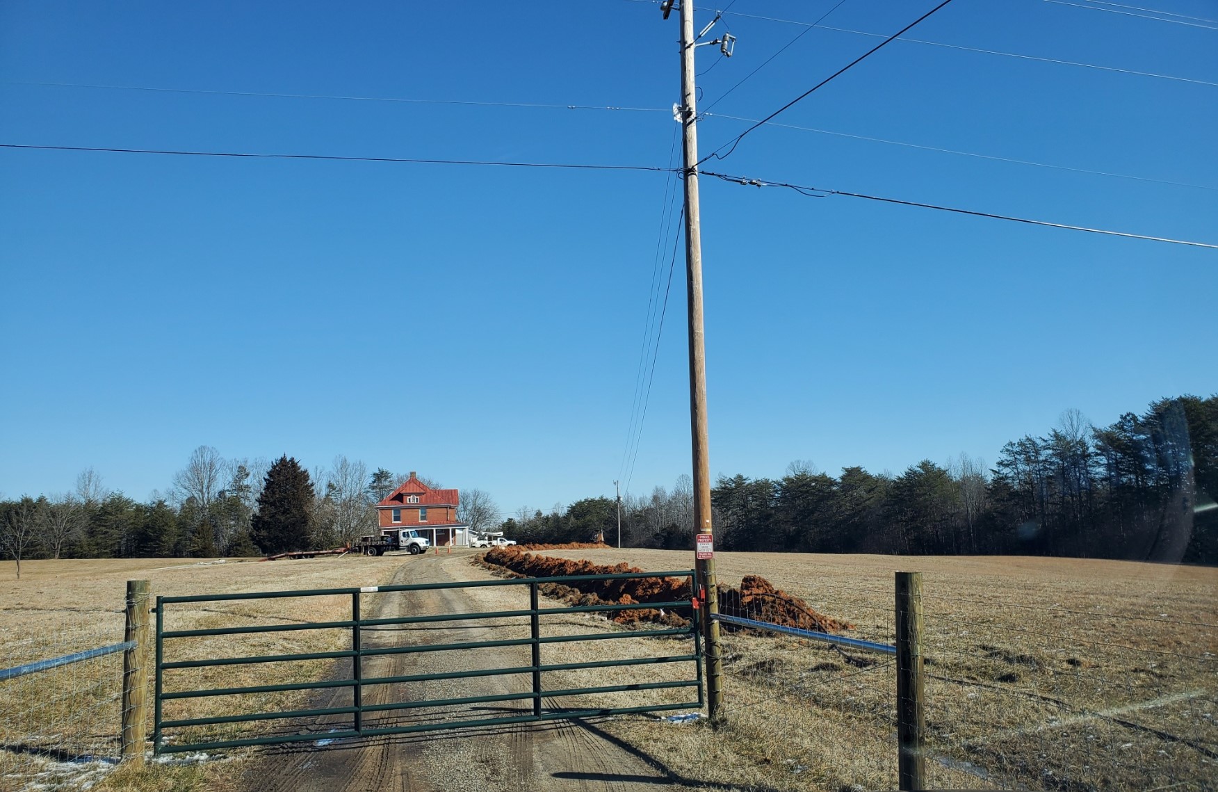

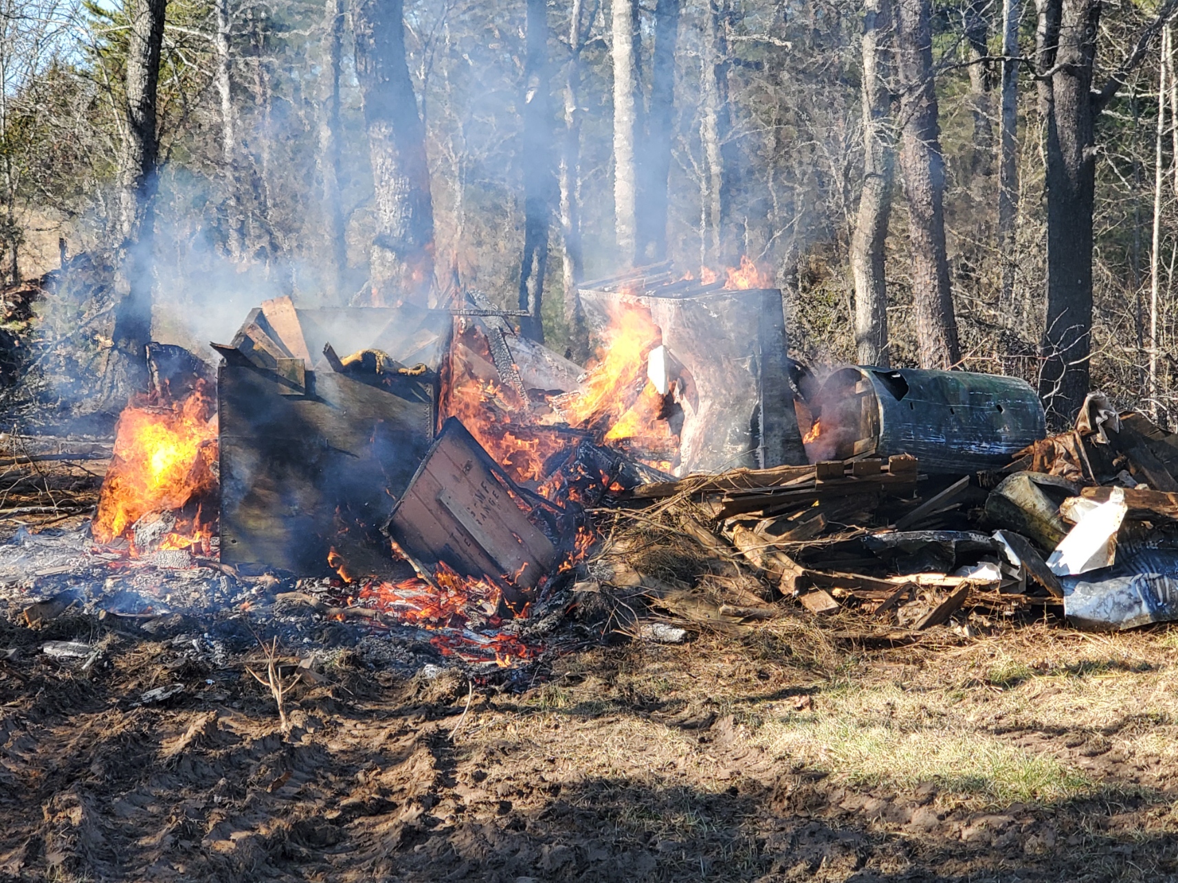

Finally getting in our new 400amp service from the road. The old line and pole near the house will come out. Also was finally able to get the old moonshine tanks out of the woods to the burn pile.

Direct cable burial electric service is allowed?

Yes... Short story the house system was 60 amps, the existing overhead wire was under rated for new 200 amp service, and the pole near the house was like 80 years old. So we made a deal to direct bury and I pay the upcharge. Got a new 400 amp service and new transformer being put in behind the shop.

Direct burial is not permitted in many parts of the USA!
Conduit only,.... for "Dig Safe".
