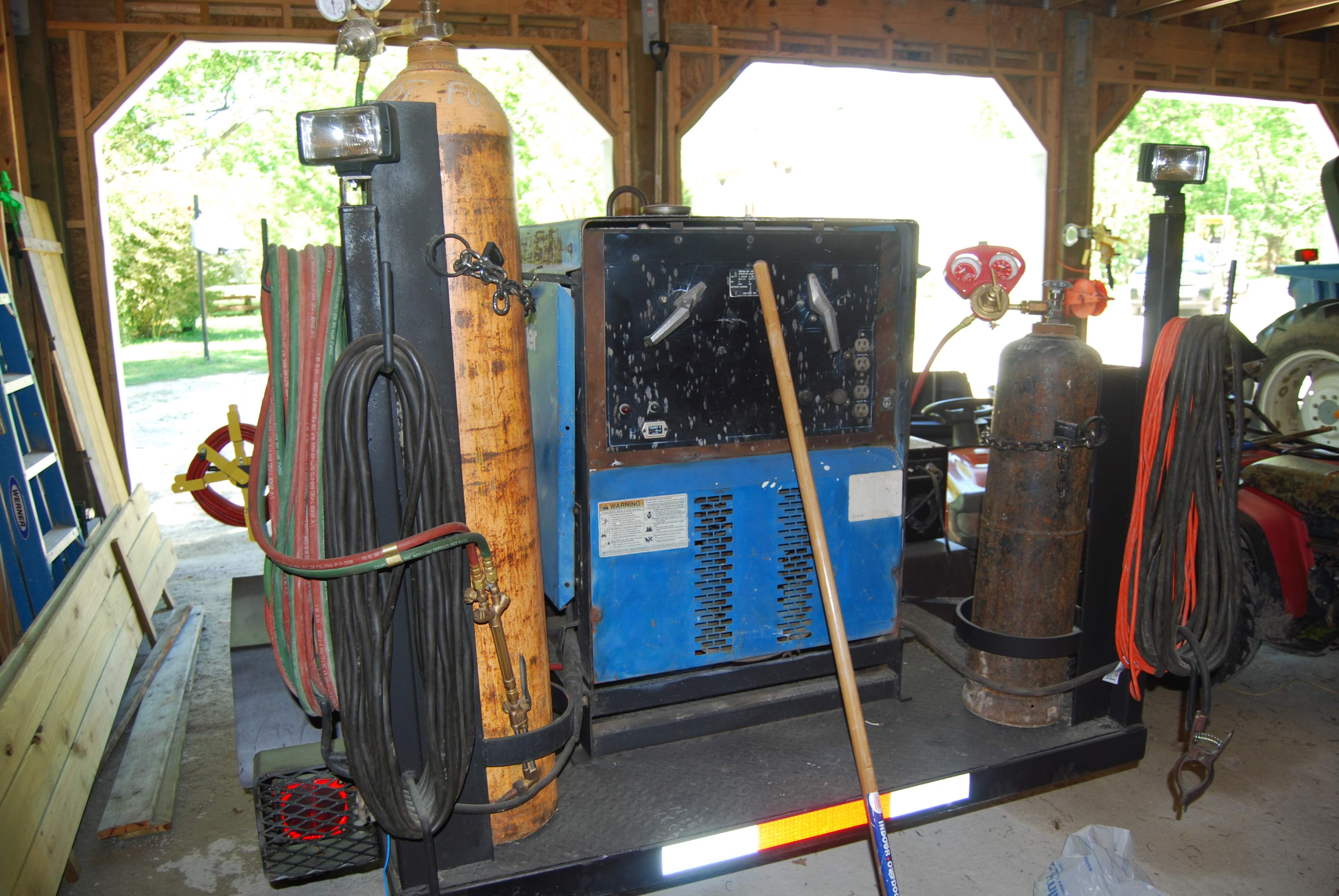

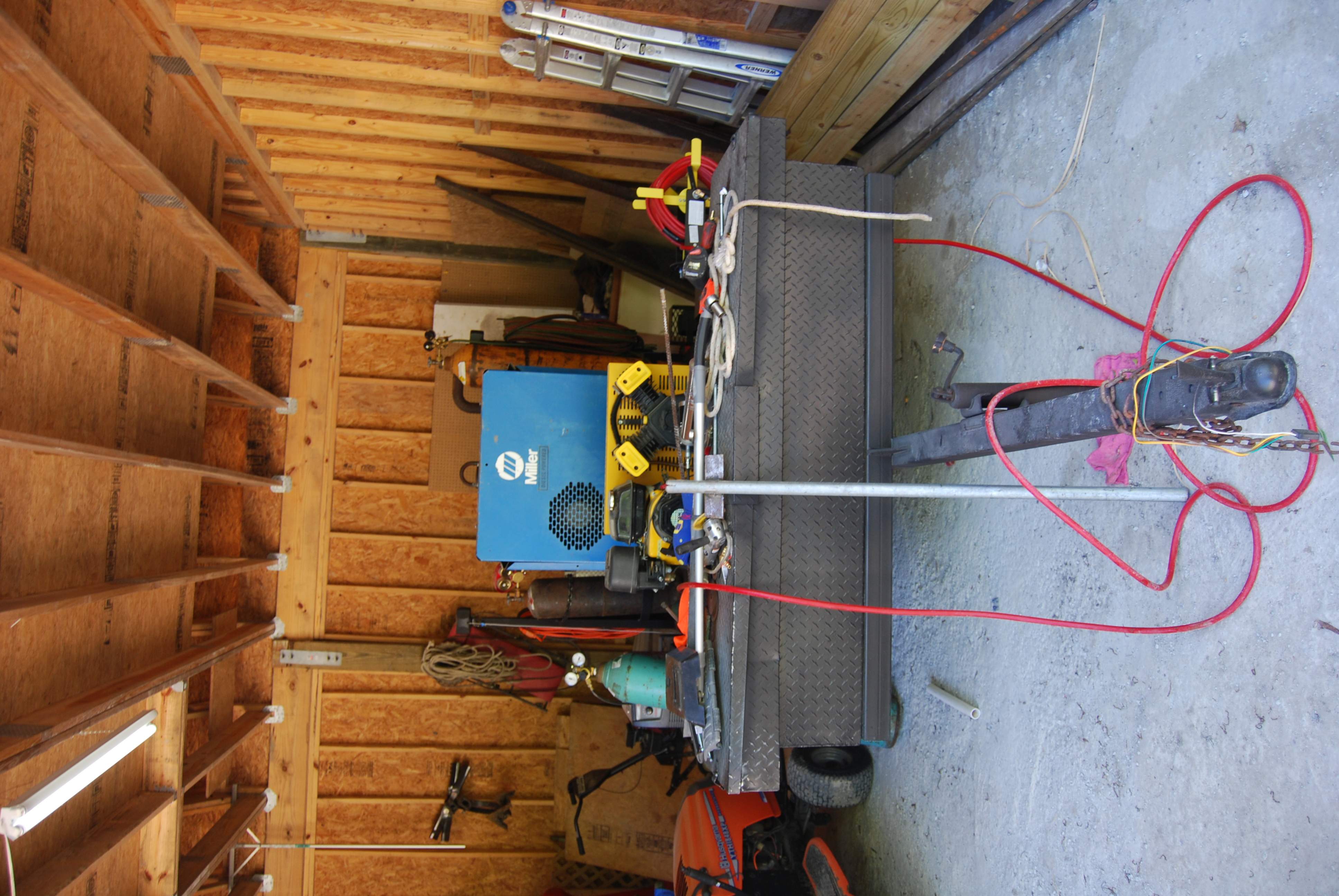

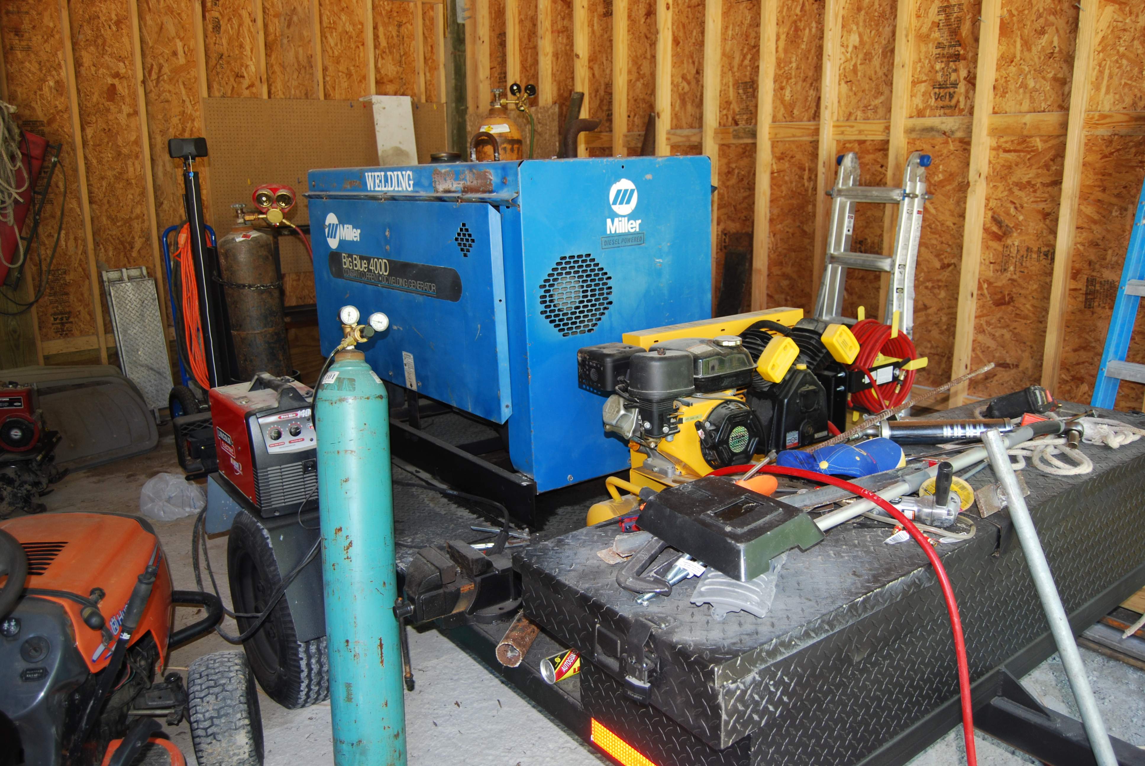

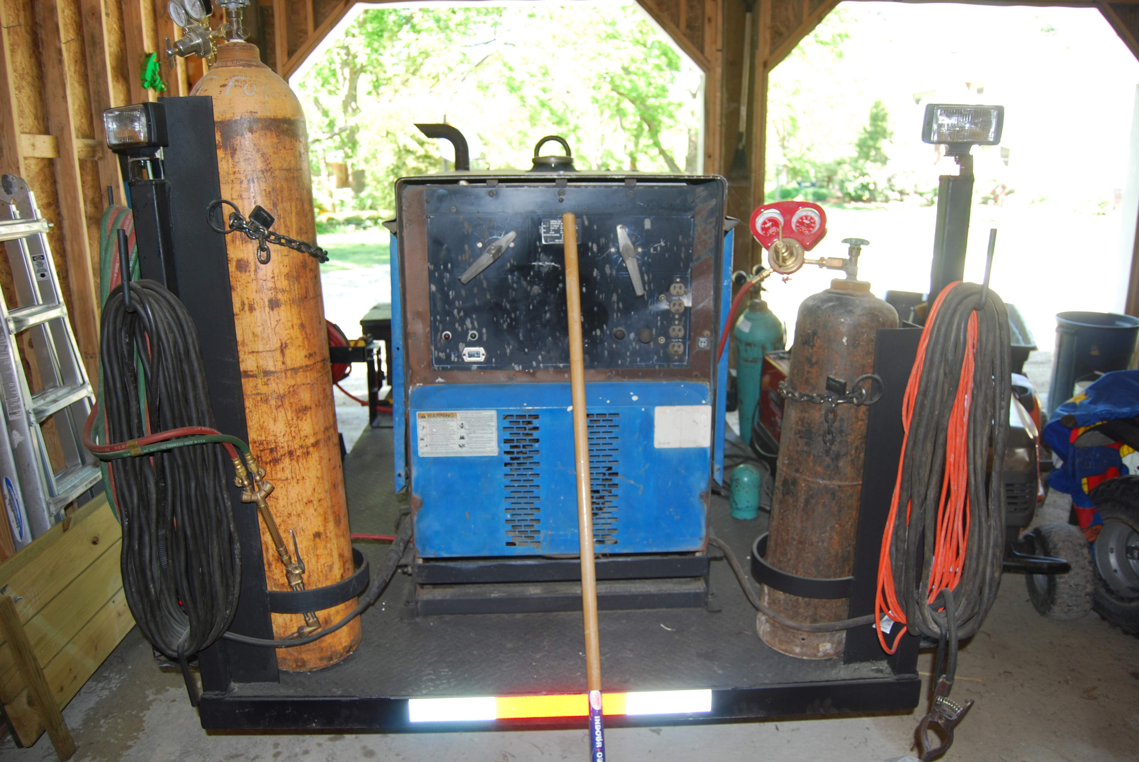

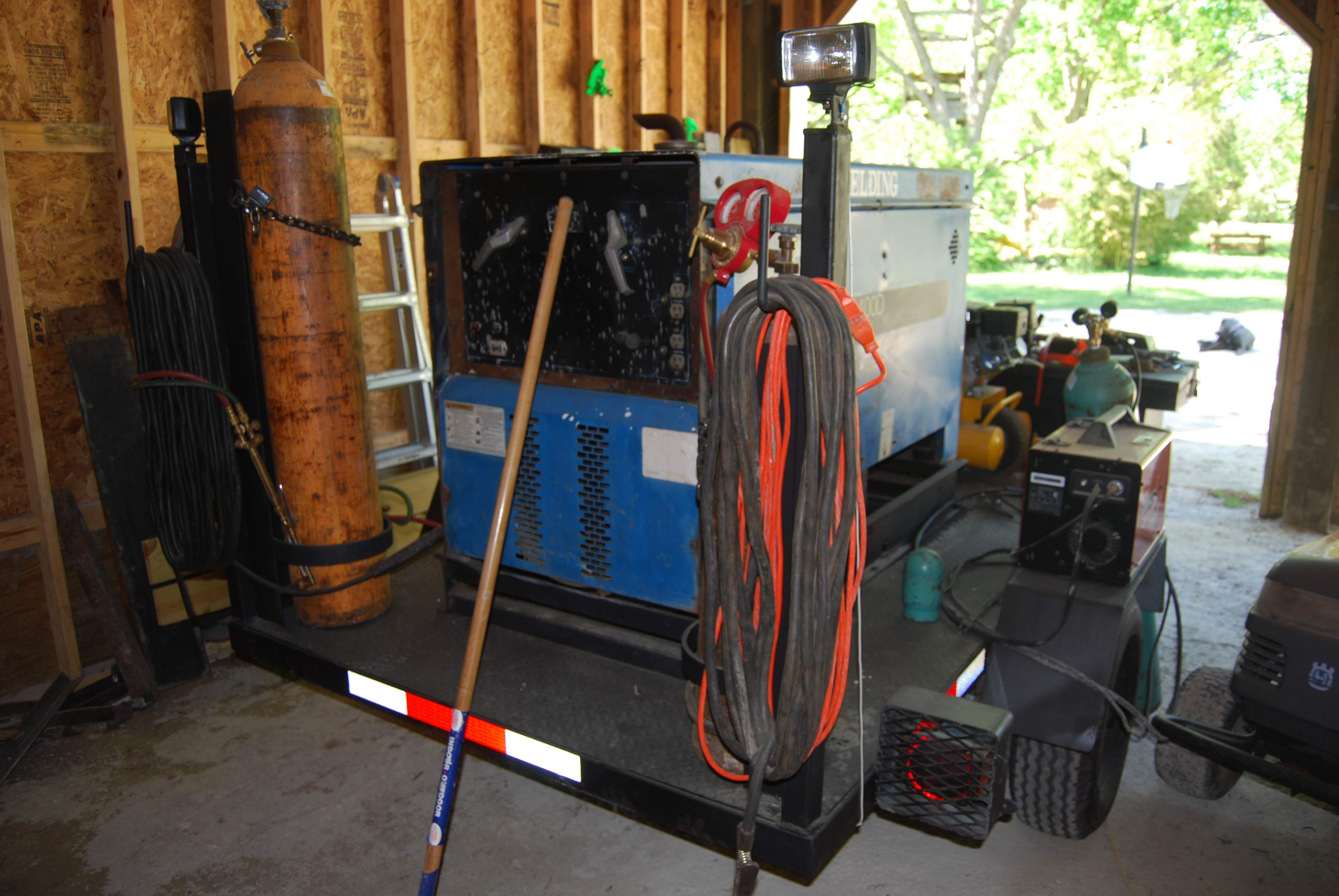

I just bought a brand new welding machine! Well alright it's new to me. It is a 1994 Miller Big Blue 400 CC DC with a Deutz Diesel. Came with a trailer, toolbox, welding leads and torch racks all for under $700.
She starts up and runs, welds, provides 3000 watts of power. Nothing wrong with it.
Just working on cleaning her up. I'm getting ready to put it to work as I am starting my own small business building small/large implements for garden tractors as well as larger tractors.
The only thing about it is it will not run a wire feeder for MIG nor will it do A/C for aluminum. It will do 500 amps D/C Stick/Tig @ 60% duty cycle and 400 amps @ 100% duty cycle.
I have had it for 2 weeks and have already painted the trailer, added my air compressor and hose, and added utility lights to the torch racks. I also put my torch/tanks on it and it balanced out pretty well. It is a little back heavy so I will need some stabilizer jacks for it. As long as it is hooked up to the truck it is just fine.
It also came with about 75 pounds of mixed steel. Along with 50 pounds of 7018 1/8 rods. It also had about 5 pounds of 6022 3/32 iron decking rods.
I am completely satisfied. I think I got a great deal!
I will post pics later as my camera is dead right now.
Thanks, Matt.

Sorry it took me so long guys. Here are the pictures of my machine. I couldn't find my power adapter for anything until just the other day.
