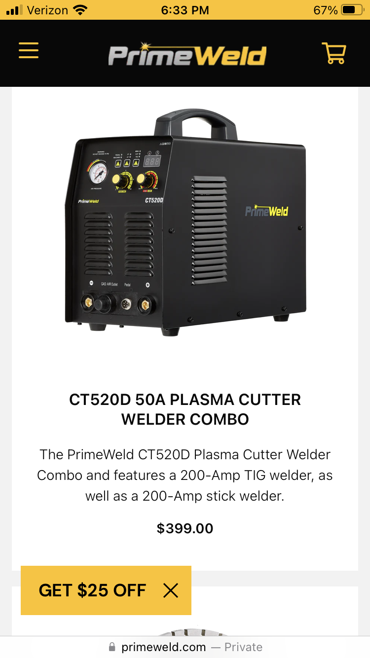

I’ve heard great things about Prime weld !
/ New inexpensive trimode welder
thanks, that's a different trimode...didn't realize plasma cutters were this inexpensive.
