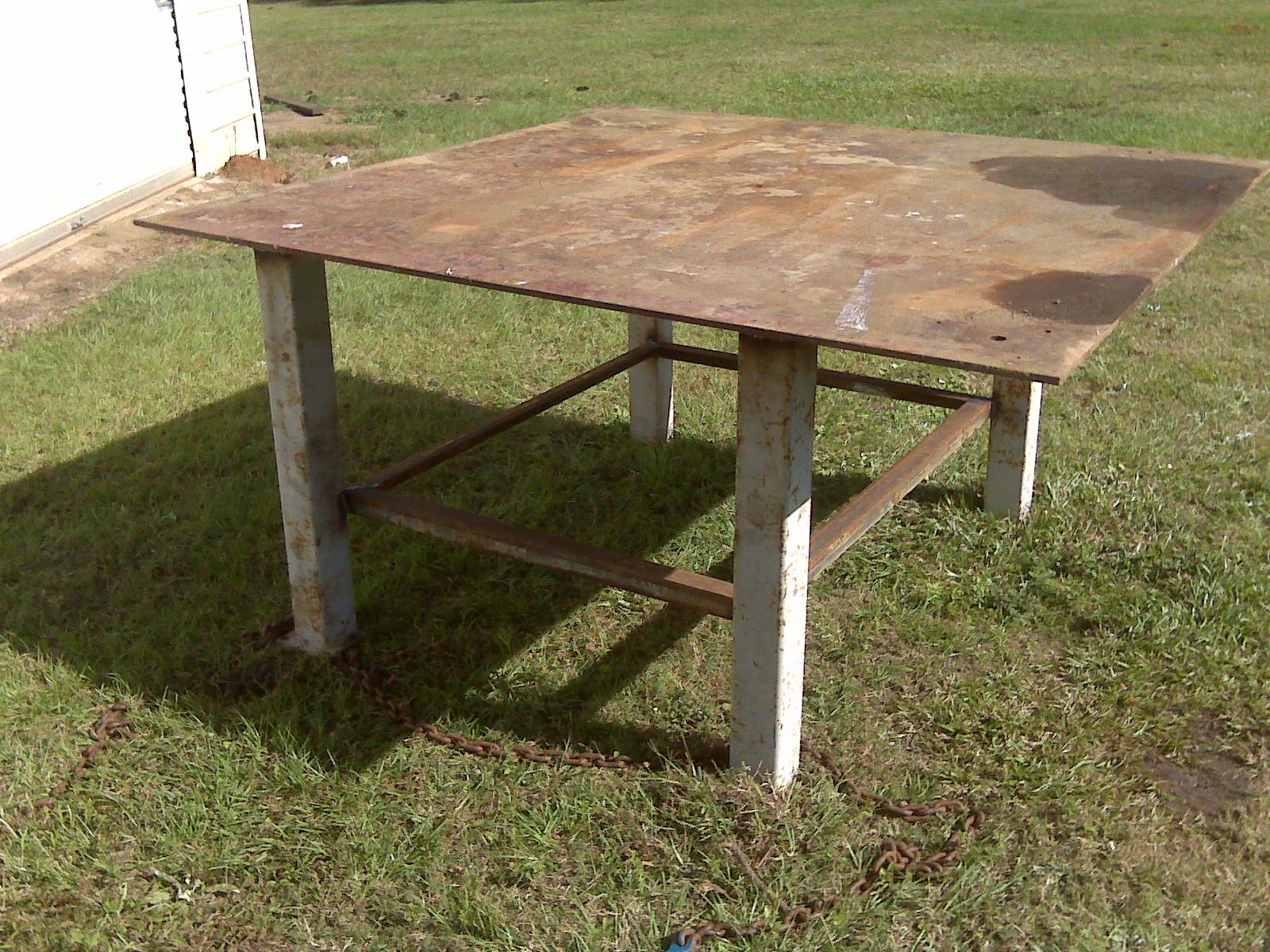

picked up a 6ftx6ft 1/2 steel sheet along with some thick wall 2x2 angle.
Oh in keeping with my cheap canopy project,so far i have less than 80bucks in the table.
Lucky fails to describe this. :)

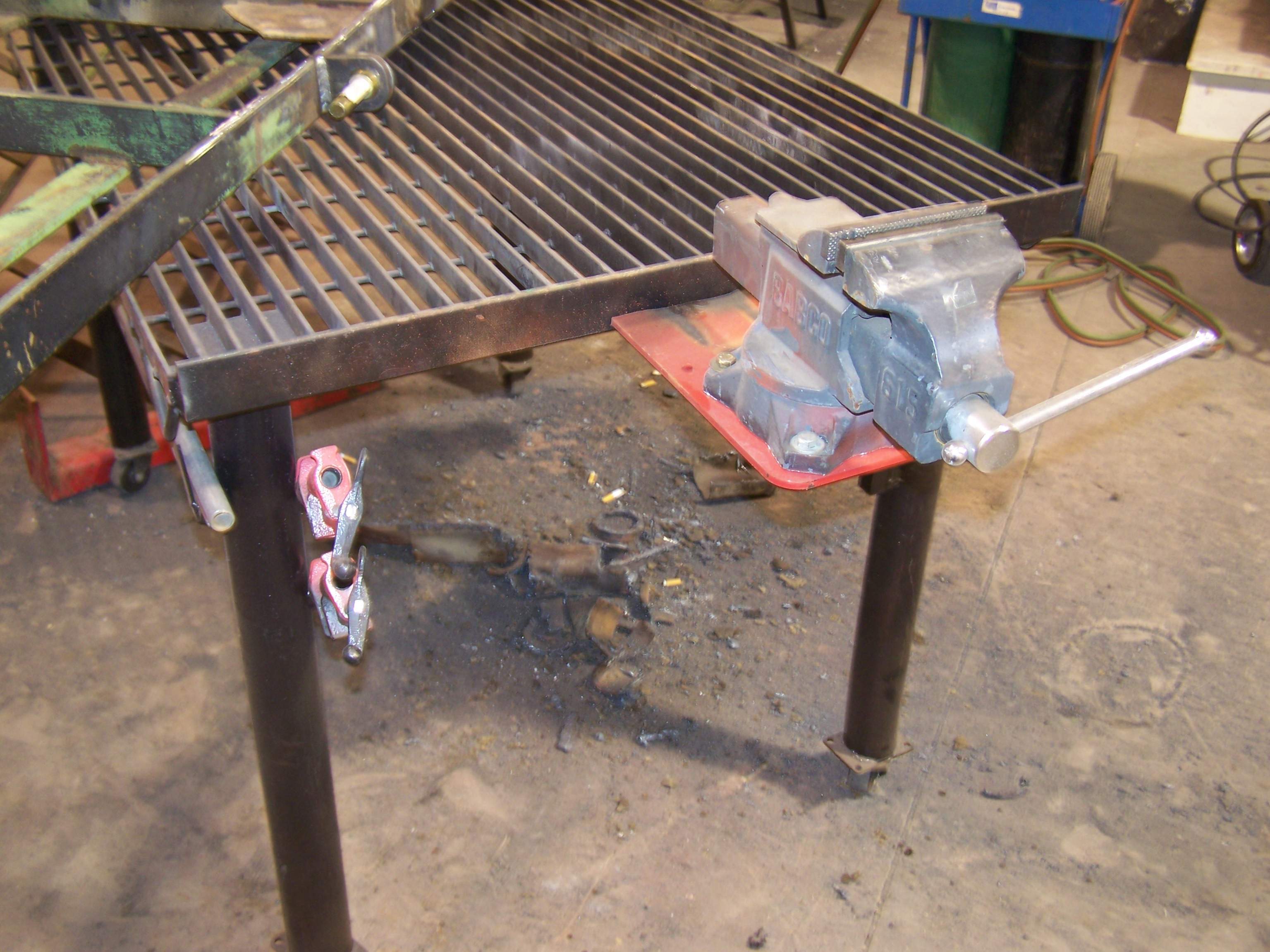

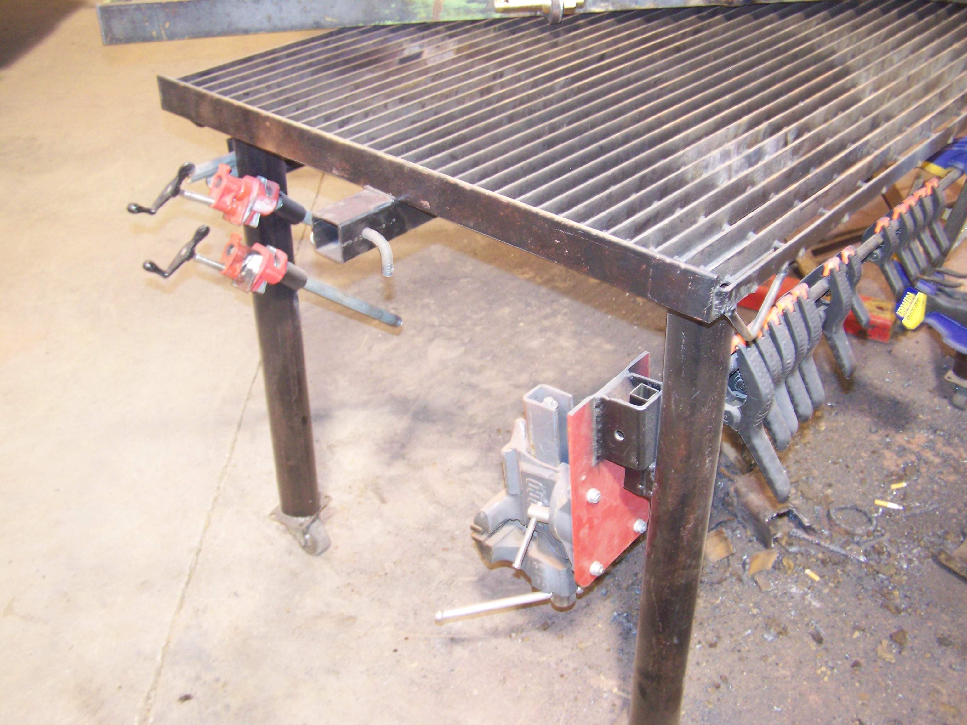

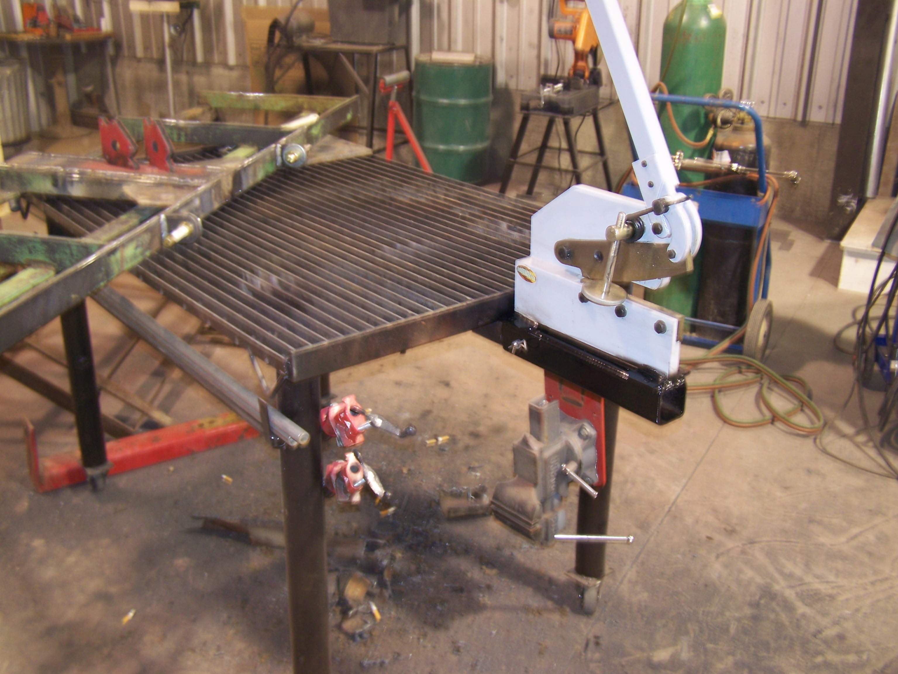

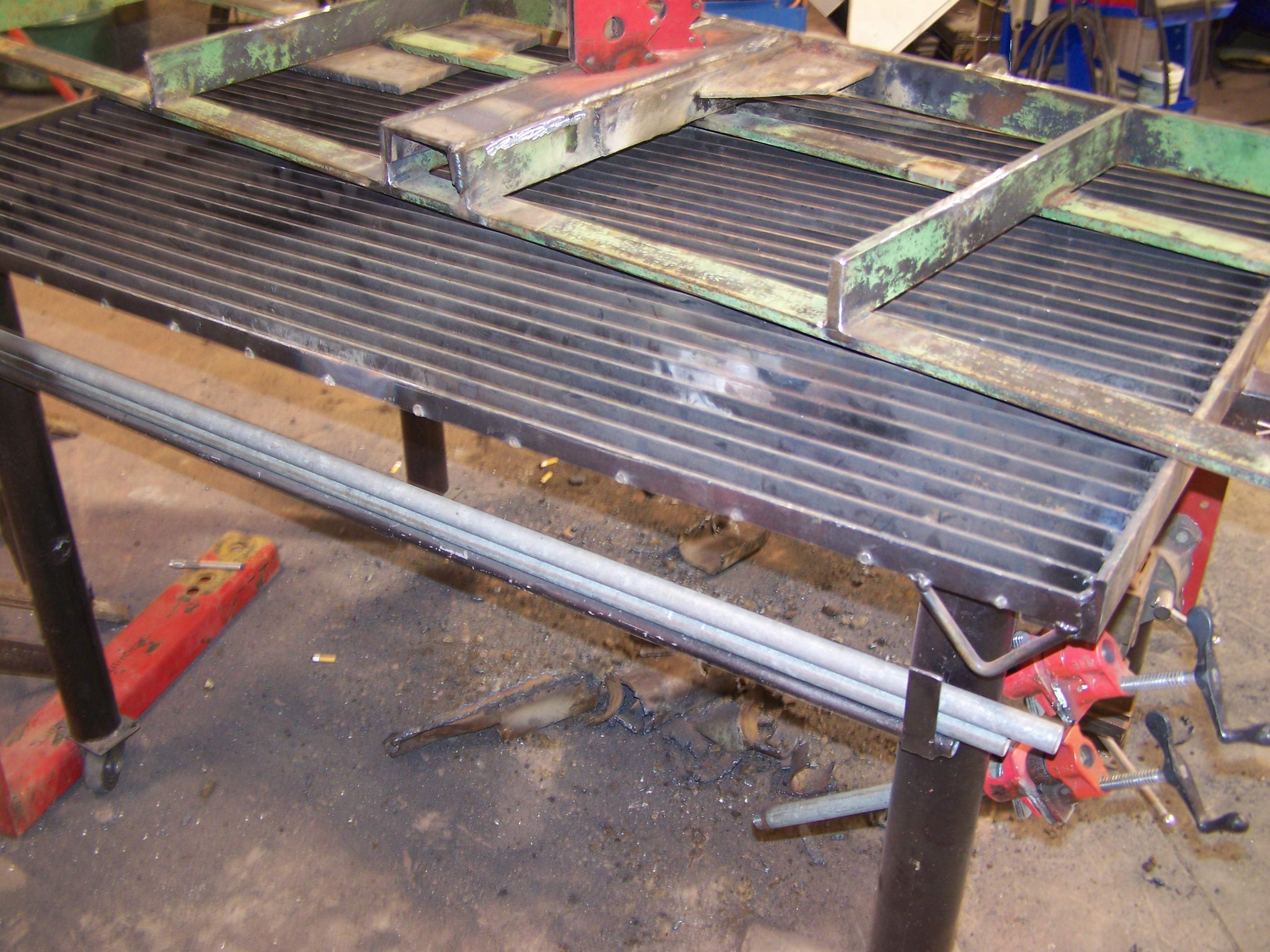

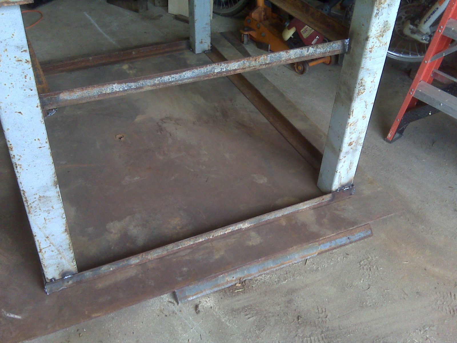

Here's mine. The top is a floor drain grate from local school bus shop that closed up.. $15.00, 3" pipe legs from scrap pile, casters $40.00.
I built it the same height as my permanent mount work benches, works good for longer items. The grate is nice cuz all the slag and metal shavings fall thru and I always have a clean top to work on. The 2" reciever setup is nice to allow my vise or metal shear to be used and then stored out of the way when not needed.
