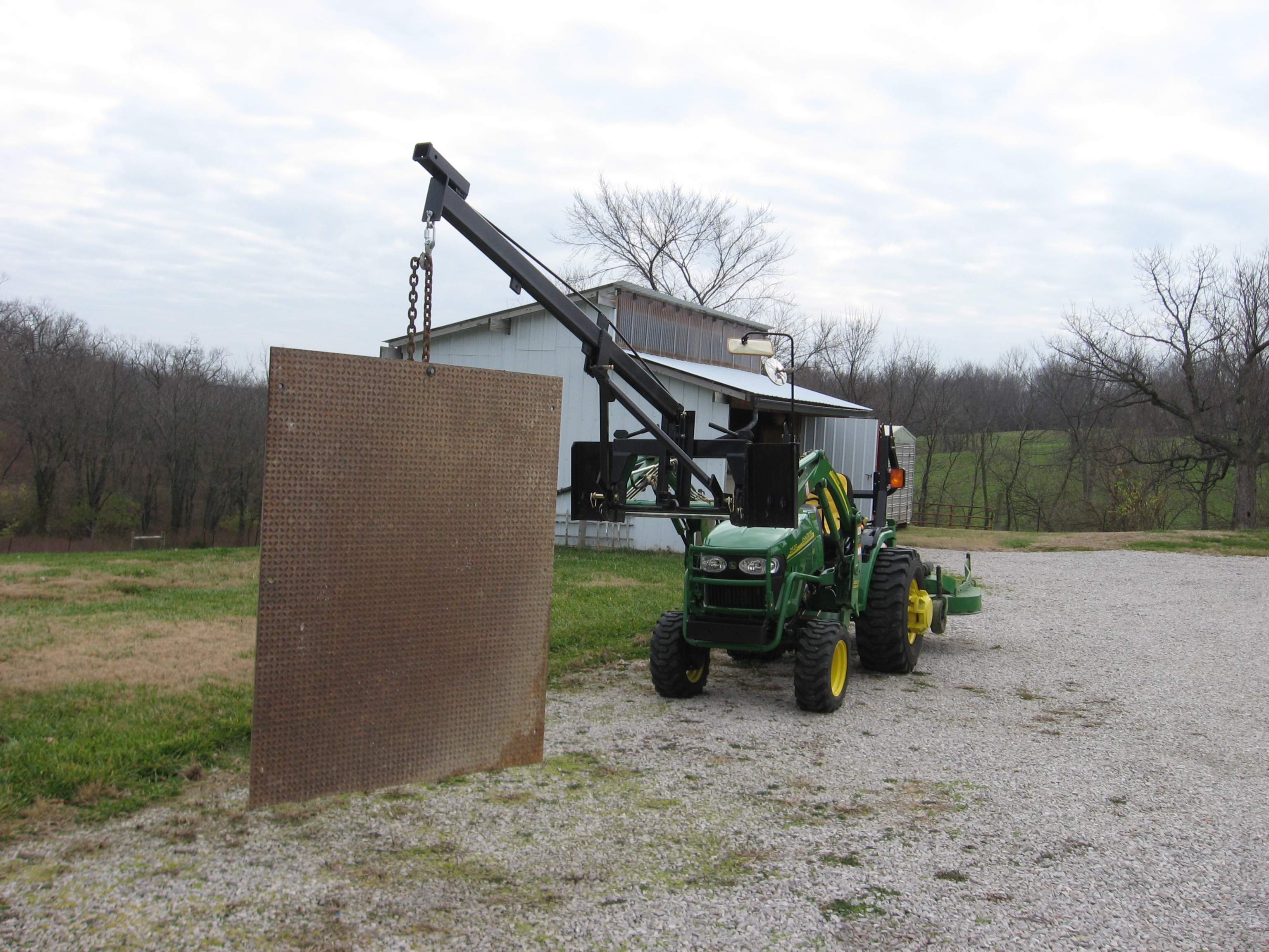

Your table is looking great. I was interested in this thread because I am currently building a welding table myself. For my top, I'm using a 51" x 60" piece of 3/8" checkerplate steel that was left in my barn by the previous owner. I will mount it with the checkerplate side down and the smooth side up.
I decided early on to mount it on some type of casters, but have been wrestling with several issues. I originally wanted some type of casters with brakes, but they seem to be super expensive and I'm not sure that just locking casters would prevent movement of the table.
Also, I had a nice set of 4" cast iron casters "in stock" so I decided to go with those, although they don't have brakes. Therefore, I have been kicking around a thousand ideas for some type brake system to hold the table in place.
I think I have settled on the idea of mounting a couple of scissors jacks under the table so that when I get it where I want it, just crank the handle until they make contact with the floor. I'm not really worried about leveling, just want to keep it from moving. Not really sure how well this will work, but if it doesn't, I'll just unbolt them and try something else. The scissors jacks were $10 apiece from HF.
I'm still in my material gathering stage and will probably begin assembly within the next week. I'm using 2x2 tubes for the legs and 1 1/2x1 1/2 tubes for the horizontal pieces. It will have two shelves, one about 8 inches below the top for tools and another 6 inches off the floor for bigger stuff. The top will have 4" overhang on all sides.
Here is the top being carried to my work area for some clean-up work.
