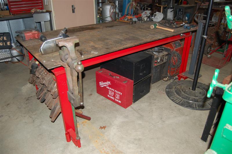

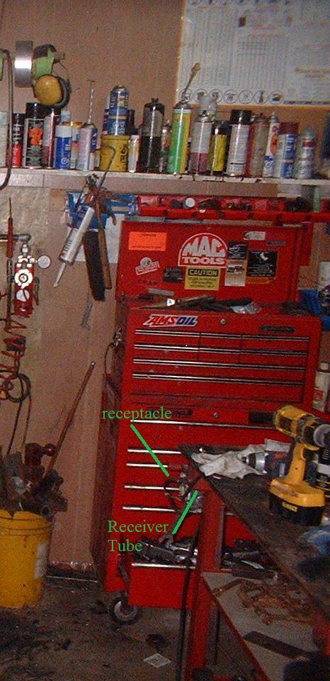

Dont put the recept in the top. Metal shavings are bad
i wired mine under the edge of the top so its close by but out of harms way
]Leave a lip around the top for clamps
Casters are ok. Just get good ones with brakes or add table brakes to yours. THe inertia of a heavy table will help.

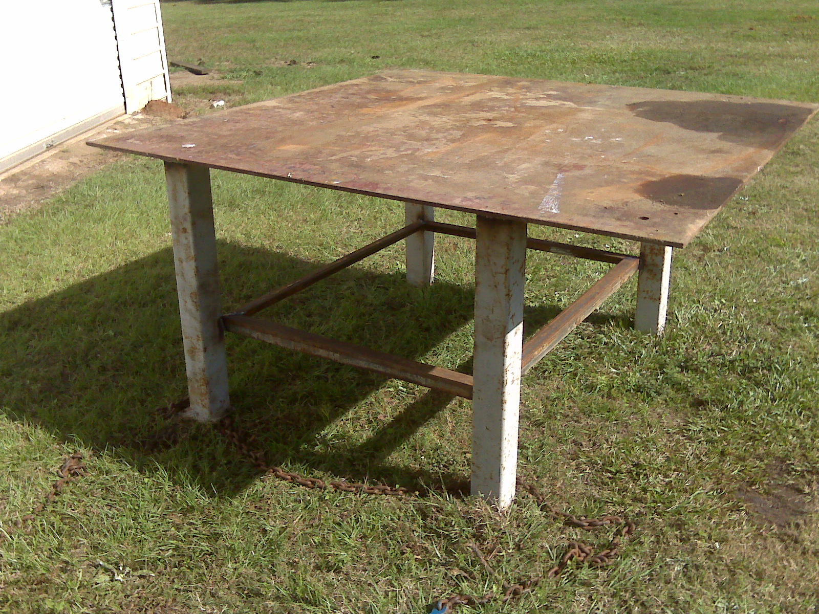

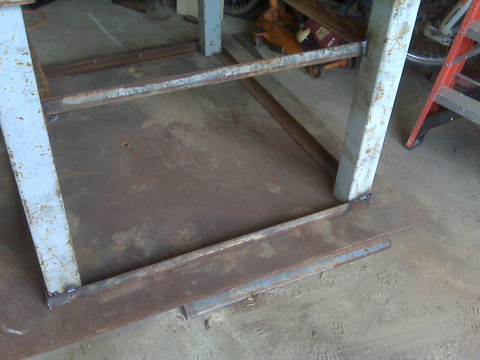

Mines probably 5x6 of 3/8 plate. Plus the legs are heavy wall. I also store all my short steel on the table so im guessing it weighs at least 900 lbs.
I welded several 2" receiver tube around the perimeter to make for modular attachments. My large vise, bender, anvil are all mounted to 2" tube. I can move them around or remove them for storage as needed.
sorry I dont have any good pics on my comp. This is the best i have.

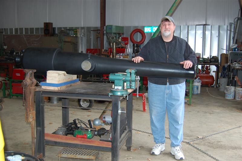

Starman, nice BIG shop. Tables look very funtional. I'd like to have similar vices and anvils. I'm assuming that's a cannon you've got there. Tell us about it.
Jay
   / New Welding/Shop Table Ideas #24
Jay

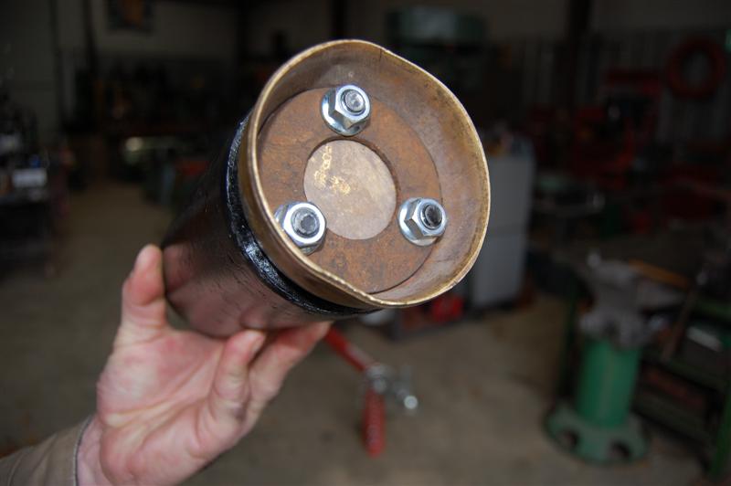

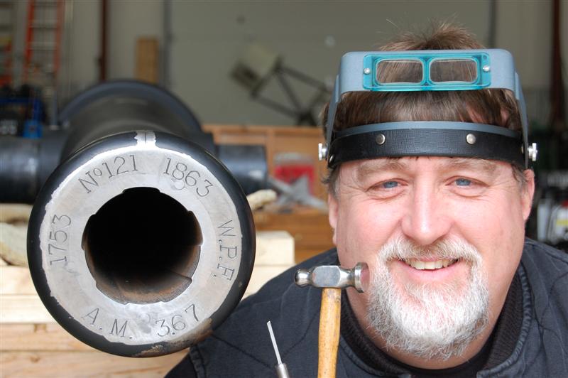

Jay its a 20 pounder that was in my shop for engraving of all
its proper markings ,its new and I make it look old for the owner.
Have been re-engraving some big guns ,one the guy had a
armed gaurd to watch over his while I worked on it
it was worth 2 million. No room for any mistakes , takes a lot of
nerves and years of practice I make it look EZ but its trickey.
The photos are of the exploding bullet ,the guy had made ,It's
a rich guys hobby as you can see .

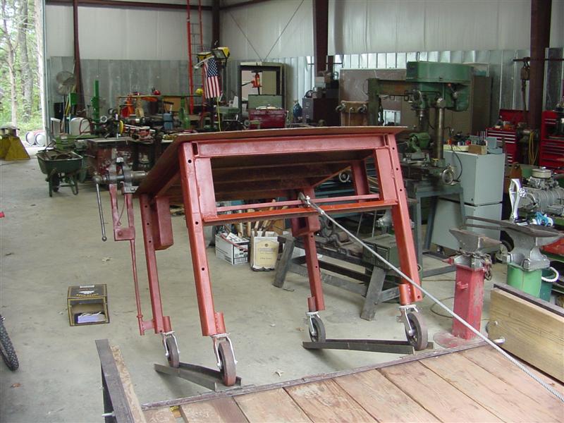

Well I didn't get as far as I wanted to but here are some pics so far
the first its all tacted and square
the other if finished welded and set up right
next sand it down and add the swing out seat and wire mesh for the shelf then paint it, I will not paint the top

looks good so far. Are you going to put casters on it?
Yeah dont paint the top of a welding table for obvious reasons. A sanding disk on a grinder will fix it up nice.
