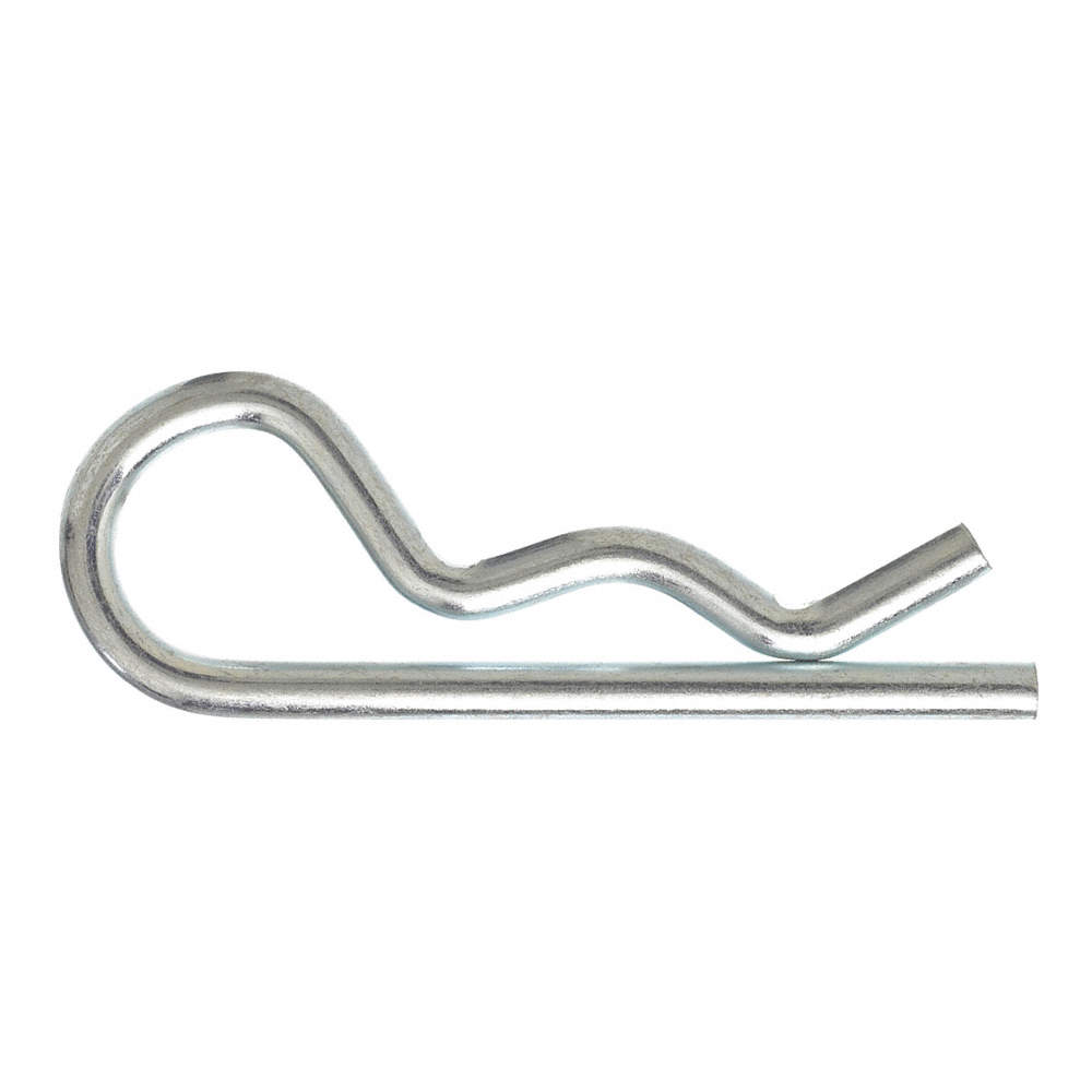

I’m really leaning towards fabricating the long pin setup. Only thing that has my head scratching is there is no way to keep
The lower bars from sliding the length of the long pin.
I mean, does that even really matter?
Except it would prevent the sway links from tightening properly.
I suppose I could drill a hole and insert a cotter pin.
   / New ym240d owner #39
It matters. There's a lot of force there. A cotter pin won't be enough. You need that long pin to become larger diameter as soon as it is outboard of the 3-point arm. Or at least a 'cotter' through the pin that is minimum 1/8" diameter.
   / New ym240d owner
#40
Perhaps cotter pin was the wrong term. I was thinking more like this style.
At least 3/16”
I figure 3/16” would be sufficient to keep the arm inward. Maybe a flat washer between the pin and lift arm ball. A765EC27-9ABD-476E-AC0B-FC105B798BC9.jpeg
