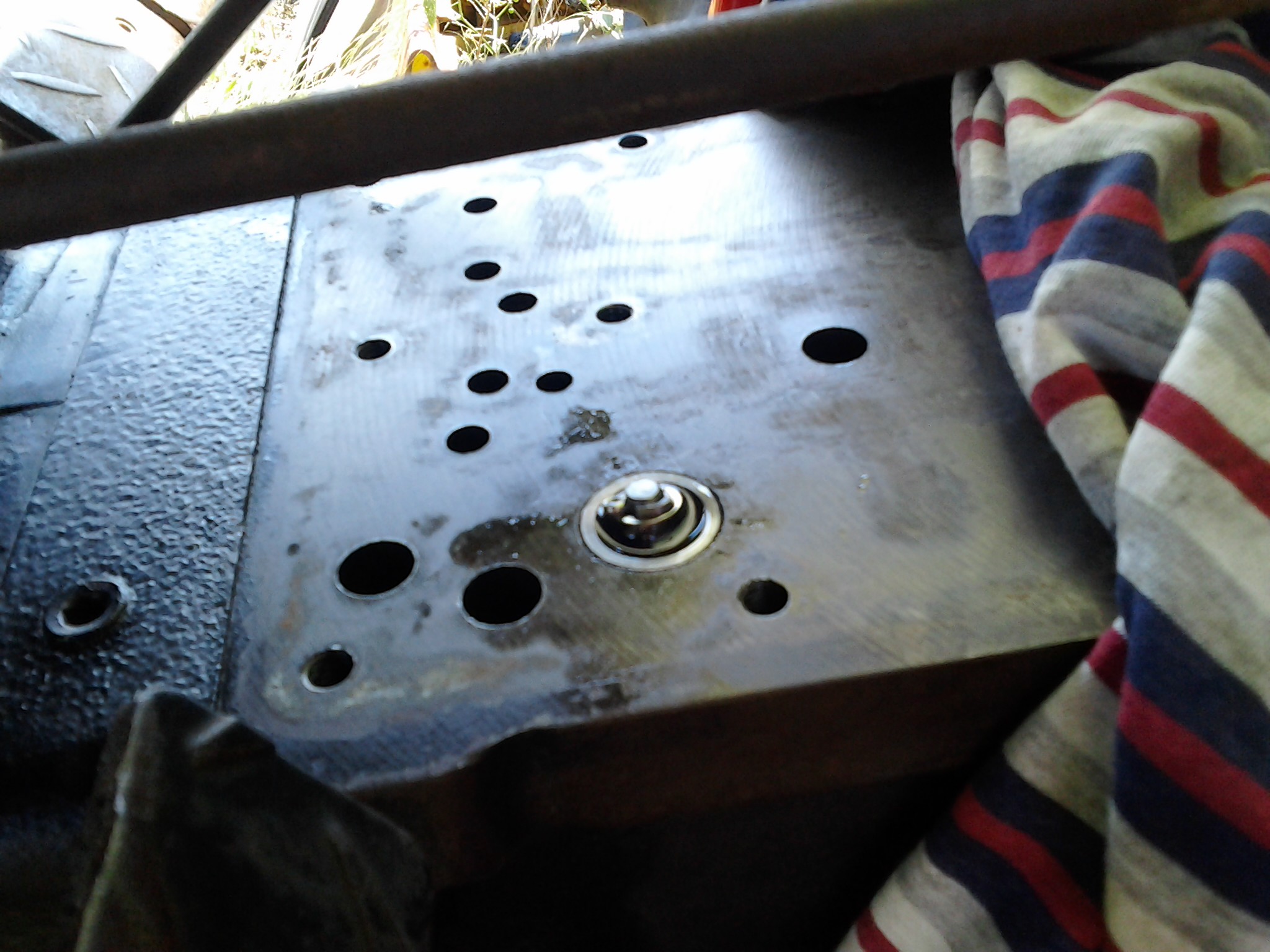

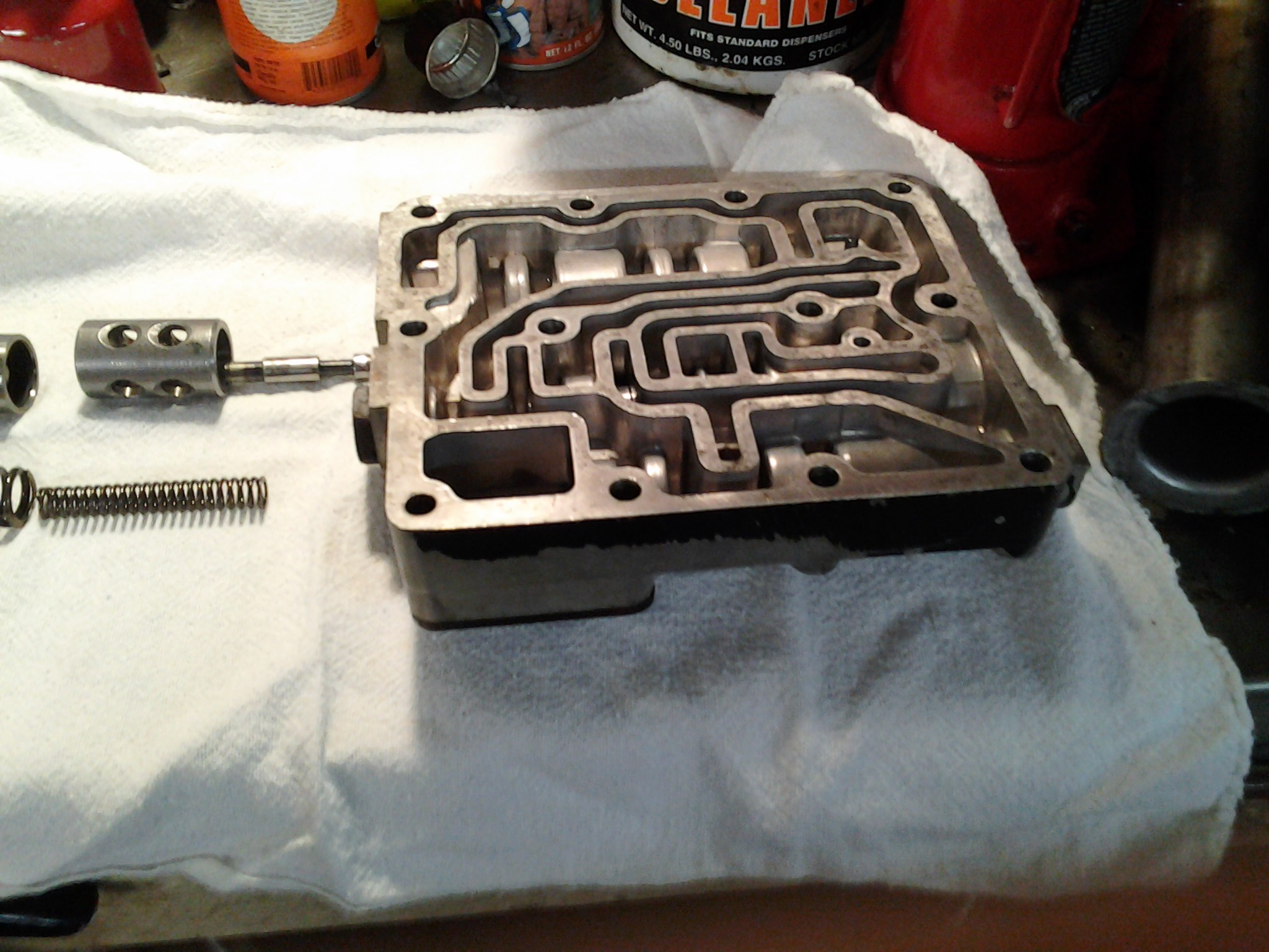

No I mow in 3rd range and 3rd on the powershift. As I said before it seems like low oil pressure getting to the clutch pack. Waiting on a gasket from Hoye. Going to put it back together and keep my fingers crossed. Winston,Did I understand you right that the valve under the valve body control that pressure?

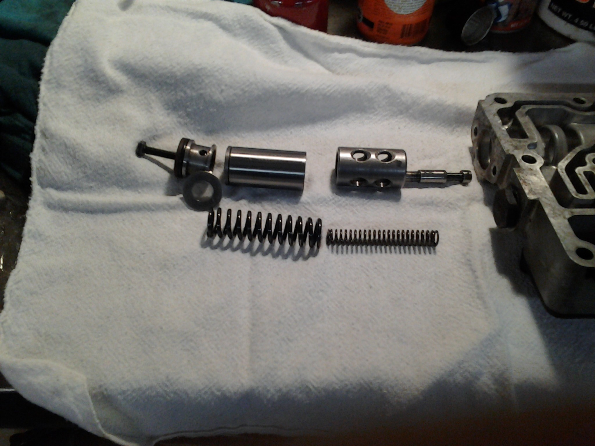

My statement was unclear so let me clear it up. That second relief valve under the valve body controls lubricating oil pressure to the clutch packs. The main relief valve controls operating pressure to the clutch packs.
Kenmac is correct, the powershift does have it's own pump and I would say that is a possible but very unlikely cause of the problem.
No drawings or anything on the 336 but am confident it has ports for checking both operating and lubricating pressures. Your manual should locate them and tell you what pressure to expect.

The bad thing is my manual is missing to trouble shooting section on the powershift. It does have the complete tear down and reassembly. No specs like pressures. The valve body has 2 ports that are most likely for testing.

The bad news is 3days and $24.00 to get a gasket and I didn't expect it to help anything but the good news is the tractor works fine. I haven't worked it under a load yet but it feels solid even in the highest gear. Before it wouldn't even pull itself up the slightest grade. At first I thought it had effected the power till I saw I had the parking brake on.The valve must have been sticking. Thanks for all the thoughts and ideas.This forum is a powerful resourse.
/ NEW YM336D PROBLEM #34
A sticking relief valve is not uncommon, although they are usually pretty obvious once you get into them.
