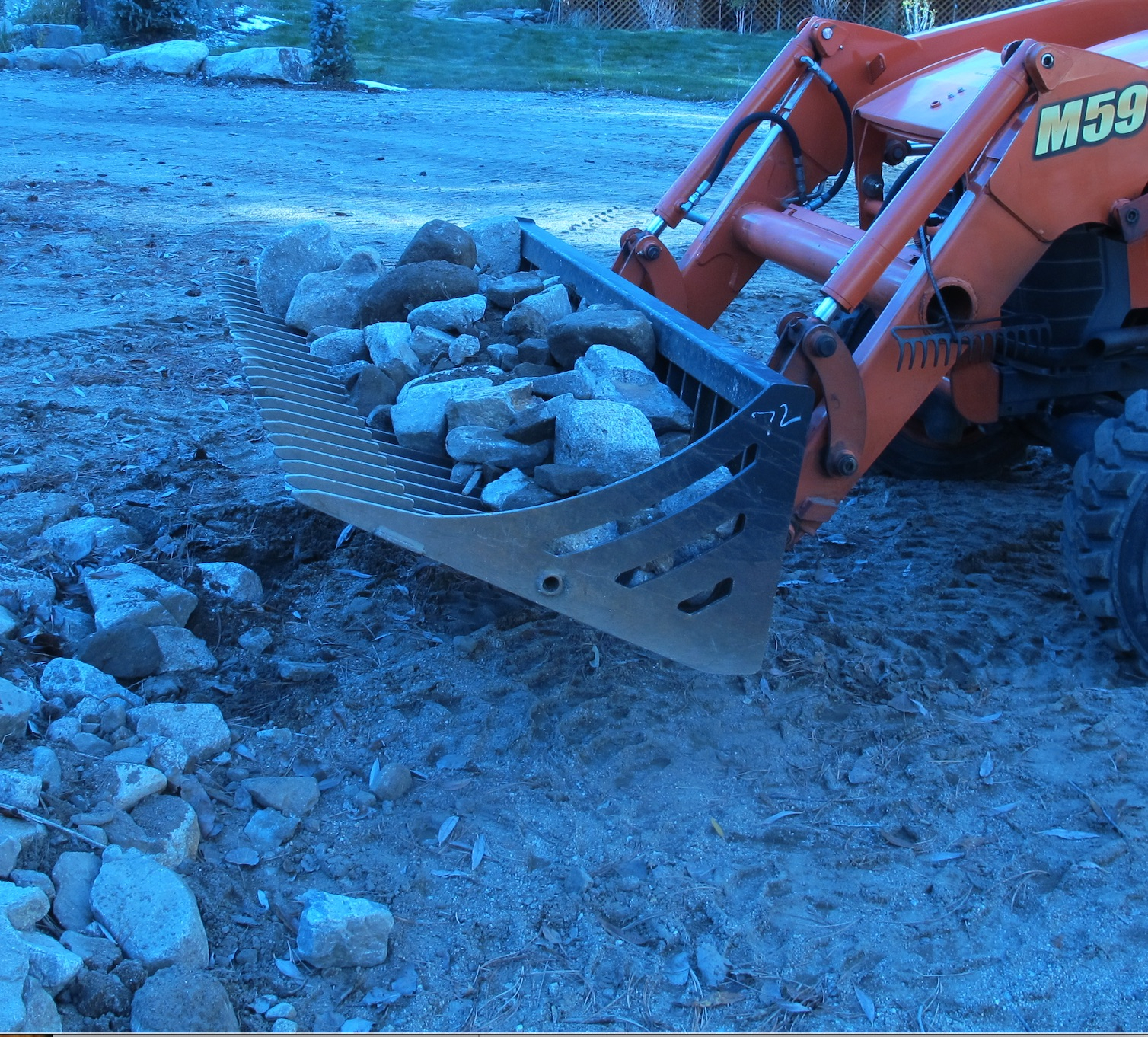

Per the recommendation for a rock bucket;
That looks really intersting. I'm assuming that you are saying that a normal bucket is not strong enough to use for large rocks, and if I plan to move any I would need a rock bucket. If so, then I think you are correct. You mentioned getting it instead of a grapple. I wondered why until I saw it. Would this be a decent tool for clearing ground of brush, saplings, and ground cover? If so, that could be really helpful...
(in that same post you mentioned getting a loader with Skid Steer quick attach. The LS does hav that.)

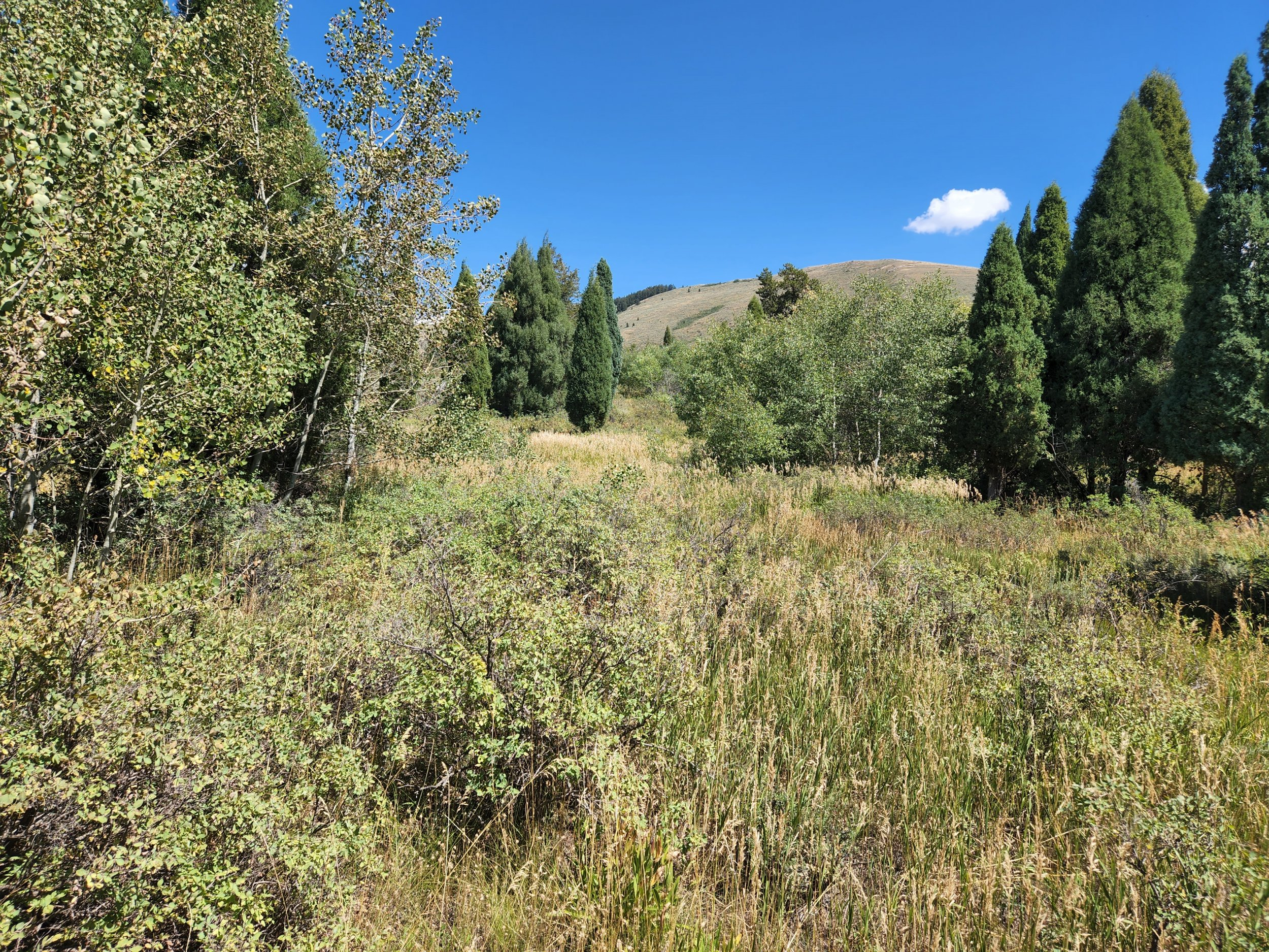

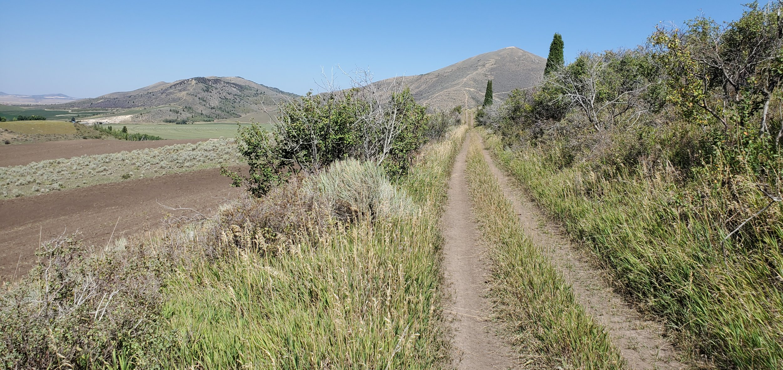

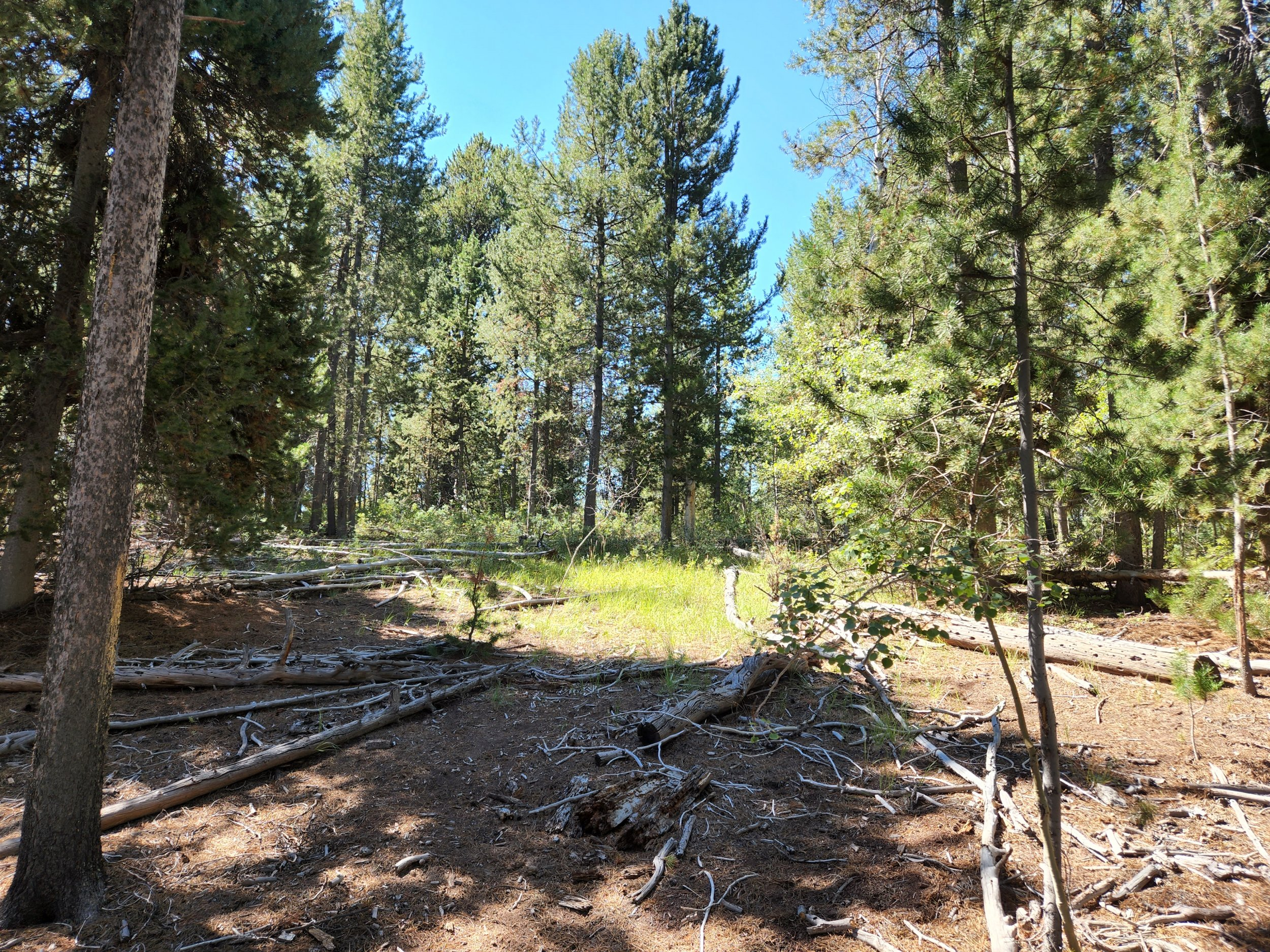

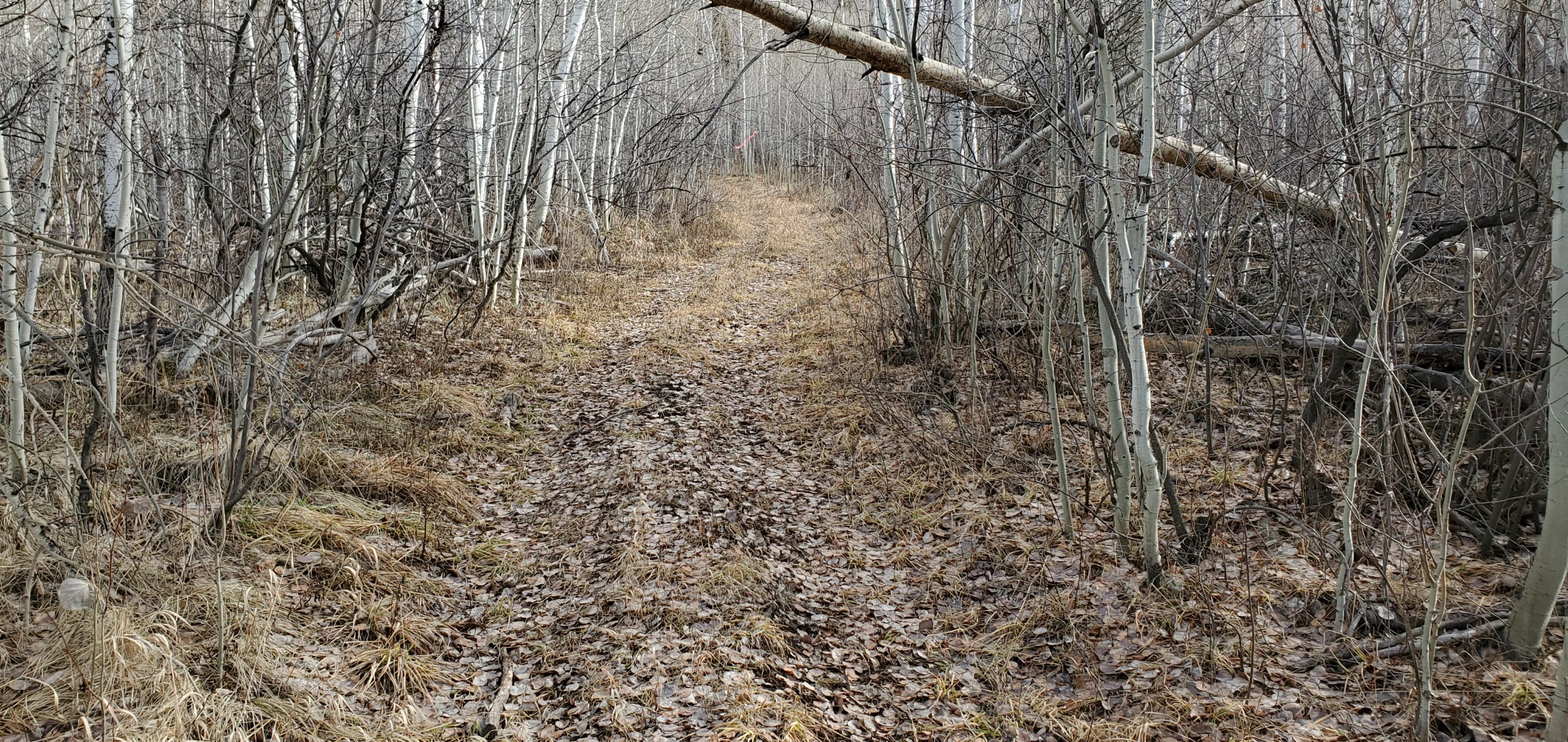

In the meantime, here are some pics.

for that aspen area, I would plan to chainsaw the trees on either side and then hopefully the dozer would be able to just push through them. Then I would use the backhoe for cleanup....

Looking at your pictures reaffirms that a compact tractor isn’t the right tool for your project. They are too light to do what you are asking, and will be torn up before the project is complete. They can handle the mowing, but that’s about it.
Consider saving a little more money for a year or two, then invest in a construction backhoe, or a CTL.

Thanks for the pictures. I'll go through your long messages today and see if I can provide any insight from our own mountain property.
But one thing stands out. I don't think you are giving enough consideration to what the various classes of machinery are capable of doing. A compact or utility size tractor is made for maintaining the property once the construction is done. Think "maintaining" - as well as doing about a thousand handy chores. You will use it everyday. And one with a backhoe+thumb is just right for moving fallen timber and holding it up for chainsawing.
Your utility tractor is capable of moving snow, hauling anything, moving rocks one at a time, or even enough dirt for way too large of a plot, or making picnic area or a turn-around area alongside the road... all kinds of work. You definitely want and need one. It's half the fun of owning land.
But for initially shaping the ground into a roadway that the utillity tractor can maintain is a job for an artist with a bulldozer. While he is there he can prepare a building site or several. He can deal with slopes that woud roll a tractor The tractor just cannot do that stuff. It isn't as stable and it doesn't have a blade that angles, tilts, and pushes - and if it did, it has neither the power or traction to push it. Even our 100 hp commercial JD310 cannot move earth like a little 35 hp D2 bulldozer. A skilled operator in a few days will literally save you years. Many years.
