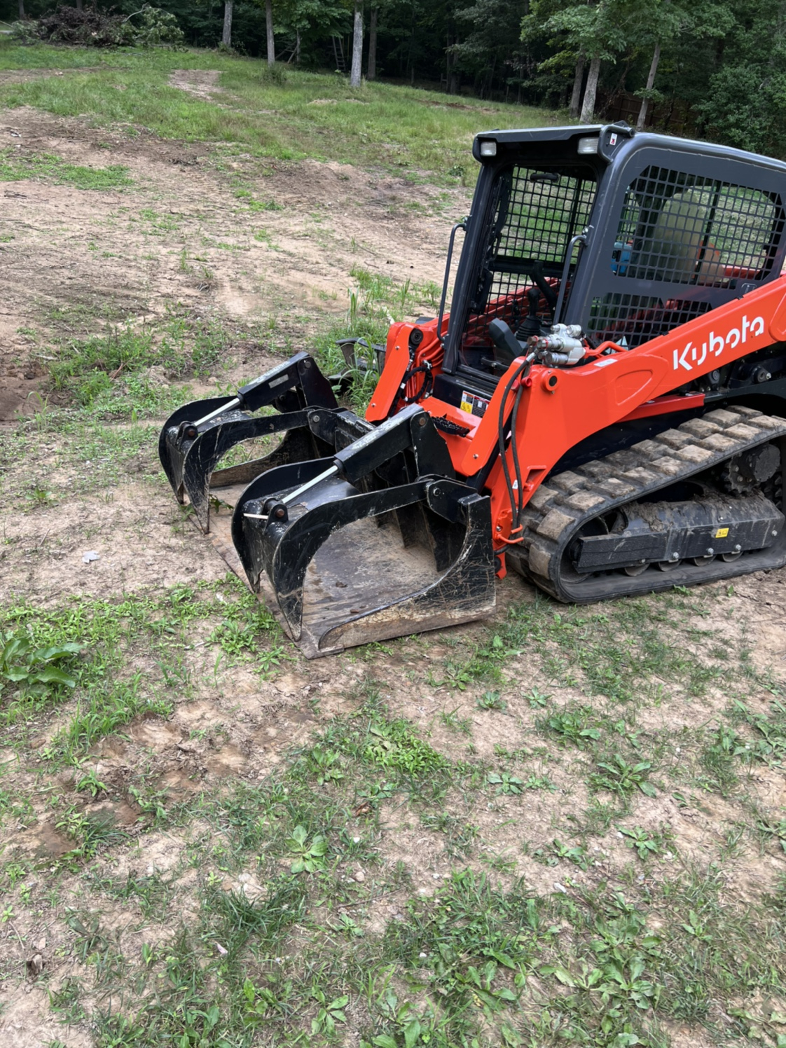

The grapple will be more maneuverable without having get out of the operators seat, making moving or cutting lots of down trees quicker. Most of my property is woods.
Since my property is already developed I have little use for a backhoe. I think a backhoe would be good for the OP's situation.

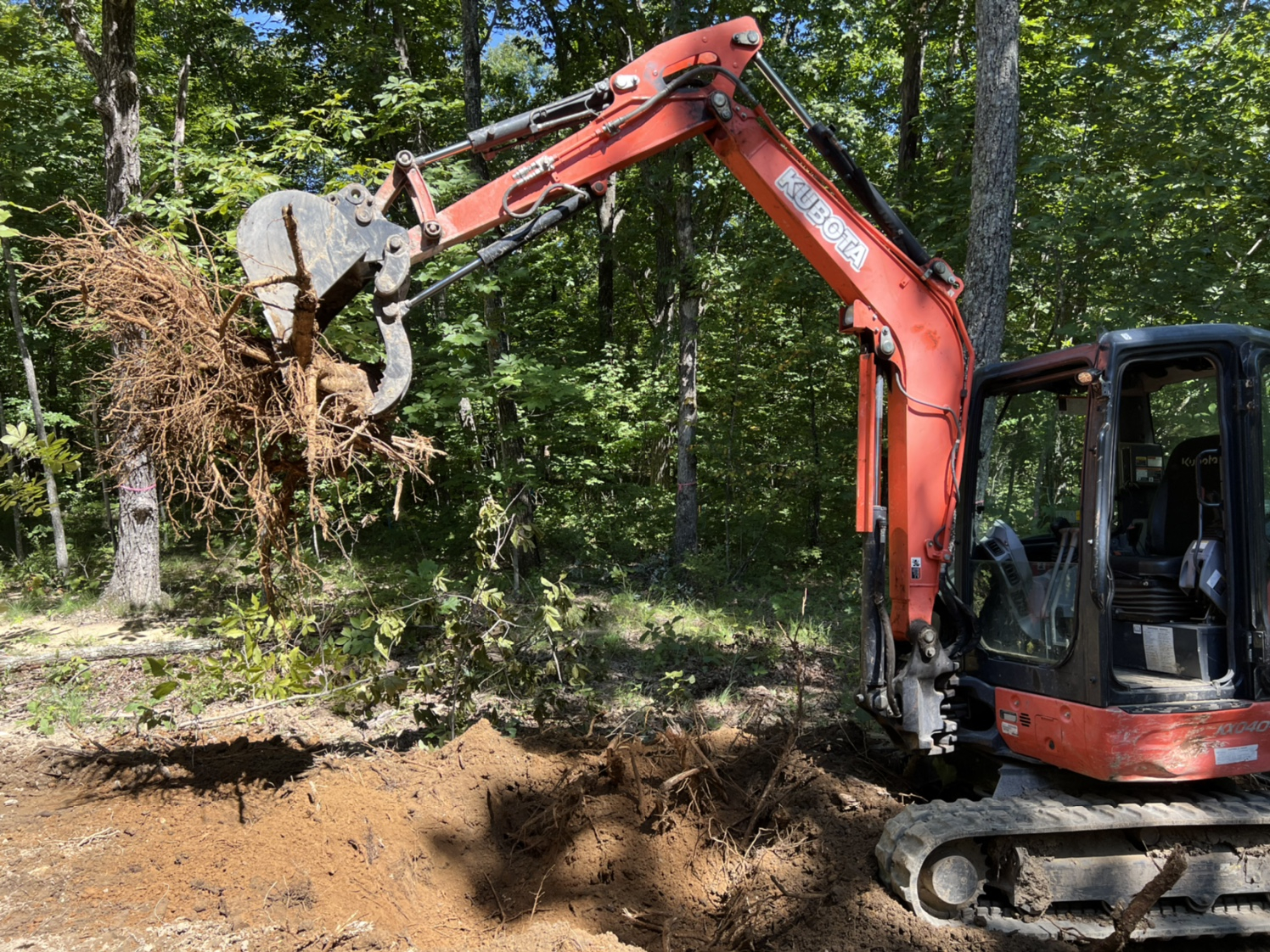

When I look at those pictures, I think "bulldozer" for 98% of that. You want a dozer to widen and improve those roads. A dozer also can push all those trees into a pile for burning. All of that is bulldozer work.
THEN after the roads look like you want them to look, a land plane (grading scraper) is the tool for the job. I have a box blade and a land plane. I have gotten to where I never even attach the box blade anymore. The land plane is SOOOOO much better for maintaining roads and grading earthen areas.
I also had a grapple and I have pallet forks. I ended up selling my grapple because the forks do the same work most of the time for a fraction of the cost.

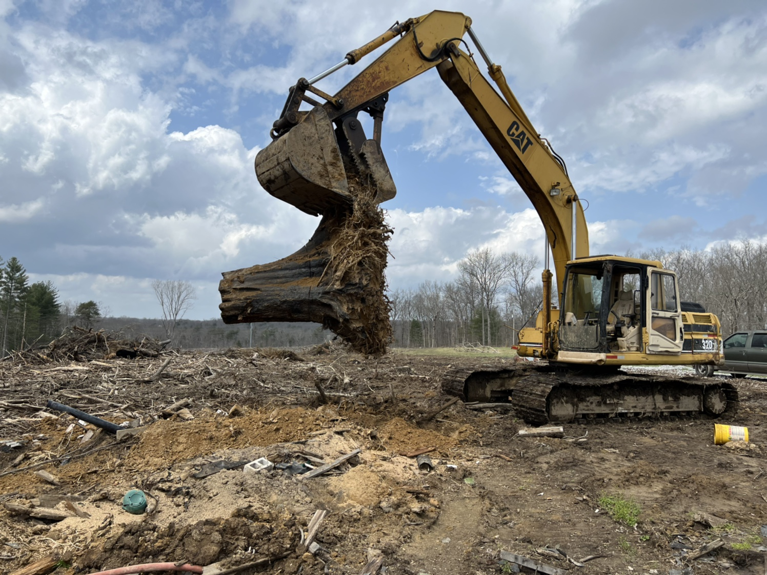

Tractors aren’t made for earth moving. You’d be a lot better off with a tracked skid steer. A tracked skid steer is a long way from a dozer but it’s a lot more versatile. A tracked skid steer is easily 5x more productive moving dirt than a compact skid steer. If you installed a tilt plate on the skid loader it would be pretty capable at building roads. A dozer even a little one would be way more productive though. Depending on how much you value your time you still might be ahead to hire a dozer.

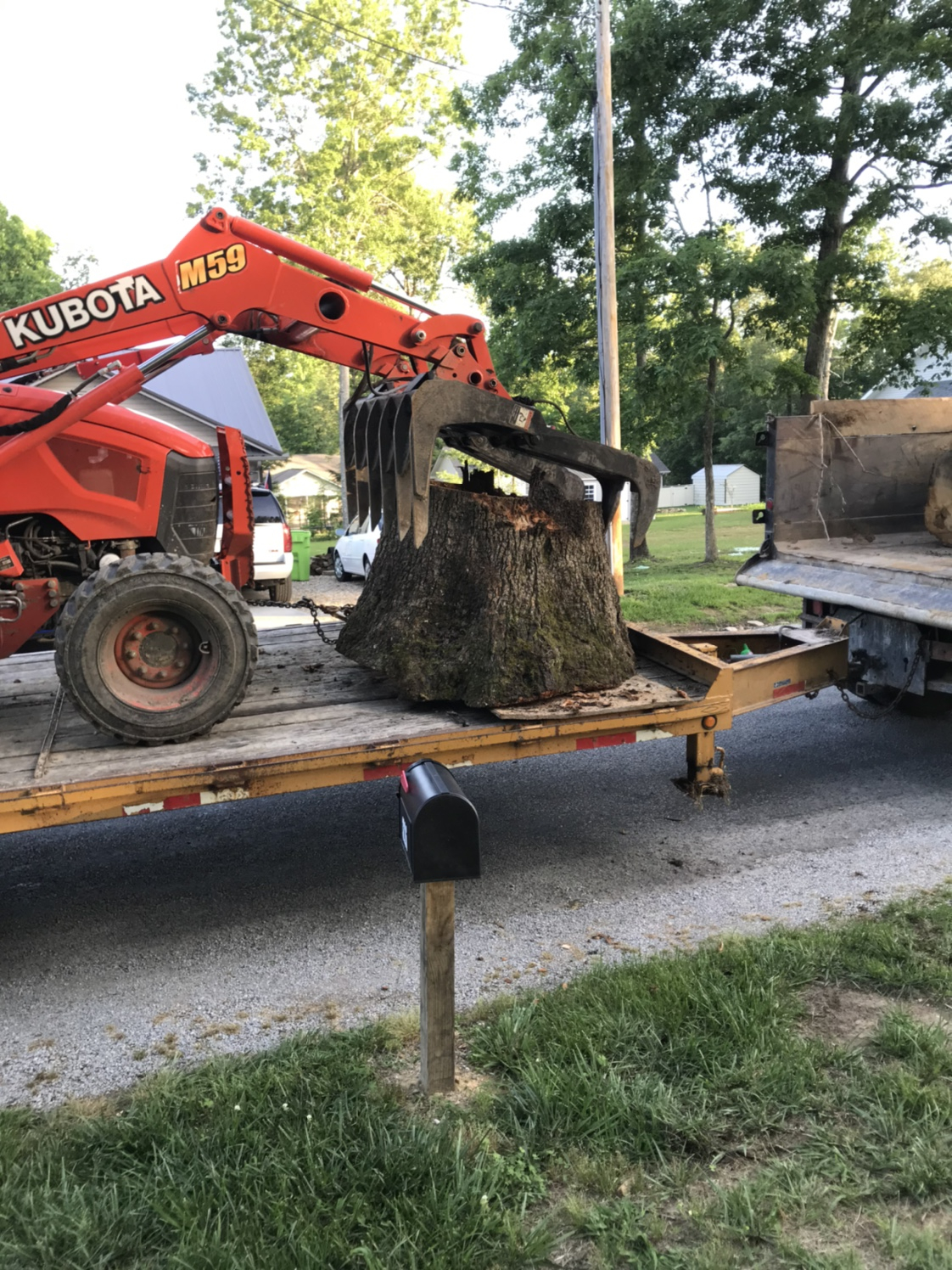

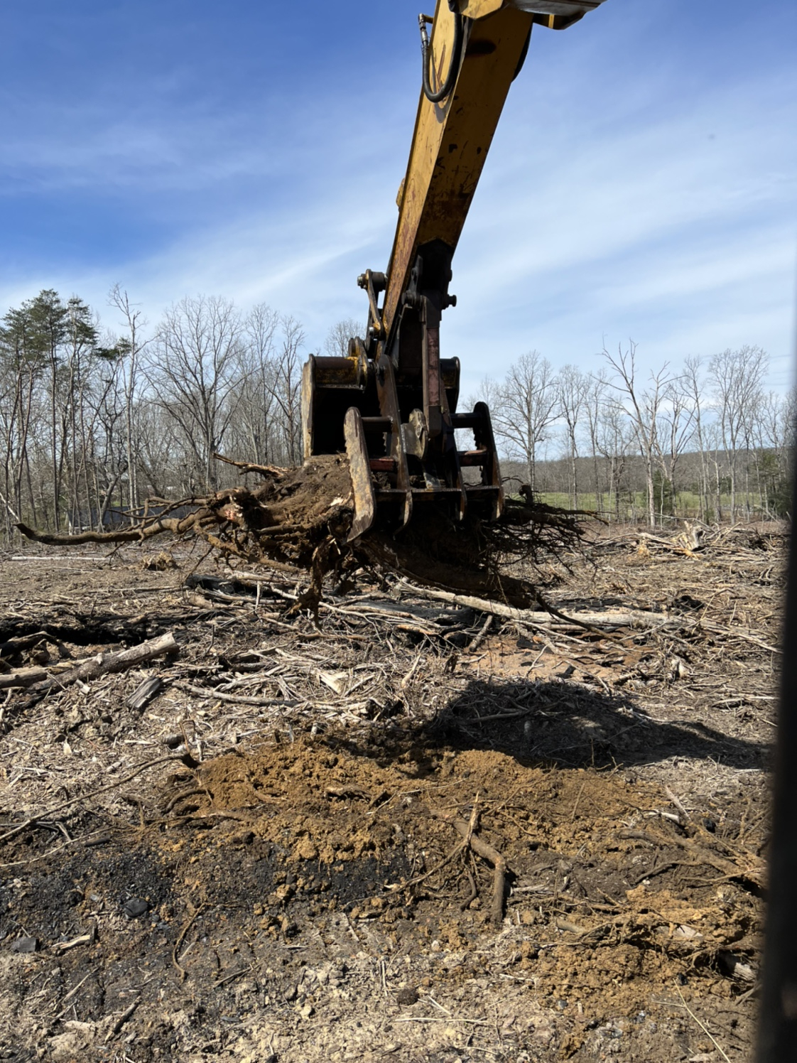

I have a dedicated grapple that I bought years ago and I got a demolition bucket included in a machine purchase. I’d been wanting one anyway because the regular grapple is lacking for loading demolition debris. A lot of trash fall through the regular grapple. I put the demolition bucket on to clean up a fallen tree. I was immediately disappointed with its brush handling ability. The visibility is extremely poor with the solid bottom bucket where you can see through the grapple. The straight edge bucket doesn’t help either. A tooth bucket would be a lot better for raking up brush. The grapple is much better than the backhoe thumb for transporting brush. It takes a lot bigger bite and you can’t drive with a very heavy load on the backhoe because the front wheels come up. About the backhoe creep lever it’s nice on tractor backhoes but I wouldn’t consider it worthwhile on the full size backhoe. It’s easy enough and almost better to just disengage the brake on the full size hoe and push it forward. The lack of reverse on the m59 creep lever was annoying. It’s also easy enough to push the full size backhoe into gear and drive it sitting backwards. With the much larger operating platform spinning the seat on the Deere only takes 2 seconds anyway. With the M59 it’s more of a gymnast move.

The lack of reverse on the m59 creep lever was annoying. SNIP.. With the M59 it’s more of a gymnast move.
Your M59 doesn't have reverse on the creep lever? Might want to check again. Mine does. Just move the creep lever in the other direction for reverse.
I must be a gymnast then. I'd better make sure to tell everyone. They think I'm a klutz.
rScotty
Now that I think about it maybe the M59 did have reverse on the creep. I’ve not had that machine for a couple years. The tractor backhoe I had before that had cruise control that could be used in the same fashion as the M59 creep but it didn’t have reverse. I’m fairly average build 6’ 180 pounds and I found the m59 swivel station tight to use where I could throw my chainsaw on the 310 floor and still spin around with ease.
