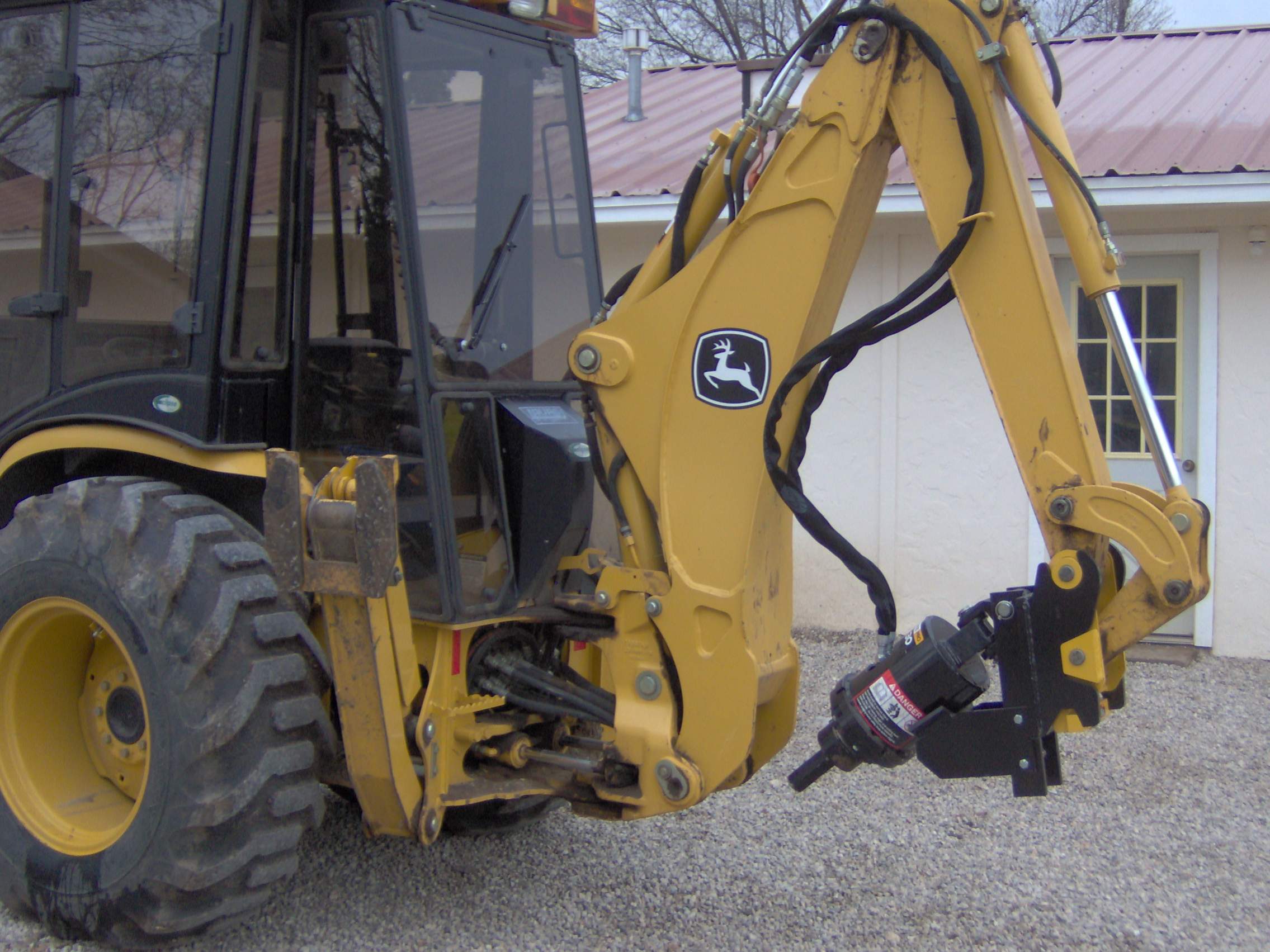

Something in the 45 hp range will do everything you wanted except lift 4500 pounds. Something in the 45 hp range could lift your minimum requirement of 2500 pounds. I know you said new, but a now discontinue JD 110 would fit your needs with a lift capacity of 2700 pounds. A Kubota M59 has a lift capacity of 3900 pounds.
I agree and have the JD110 with a Laurin cab and it is handy and versatile. I would also suggest that the larger Deere 210 L construction landscape loader tractor with factory cab and 5,400 lb. lift is worth a look. The new replacement for the Kubota M59 tlb is the M62 available early next year and is supposed to be available with a cab.
Buying new with cab I would have to give both of these machines a hard look, Kubota M62 62hp hydrostatic transmission will handle 3000+ lb pallets. and the Deere210L 93hp, powershift transmission will handle 4,500 lb. pallets.
To the OP,
I would not nail down to a specific model of ag tractor or tractor/loader/backhoe, compact tractor just yet. I would try to get a better idea of the needs first then look at all of the suggestions before deciding which is best for you.
I am a general contractor and it is my experience that suggest a Kubota M62 with cab should be a well rounded machine for 90% of your uses. This will be available with or without the backhoe, but I find a backhoe is always needed on construction sites. The Deere 210 L while larger and higher lift capacity is great for grading is not available with a backhoe and is not a hydrostatic transmission. It has a powershift transmission which works very well for grading work.
For mowing I have the x749 which is about the same as the x739 but is diesel, very satisfied with it after 5 years of use. I also have an x758 diesel without the 4 wheel steer it is also good but lacks the maneuverability I am used to.
About pricing I found that all of the Deere equipment I have bought new was purchased from 15% off msrp for the small mowers to 20% off msrp for the loaded 110 tlb. I would expect some where around 15 to 18% off on a new tractor purchase. Don't have a clue where the other brands discounts are structured.
