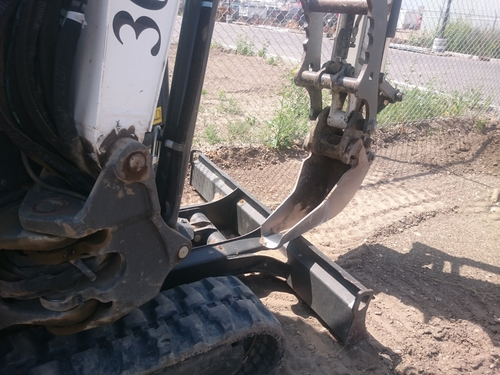

not sure a ripper will lay pipe, I made a custom bucket for pipe, I can dig a trench 5 inches wide quickly and minimal filling afterwards
   / Newbie mini ex questions, and Kubota KX vs U series? #23
Picture please. I'm working on a 9"(quick coupler width) at the top to 3" at the cutting edge by 38" deep for trenching in the areas the chain trencher doesn't work well.(sticky clay)

what machine are you putting it on? mine is a Bobcat X change I drew it on cad so it works with there system, no pins, this will dig down 32 inches easily the shallow depth and taper stops it clogging,
