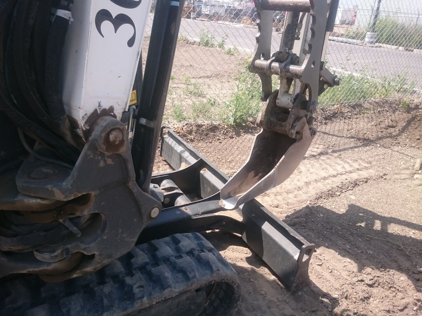

what machine are you putting it on? mine is a Bobcat X change I drew it on cad so it works with there system, no pins, this will dig down 32 inches easily the shallow depth and taper stops it clogging,

on my E32 we tried trenching with a 9 inch rental, was never cleaning and packed with material 9 out of 10 times, switched to a 18 and way better though for gas lines and electric it was a overkill.
check out the trench bucket I built a couple years ago, it cuts a 5 to 6 inch trench, widens as it goes down with a depth of 34 inches I do water sprinklers, electric lines and the odd gas line, works great and rarely plugs by design, its custom made had the plates plasma cut and welded together

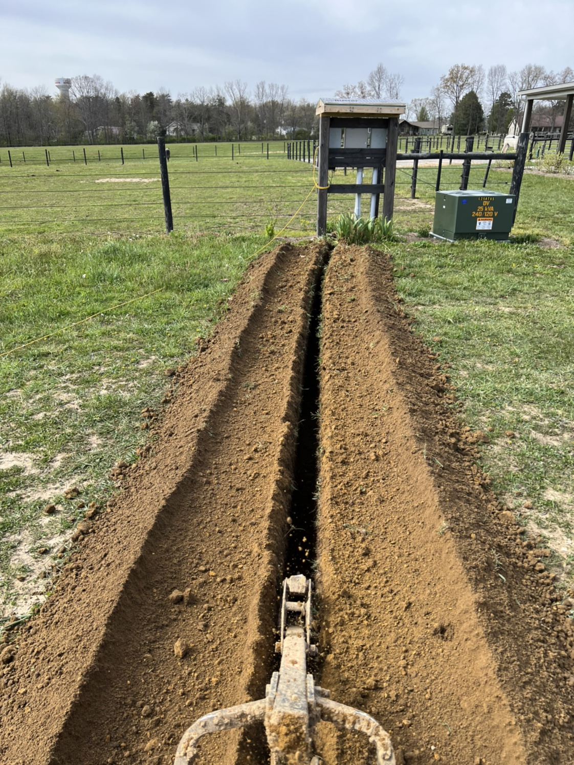

Here’s what I’d use if neatness is of any concern. Otherwise dig away with the 18” bucket.

no knock off, I have used the bobcat for several miles of trenching, this was version 4 and it works 100%, the shallow depth and widening prevents clogging, it basically self cleans
gave the files to two members, they are happy but not using the bobcat x change mounting, this was designed to mount directly on x change system
I can easily state no bucket exists of this design, demoed it to a dealer but they can not sell it
   / Newbie mini ex questions, and Kubota KX vs U series? #39
for material its made of 3/4 steel plate for X change sides, bucket sides are 1/2 or 3/8 plate, back of bucket is 3/8 steel 5 sections to create the profile, on the edge I used a 5 1/2 inch of road grader blade, it does the work and takes abuse
welding was 2 hours and ready to dig, figure we dug miles with it for water and power
