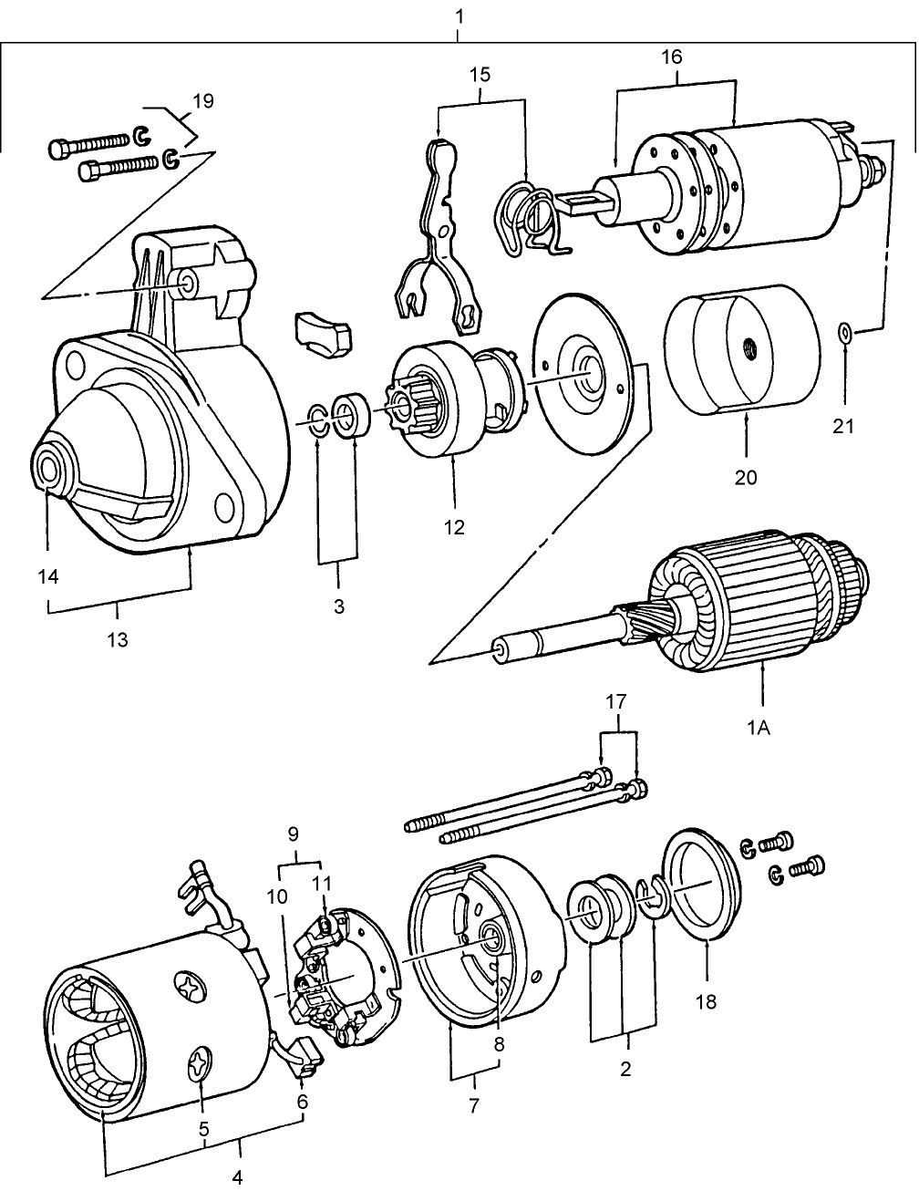

Fluid replacement is on the to do list for the weekend. The axle froze again. That front oil definitely needs to be replaced. All right I got another question for everybody. Took my battery off to charge it and noticed how rusted/corroded some of the leads were. Decided while I was at it I would pull the ground strap, hot wire to the solenoid, and solenoid off to clean all the posts/surfaces of corrosion/surface rust etc. to get a better/cleaner current to my starter.
Well I may have bitten off more than I can chew with the solenoid. I've disassembled and replaced plenty of solenoids before (power sports) but this one was new to me. I made the ultimate mechanic sin of taking something apart and not remembering how it went back together. I am particularly baffled by the spring/plunger/actuator arm that goes down into the starter. Clearly I can see the plunger slot goes over the acuator arm but how does that dang spring go back in there? And which leads go to which post on the solenoid? Anybody got a diagram of exactly how they go back together? I wouldn't have pulled the solenoid knowing these internal parts would come out when I pulled it off the starter. I thought, like in power sports, it alone would come off as one easily replaceable unit and I would more easily be able to clean it's brass posts.

let's start with the pic but at the same time post make and model of your starter off of your tractor. There might be some parts breakdown somewhere.I'll look at what I have for some clue.

Jonah, I think the attachment is an illustration of your starter. Maybe it will help.

Yeah Jinman that's it! Thanks man. I searched around and eventually found that diagram as well.
I got it all back together and running again. My projects now are still to replace that front axle fluid and install a block heater.
