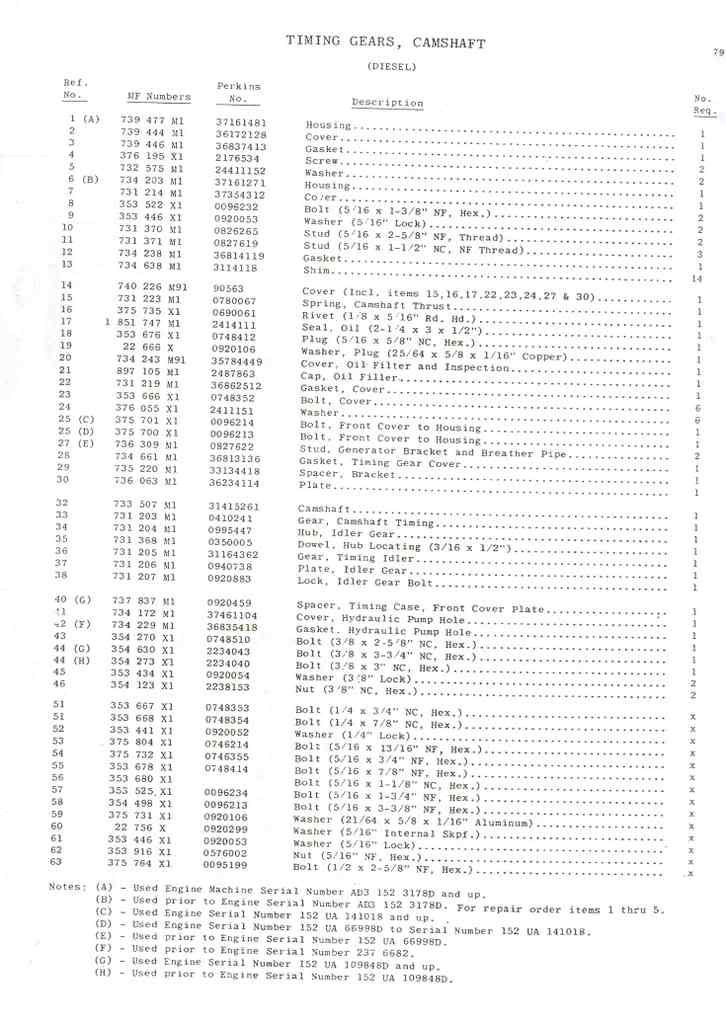

Soundguy,Thanks but the gauge is showing the problem, every time the hole in the idler gear lines up with the hole in the hub that it rides on the oil pressure drops off to almost nothing. As soon as they don't line up oil pressure is normal. Flusher, VERY nice job on the old girl. I guess what I need is someone with a set of Perkins parts books with the different years to see if there is some mis-matched parts on the front of this engine. thanks Paul
Thanks.
Here's more timing gear info for the MF-135 AD152 engine. The parts list shows some of the changes MF made during the production run. Don't know if this helps.

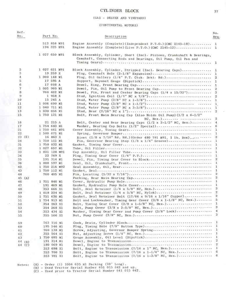

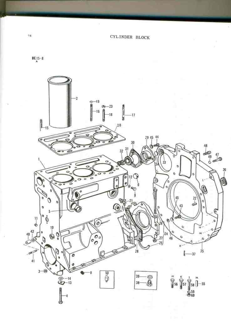

Hi Guys, Been reading all the replys and thanks for the tips. Allready installed a new oil pump and pickup. Did the oil line off the engine with it running and watched it start and stop flowing. the problem is so pronounced that I don't get oil to the top of the engine. I took a reclaim refridgerant tank and filled it with oil and pressure fed it to the engine both running and stopped. Then I get oil to the top of the engine. Does anybody have the block parts list? Maybe a plug missing? It reminds me of a Detroit Deisel with the plugs missing from the crankshaft. Thanks for the help guys, Paul

Hope this helps.

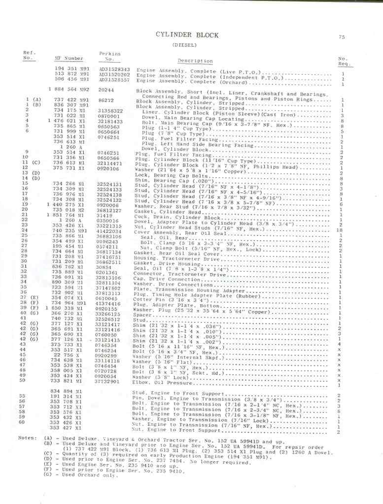

QUOTE]
Oops. That was the MF-135 Continential gasser. Here's the MF-135 diesel engine stuff. Sorry about that.
