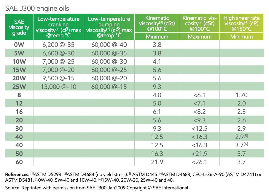

15w40 is goo in the winter. Cranking speeds will be about 60% slower than almost any other oil. Use at least a 10w40. 5w or 0w40 would be better. Unless you don't mind having your overhead valve train smoke when starting cold. Of course, you'd never see it.
   / Newbie Tractor Owner Gets An Old Diesel Tractor, recommendations for engine oil #38
Real goo would be mono-grade SAE 30 in the winter.
The manual's recommendations list SAE 30 for >80 F, SAE 20 for 32 F to 80 F and SAE 10 for -20 F to 32 F. The relevant ASTM specifications differ for testing "winter" oils vs. regular oils, and for a multiviscosity oil, they run the oil through all of the tests to get both the "cold" numbers and "hot" numbers. Thus, I cannot find data for the cold pumping viscosity for SAE 20 or SAE 30 since those "regular" oils do not have to meet the "winter" specs and aren't tested. However, if the 40 C viscosities are any indication, SAE 20 is going to be noticeably more viscous when cold than 15W-40 so I would not feel uncomfortable running it where you would otherwise use SAE 20 per the manual. Also, any modern oil is going to be a whole lot better oil than what was around in the early 1960s and that includes residual film protection on cold starting.
   / Newbie Tractor Owner Gets An Old Diesel Tractor, recommendations for engine oil #39
Kirkland HDEO has a pour point of -36C and better cP rating at -20C (6010) than some 5w do at -30C (6600(limit)) The Kirkland has a pumping viscosity of 20000cP at -25C which is below the limit of 60000cP
While if I was at that temp I would not use a 15w40 I feel comfortable to 0C, 32F and occasionally a little lower.
BTW that is almost exactly the cP of molasses at 73F
It's about pumpability at these temps and not so much about flow. Most other modern oils perform the same or better.
