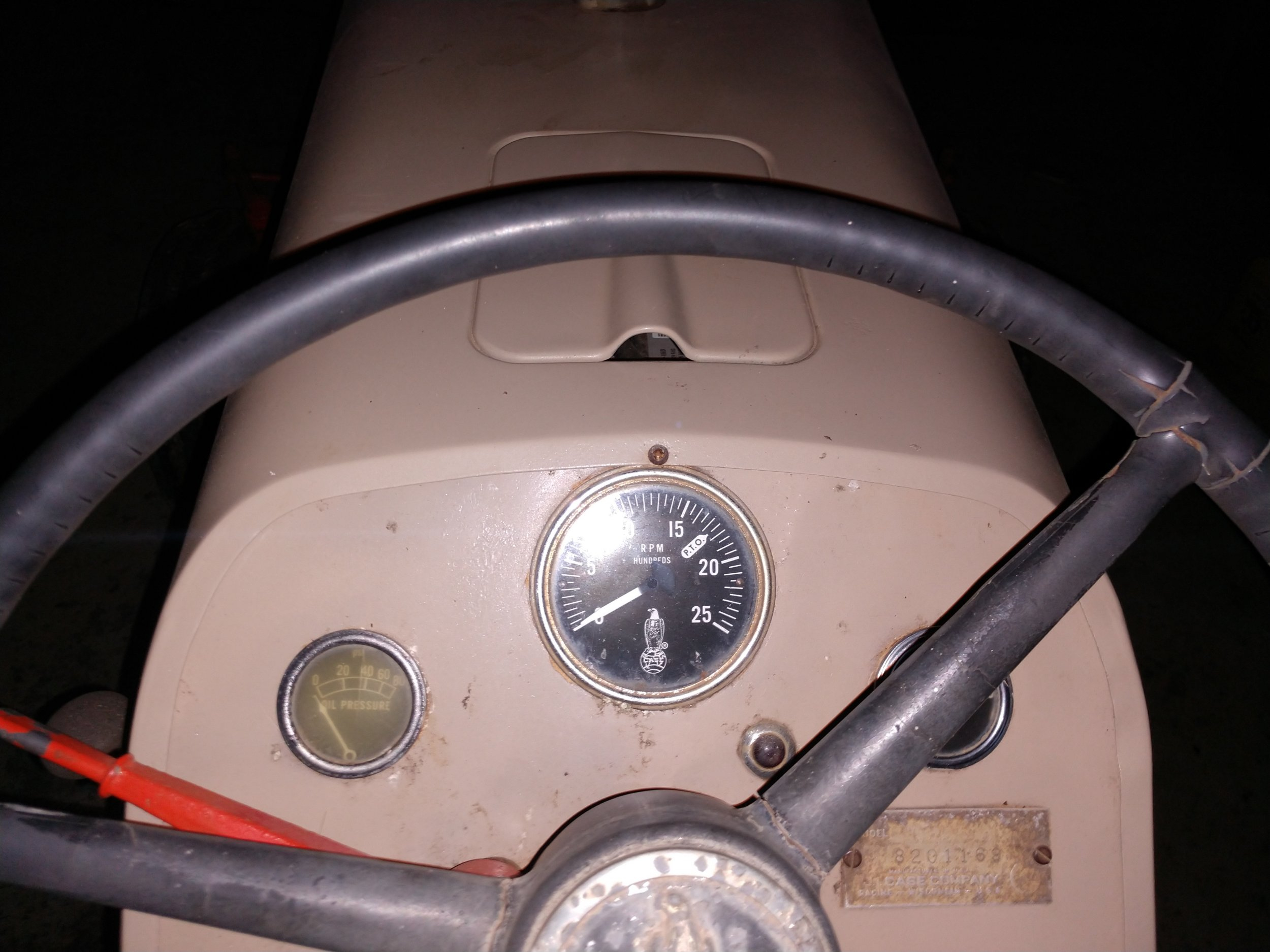

Hours? What are hours?
But check out that awesome Eagle logo!
Interesting. Given the interest in this logo, perhaps the large cast iron Case Eagle I saw on Craigslist is not overpriced at $16000!
