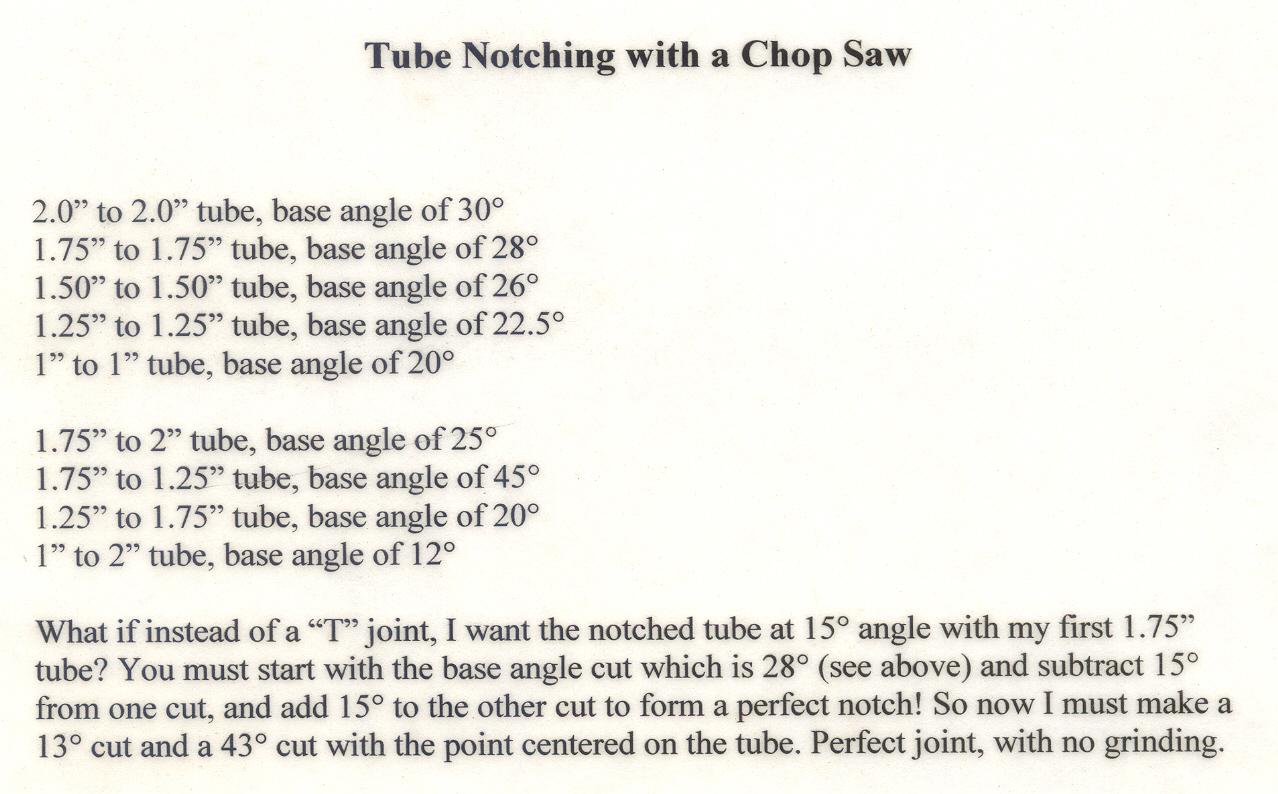

I don't ever remember saddling pipe with a chop saw, but I know guys who have great success at it. Someone posted this chart years ago who saddles with a chop saw.
Here is a link to a handy coping calculator.
Tube Coping Calculator

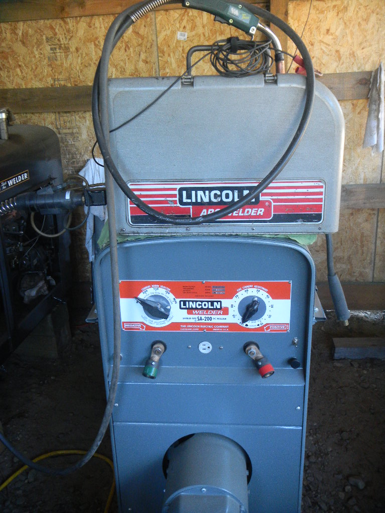

I forgot to mention, don't know what kind of engine drive your neighbor has, but it really doesn't matter. If you want to make quick work of those bad fits. Nothing fills gaps like a wire feeder! If you could rent an LN-25, and buy some Lincoln .045" NR-212 wire, you could run it down hill and make quick work of those bad fits.;)
Here is a picture of some NR-212 run with a 46-year old engine drive.

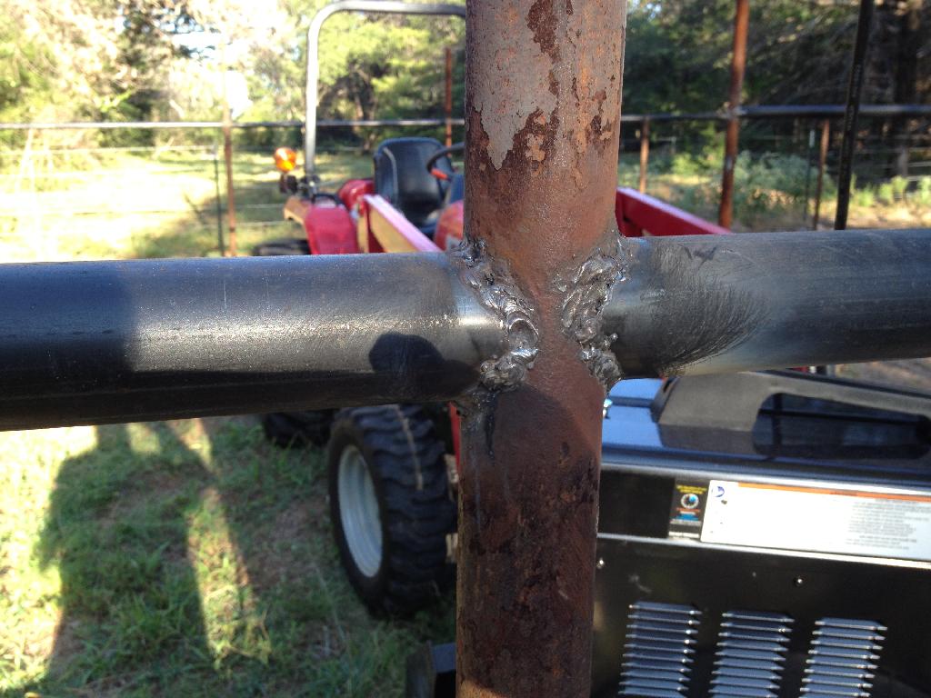

...and btw, I picked up a 90amp flux core wire welder from Harbor Freight for $109, works great with my 7000 gennie, I've only had to wait on the duty cycle a few times due to the start/stop nature of my amateur welding capabilities... see pic, they ain't pretty, but I think they'll hold. I'm getting better as i go too. Thanks for the tip on the wire welders, they really do help fill in holes/gaps better.
