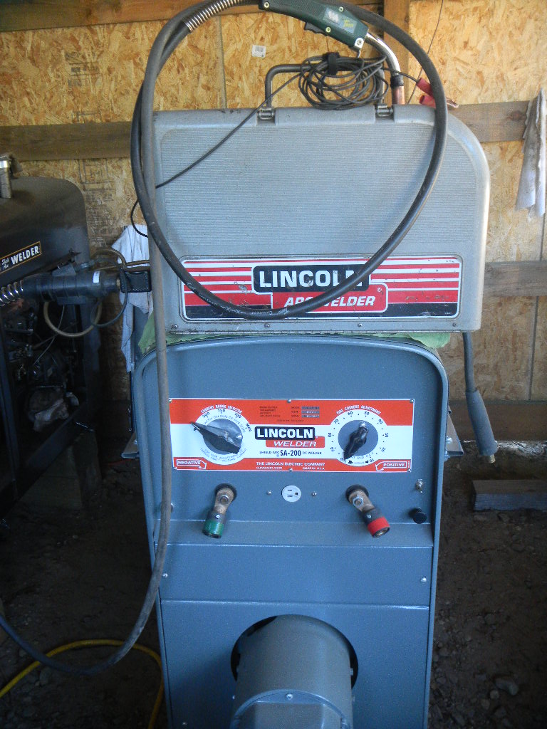

The Harbor Freight wire feeder wasn't exactly what I had in mind! More like this picture.
I highly suggest you start running those welds up hill.
