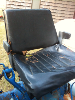

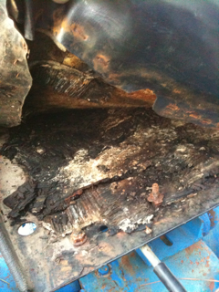

Thanks for the advice/tips. One other item I wanted to ask is about seats. Currently the tractor has a seat from a Yale forklift. And is rotting out from the bottom, see the pics. So looking for a replacement on the internets......
Most of the seats on eBay seem to be affordable. But what works best for the long haul? The Ford 601 has the old school saddle looking seat, but it can start to get hard on the bones after a few hours of bush wackin'. The seat that came on the tractor, or what people say came on it is 200 bucks...and that is on eBay!
Anyone have a good model that they prefer? I tried to search the forums here with no luck. Guess I need to start a new thread, and pretty confident that it might get heated. :)

any seat that fits you there is a bunch of different types of seats that goes on these tractors and depending on the build of the person would determine the seat they like so it would be more of what fits u not what everyone else likes
   / Newbie with a '65 Ford 4000 #13
tsc sells a 99$ universal seat that has arm rests and decent cushion.. adjustablle front to rear with slide handle.. will bolt right on to the 2 bolt mount on a ford top cover..
if you need clearance for a remote handle.. or ya got long legs, use a big piece of box channel with offset holes in each side.. mount box to top cover.. then seat to box..

Also Soundguy has good advice on the seat. I was pleasantly surprised when I was able to buy an entire seat and mount with weight adjustment and armrests for well under $100. I have a thread somewhere below with pictures of my 3000. You can see my $85 seat. It worked out very well.
