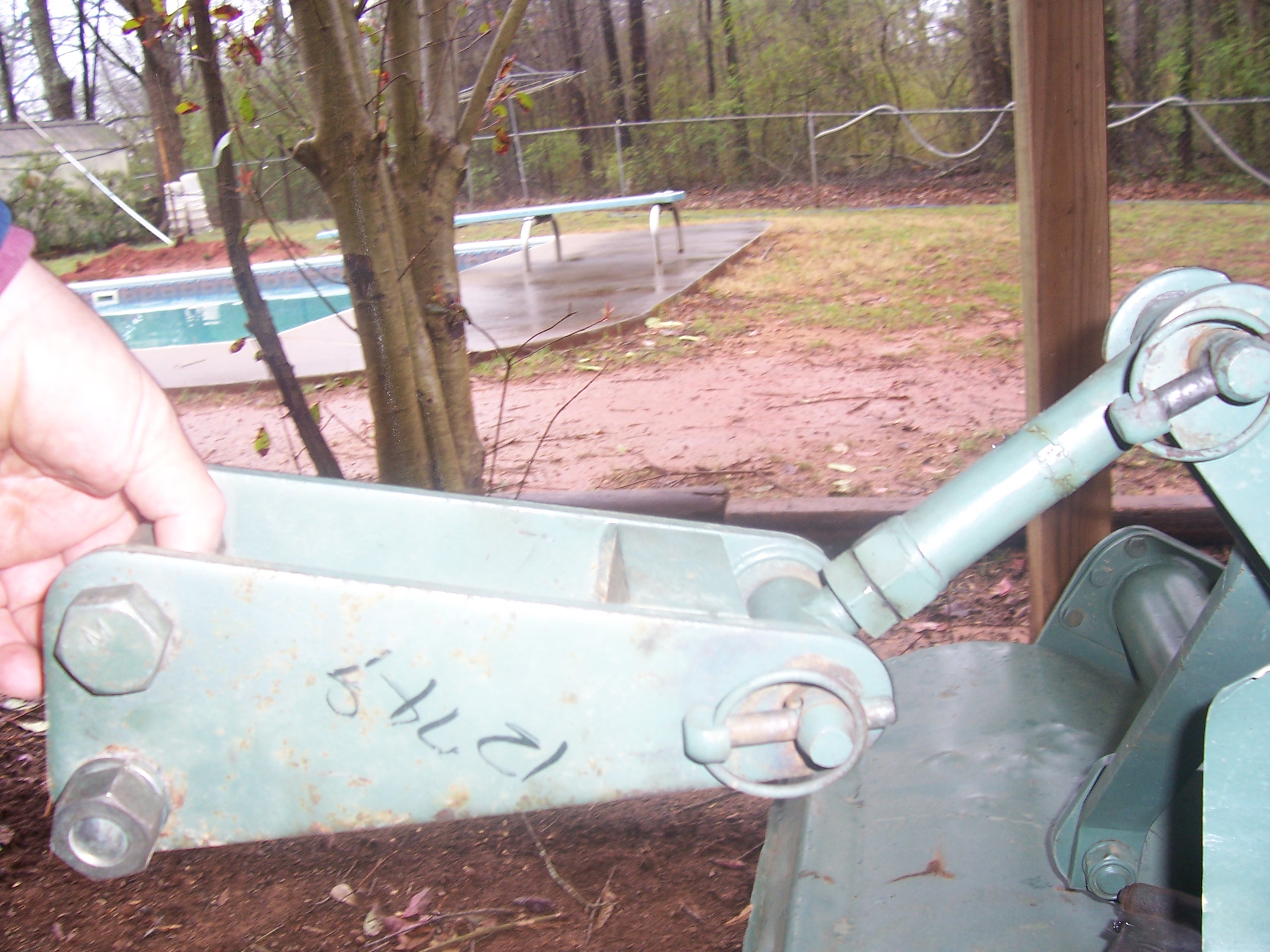

Fredricks will give it to you. Top Bracket. It allows the Tiller to swing Out away from the rear wheels and then up. And the correct PTO drive shaft also

Lol thanks for the input. I will call Fredricks and see what they have. What is a fair price for a 4.5 or 5ft one from there? So anyone else think a 5ft would be ok?

Thanks Bmaverick. I will do that. Also thanks for the info on the tillers. I was curious about how they compared to the TSC county line ones. Just out of curiosity would a different brand of triller need that extra top link attachment that Fredrick's have, or just work with a standard top link bar? I'm asking because I found a nice local 5ft tiller for $650 I can get.

Hard to say it just depends on how it's set up. The top link bracket is set up to push the tiller out and up to were a top link would basically just go up and you may run into a problem. So many variables with different brands. The 650$ could end up costing 850$ having to buy longer ams longer/shorter Dr.shaft or even both. Then the tiller itself may have problems or going to have problems with worn out parts,tines Etc.. I would start with giving Fredricks a call and go from there. At least your know that it will work and is setup for your tractor properly. I had problems getting mine setup Yup!! gave me the wrong drive shaft LOL.. So at least you know they will stand behind it and make sure you get or have everything you need.

As Carey said RS 1400 (55 inch) was made for YM2000. It says so on its setup decal. So your 2210 is well matched to it. (Same displacement and nearly identical engine, the increased rated hp may be just an ability to run at higher rpm).
A US tiller has more aggressive tines so I suspect it loads the tractor harder. Still, if you found a nice 5 ft tiller locally for $650 that's the way I would go. It will be built to conventional 3-point dimensions so it doesn't need that special top link. The purpose for that device is to make the top of a RS tiller rotate away from hitting the tires as you lift it but this shouldn't be an issue with a 'standard' tiller.

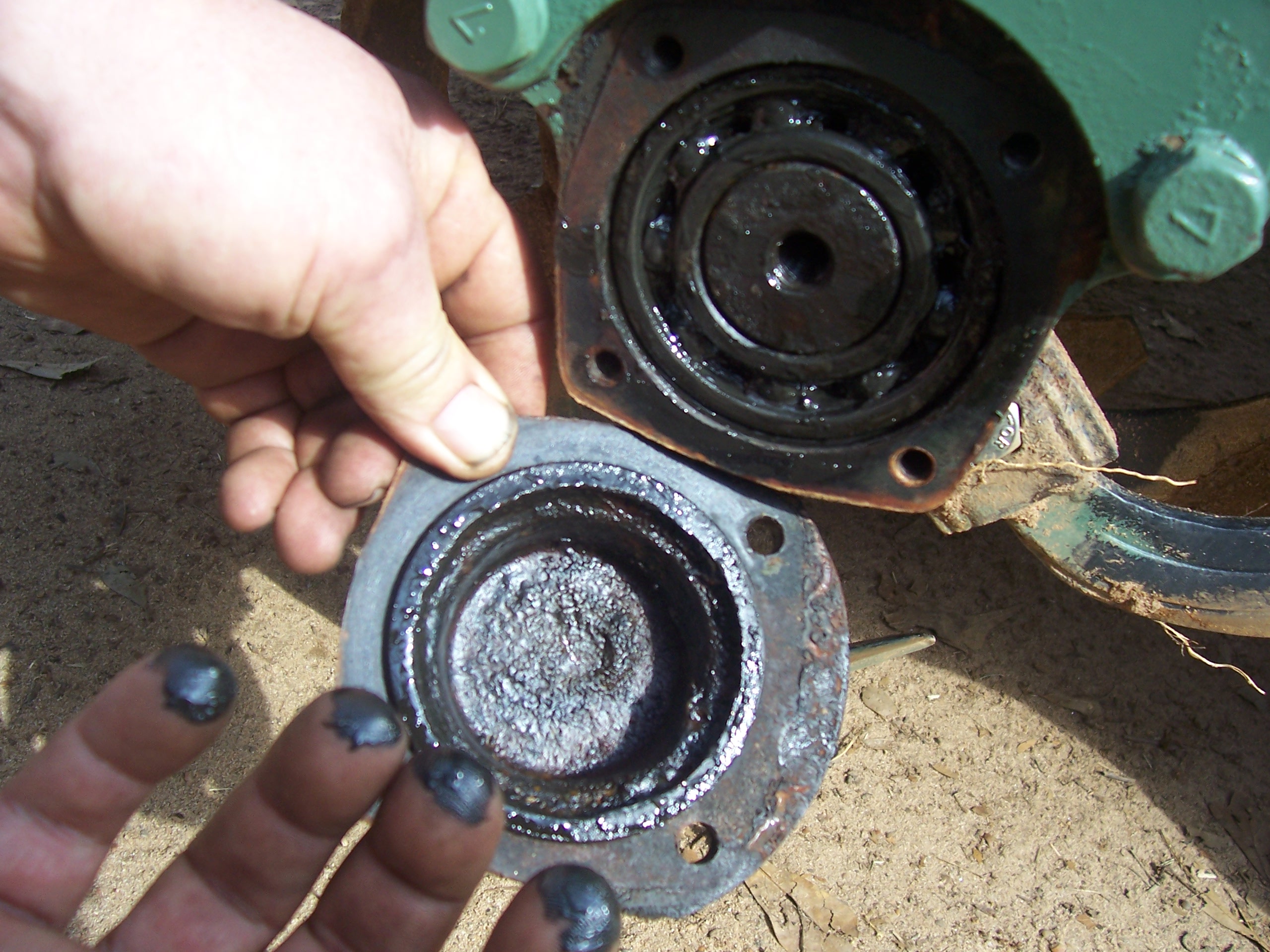

Also Winston mentioned changing the fluid upon buying a used tiller. Particularly for the Japanese ones, they were run underwater for their first lifetime. The decent importer where I got mine insisted there was no need to replace fluid but I did anyway. It was milky, ie homogenized water/oil. Subsequent years I have opened the bottom drain before attaching it that season and have always gotten some water out. I don't know if this is residual water from 20 years ago or recent condensation. I suggest make this annual check for water.
And - if you do find a used Yanmar tiller be sure to replace the offside (non-geared side) bearing at the end of the tine axle. A dealer here said he saw import tillers destroyed by neglecting that bearing. He advised replacing it with the same spec sealed bearing.
