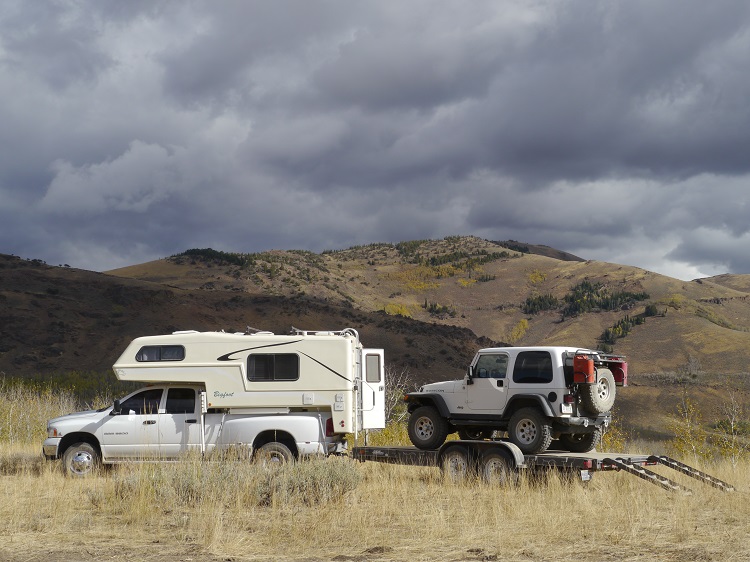

The DRW trucks have high GVWR痴. Why use a DRW truck if you aren稚 towing at least 14k?
Stability is why. I haul a cabover camper on my truck a lot. Used to have it on a SRW but since I take it off-highway I went to a DRW. World of difference having those two extra tires out there in an off-camber situation with a camper nearly 13' tall.
