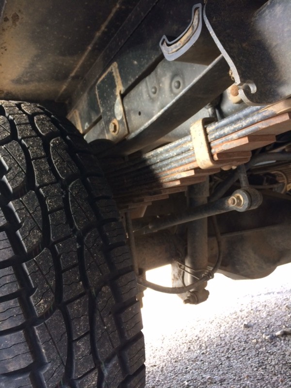

My truck rides very rough, when unladen. It was a chassis cab, not a pickup. The chassis cabs have a lot more leaf springs, in the back, than the four that come on the pickup. With 3-4K on the bed, it settles in nicely, or 7-14k on a bumper pull. My dump trailer is around 5k, empty, and my truck still rides rough, with it following.
Here’s my leaf springs:
Great for heavy loads, terrible for unladen ride quality.
