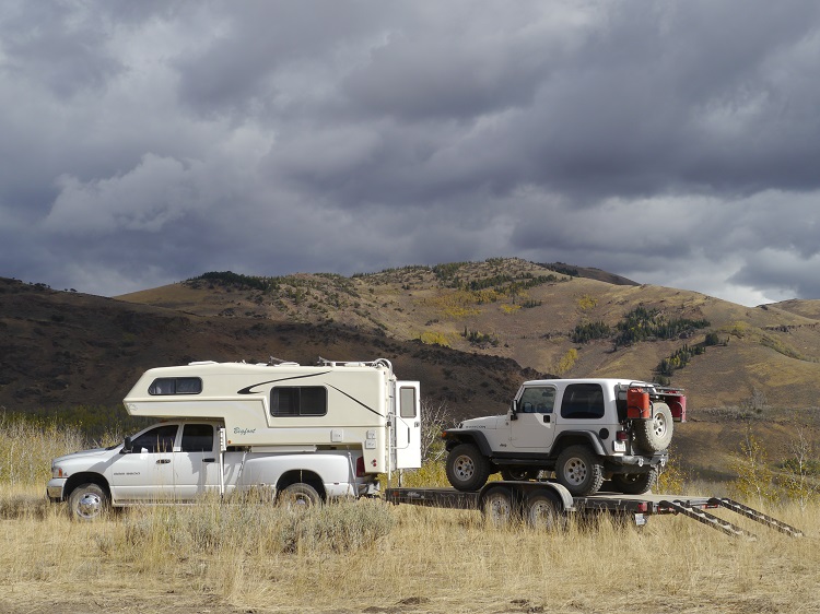

Stability is why. I haul a cabover camper on my truck a lot. Used to have it on a SRW but since I take it off-highway I went to a DRW. World of difference having those two extra tires out there in an off-camber situation with a camper nearly 13' tall.
I get that. A DRW is much nicer to pull with, in most situations. Due to legal and insurance implications, I don’t recommend mend the DRW unless it’s needed. Such as the OP’s case, where he’s getting dangerously close to CDL territory.

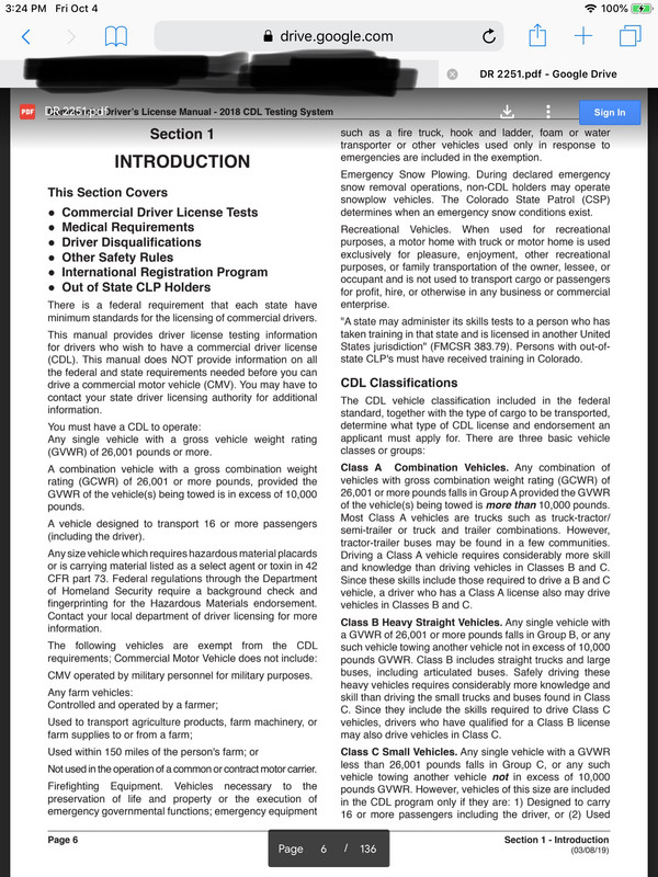

Here’s a page from the Colorado CDL Manual. I copied the part about when a CDL is required:
Notice, the combined GVWR’s being over 26k (with the towed vehicle over 10k), CDL is required. Now, go back and reread my posts and tell me what is inaccurate. Not what is inconvenient, for you, but what is inaccurate.
Here’s a link, if you think I typed it up, myself.
DR 2251.pdf - Google Drive
Where does it say you need a CDL to tow a trailer that weighs 10,001 pounds or more while keeping the total weight under 26,000? Nobody not once has disputed needing a CDL for 26,000 pounds or more. ( although there are exceptions ) I didn’t see the part about 6 wheel pickups needed a CDL either.

You keep skipping the pertinent part: GVWR. It’s not just actual weight. I know your type. The kind of guy who cherry picks the parts that suit them while denying the inconvenient parts. They are the ones who are going to sue me, have my job, blah blah blah, on the way to jail. Then, when the Judge finds them Guilty, the Judge doesn’t know anything. Not far different from the guy who is going to kick my ***, while the handcuffs are on, but are “yes, sir” when they come off.
My posts come from my experience in applying written and case law then professionally defending those actions, in court, and in running a side business (tractor jobs) where all of this is applicable. I am not an attorney, but I do have a very thorough working knowledge of how to avoid needing one. In the end, I can back up my statements with legally relevant documentation. I have posted the relevant page from the OP’s State DL manual. I can’t make you read it or understand it, but I can comment on it’s applicability, in certain situations.

Notice the Colorado exemptions, the CDL requirements don't apply if the vehicle is not being used as a common carrier or in a commercial situation.
